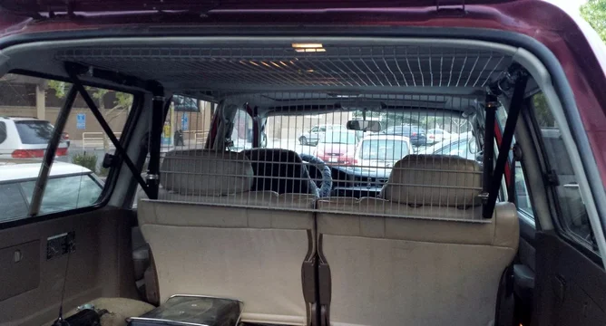

In my old 80 years ago I made a barrier with wire shelving. Worked good the kids are still alive.
That's the sort of thing I was referring to, Thanks for posting. However it looks like a roll-bar hoop you have there and at that point buying the member built one is a more realistic option. Family camping and offroading, so I'm not likely to need a roll-bar, at this point anyway
