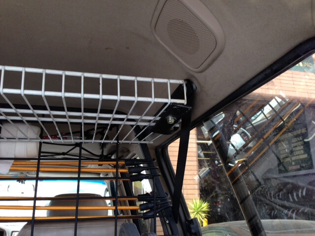

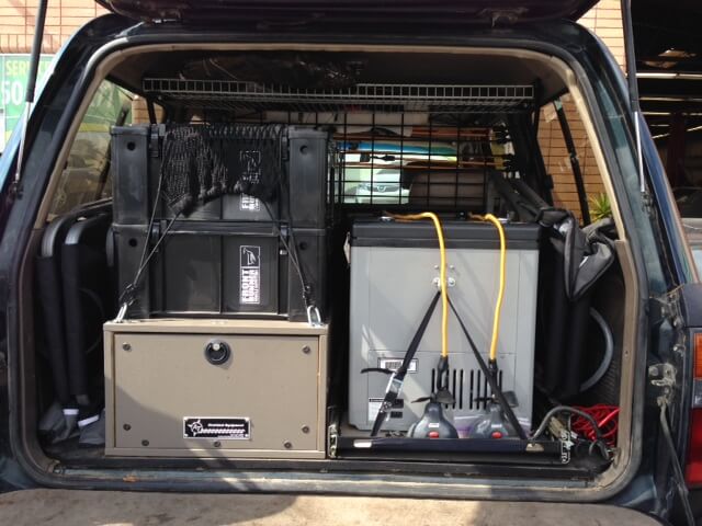

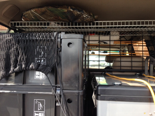

Here is my attic setup in the FZJ80: Used an old closet shelf and some scrap metal to build brackets... totally free project (Idea stolen from XTERRA Forum about a year ago).
Here is a closer shot as you can tell I just inverted an old closet shelf I had laying around. The grid on this is closer together which might come in handy for some. I know at the Home Depot they sell a 2 foot by 10 foot section or cut to fit by the foot. (I beleive mine is the 16 inch version. 2 foot would allow paper towels etc... to be hung/accessed from back hatch pretty easy. Maybe I will rip the 2 foot shelf out of my wife's closet :)
I also welded up some cheap/scrap steel brackets seen better here that fit over the cargo barrier mounts that came with Speski Cargo Barrier.
