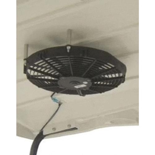

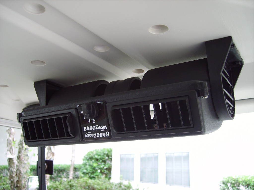

I have rear facing carseats in my truck, and a third row. It gets hot back there and the rear-facing car seats get no airflow. Summer is coming, and the Carolinas are oppressive once the humidity and heat unify to overthrow humanity.
In seeking to copy @jcardona1's attic setup it also seems opportune to install a forward facing fan (or two) in the center, and two rear facing fans for those children incarcerated in the third row. I want to control them (the fans) from the front seat (on/off; adjust speed), but also have local controls on the fans themselves.
Search has turned up nothing.
I've also searched for small fans that could work. Not much has come up. Now I turn to you, oh gurus of the mud.
Has anyone done something like this?
Who makes a good quality fan that could work? Perhaps 4 inch diameter?
@NLXTACY do you have a line on switches that could fit in the coin slots for controlling actuation and fan speed?
I'm a big fan of Caframo fans in 12v applications like this:
http://www.caframolifestylesolutions.com/product-types/fans/
I've used the ultimate in both sailboat and campers where I run them overnight while sleeping, and on hot days while stationary and underway/driving. I've also used brushless 12v computer type fans which have their benefits as well and come in a variety of sizes and amp draw/cfm/etc.
The caframo ultimate comes with a stationary mount as well as a suction cup mount and you can power it via a cig. outlet or direct wire. I've gone both routes and have also put magnets on the the base of a few to use in an older car with lots of exposed steel. One or two ultimates may be all that you need to cool the 3rd row and you could get by with suction cup mounting them on the rear windows for a while as you dial the setup in. The other caframo models with protection around the blades are also great options though in my tests don't move quite as much air.
I would check out 12v squirrel cage fans too, more cfm from a smaller footprint.

Also a fan of the Caframos. In the limited space back there, its only a matter of time before someone gets whacked, or the fan falls off and wrecks the blade hub. Under that circumstance, the rubber blades protect, and when the hub self destructs Caframo sells replacement blades. I've used one for 20 years on our boat. 2 blades and nothing else even shows wear.

A little ABS plastic to make a housing & one of these comes to mind:
Mayfair Bilge Blower Flange Mount
12v & squirrel cage, 112 CFM - add some sort of rheostat / dimmer & you have some air movement.
