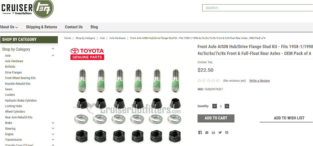

Wild, that is a first for us and an unfortunate first. We'd be happy to refund you for them. I see Bryce replied about a warranty, that is standard policy particularly in a rare circumstance like this. But as mentioned I'm more than happy to refund them and we'll work it out on our end. LMK
We have hundreds of the OEM kits here in stock so should you choose to go that route, I'd be happy to set you up with a couple of sets of these:
