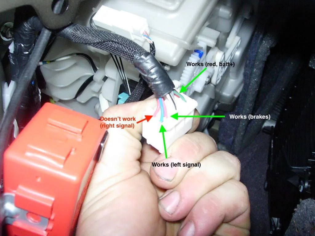

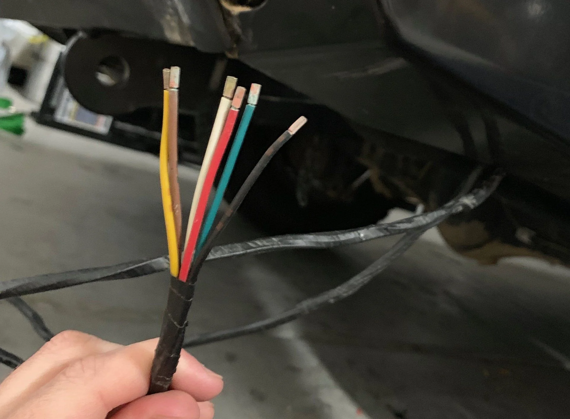

Took a crack at redoing the wiring for the ARB lights. Removed the splices from the trailer harness under the vehicle (where the trailer plugs into) and actually setting up the ARB wire harness how it was intended. Then, on the left side of the vehicle, clipped off the ARB harness connector and spliced into the wire harness just before the towing converter. I read through the instructions in the thread you posted, @Fisher23 (here), and noticed a few things:
  • when the signal light is spliced into that location it ticks a lot faster than stock (similar to when you hook up LEDs and it needs a relay to slow the light down)
  • the right signal doesn't work when attached to the wire indicated in the linked thread
  • brake lights and tail lights are the same brightness on the ARB lights (which is super bright, looks like the brakes are on constantly)
I haven't made final connections for these wires yet and I didn't splice into any other wires on the towing converter because I didn't want to break anything and I don't have a wiring diagram for my model year ('13).

Interesting. Based on what the tech told you, it seems like the harness needs to be spliced into a couple of different places then.
  1. on the left side into the towing converter, and
  2. under the truck into the trailer harness (where I had spliced before) with these wires:
It also seems like tapping into the green wire on the left tail light may not be necessary (as per the other thread) if the exposed wires (above) are there to control the running lights. Only having to tap into the left and right signal plus the stop light on the towing converter side would certainly make wiring up that side easier (it's a small space when the 3rd row is still installed).

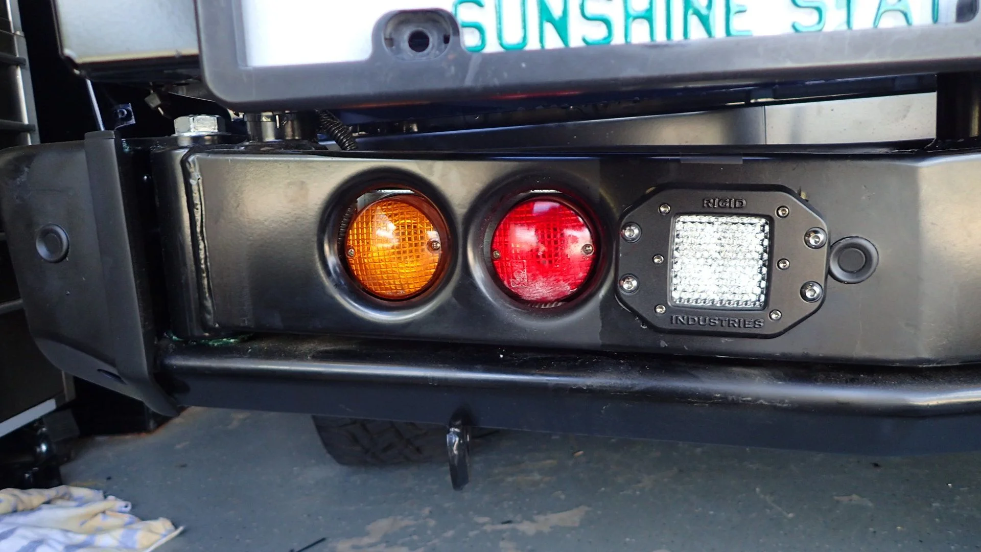

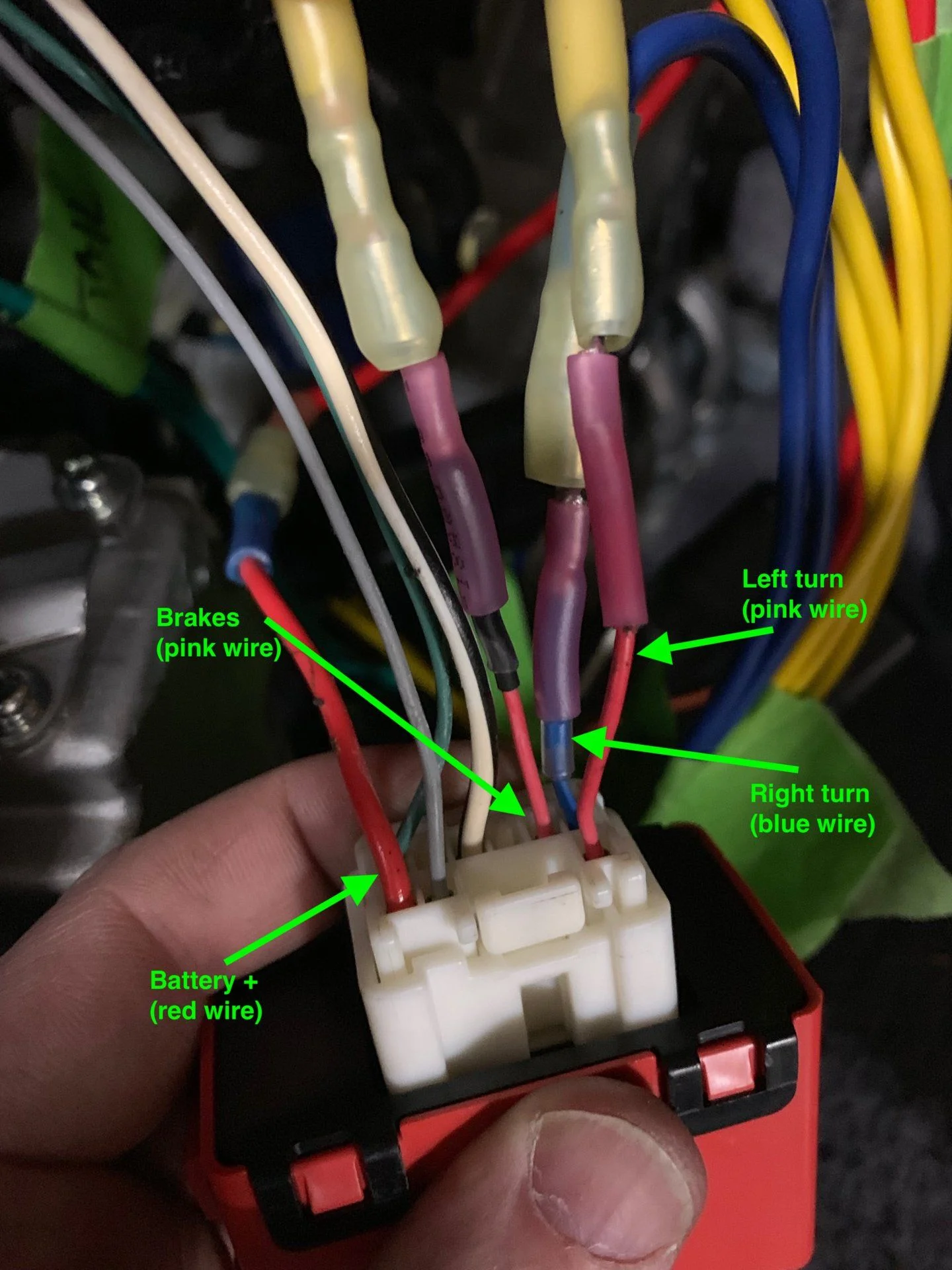

Spent the day working on the wiring for this bumper; I was determined to figure it out and get it done. It took a bunch of different tries and as soon as I thought I had it figured out, something wacky would happen (e.g., amber light would randomly come on with the brakes, but only one of them). What I realized, is that the wires I'd soldered back onto the ARB wire loom weren't covered with heat shrink yet. The heat shrink was on the wire, but not covering the soldered part; I was getting all kinds of mixed signals because they were all in a bundle and touching each other :doh:
So, I moved the heat shrink in place and everything started working correctly. I'd tapped into the trailer harness when I realized my issue because I thought I'd at least get it back to what was working before. Then, one-by-one I switched to using the wires on the left side of the truck by the towing converter. It all came up roses then.
Here's what I tapped into:
For the tail lights, I tapped into the green wire on the left tail light as noted in this thread. Once I had all that hooked up all the lights worked perfectly; signal lights were flashing at the correct speed, tail lights were lit but not super bright, and hitting the brakes brightened up the tail lights (no amber lights turned on with the brakes anymore).
Went back to the trailer harness and removed all the connections from the ARB harness to the factory wiring, patched up what needed it, and tested the trailer harness to make sure everything was good (it is).
Oh, and the reason the one signal was going faster than the other? I didn't hook the harness back up to the left tail light. As soon as I did that the signal worked at normal speed. Total blonde moment.
So glad to have this done. Thanks everyone for the helpful comments and suggestions (even when it was my own stupidity causing an issue ;)
