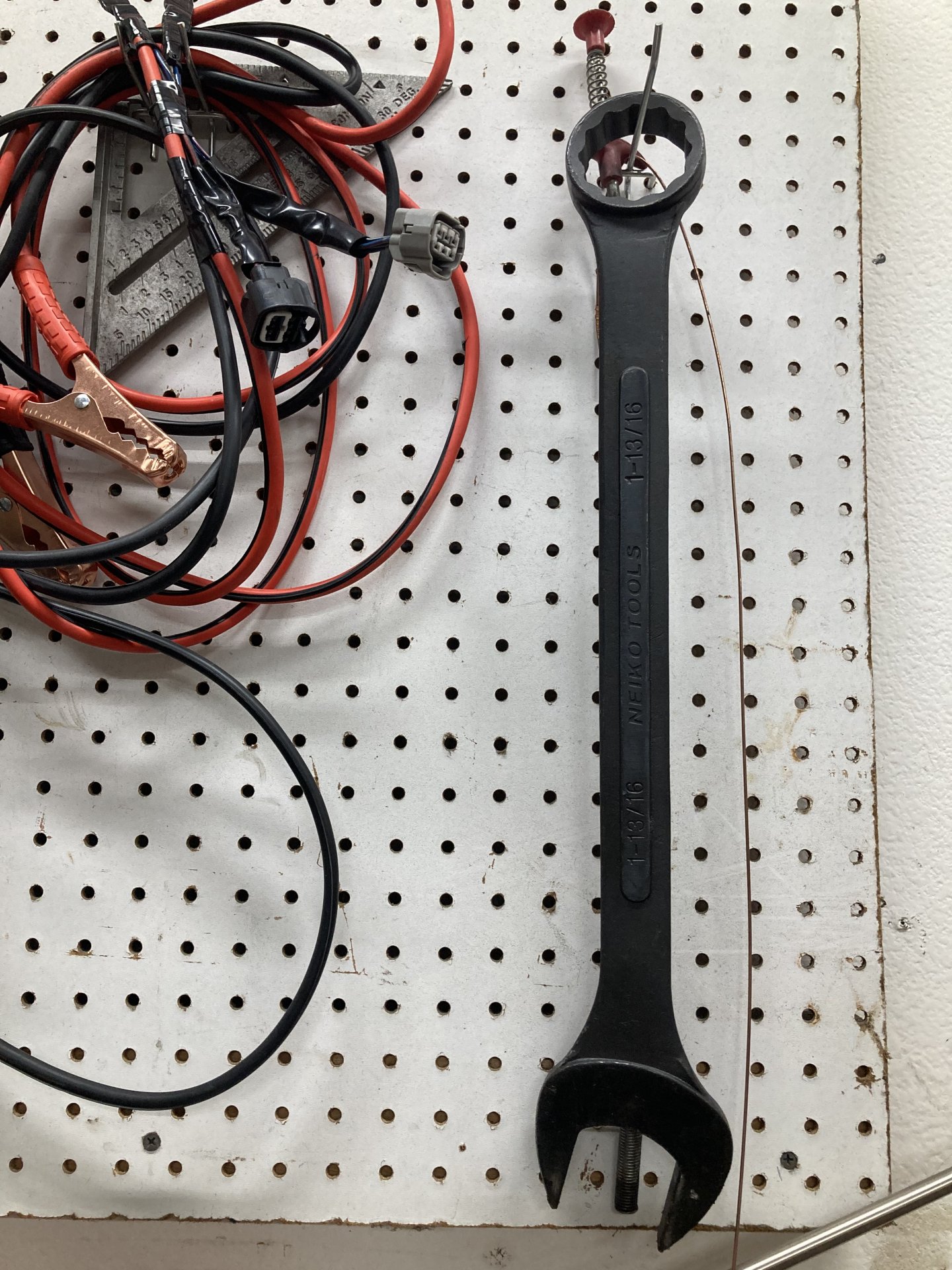

Large flat head screwdriver as a pry bar on the flex plate teeth through your missing inspection cover on the bottom of the bellhousing works well.
Depending on how tight your engine compression is it might be worth pulling the spark plugs, but these engines usually turn over by hand pretty easily.
Alternatively, if you have one you should be able to snake a 1-13/16th / 46mm wrench onto the crank pulley nut.
