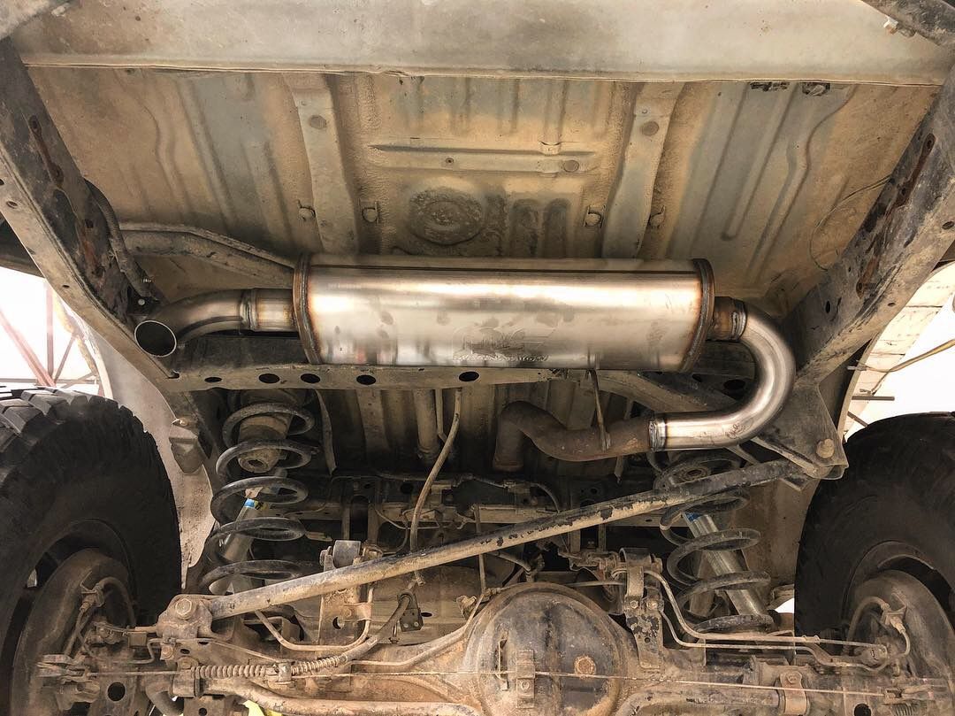

Something like that

That's pretty slick :)

I have my turndown just behind the p/s rear wheel and terminates just before where the 4x4 labs bumper armor begins. Similar to @NV1971FJ40 . It looks like you would need maybe a 4-6" extension to get it to the same location as mine, but hard to tell. No issues for a few years now.

As for your exhaust, just get some pipe and weld it to your end and turn it off like @inkpot did, similar to my solution after i chopped resonator off.
Me too; works well; sounds fine to my ear.

I’ve been running the EMS above the framerail exit since when ever that system came out. It’s basically a turndown. Wouldn’t do it any other way. I don’t get any exhaust smell but it is definitely louder than a traditional tailpipe. I had one on my 60 as well right behind the axle pointed straight down. I got exhaust smell from that one. So I’d just say make sure it’s angled at a 45° towards the back and it should be good based on my experience.
