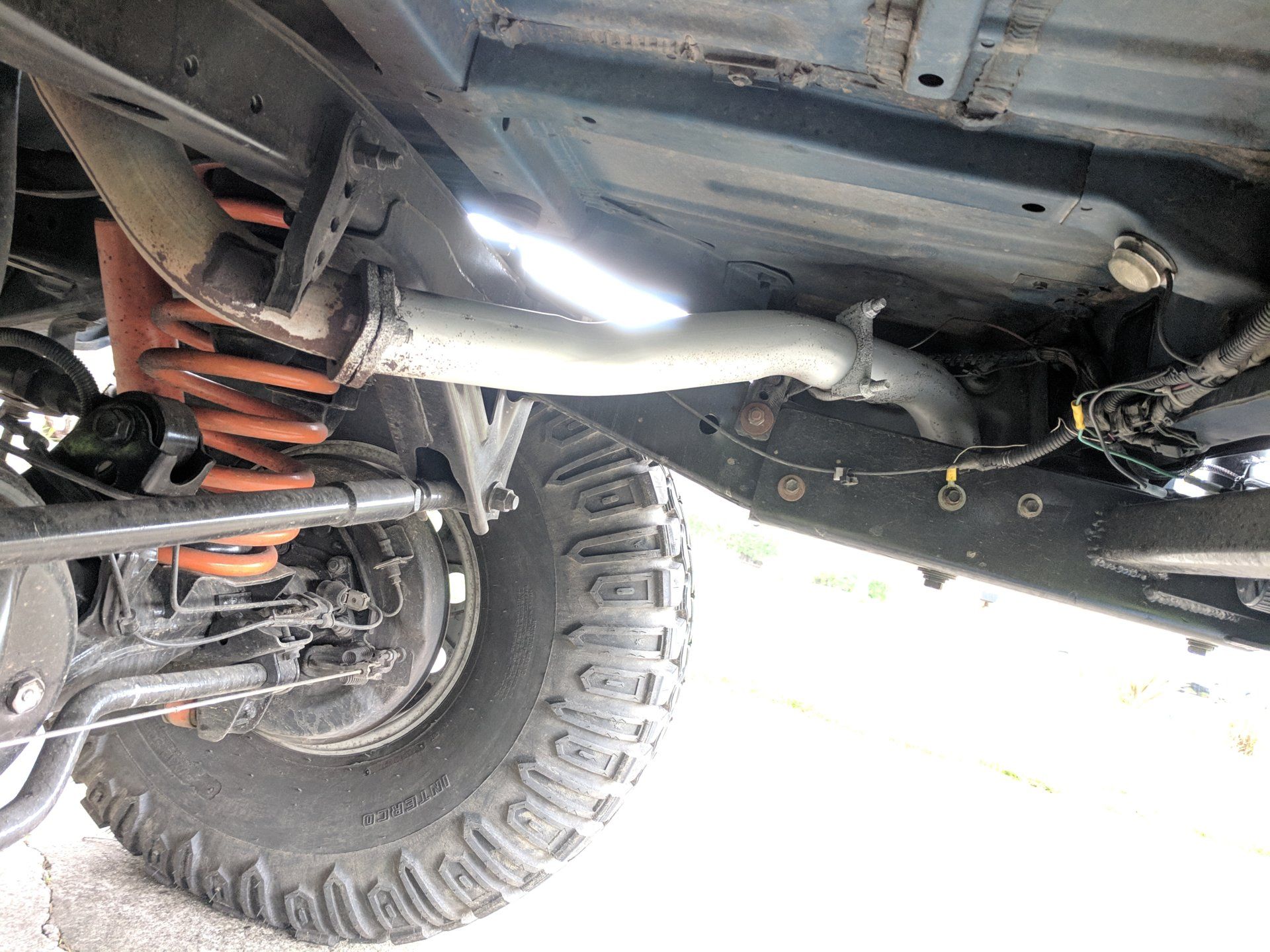

Not the best pics, but I added an additional hanger and slightly turned down tip. No droning and it runs along the frame rail, so it can be scraped, but not crushed.
When I built my labs bumper I cut a hole in the plate behind the passenger tire. I rerouted the exhaust over the rear frame rail to exit through the bumper.
Well protected, no fumes, no drone, no excess heat.
