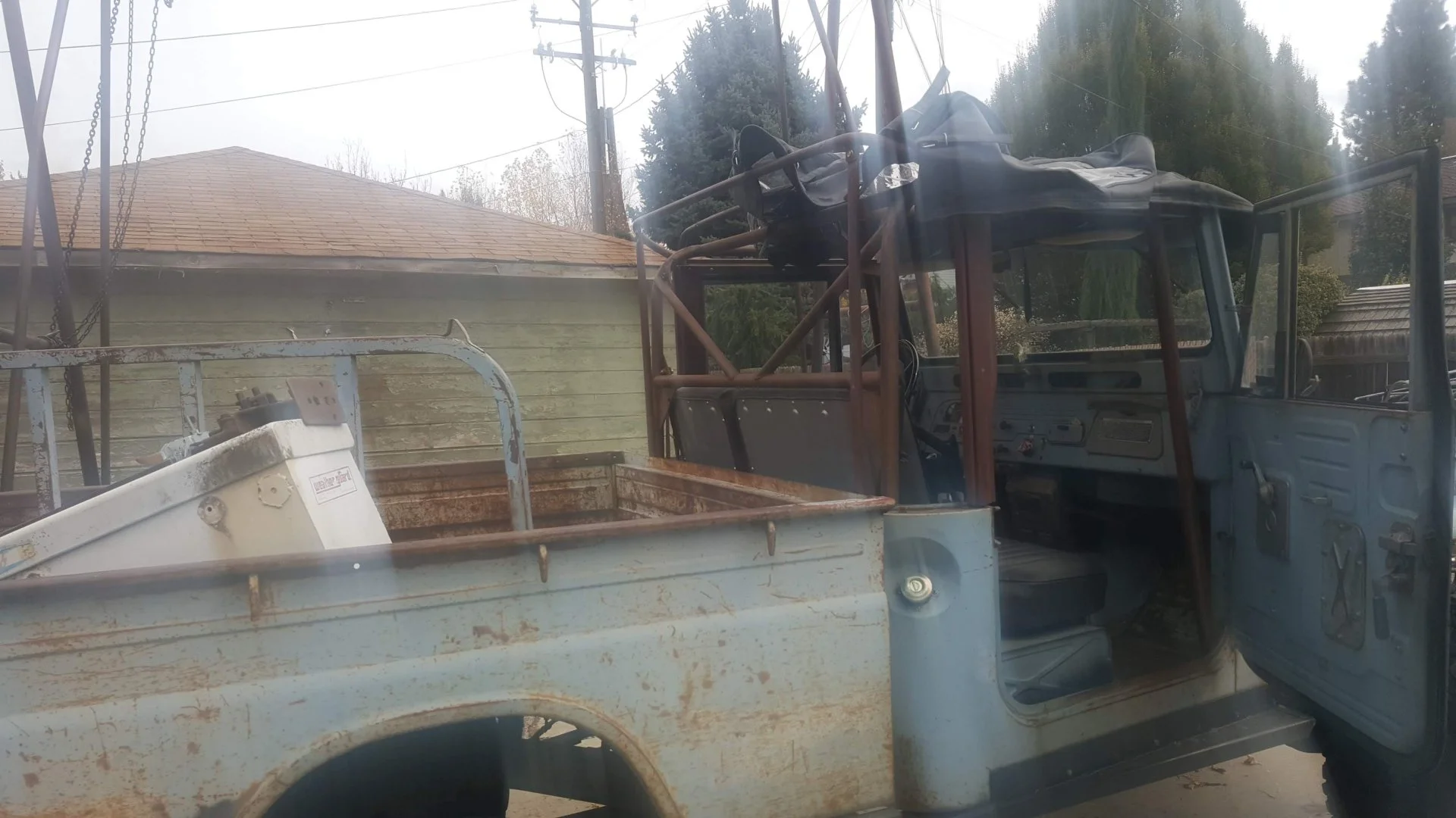

This is a stretched 45 cab with soft top. You'll have to search through the thread to find soft top details. All custom work.

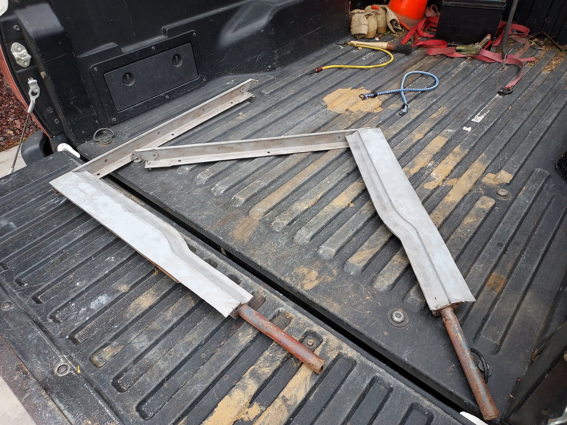

I've got an Eshan top and bows that I acquired from IDave a few years ago. Started to put it on about 2019-ish, but need to pull the bed off to install footman loops and never got around to doing that.
If you want to come by to take a look at it, I could pull it out of the basement.
Took a few pics of the partial install.
Ewheeler, thanks that is a big help. I maybe able to engineer what I have to mimic what you show in the pictures. Thanks
Owyhee Jackass that tubing looks pretty heavy of a tube, pretty stout.
