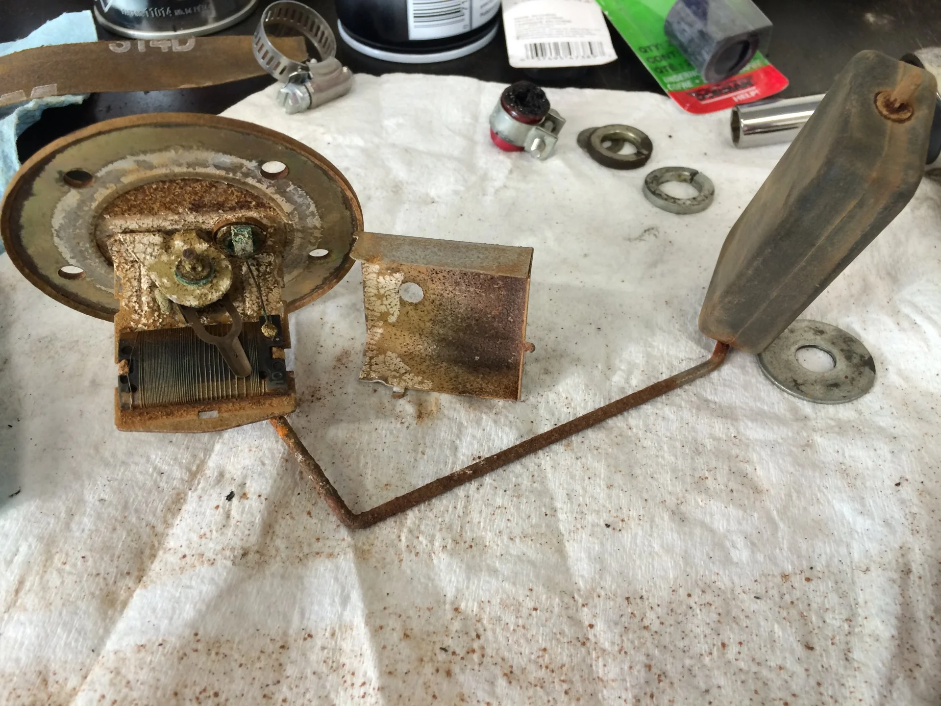

I am wondering if anyone has opened up their fuel level sender?
I have one that reads fine, and another that reads maybe ~1/4 low when the tank is full. Wondering if there is any fix for that?

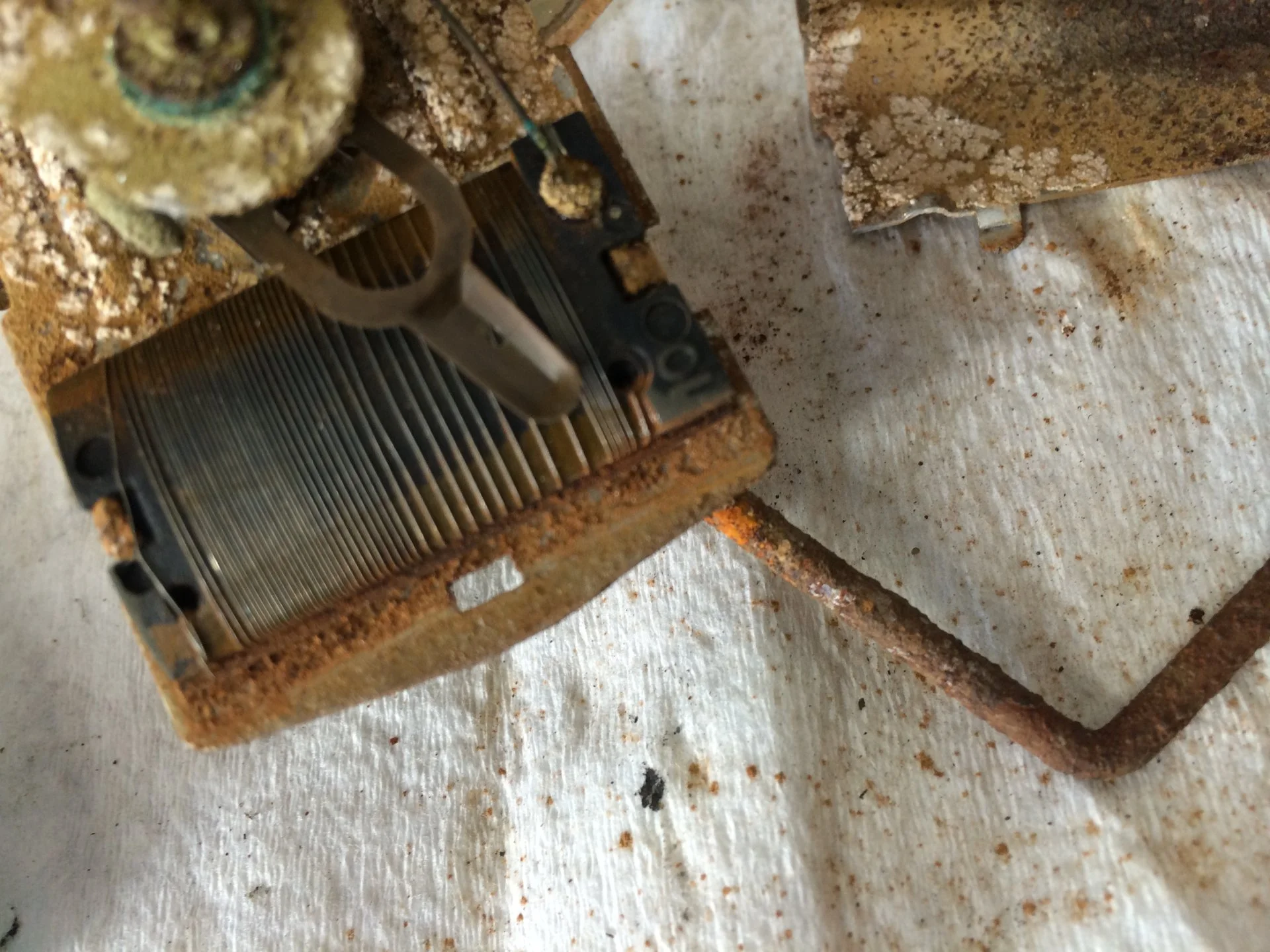

I did. It is very basic and if the fuel system got a lot of rust in it that will bridge between the wire wraps on the sender. Also, the wiper will eventually get a wear spot in it and wear through making for an inaccurate reading. That’s what happened to mine…
Yup
Wear spot:
