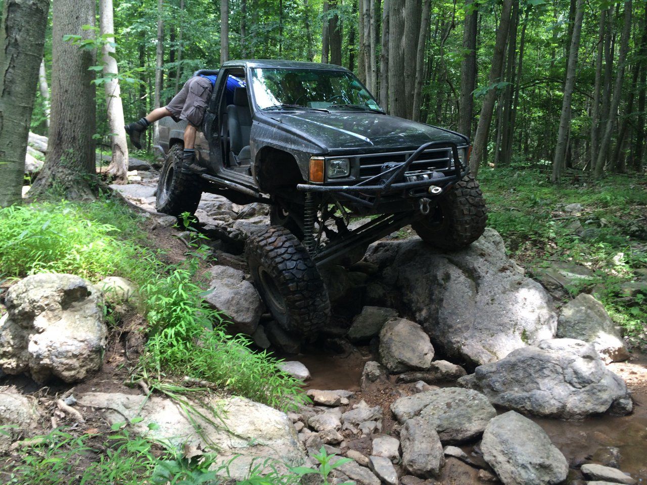

The anti rock will help with body roll under articulation. I think mace is right,in theory the only time a sway bar would help is when the suspension articulates the anti rock will "pull" the body level.
Though I have to say with my truck (3 link and coilovers) the anti rock has completely fixed the body roll under articulation, however I really notice it in off camber situations, probably because with my suspension the axles have enough movement to flex to adapt to the off camber and when that happens the away control corrects the body roll.
So why wouldn't it help under a leaf sprung application ?
I'm just thinking out loud here, if the axle was at a 10 degree angle off camber, wouldn't the anti rock pull the body back to level with leaf springs ?
I guess the short answer is if the suspension articulates it will help, but I suppose with leaf springs the axle doesn't have the ability to articulate as much and conform to the obstacle then if won't.

My (maybe unrealistic) goal: I want to control the amount that the body and frame roll/tilt away from being parallel with the least off camber axle in "side tilt/off camber situations. In these situations the uphill springs unload and the down hill springs compress - I have fairly flexy springs. This shifts the center of gravity in a way that exacerbates the situation.
Mark, are you ever articulated to your bumpstops?
The only way I can see this helping is in the middle of suspension travel. Let's say that your DS is on the bumpstop and your PS is at full droop. Your swaybar has no suspension to work with and won't do anything.
Another situation is when you're driving on an off-camber trail and the suspension is somewhat level. The swaybar isn't going to help in that scenario either.

I think part of the reason why sways work so well with @dubsb 's truck is because he has so much suspension to work with.
