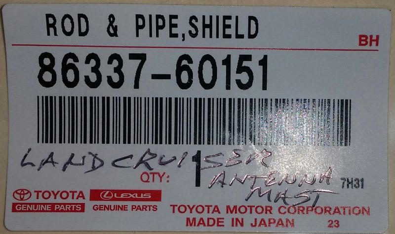

My mast snagged a tree branch last week and snapped off when backing into the driveway. The reviews on Amazon and the ebay aftermarket replacements seemed sketchy so I bought an OEM Toyota mast from ebay seller JP-Genuine for $32, Toyota p/n 86337-60151, "Rod & Pipe, Shield".
As per earlier posts, remove the mast base nut. I used angled snap ring pliers to engage the external recesses in the nut. Then turn the radio on and drive the old nylon geared "tape" section all the way up and pull the rest of it out by hand. The new mast installs with the gear teeth facing the front of the vehicle. Feed the new geared tape down as far as it will go. With the radio still on, you can reach in with the passenger door open and press the antenna down button and controllably feed the new mast in, and stop just before the plastic base of the mast enters the hole and engage it by hand. Power the new mast down as far as it will go until it stops and install the nut. With the radio on, I found the new mast would stay extended about 8" when the down button reached the end of its travel. When I turned the radio off, the tip of the new mast now retracts fully flush with the fender. I cycled it a few times and it seems to work as good as new.
