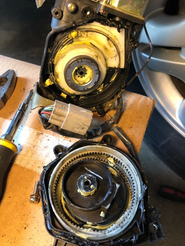

Hey guys, has anyone gave this mast a try? Need to replace mine and can't decide what to go with. I can hear my motor running but the antenna will not go up or down, so I'm guess the there's a piece that broke off in the motor. I refuse to pay $90 from Lexus. *98 LX*
I ordered this mast from The Antenna Source for a little over $20 + free shipping. Installed it today. Many thanks to those on this thread especially @Ohashimi for his video. Quality of this particular mast seems very good for those who are in search of one. Putting it in was super easy after getting the old broken nylon gear "cable" out of the motor. Teeth toward the front of the car as the motor pulls the new cable down in. Goes up and down fully with no issue. I did put some teflon dry lube on the mast itself in hopes of reducing wear. Just left the old grease in the motor itself, seemed like there was plenty.

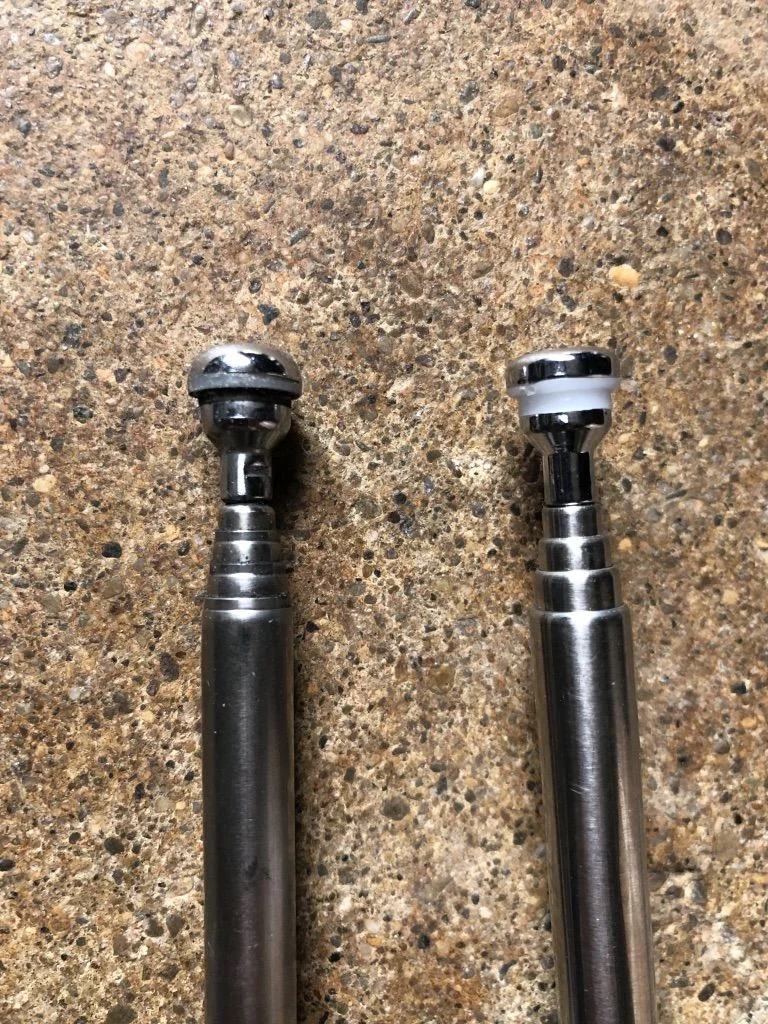

Old left, new right. They both have their own shape of rubber grommet they fit into, so the slight shape difference doesn't matter:
