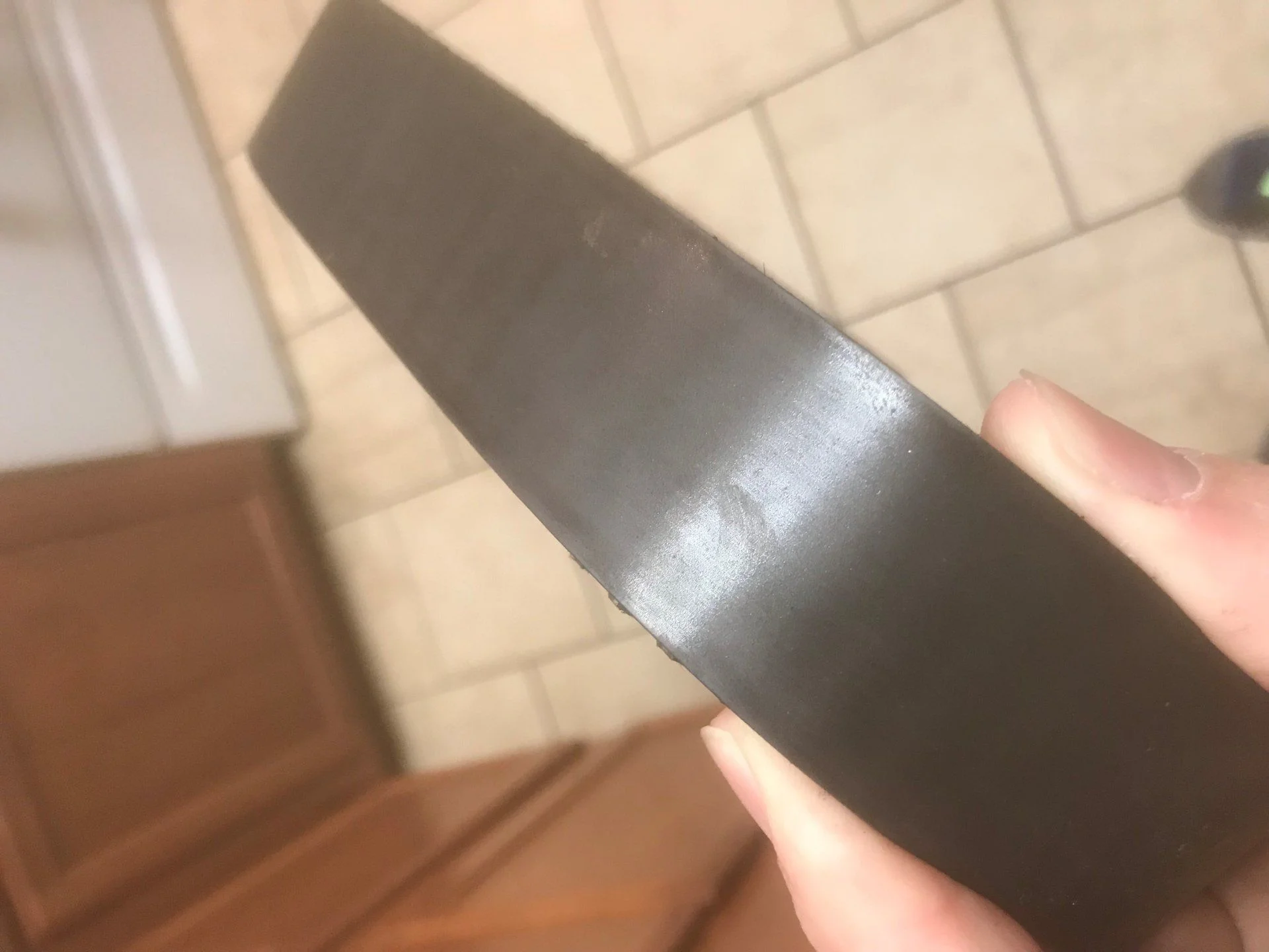

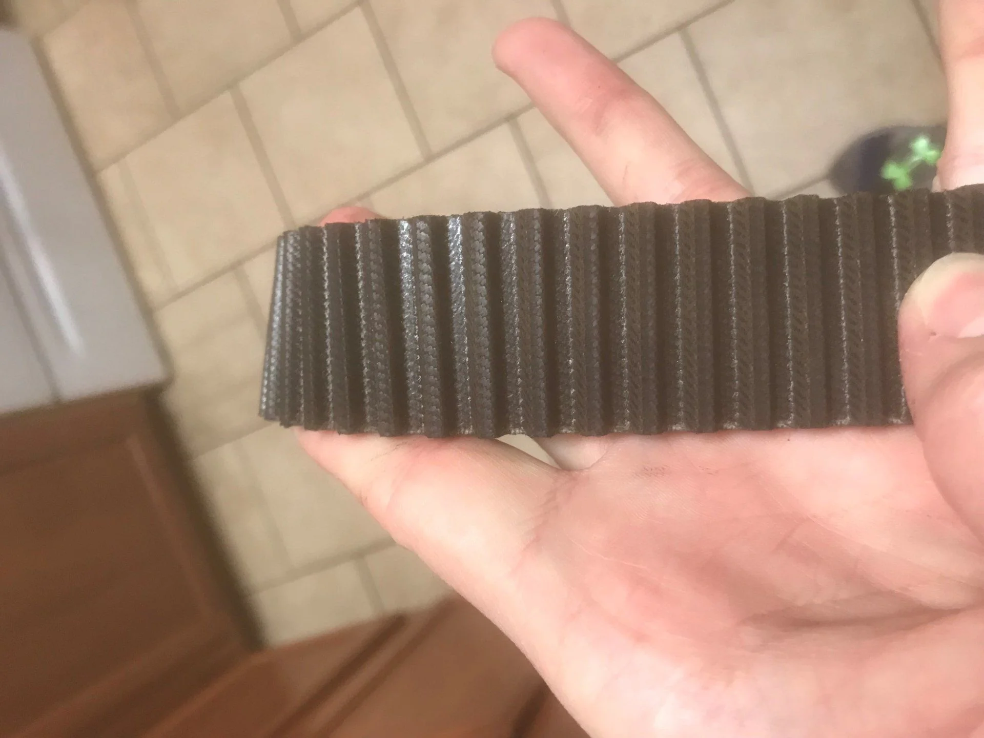

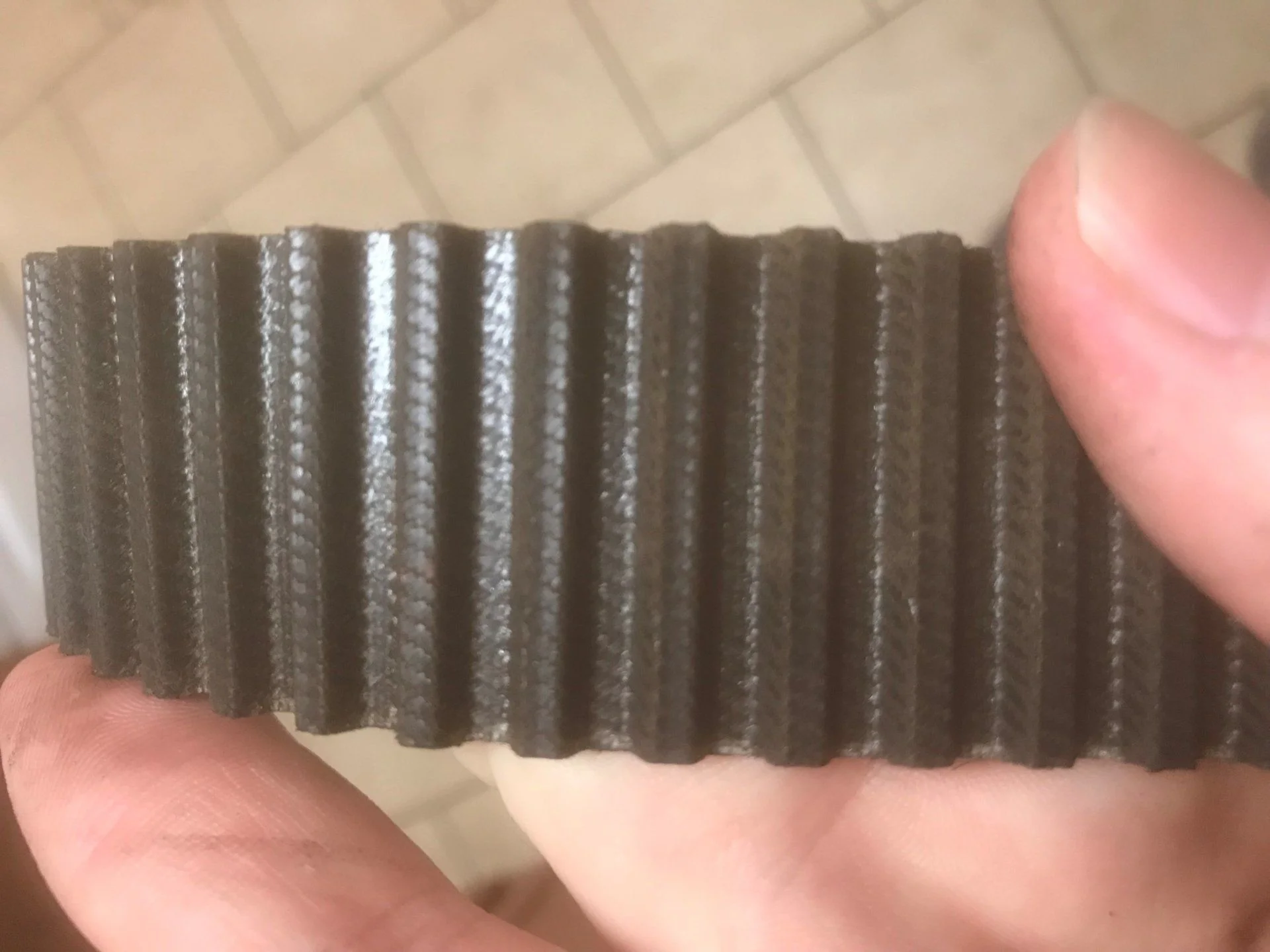

I got the crank seal, timing belt and water pump replaced at a Toyota Dealership today. Got away with $1100. These pics are of my old timing belt @ 111,000 miles. It almost looks as if it was replaced before... still glad I got it replaced, better safe than sorry.
