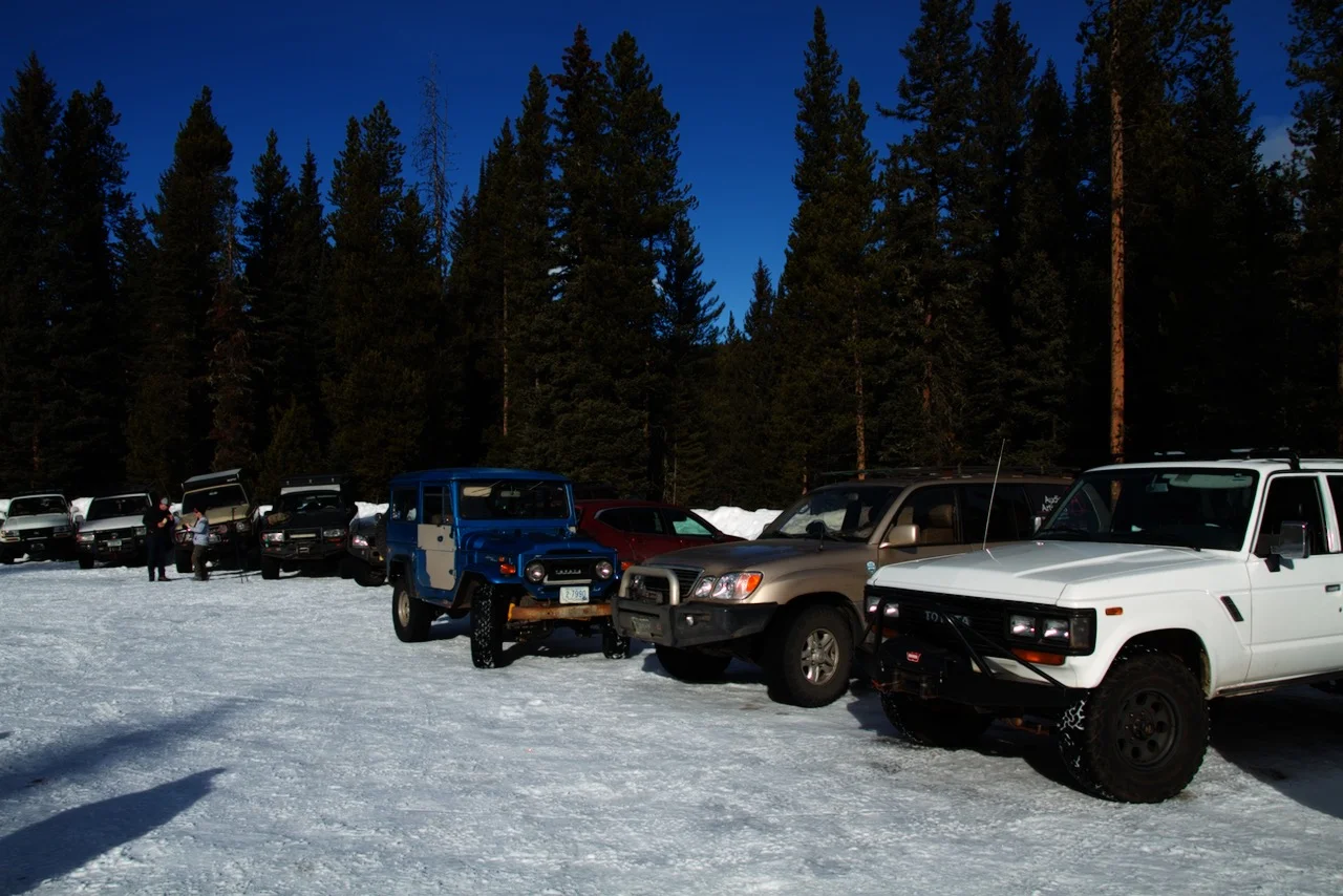

In mid-January I went and hung out with the local Cruiser club. Turnout was pretty good with 19 rigs present and examples from every series except 55.

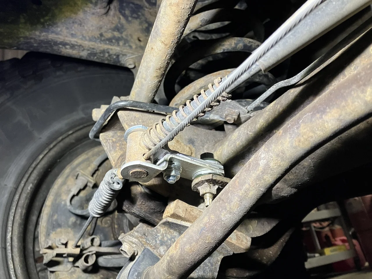

Next I installed a new emergency brake equalizer; the original pivot bolt broke off when I had to remove it to work on the rear axle a while ago. I retapped the threads in the bracket on the axle and put on a new pivot bolt, bushings, and equalizer brackets. The handbrake feels much better now.

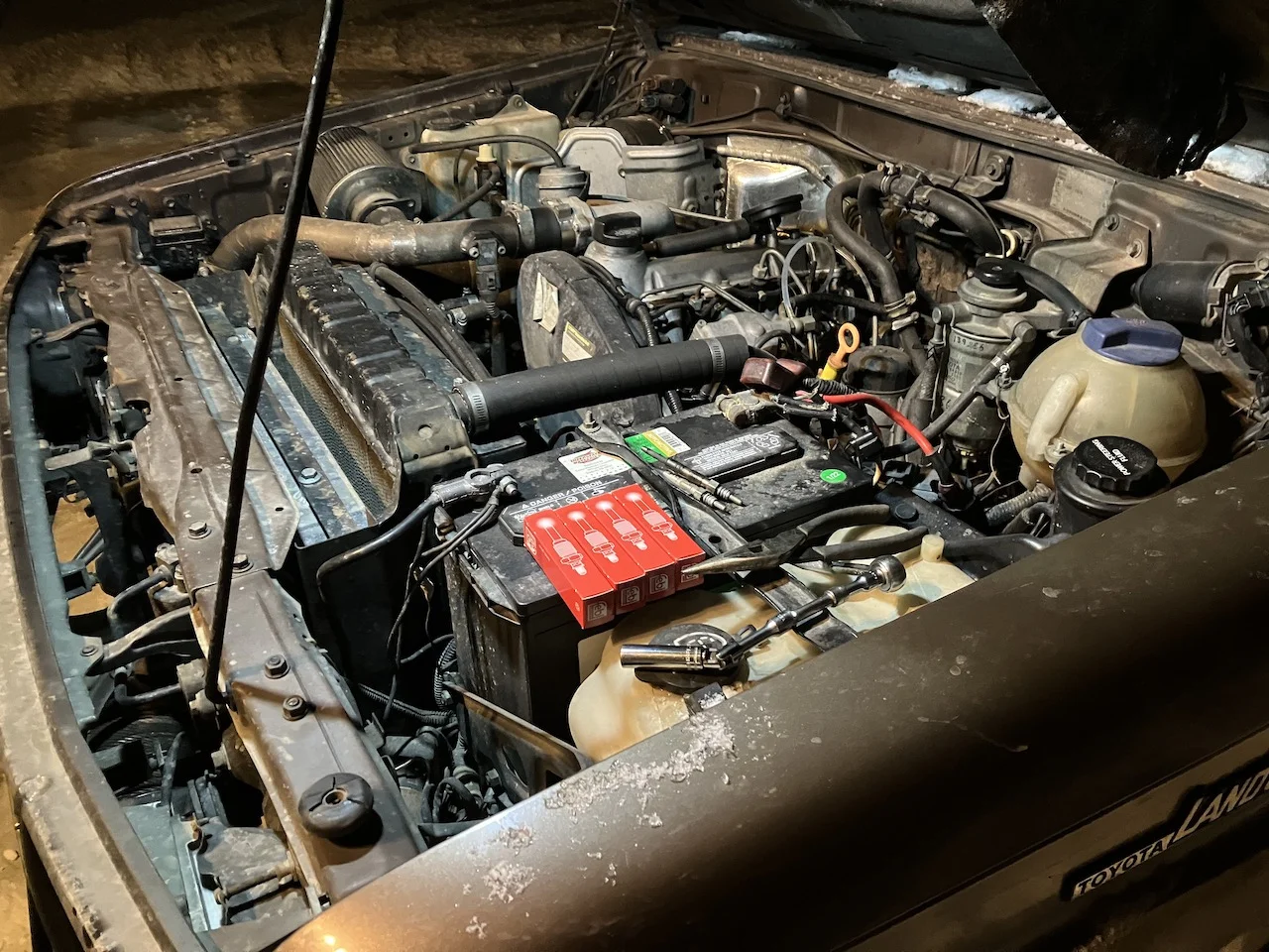

New glow plugs arrived in the mail today, and with sub-zero temperatures predicted for this week I lost no time getting them installed. It was a fairly quick job, but by the end of it my fingers were starting to get stiff in the 10ºF weather. #4 plug was a little stubborn but with some penetrating oil and patience it came out fine. Really hoping the new glow plugs make a difference in the cold.
Planning on getting a 1.8kW "cold weather" starter from a 4Runner this coming weekend to try out; with fresh glow plugs and faster cranking I should be getting similar cold starting performance to a stock TDI.

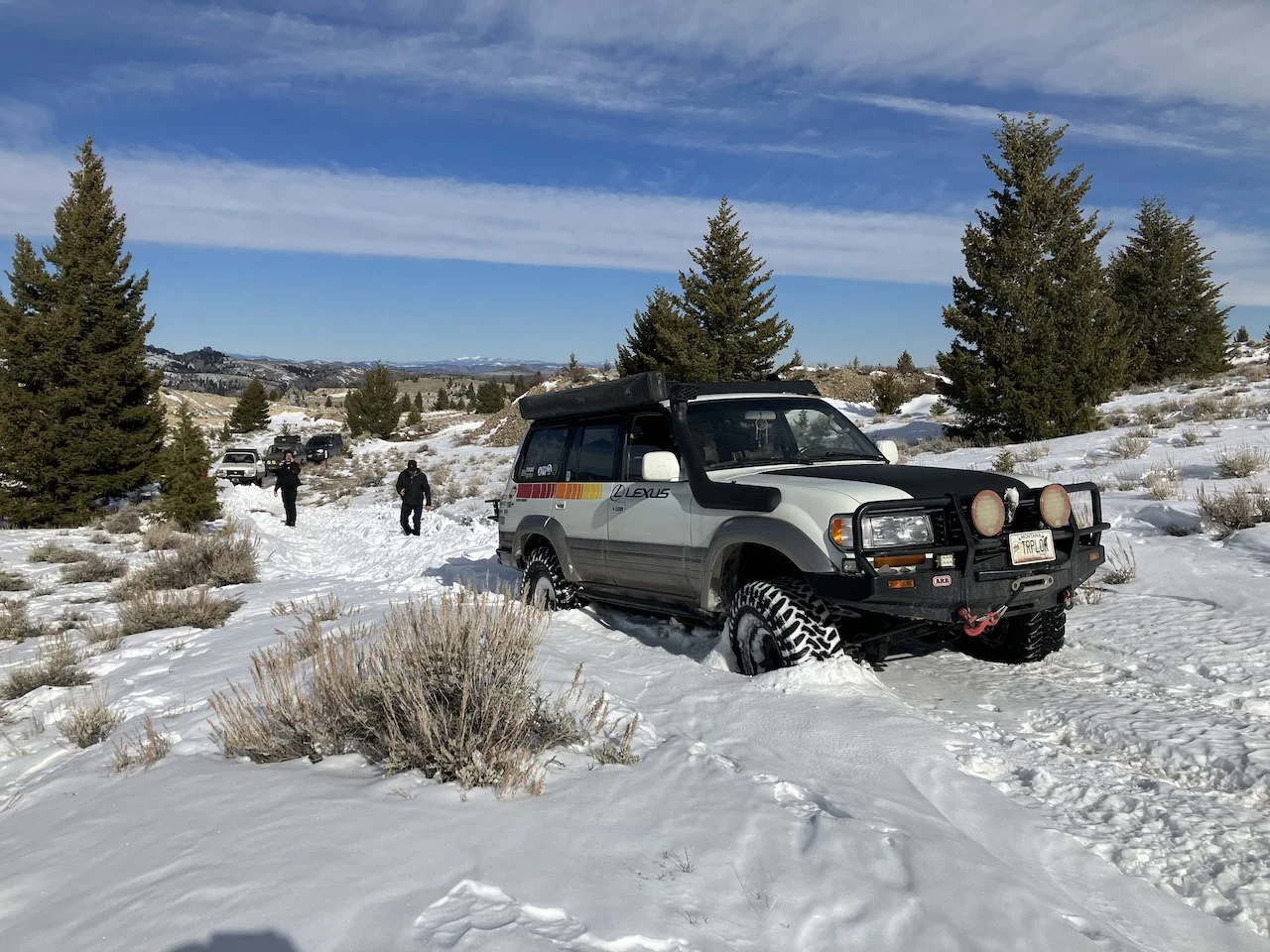

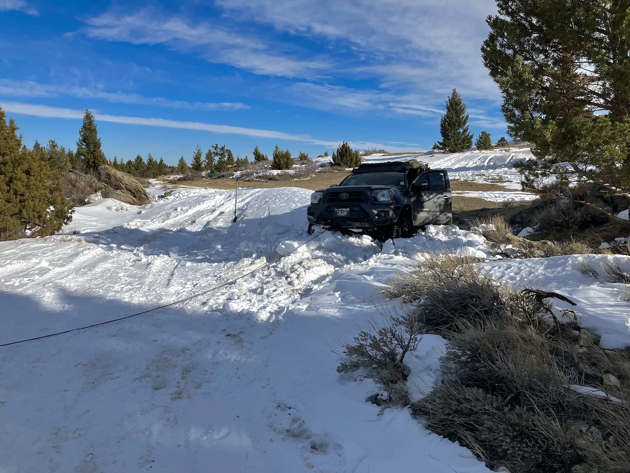

Went snow wheeling last weekend with @ttFJC, @CCRider and @MTsoul. (Thanks for the photos!) Had a great time and got lots of practice with kinetic recovery and winching ;).
During one of the winching sessions my winch started leaking fluid, and then stalling under moderate load and not spooling out when under tension. I'm pretty sure I'm the only person who has ever used this winch, so it hasn't had much use at all but I think that seals and gaskets are probably just aging out. The plan is for a light refresh of all the seals and gaskets, as well as replacing the main positive stud and associated hardware. Thanks to @Rigster for a lead on parts for that, I have a parts request in to Dave @Japan4X4.
