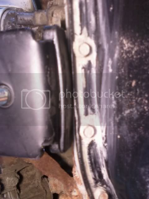

I got a 1FZ mount the other day and finally had time to fit it up to the engine. It looks promising. The one issue I ran into was the oil pan flange and gasket seem to stick out a smidge too far for the insulator to snug up. I am debating taking a very small amount of material to clear the pan. But I also plan on pulling the mount between the block in the insulator to make sure. I need to check the other side, which sits up higher on the block, but I still need to get the engine up on a rack just to see.
