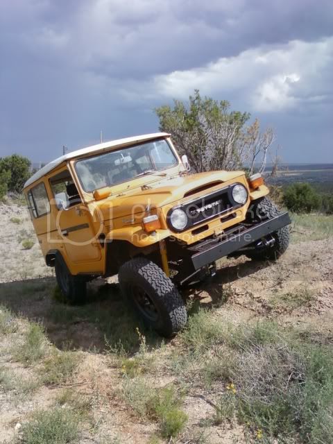

A picture of where the new engine is going.
