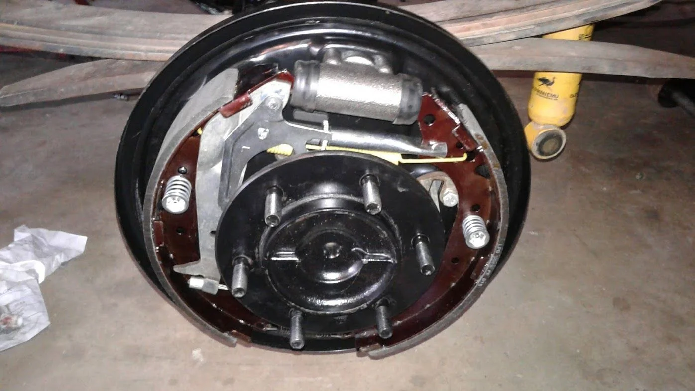

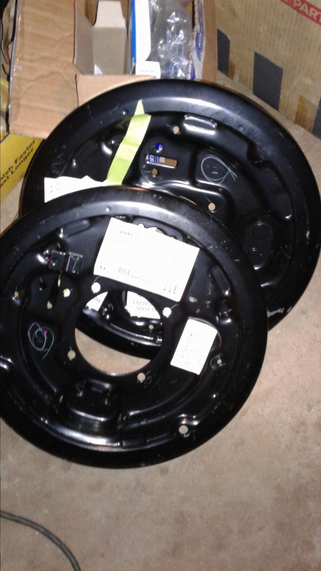

Most parts are here - still waiting on wheel bearings. New backing plates and all new brake parts including ebrake bell cranks and wheel cylinders.

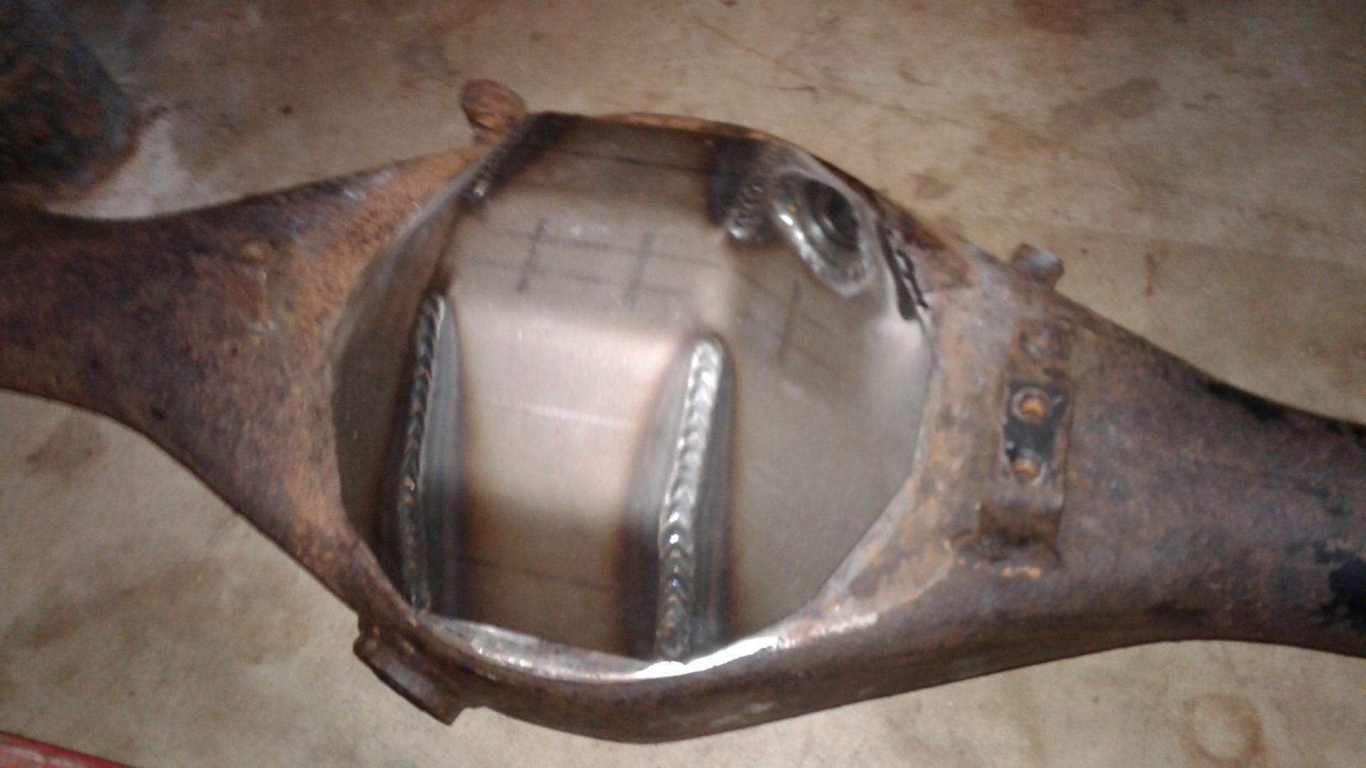

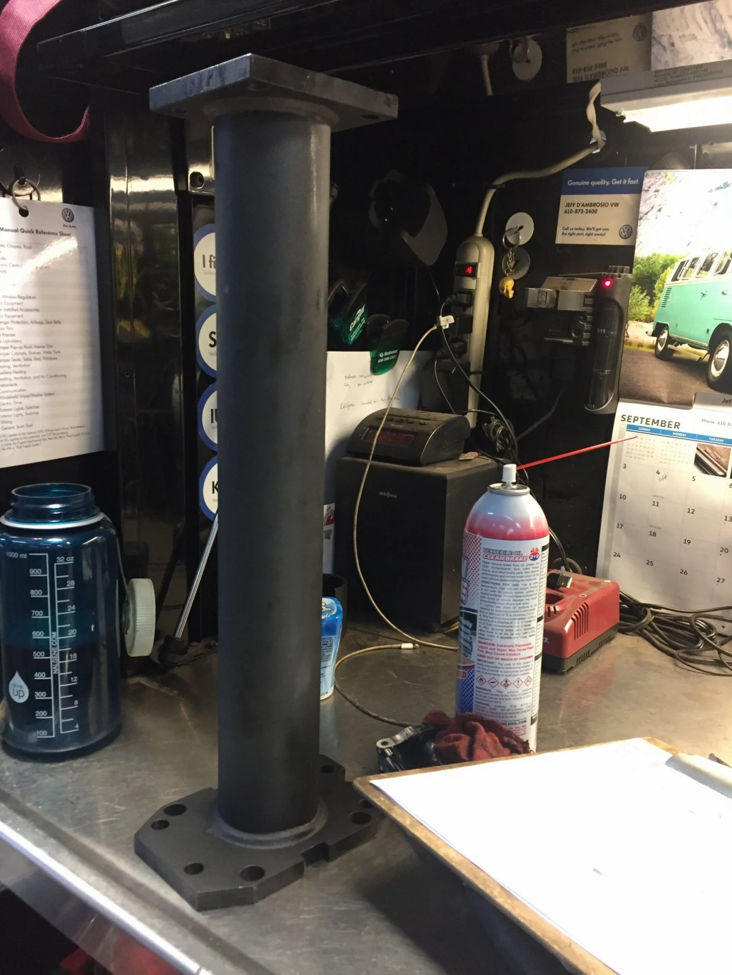

The diff cover is here and tacked in place. I don't trust my welding skills enough to make it leak-proof. I had to grind a bunch out of the inside because it hit the back of the diff at 2 bolts on the sides.

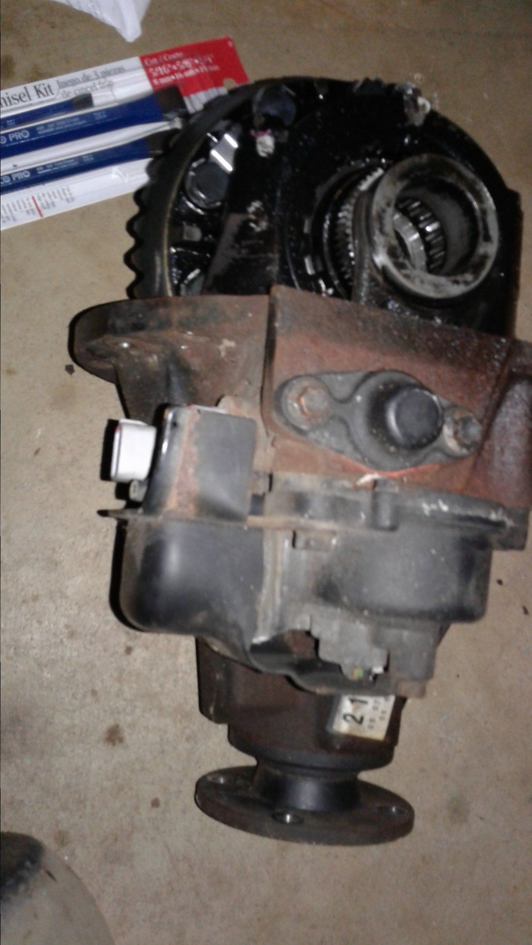

Found this elocker diff on Craigslist for free! It was replaced because of a bearing noise. Going to use the motor from this one as mine is.pretty crusty.

It is welded now. Going to try to leak test it today to be sure. Took it to my "Amish weld shop" yesterday. They did ok I think.
Remember to take it to 1.5 times its mawp. Specs call out any other ndt on it, ut or pt?
Your pressure gauge have a current calibration date? Manufacturer of the cover provide an mtr for the steel? I dont see a heat number or po number on it, thats going to make traceability an issue.going to need a copy of the welders wqr as well.

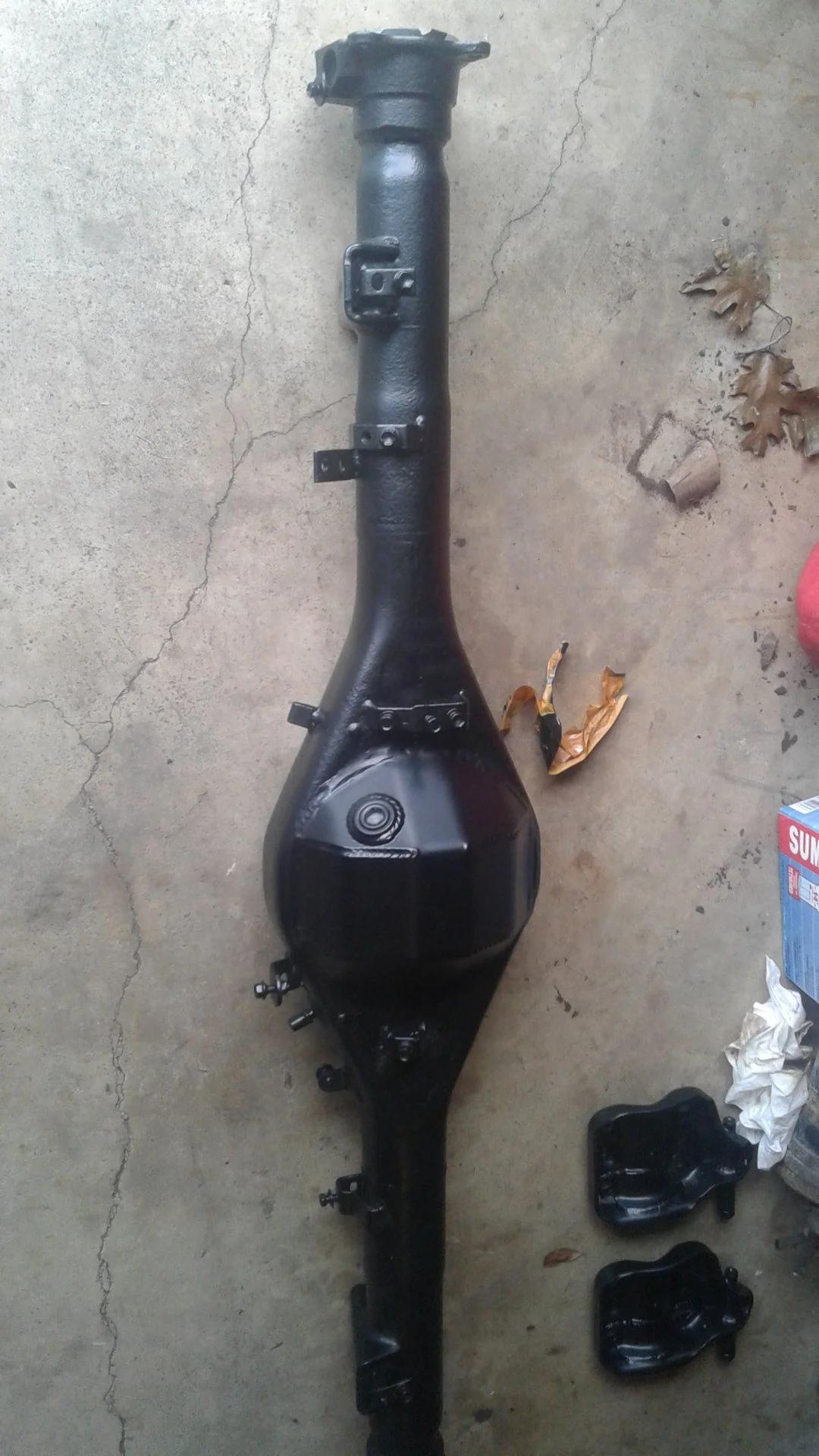

That is for sand blast AND powder coat. They do a good job - this thing is a little pitted because of the rust but that isn't their fault!

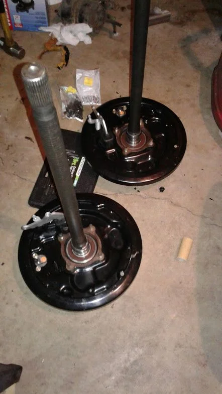

Thanks again to Blair for lending me the press fixture! It worked like a champ.

I need to cut off the ubolts and wire up the locker. I know the locker works fine as it was engaged when I took it for a test drive! I had to pull the motor and unlock it manually.
I didn't do a ubolt flip as one of the brackets I bought from Ruff Stuff was bad. I opted to just take the housing for sand blast and powder coat without the shock mounts.
No one but me will ever see it, but it makes me feel good to know it is all fresh and not rusty!
Shafts pressed on
Spiffy new brake parts
The final product
