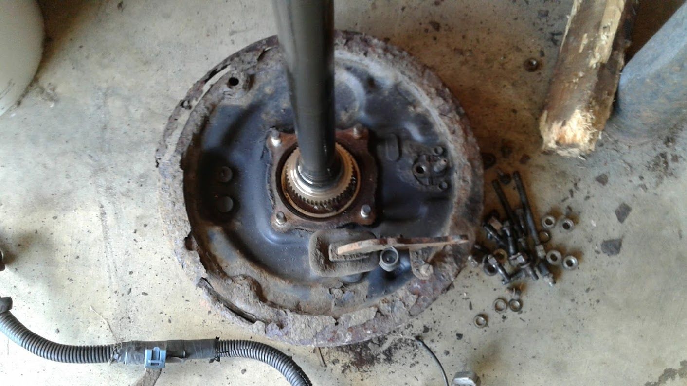

Also finally pulled the e-locker axle from the 2001 truck I bought. I will be putting it into the '96. It is pretty crusty - going to tear it down and have the housing sand blasted and powder coated.
The backing plates are shot (rust) - need to replace them soon.
It almost makes me sad to replace my pristine still-black axle with this crusty thing!
My thoughts exactly. After the reading I have done on this, I am none too anxious to tackle it! Seems that many have had issues getting the inner axle seal to seat correctly.
My plan for now is just to do the housing and put it under there to get it back on the road and then do the bearings and backing plates this winter....

This axle is a train wreck!! It makes me sad - my old axle still had the paint on the rust-free backing plates. Well, here's to progress!
