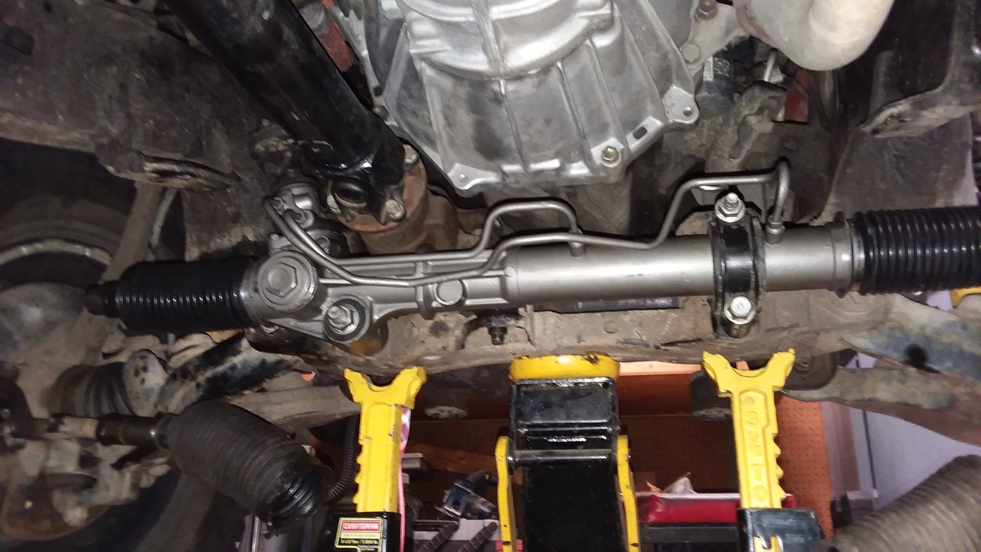

New steering rack - old one leaked and kept destroying inner rod ends. The last straw was a clicking noise the last few months.
Did you source a factory unit or aftermarket? and if aftermarket who did you go with?
Also looks like the old style rack, I will be doing this to my 4Runner, something to consider down the road.
It is a rebuilt factory rack from Rack Doctor. Tacomaworld has had mixed experiences with them, but It looked to me like they were more positive than negative....
Yes, it has the old style guide. I have the updated parts from my old rack to change it, but I don't want to void the warranty just yet!

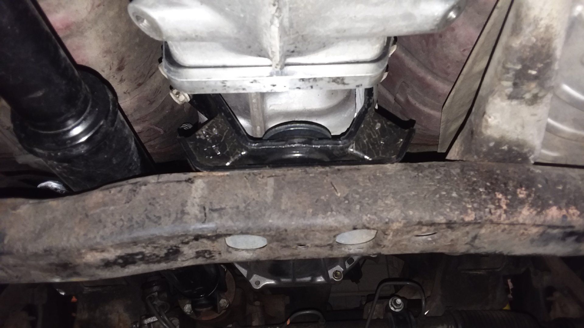

Also installed a new Toyota transmission mount

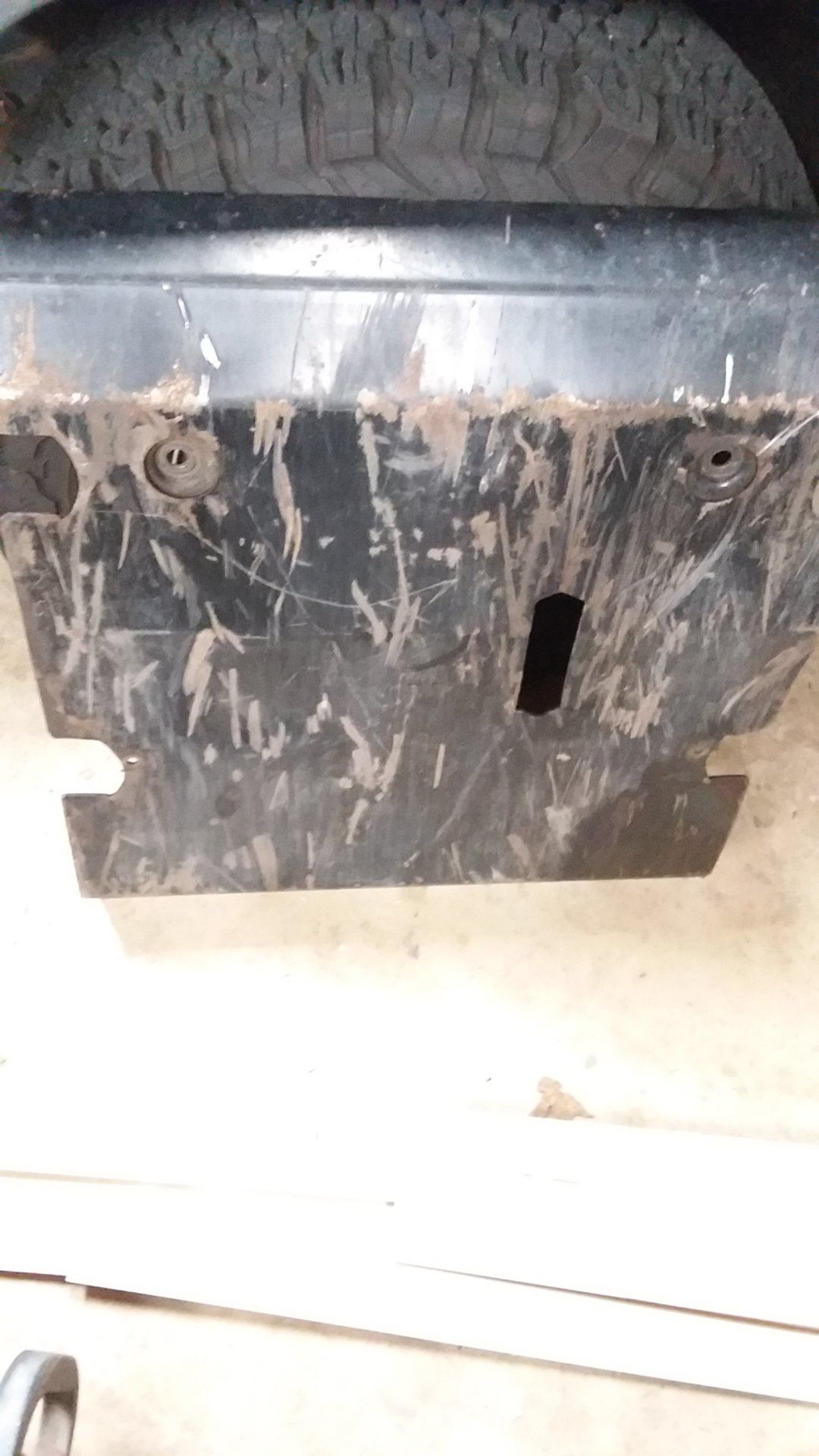

My skid plate is holding up pretty good!

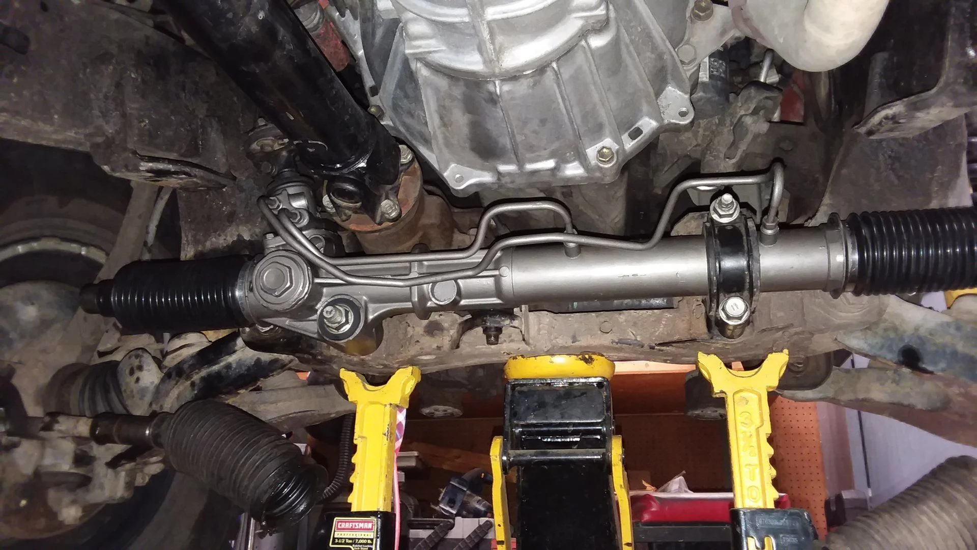

Was just reading back and noticed you had already replaced the guides in your old steering rack... Did that improve things? Is this just part of Taco ownership?
I think this is more a part of me catching up with the maintenance on a vehicle with nearly 300k miles! While it is not as robust as a steering box, I don't believe it is a chronic issue with the Taco...
While swapping in the updated guide did improve things, I believe the rack itself was just too far gone. I've replaced inner tie rods 3 times since buying the truck and only have around 10k miles on it! PS fluid was leaking into the rack boot and washing the grease out of the inner joint.
I am hoping it was just because the old rack had a LOT of miles and crossing my fingers that a new one will last me at least a few years without issue.
Once I get a few miles on this one and know it is not defective I will probably swap in my updated guide.

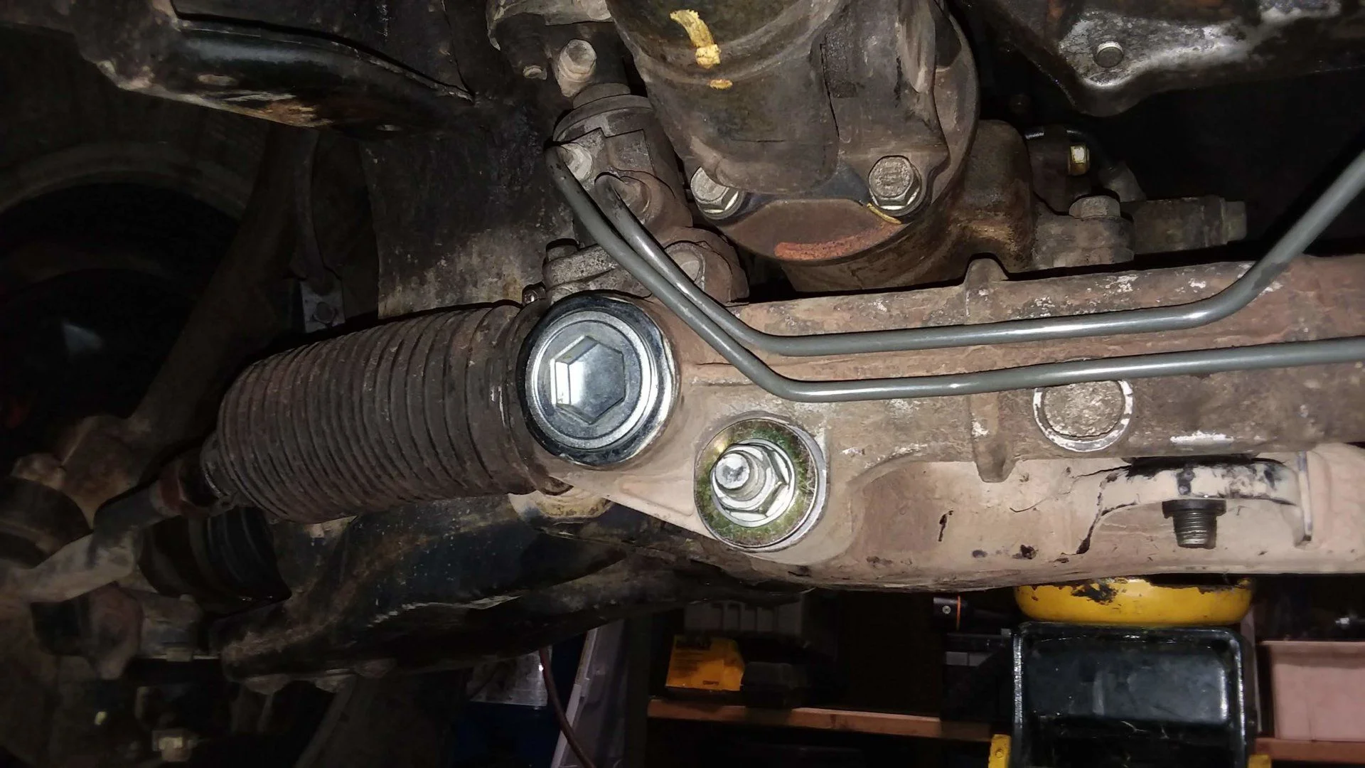

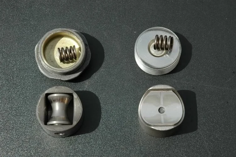

Question on the rack- the old style guide cap has a nut while the new takes a hex?
New style:
Old Style:
Internal difference:
Roller is old style, delrin pad is newer

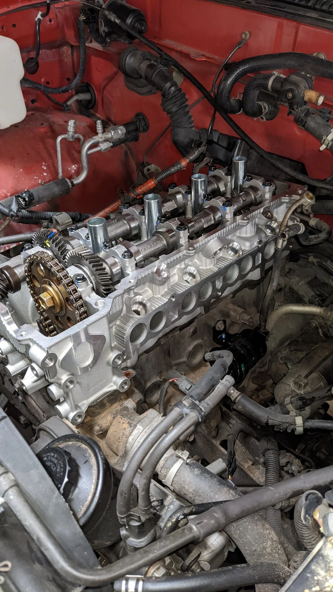

Been a long time since I posted here! Truck has been down for a while. I had an issue with stumbling on startup and coolant disappearing.
I put a new head on it. Also had the injectors serviced, and did an EGR delete.
Starts faster and runs smoother than I remember!
Hoping to make it back to the trails soon!
