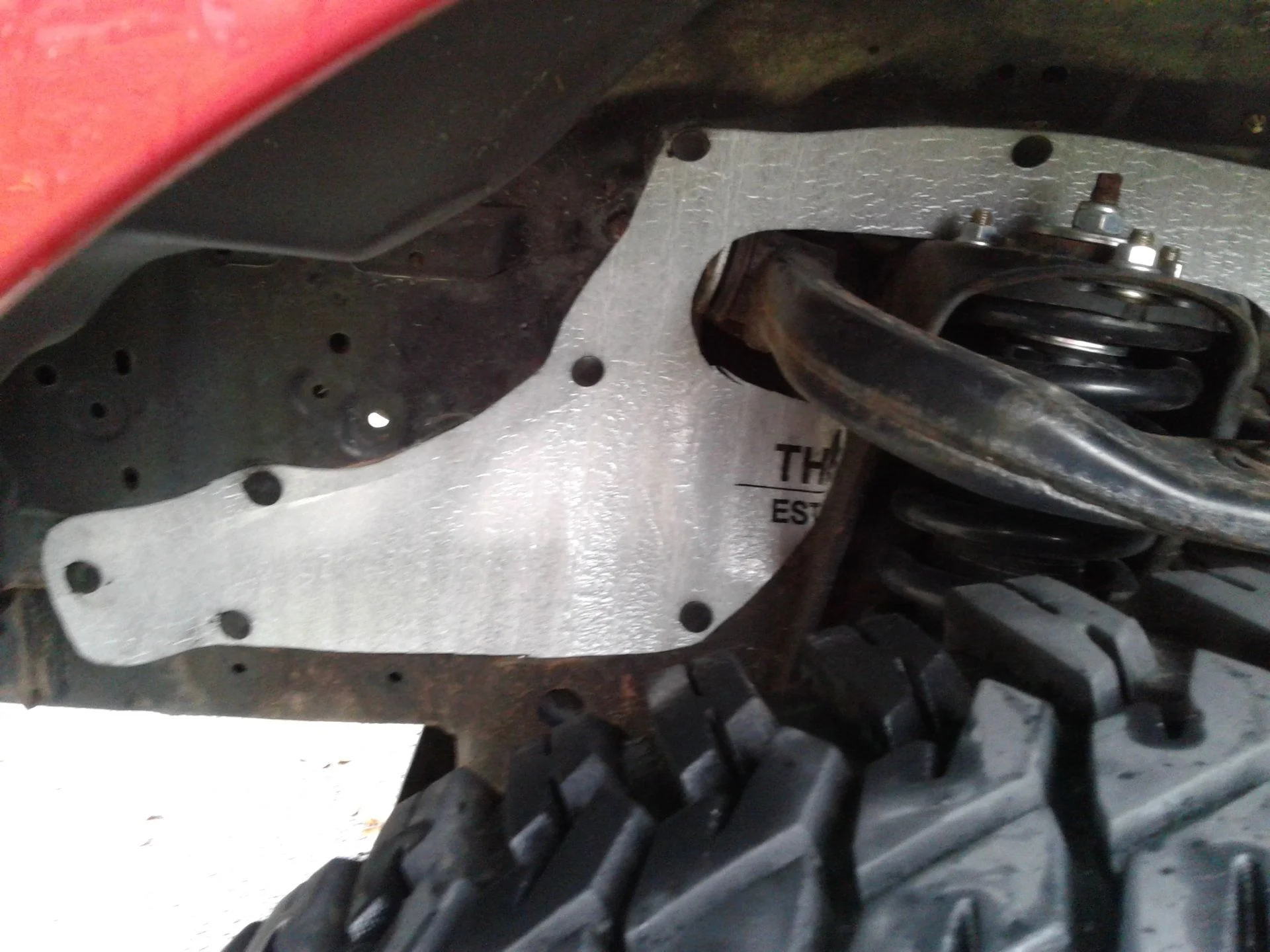

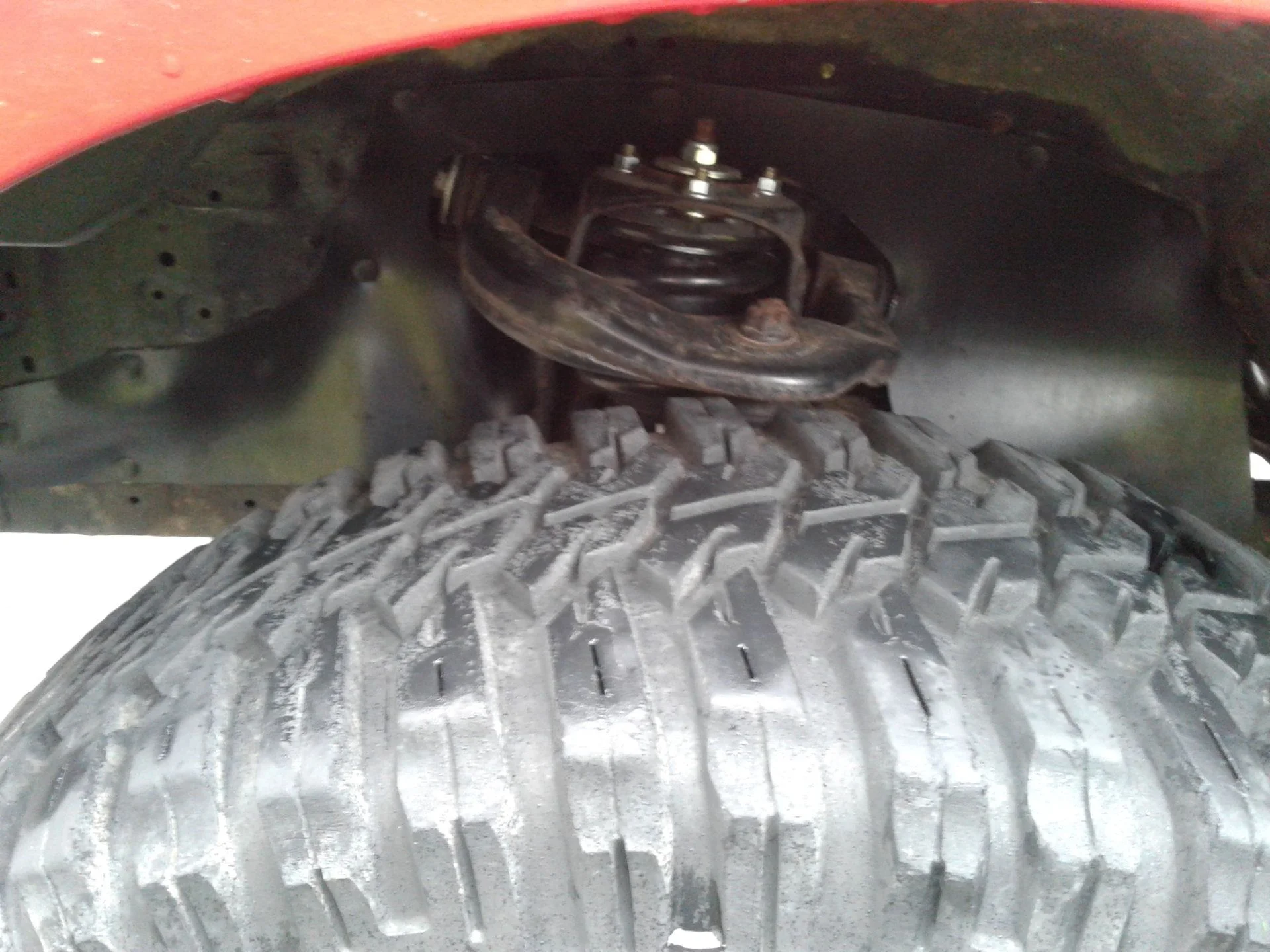

Got tired of my inner fender rubber thingies flapping in the breeze.
These things really help in keeping the slop out of the engine bay. I cut them a little closer to the suspension than factory.
I made some templates out of underlayment foam used for laminate flooring until I got the shape right.

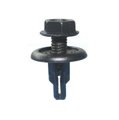

Found some clips that are a lot less frustrating than the factory clips.
https://www.amazon.com/gp/aw/d/B01LZ80AOB/?tag=ihco-20

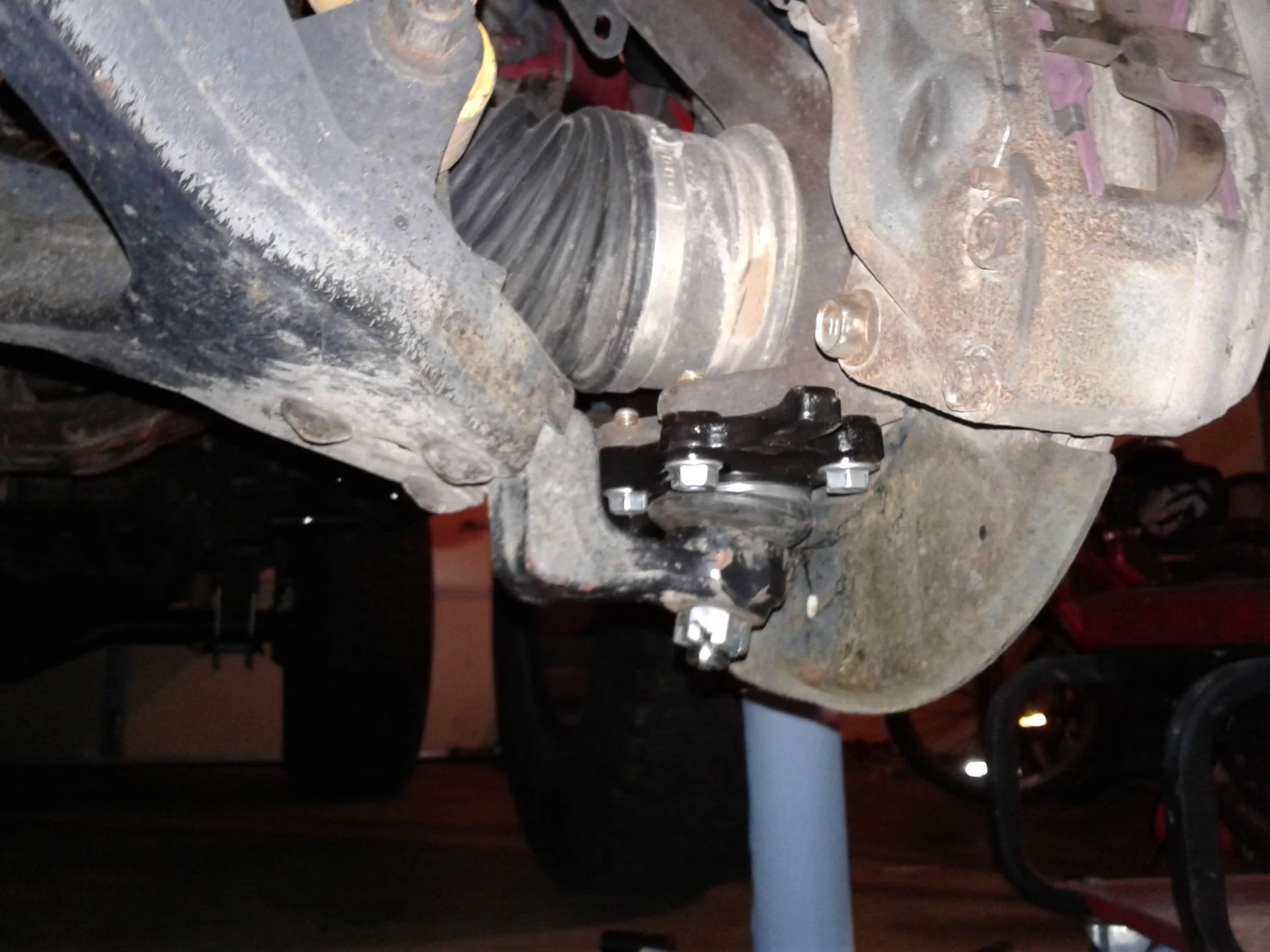

Did you use locktite?
Was going to ask the same thing :)
Loctite and proper torque are a big deal with those bolts. Our buddy Jeremy had those bolts fall out twice, once caused the front end to collapse and mess some parts up. We got him patched back up to get home from the trail, but some of the bolts fell out again on the trip home. Not sure what his final resolution was on that issue, possibly stretched threads were the culprit.
All of them fell out in the middle of a NJ intersection!
To add to that, JT I agree with you stretched bolts was definitely a culprit however I think the damage was already done to the spindle side of the threads, ultimately I believe he needed new spindles as well. The problem with the aftermarket ball joints kits is the bolts supplied more then the joints themselves, I have run aftermarket ball joints for some time and have been fine, but I always use the factory bolts, locktite and correct torque.

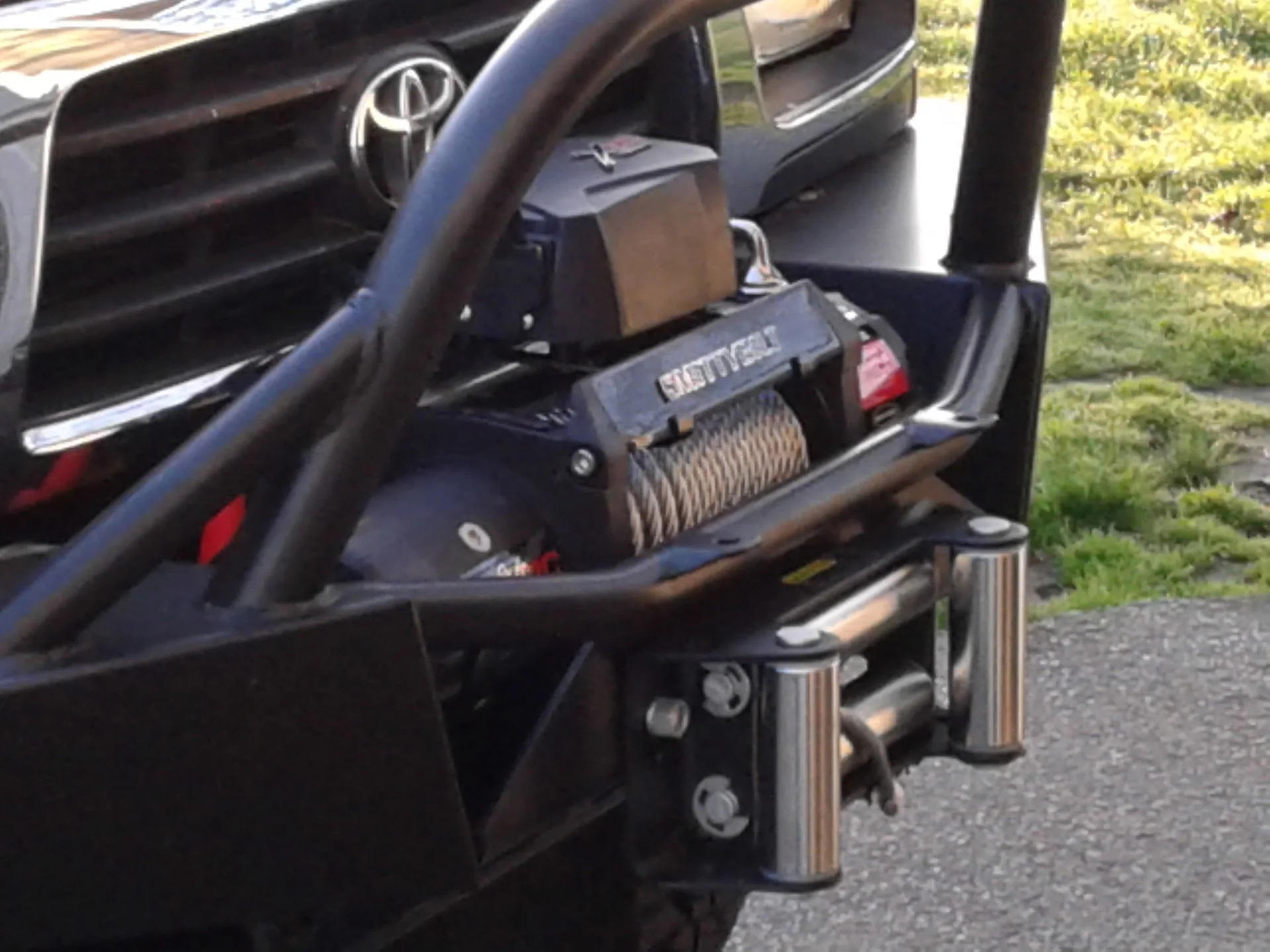

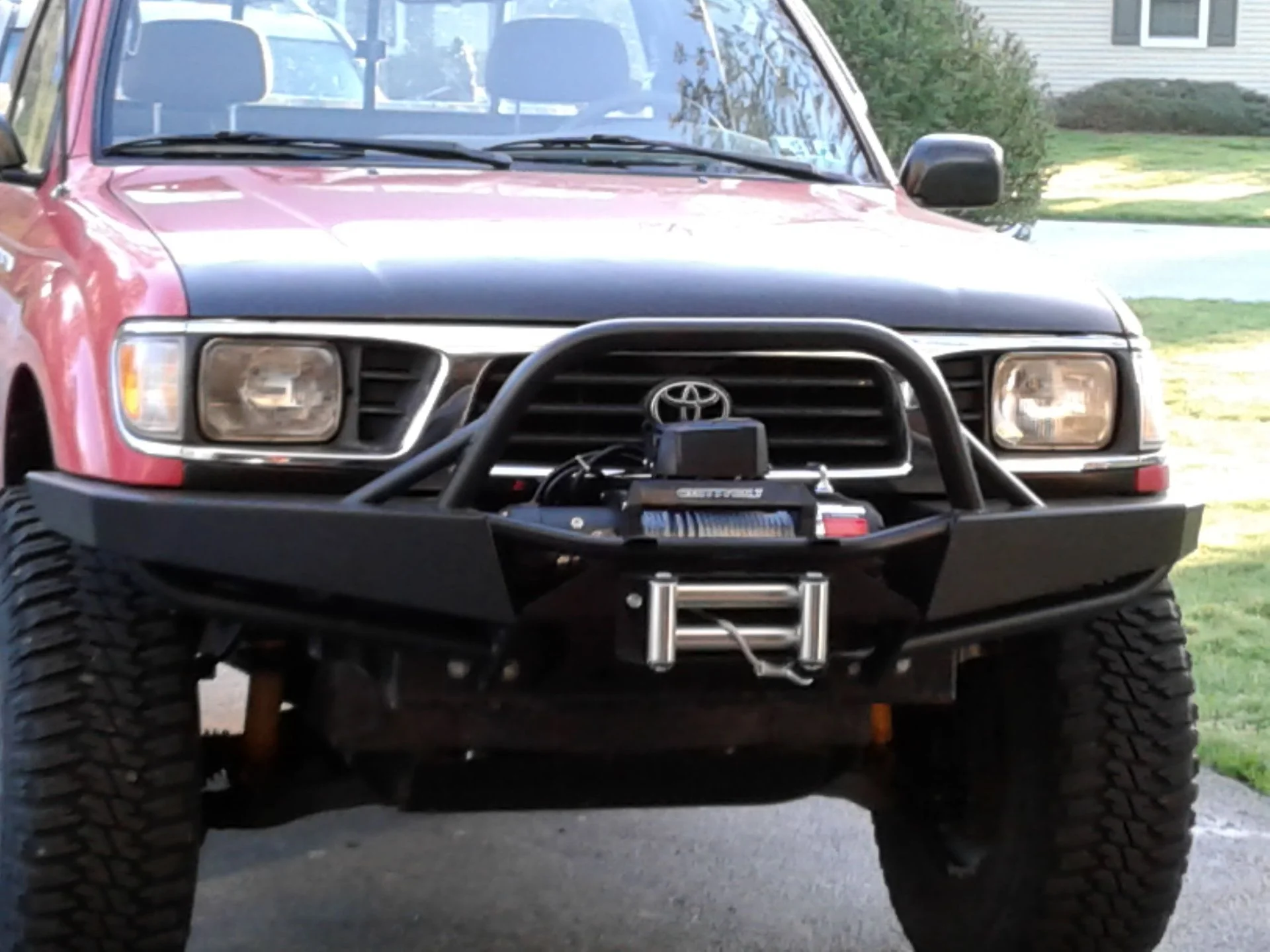

My winch mostly pulls box woods out of my neighbors' front yards. :D I figure it keeps the gears well greased.
