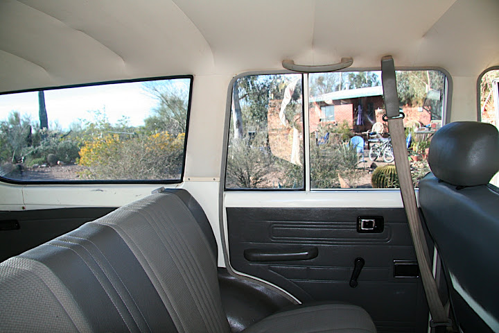

Looks like the factory belt, just never seen them mounted to the B Pillar, always seen them mounted here:
Has that headliner been replaced? Wondering about that trim piece over the door openings...
Not that I am aware of. That trim piece wraps around the entire length of the interior, not just over the doors. I'll ask about that.
