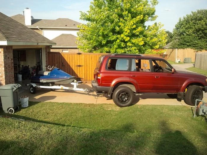

Here's the latest pick with the exhaust and the lift and wheel/tires
Man that was a lot of work.

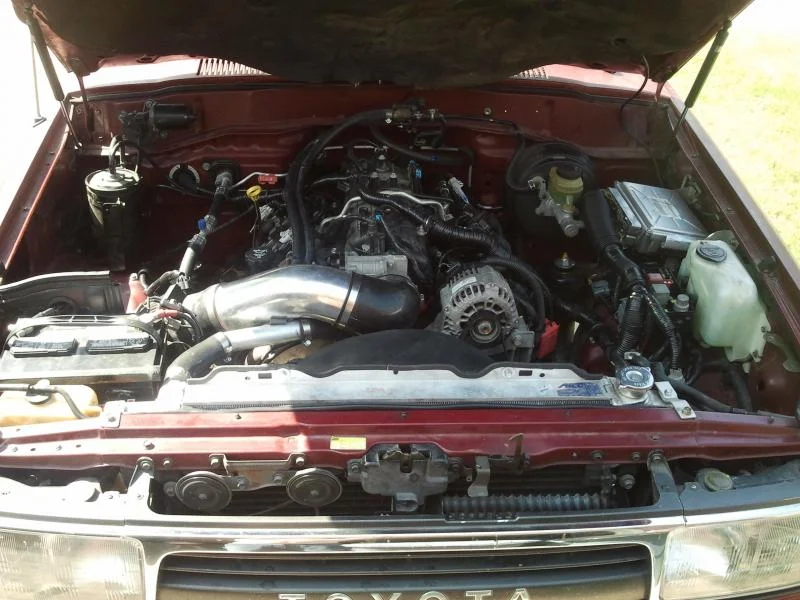

The engine bay is completely done, with lack of a good high flowing water proof air box. TBD regarding a snorkle kit.
The AC is ice cold. It is totally run by the Toyota system, and un fortunately, the AC input to the ECU is not working as it would on an earlier GM ECU, due to being drive by wire. Needs to have the proper serial data from the AC control head. Same goes with the cruise control. Needs data from the ABS module. For simplicity sake, cable throttle swaps are recommended, however, if you like challenges, and are an electrical nerd like me, then try looking into an ecu that didn't have auto climate possibly, or wire in the control unit and hide it behind the dash. DBW is still cool.
I did need to use about 30$ worth of foam Fromm the home depot race shop to completely seal the gaps between the condenser and radiator. I also bought a heavy duty fan clutch from parts store so at 1,000rpm, the fan is really zinging. That moves so much air through the condenser its not even funny. Heck these trucks being so old, that should be a common mod. Well I'm going to red river next weekend, may stop by Bonham on the way out.
