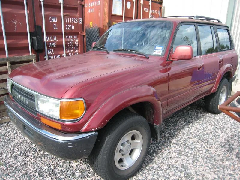

Here is a pic of the LC.

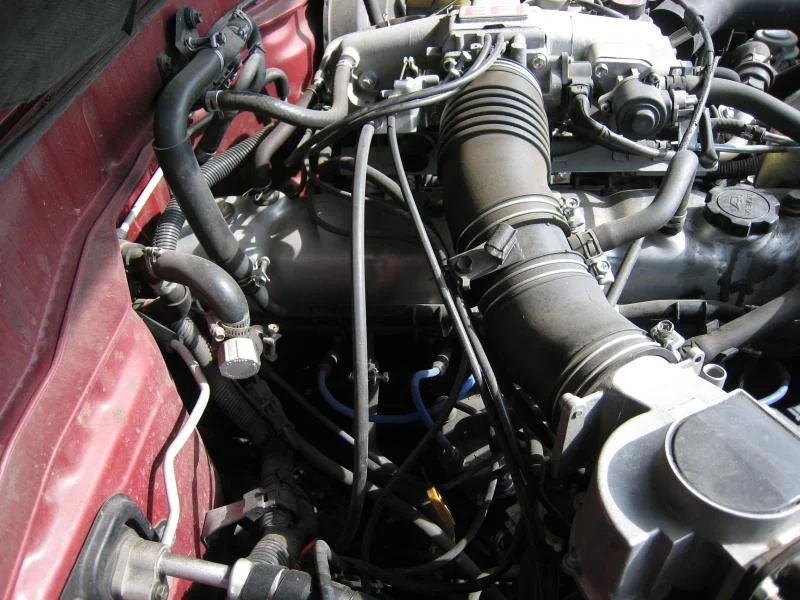

Iron block LS engines galore but I'm wanting an aluminum block. So, I turned down a few. I'm going to weigh the toyota combo against the LS combo with adapter installed to compare. I'm hoping for a big difference.
I suspect I'll be quiet for a few weeks unless someone buys the engine etc. or unless I get my LS powerplant. I'll document everything here when I do it as well as labor hours spent. I figure once I get instructions down, it will go smooth for someone else if they wanted to do this.
Oh, and someone wanted to know what's up with the shift linkage, well, I crawled around under there, and I suspect that I'll just make it. Can't be that hard. I'm thinking, a tweak or two on the ol' bridgeport, and some chromoly tube here and there and whala. (you'll be seeing that alot.) Whala... it should be a "smilie"
LS needs a pressure vent to the radiator, and if I remember correctly, the later model LC radiators had one as well, but mine didn't so I might just weld up a header tank. Other than that, I'm just making an aluminum fan shroud and slapping some electric fans in there and done with that. I'm using all the LS accs, like PS, and A/C. I've made lots of hoses for other stuff, so that shouldn't be an issue. Looks like I need to reseal the steering gearbox. Dang. Don't see any other leaks in the tcase or axles, so I'm happy.
