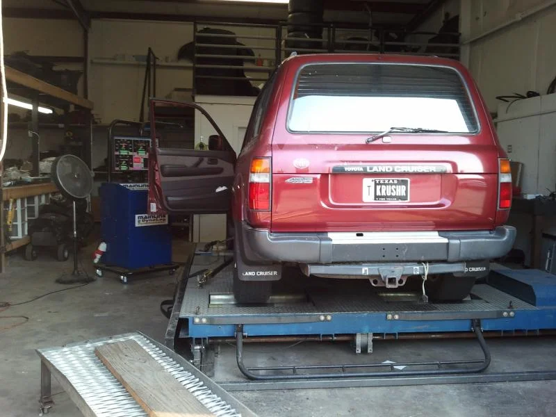

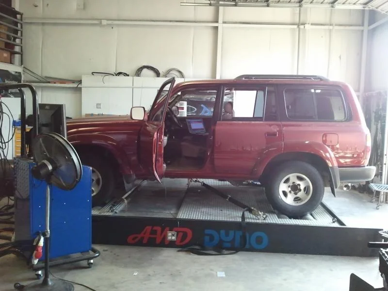

On the dyno

Here's some photos. Dang it needs paint.

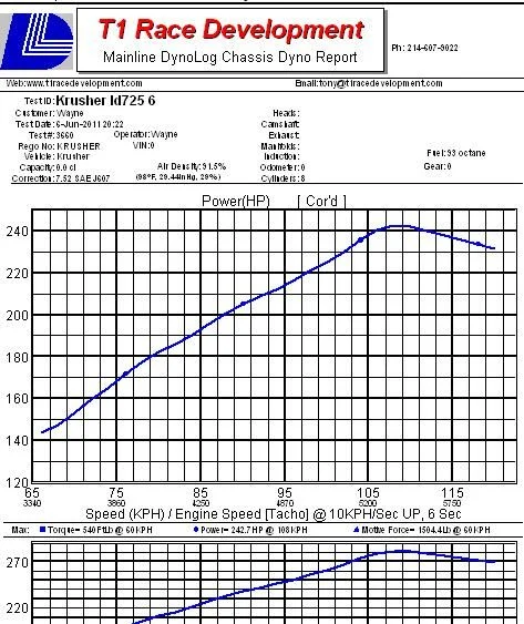

dyno chart
Finally.
Hate to see a stock six cyl on my dyno. This is a stock 5.3 with a custom intake and exhaust. The numbers at the bottom are what you would see on a dynojet. No vids sorry. Was pushing buttons. :D
The tq number is right. Ill plot that tomorrow. 2nd gear.
