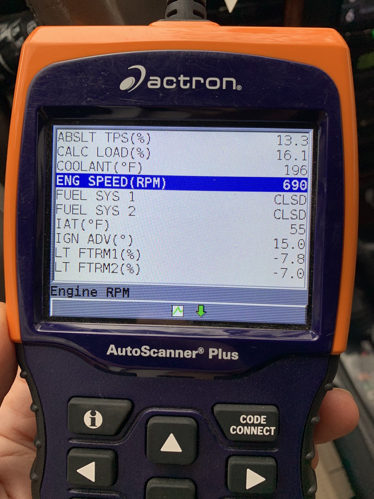

Disconnected the battery while I put everything back together.
Started it up and got the high idle...let it run until it was warm.
Shut it off and did some “idle reset” processes I found on YouTube.
1). Ignition on, not running, slowing press the pedal to the floor and slowing release it 3x
2). Turn ignition on (do not start) then off, then back on and start. Turn off all lights, radio, etc...Engage parking brake, hold the brake and place in drive. Let the vehicle idle for 5 minutes.
I have no idea if step 1 or 2 or both or neither did anything, but afterwards idle was at 690rpms and throttle around 13%.
Drove it around the block and everything seems good as new.
Thanks for the help all!!

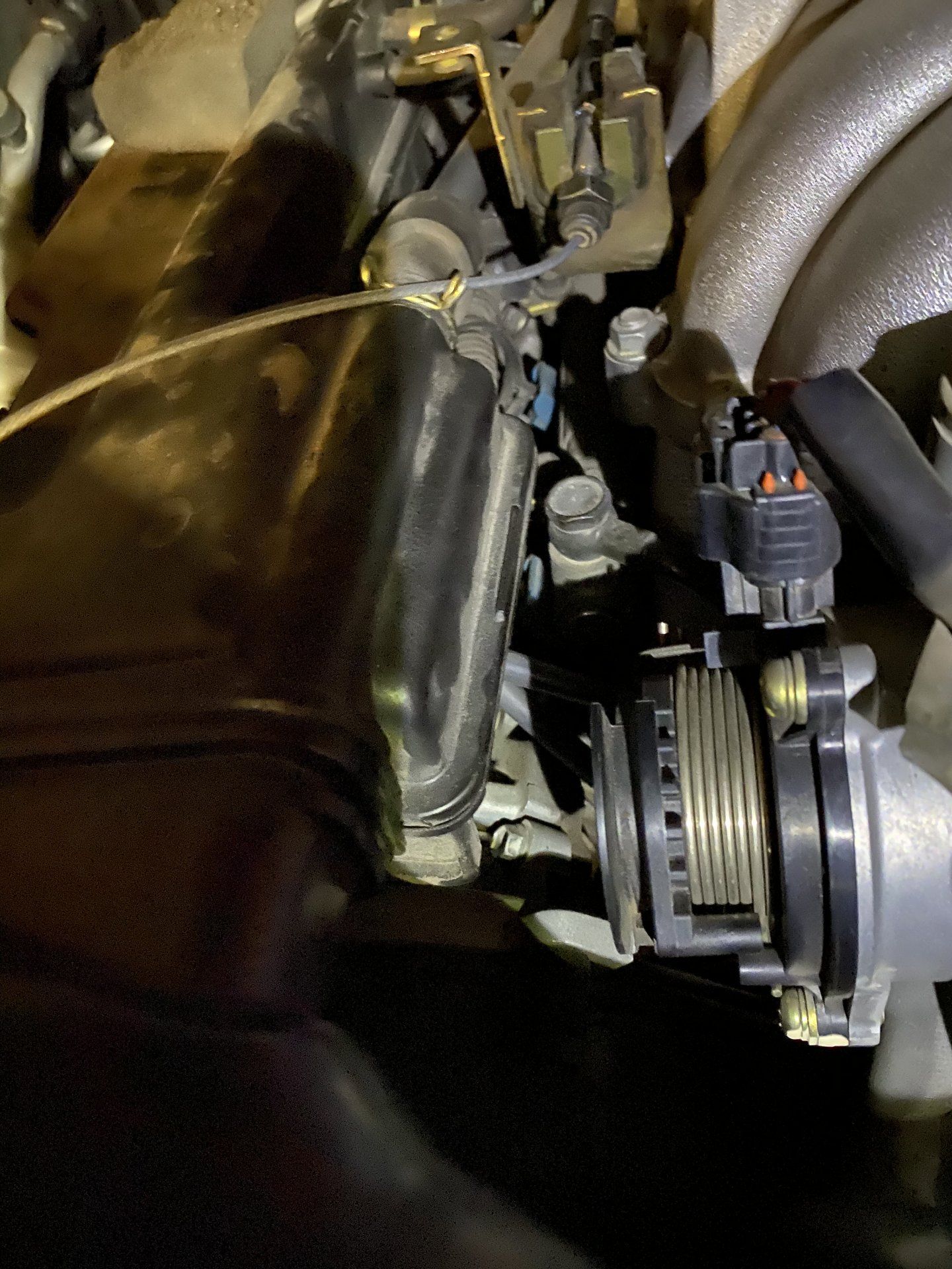

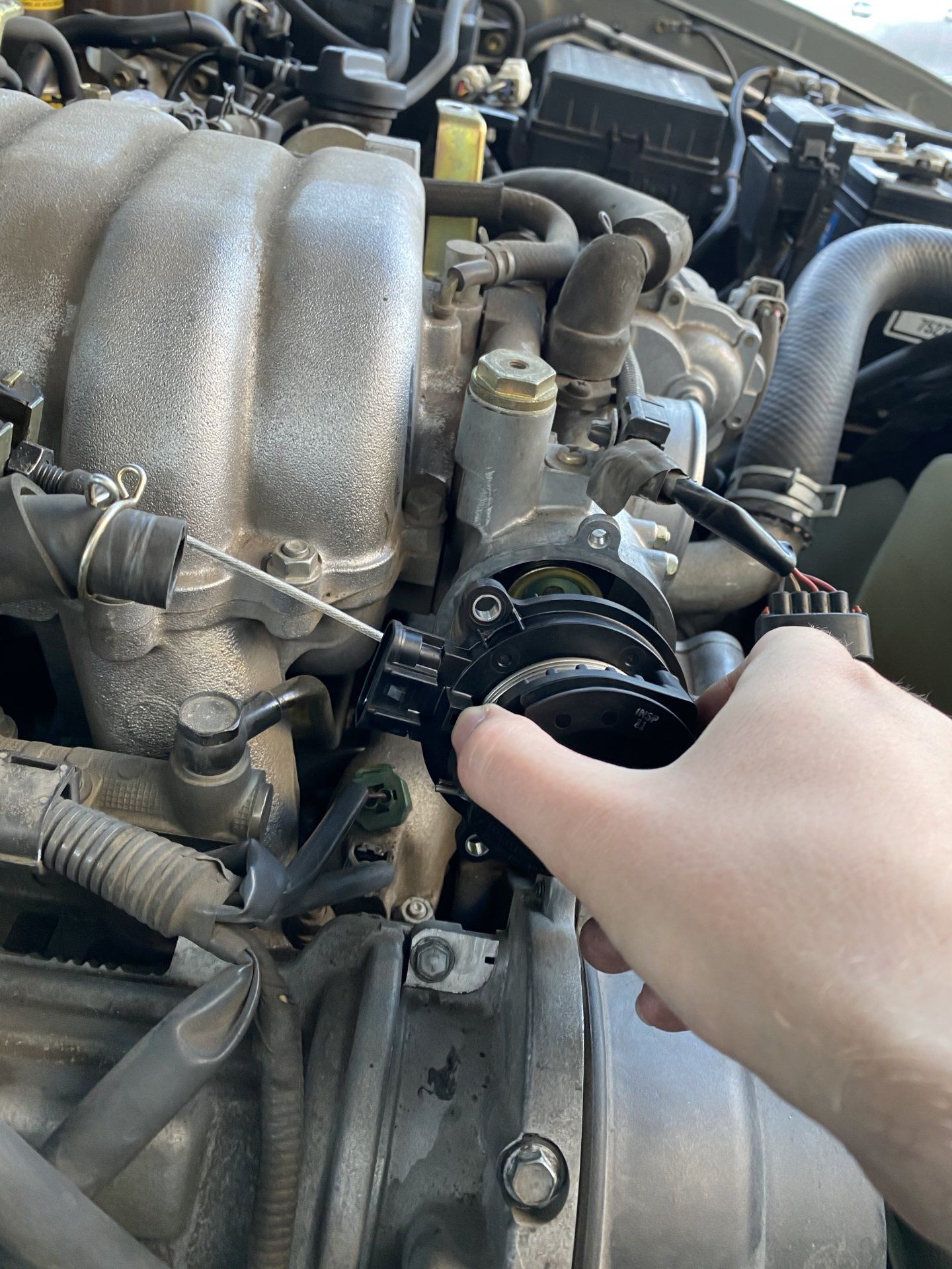

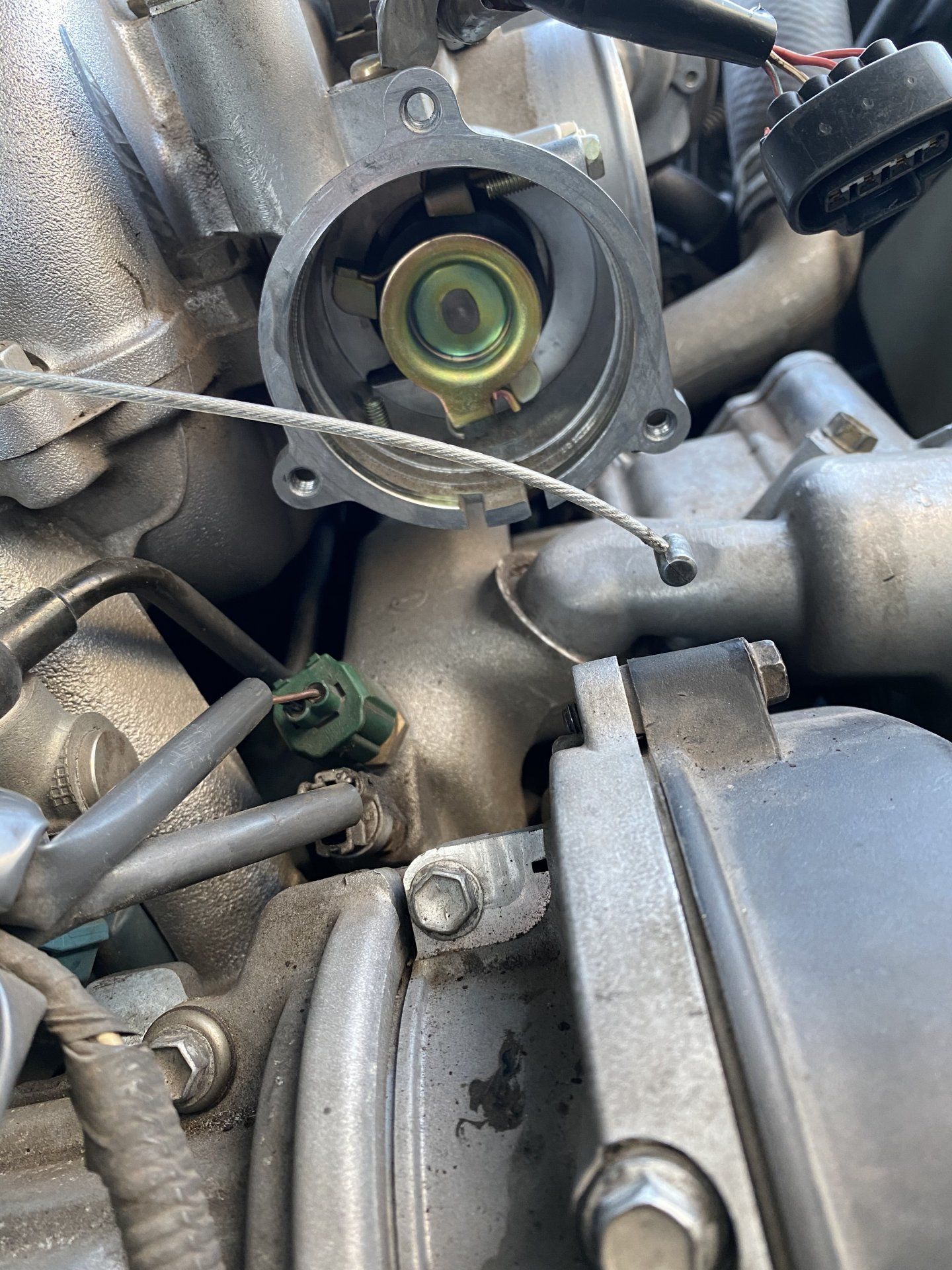

I messed this part up on my first attempt. If you do it correctly, you can hand rotate the screwed in APPS to re-attach the throttle cable. No resetting of sensor was necessary. Hope that helps.
From the original instructions:
12) Install the APPS so that it's about 20 degrees to the left of it's actual installed position
13) Gradually rotate the APPS clockwise until it touches the throttle valve shaft, then tighten the three screws securely (steps 12+13 are the official from the factory man steps - I didn't exactly do this but jiggered it around until it fit correctly - seems to work fine)
