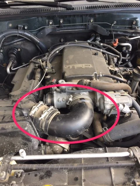

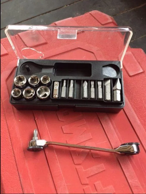

The super charger made for less things to take apart. The intake on my vehicle has been modified as well so I only had to remove a small section of the hose to get to the APPS. An offset bit driver was a key to making this an easy repair.
