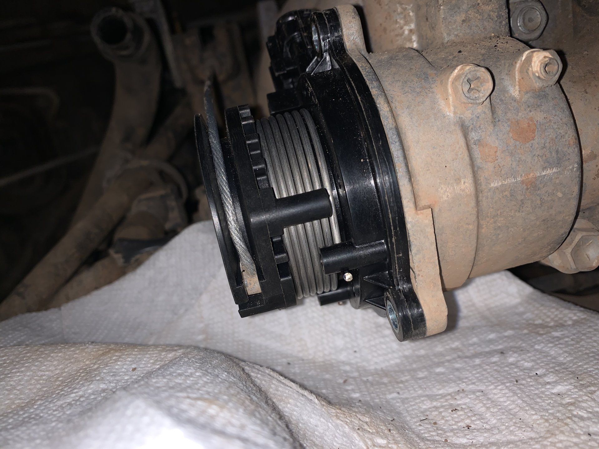

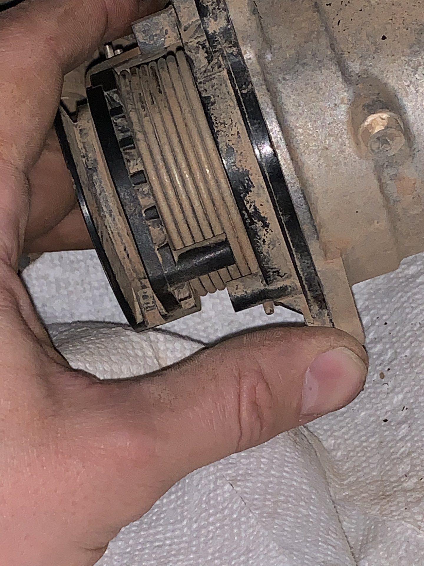

I can’t seem to figure out how this Apps sits in the housing....when I put it in and rotate as the FSM indicates, I run out of cable the throttle is applied...
You can see in the pics below the gap on the apps. However, the factory apps seems to have the gap as well. (At least the way I am installing it)
That looks installed correctly. If you did APPS and TPS and still getting limp mode. then you need to get a new throttle body ...
