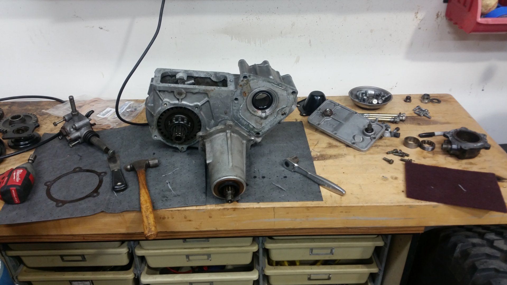

When I put lube in the tranny and transfer case a few months ago the transfer case leaked like a mofo. So while I had full access to it (tub still on sawhorses awaiting paint), I decided to pull it and toss it on the workbench. I picked up a gasket kit a couple months ago with some other stuff, so tonight I started to tear into it. So far everything looks good internally, just a couple old paper gaskets I thought I could get away with leaving there.
I made a little more progress than the pictures show, I had too much oil on my hands to be digging around for my phone.

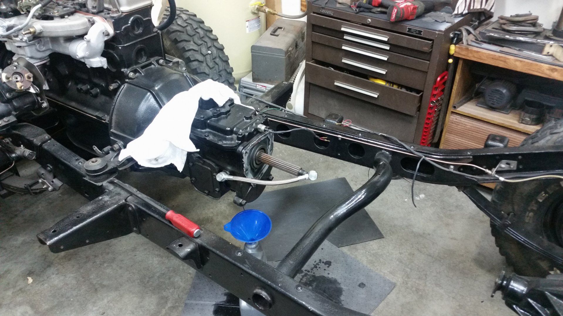

I did manage to get some work done to it last night, put the t-case back on the tranny, front output side is back on. Tonight I hope to finish the speed-o-gear seals and start putting the rear half back together, possibly get finished with it tonight or tomorrow night.

When I put lube in the tranny and transfer case a few months ago the transfer case leaked like a mofo. So while I had full access to it (tub still on sawhorses awaiting paint), I decided to pull it and toss it on the workbench. I picked up a gasket kit a couple months ago with some other stuff, so tonight I started to tear into it. So far everything looks good internally, just a couple old paper gaskets I thought I could get away with leaving there. View attachment 1424889 View attachment 1424890

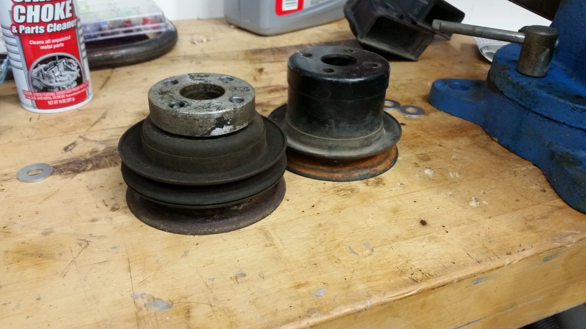

@Jdc1 which water pump pulley are you running now? I think the one on the right without the spacer will be the one that lines up with the HB pulley.

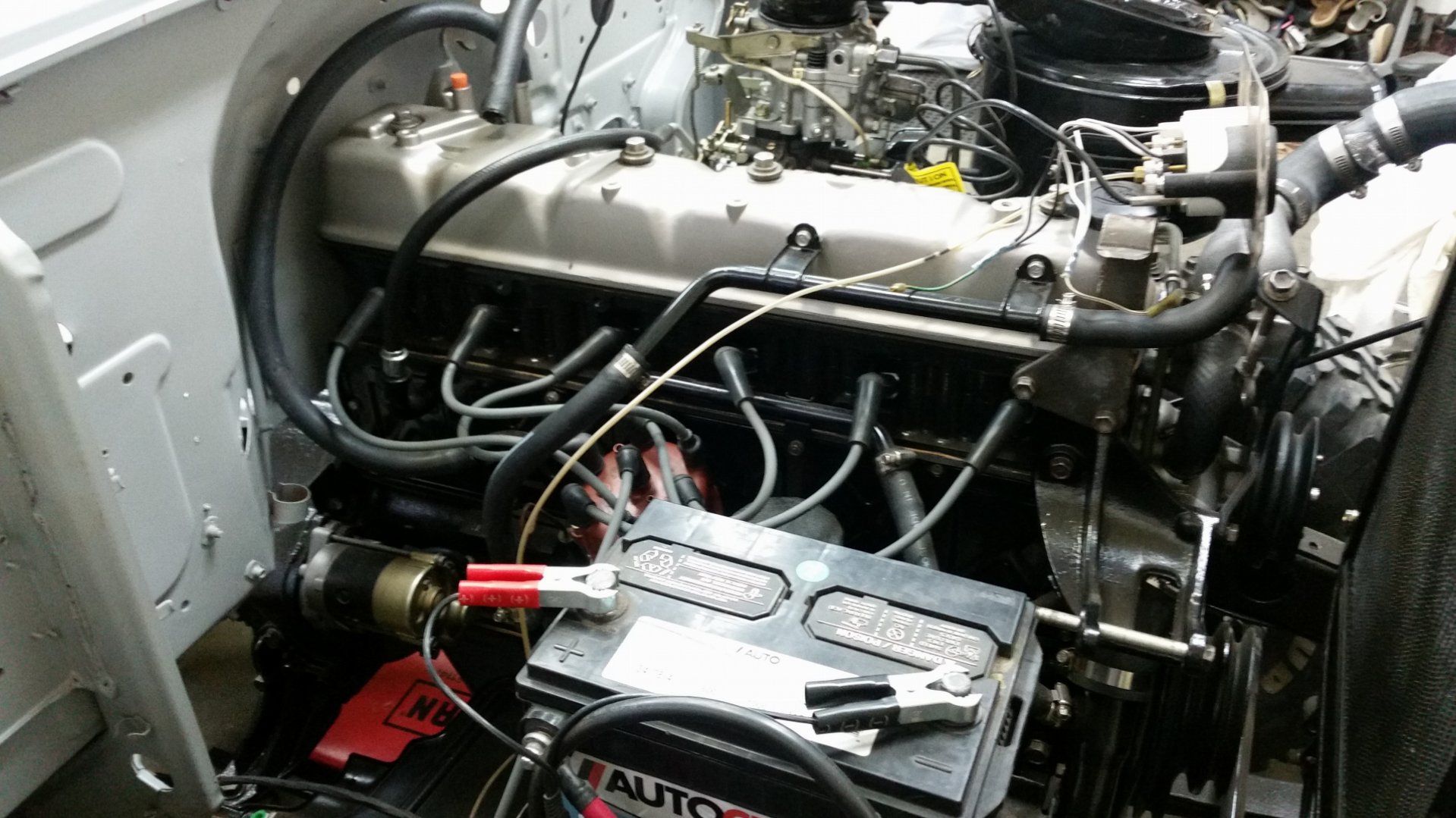

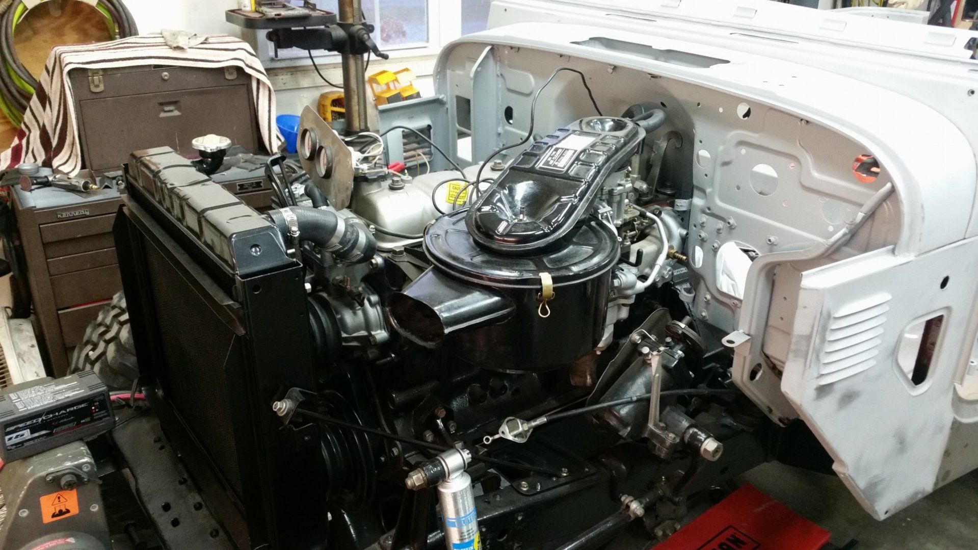

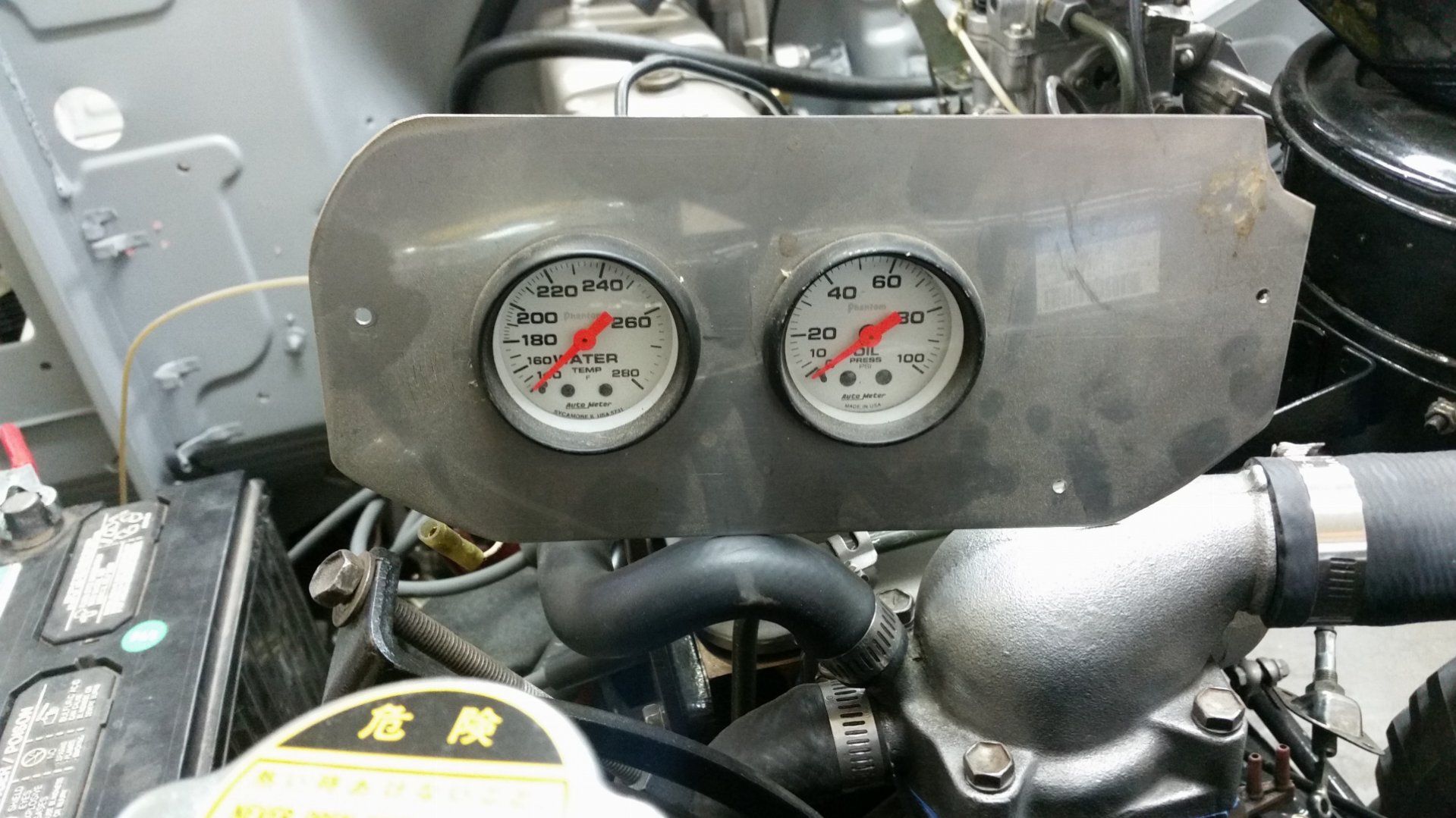

I poked around and did some small stuff on the engine today, filled it with oil, new plugs in, and installed water temp. and oil pressure gauges. Once I sort the water pump out I will be ready to fire the engine up for the first time. I will go over everything about 20 more times before I start that though. I need to ground that engine to the chassis........and plumb a temp exhaust......oh and coolant.....and......and......where's my beer?

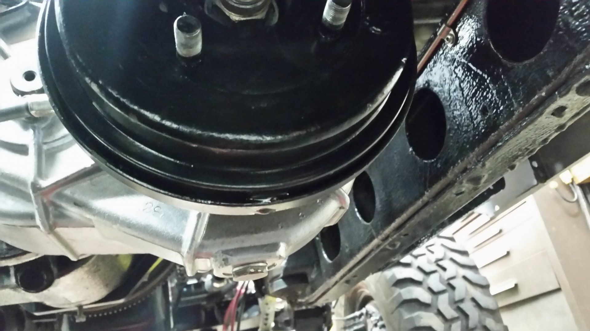

Also finished up on the t case a few nights ago, filled it with gear oil and checked for leaks the next morning. F@#K! :bang::bang: Time for a Speedi-sleeve. Just a tad bit of a groove in the brake drum is giving me a headache!
I'm not sure what the pulley is out of, Onur found it for me in Japan. It is a double pulley without a spacer. If you are thinking about power steering, you'll want to use a double pulley. I'll see if I can find a part number and snap a pic as soon as I can.
No power steering for me, I mocked up a couple things today but without having another WP to compare I can't figure out which pulley to use.
Crap, I may just move the radiator forward to get an inch more of clearance.
