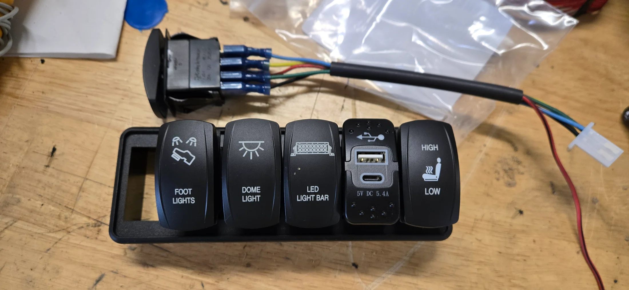

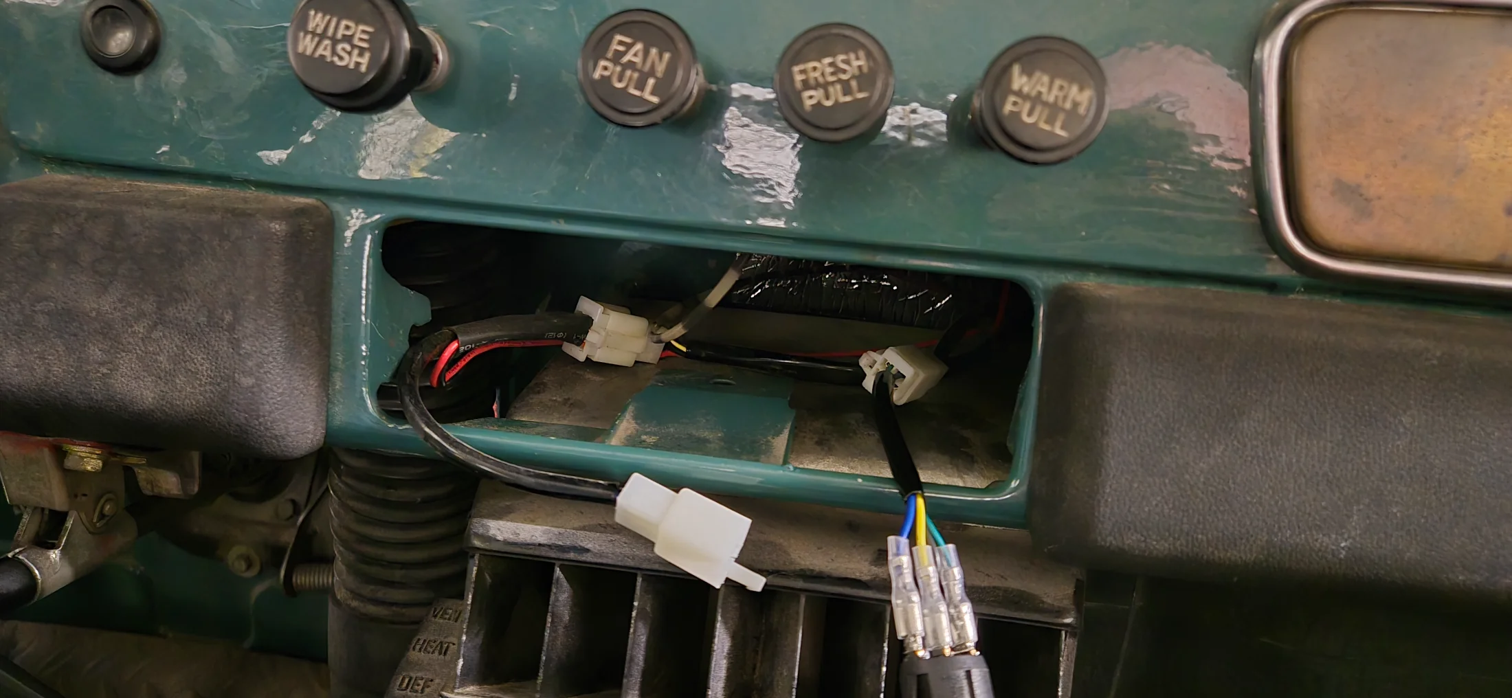

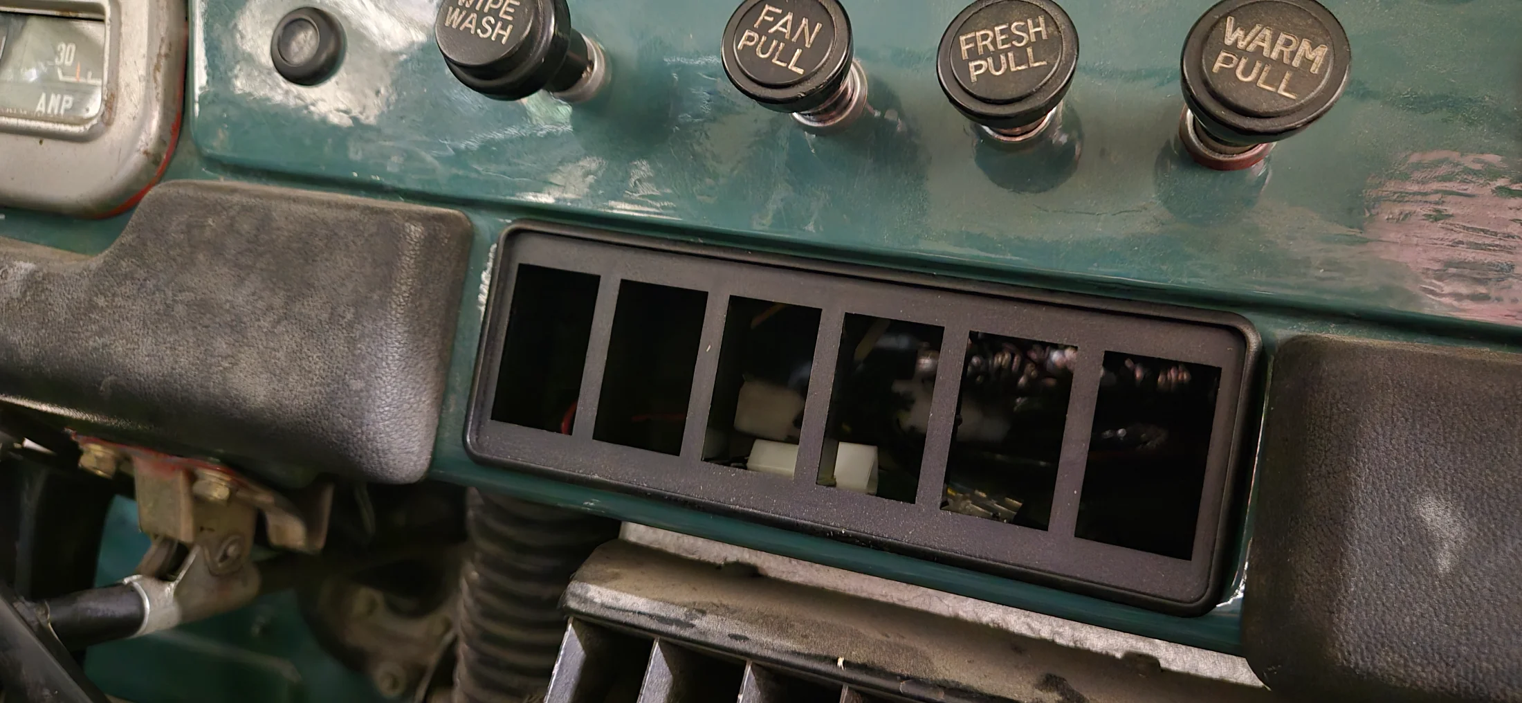

I've been wanting to do something with the radio slot in my dash for a long time now, with the new seats that included heaters in them it gave me a good excuse.
The switches included with the seats are dumb in my opinion, yeah, they're cheap, and that gets passed along to the consumer. Nevertheless, I don't like them.

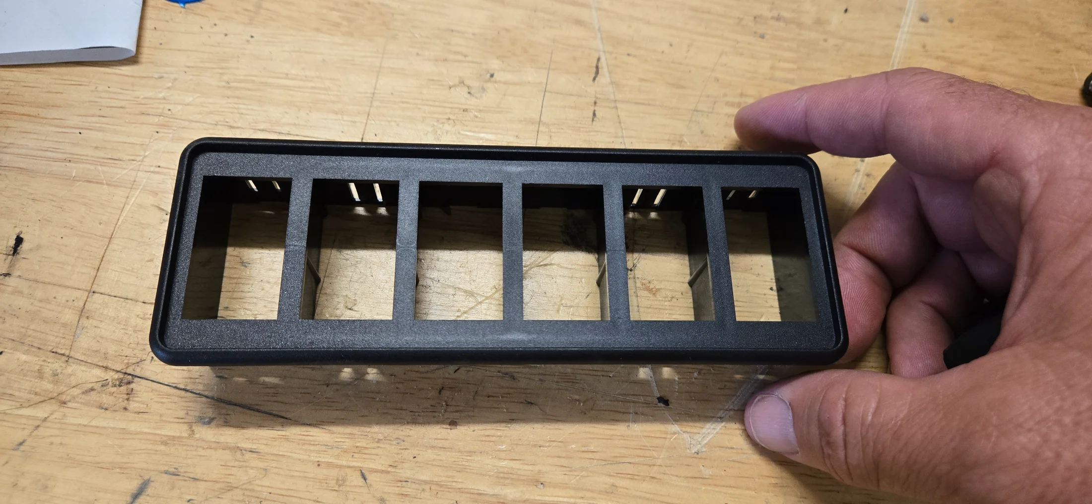

After countless hours of browsing 40 tech here in mud, I found some pics of a 6 gang rocker switch panel from somewhere. I started a thread about it and received some solid input.
Along came some stuff from Waytek and OTRATTW switch place.
More to come later...

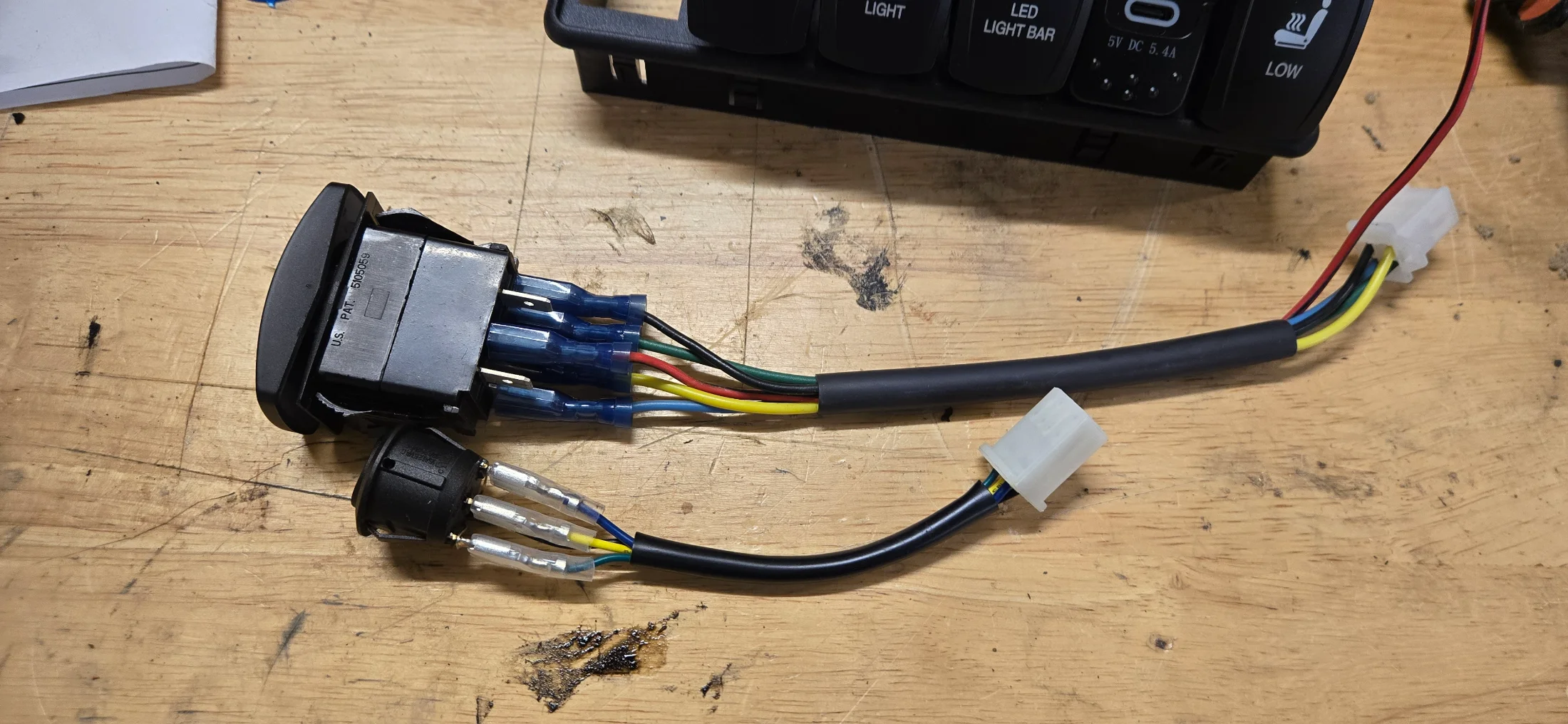

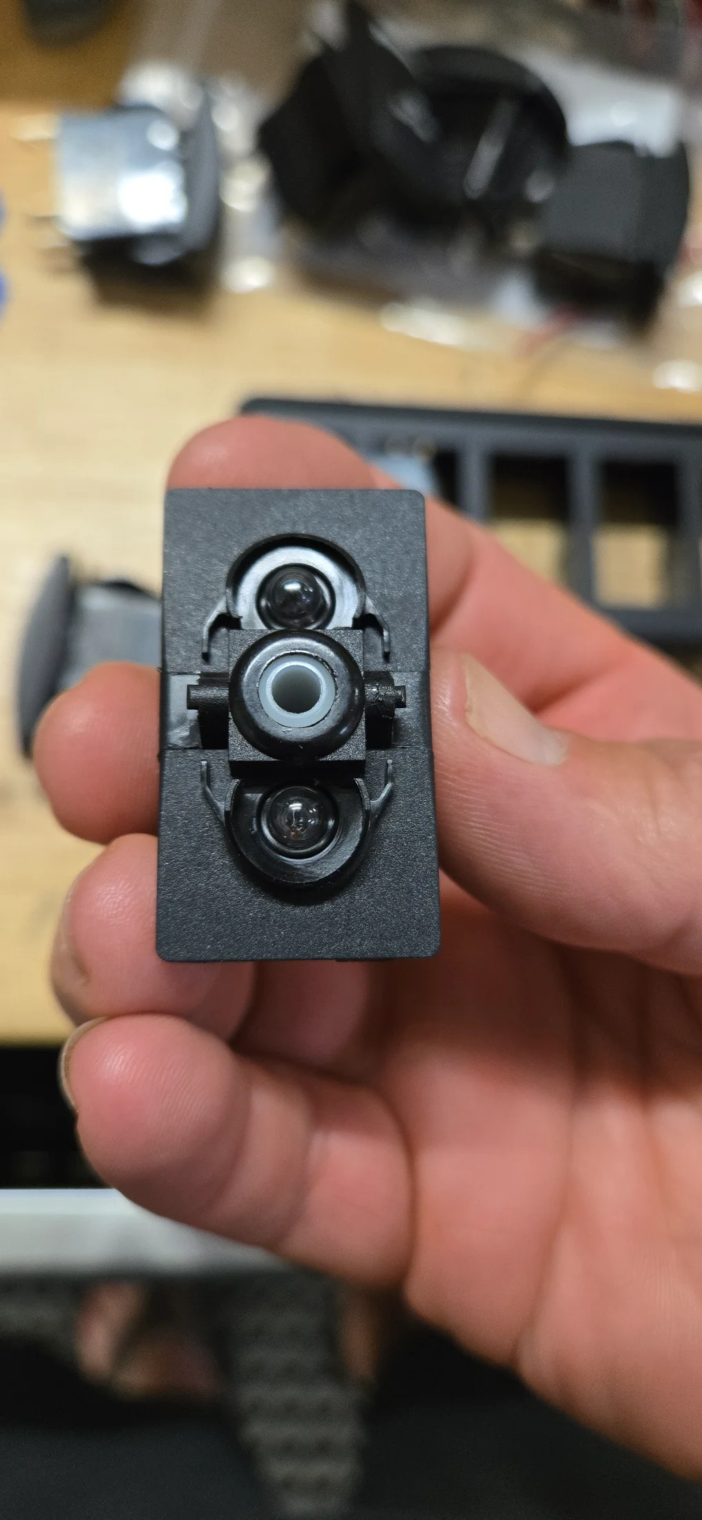

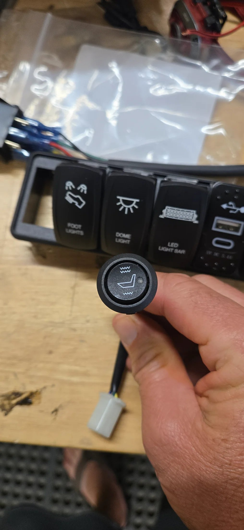

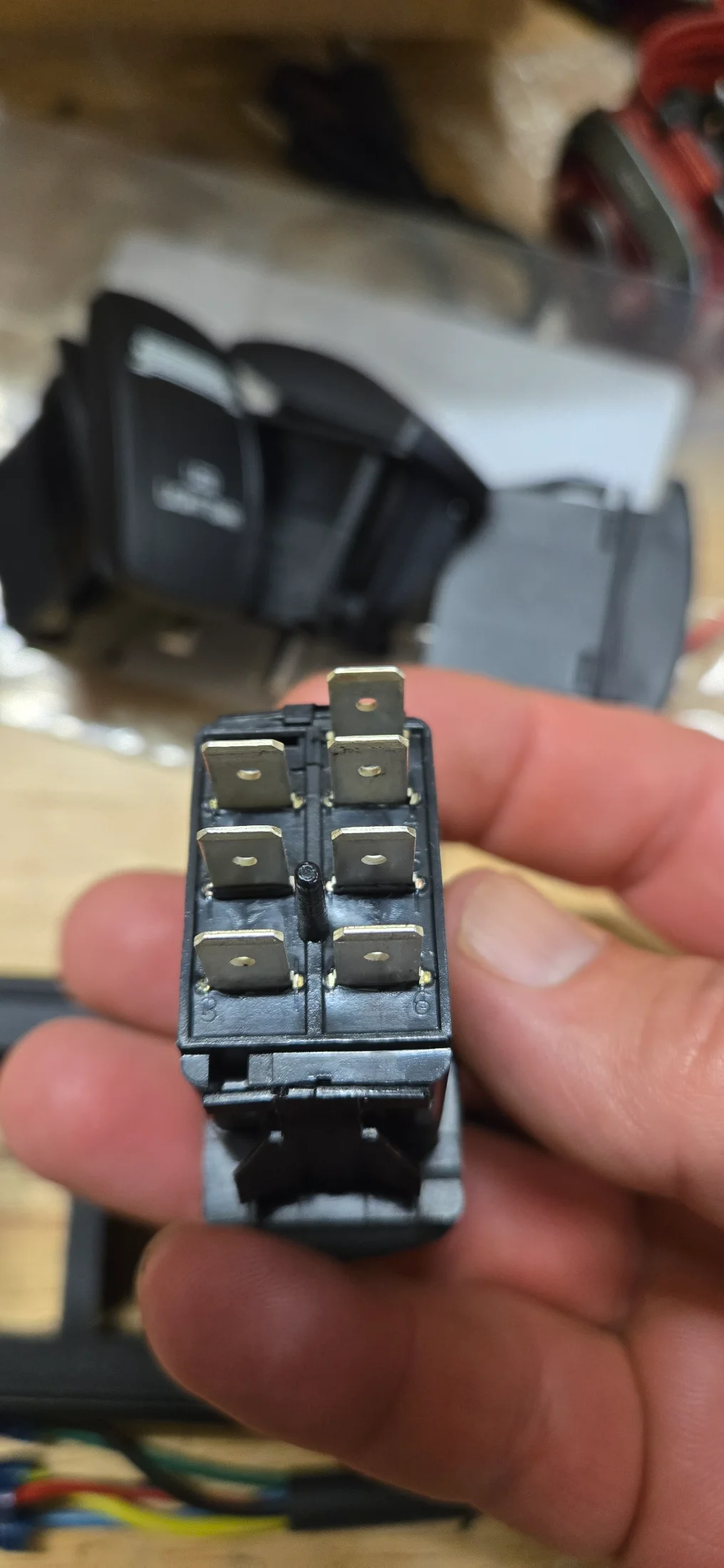

The fun began when I wanted lighted switches. I had already decided on the V series rockers from Carling.
The seat heater wiring design runs the 12vDC power supply to a magic black box under the seat, from there a 3.5(ish)vDC switching circuit goes up to the switch. Hi-off-lo switching circuitry (SPDT).
That wouldn't work with a 12vDC light in the Carling switch, after reviewing some wiring diagrams on their switches I figured out i could run with a DPDT (double pole double throw) switch would work. Using one set of contacts for the heater switching, and the other I brought 12vDC to power the lighting circuit in the switch.
I found a wiring connector kit on Amazon that mated up with the existing connector bodies from the heater harness.
Female Sta-Kons from Waytek.
Klein tools from my trade life.
Heat shrink tubing from my existing parts stash to help clean up each switch harness.
View attachment 3986091View attachment 3986093View attachment 3986094

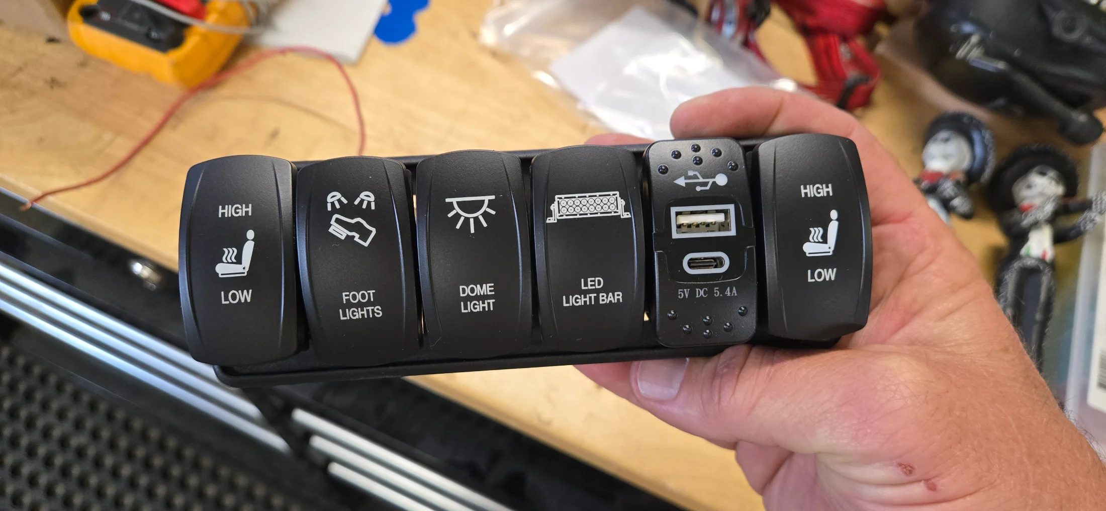

I used 60 series seat heater switches in my 40 to power the BMW seats. Works great.
The "Foot Lights" switch will be perfect for your underglow and spinning hubcap lights!
