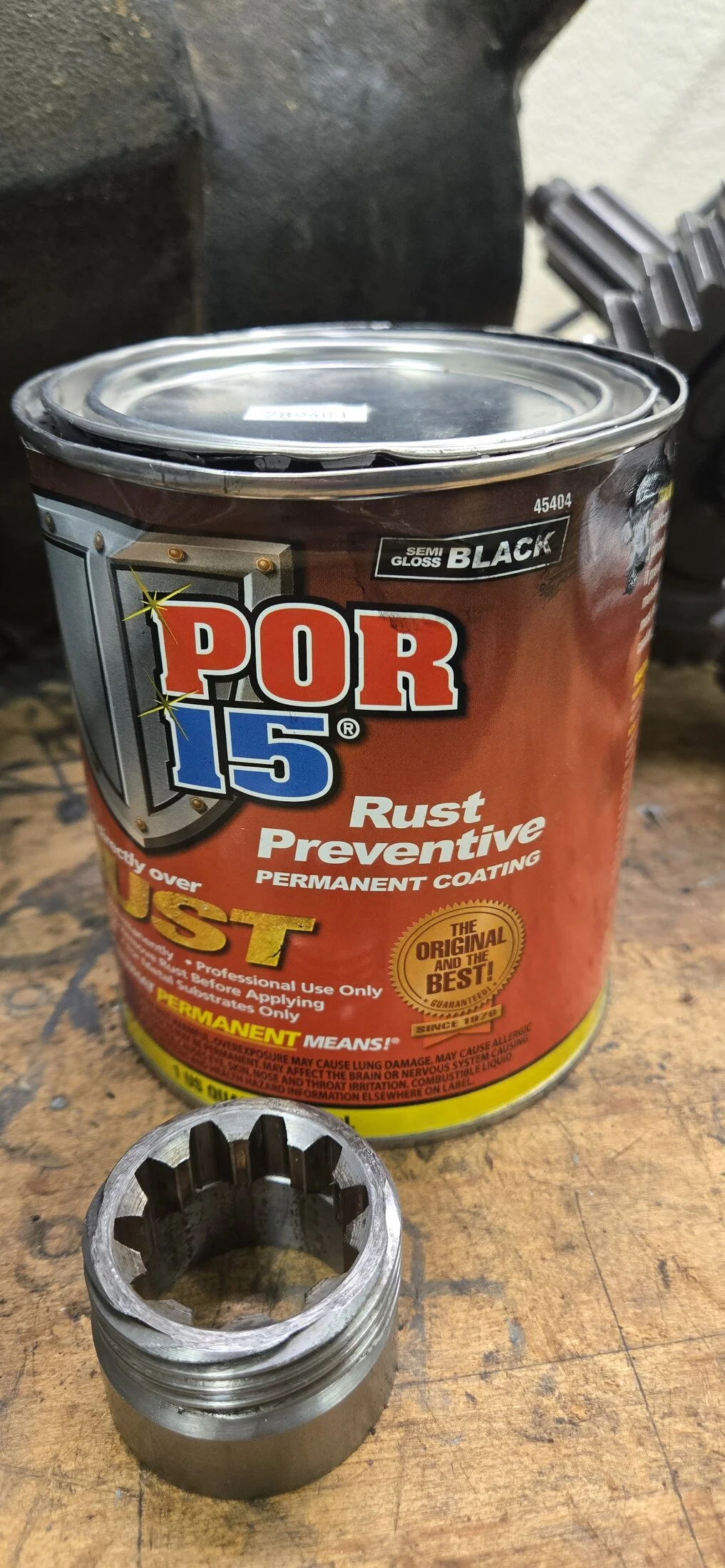

While I had some free time I lathered some POR 15 on the spots that I was concerned about in the wheel wells.

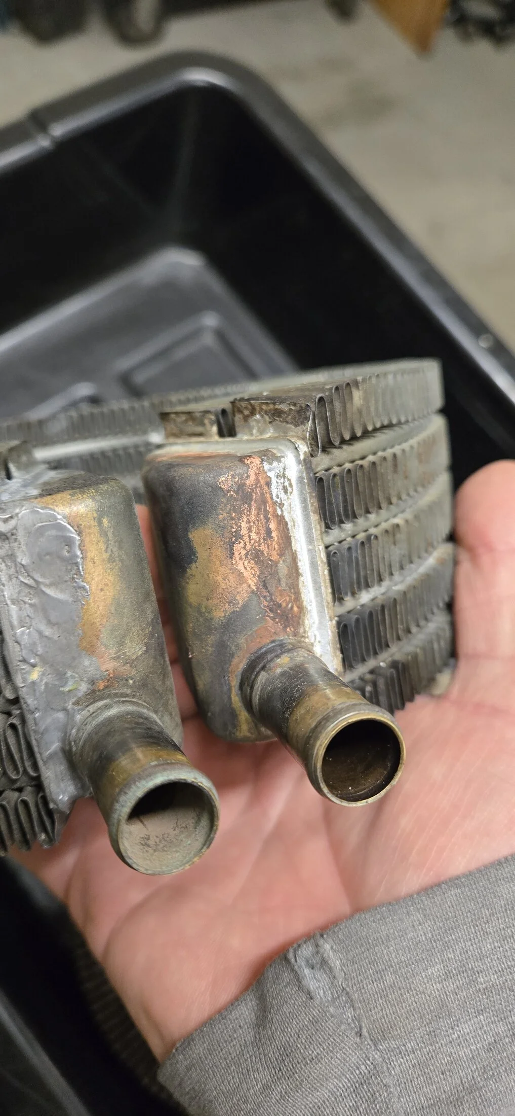

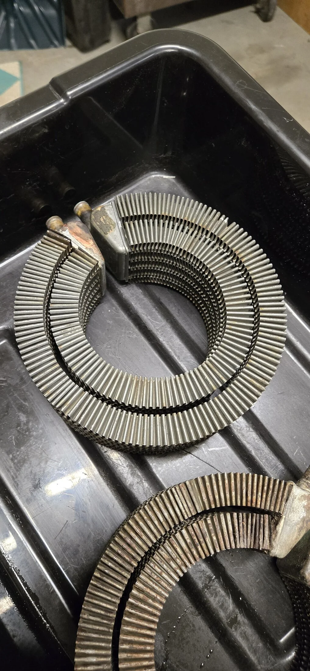

While I had the interior pulled apart I figured I would address the leaking rear heater core.
Sleazy money, I had a spare, 10 minutes later I'm back to cold beer and wax.
Until the next day when I noticed that the replacement leaked worse than the first one!
Nothing that can't be fixed.

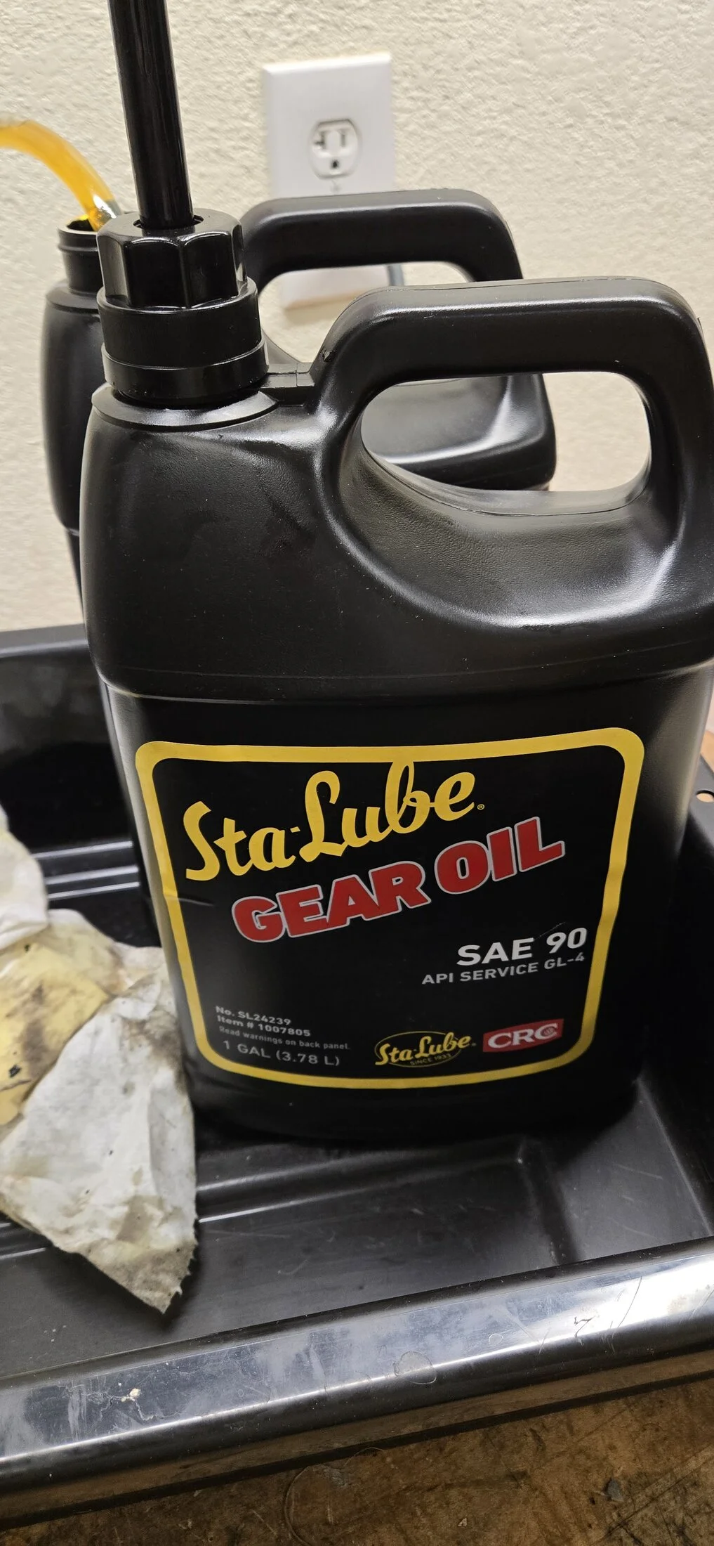

Couple gallons of Sta-Lube and it's time to rock and roll.
