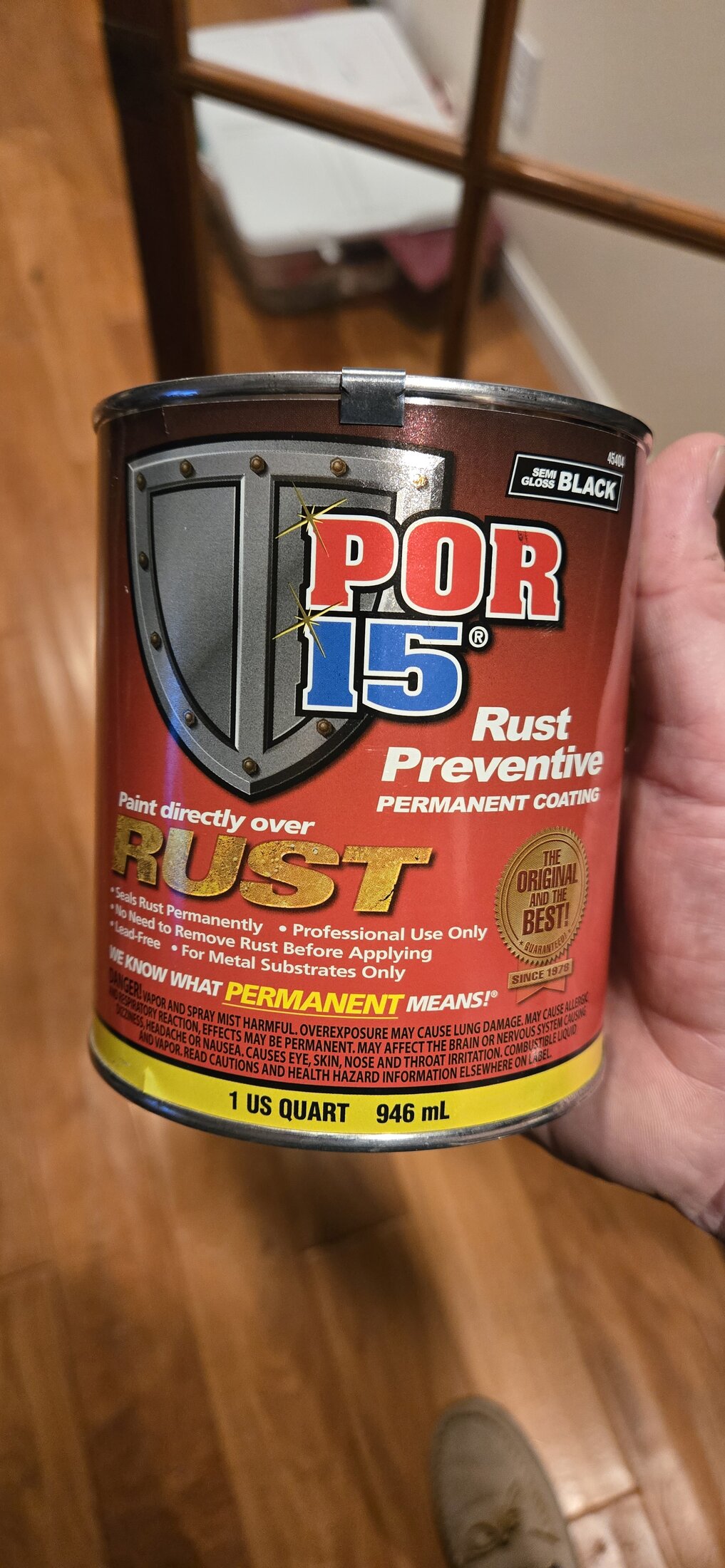

I also tripped over a quart of POR 15 hiding in my stash.

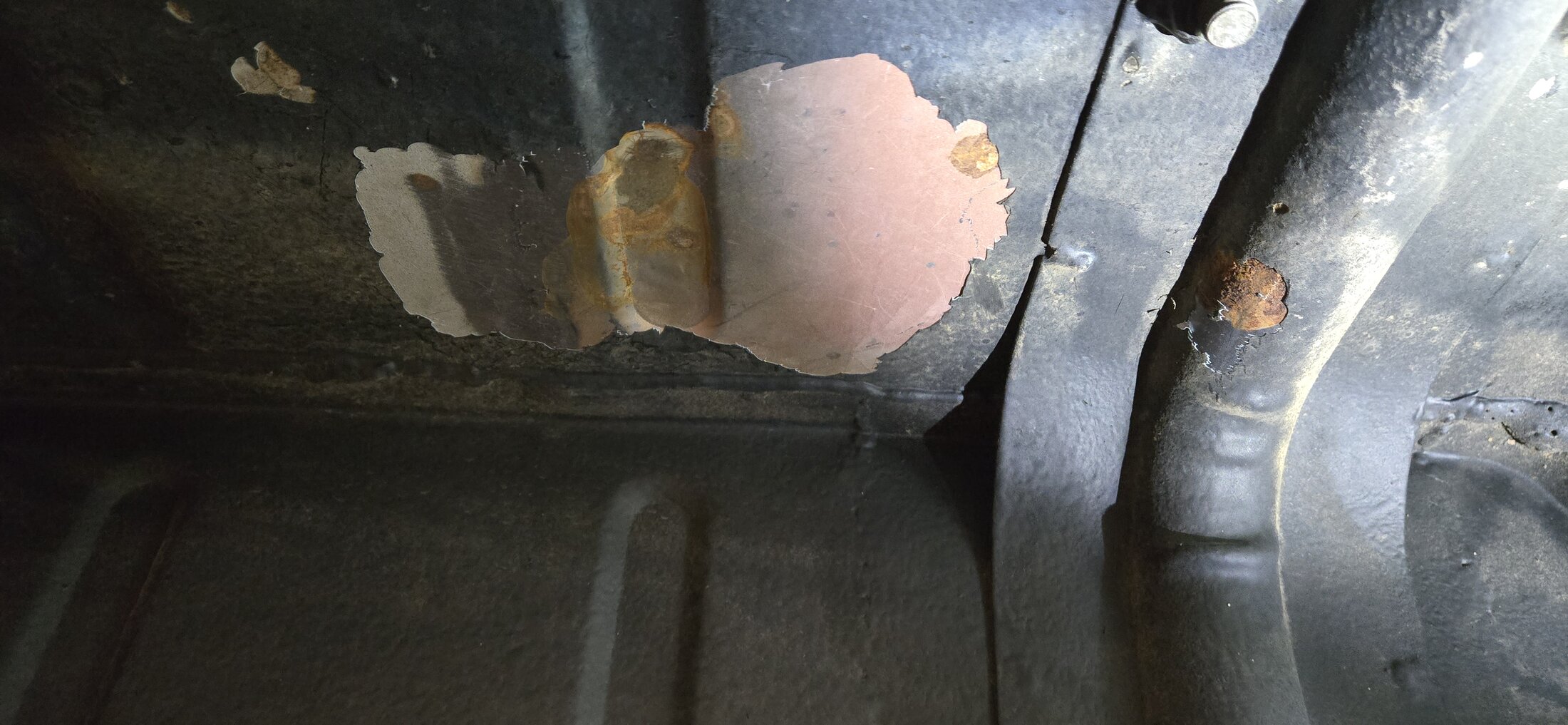

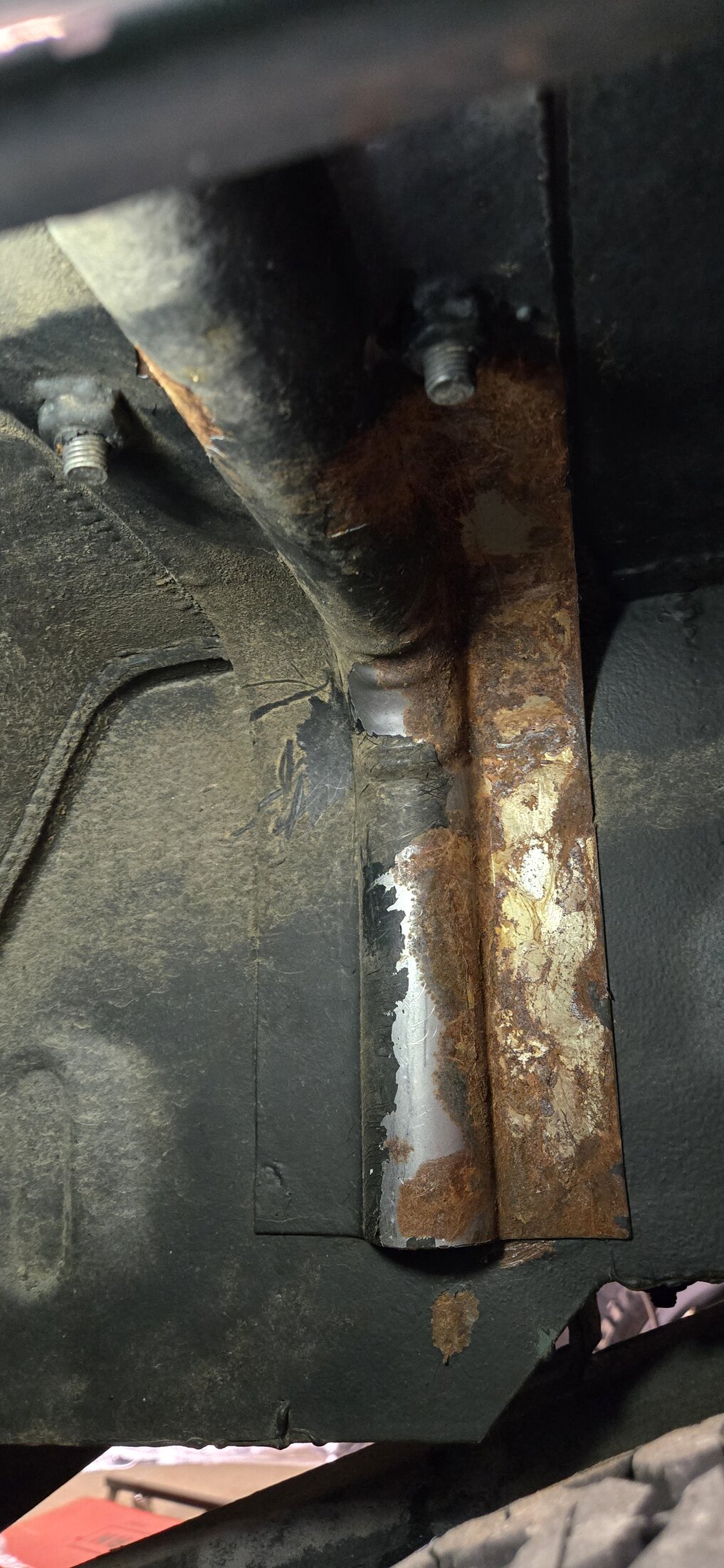

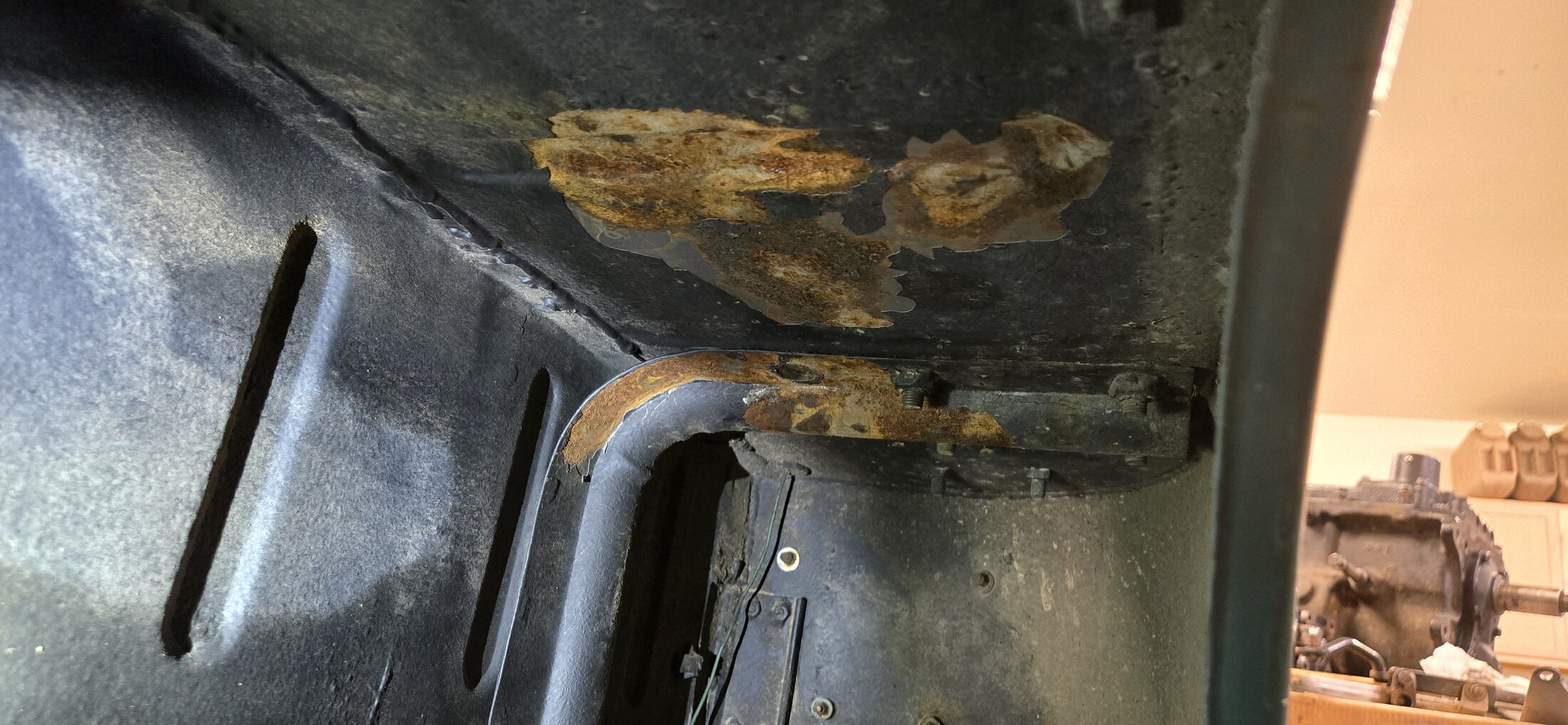

Pics of the wheel wells, there's a common denominator between all of these areas that the epoxy primer failed. These have all been areas that I patched with fresh steel, either from Real Steel, or local sheet metal.
The one area that I haven't seen anything fail is the rear sill that I got from @Awl_TEQ back in the day.
I don't know if there is a difference between the metals, or a difference in coatings across the border to the north.
Or it all boils down to piss poor prep on the body guy. (Me)
View attachment 3798577View attachment 3798578View attachment 3798579View attachment 3798580
Could it be mill scale? I've read if it's not addressed, it can effect paint adheasion overtime.
