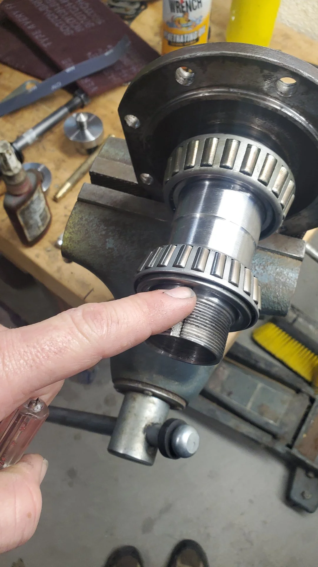

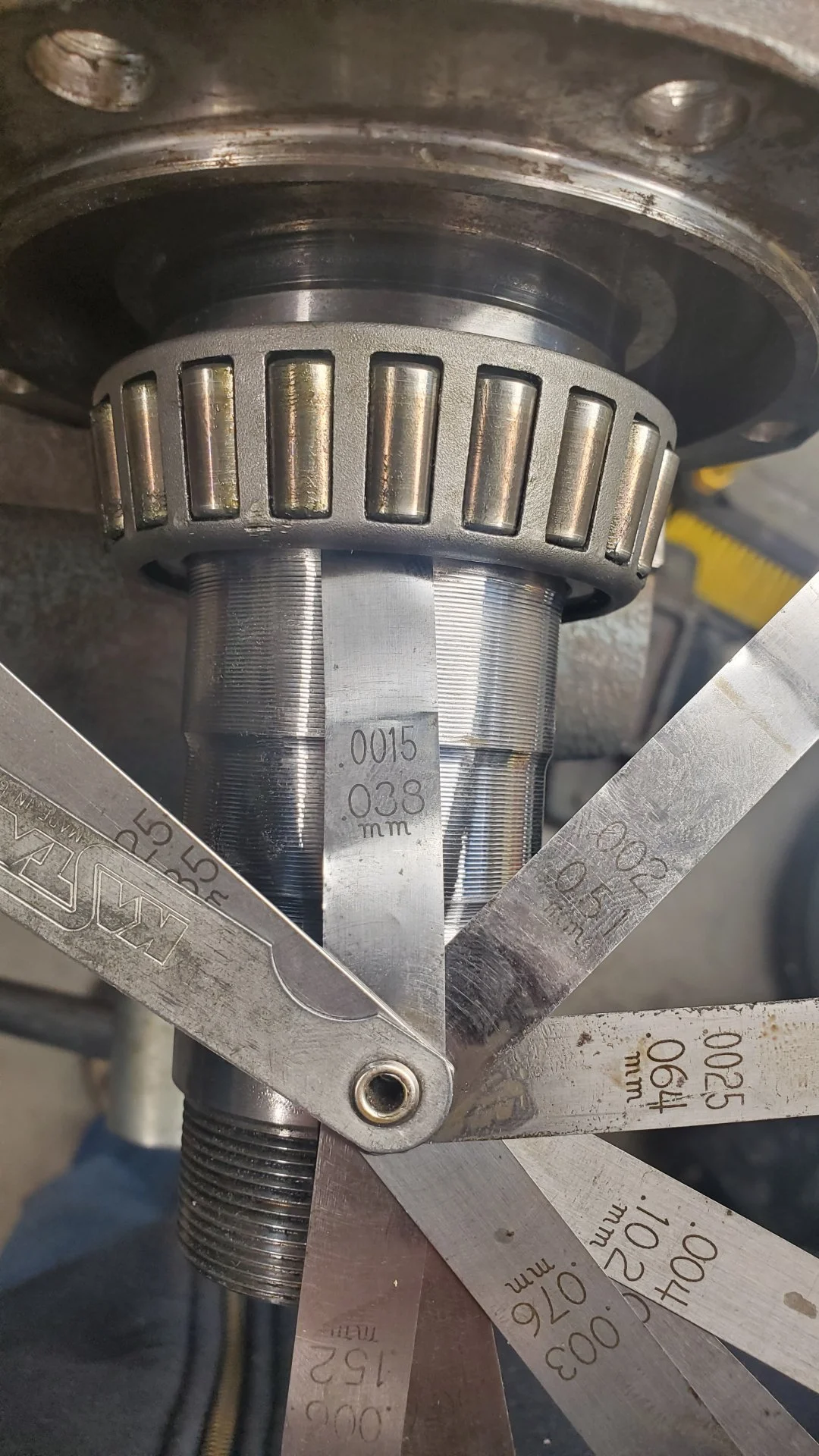

Anyone know how tight the tolerance should be here?
I can get a .0015 feeler under there but not a .002. I'm wondering if I may have some problems here. This is also the side that looked like the wheel bearings had spun.
Should the inner races be tight on there?
Should I tack the inner race in place and chuck a for sale sign in the window?
inquiring minds want to know.

Very nice pics CPT Ryan. Extremely helpful. Most folks are visual learners. This is the type of visualization that is worth a chapter in the FM....
The loose clearance of the caged bearing isn't as important as the assembled clearance against both races which you can control by feel, right?
The more I think about it I lean towards just that.
The shoulder of the inner race is tensioned by the shoulder on the spindle, all held by the tension by the outer bearing and the washer/axle nut torque.
But it still seems just a little too loose IMO, or maybe I'm just overthinking it all together.
I wouldn't want much if any clearance. Is it possible there is some taper on the shaft?
Someone mentioned that to me this morning, I don't think there was, but I'm not going to wager the homestead on that.

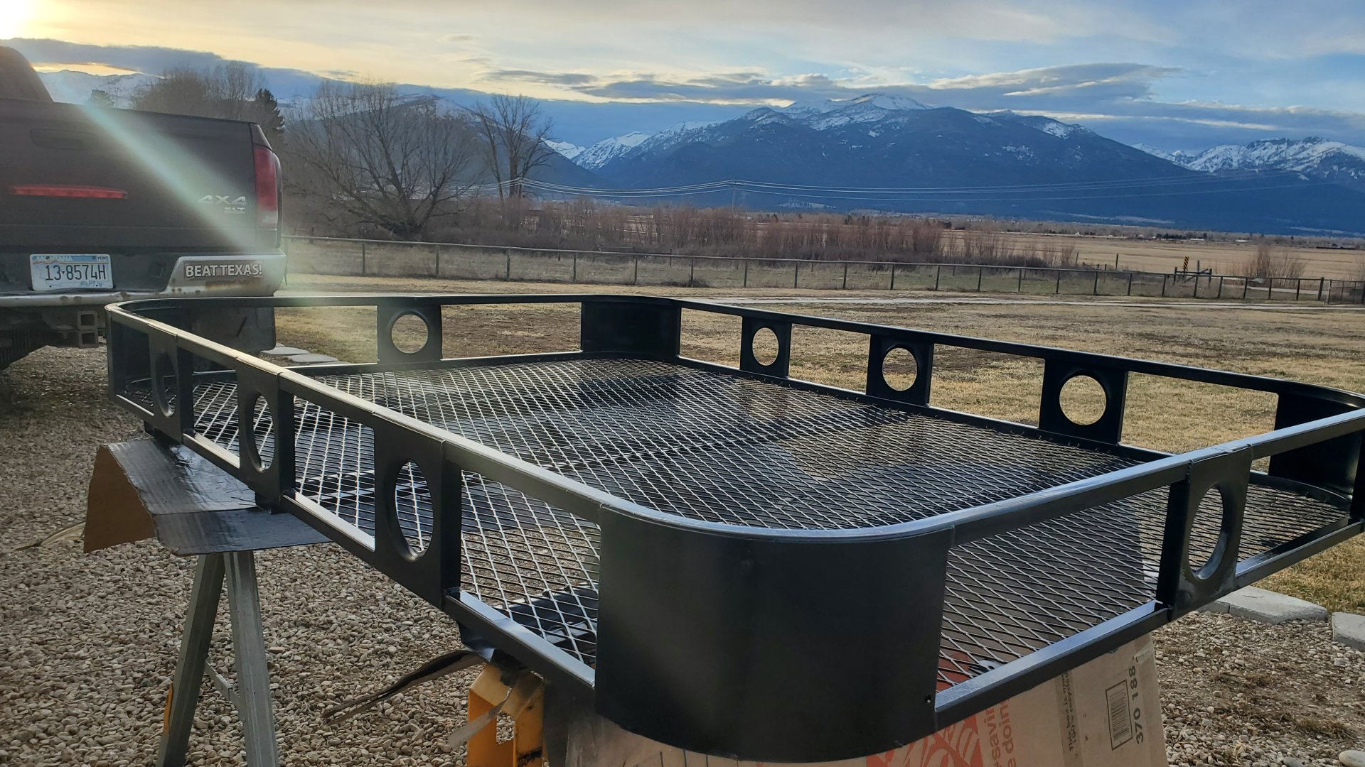

Shot some black gloss on the rack.

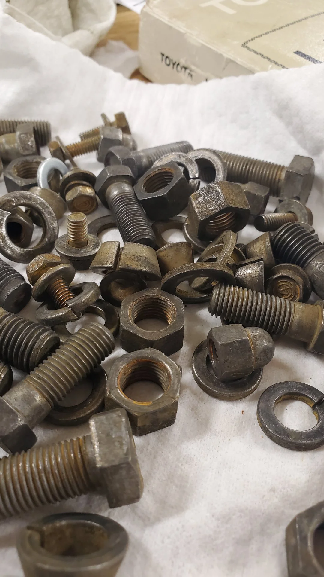

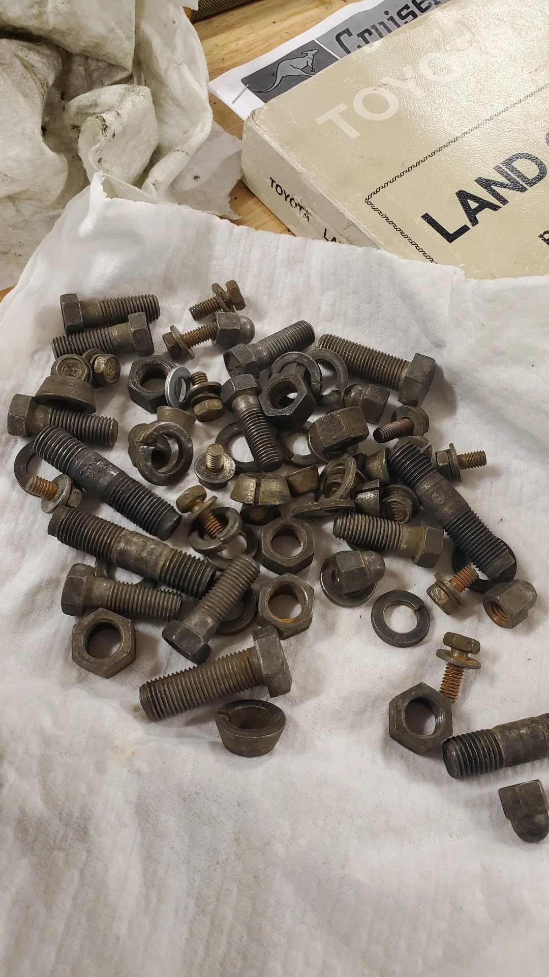

Dropped some hardware in the ultrasonic cleaner at work today, was not disappointed.

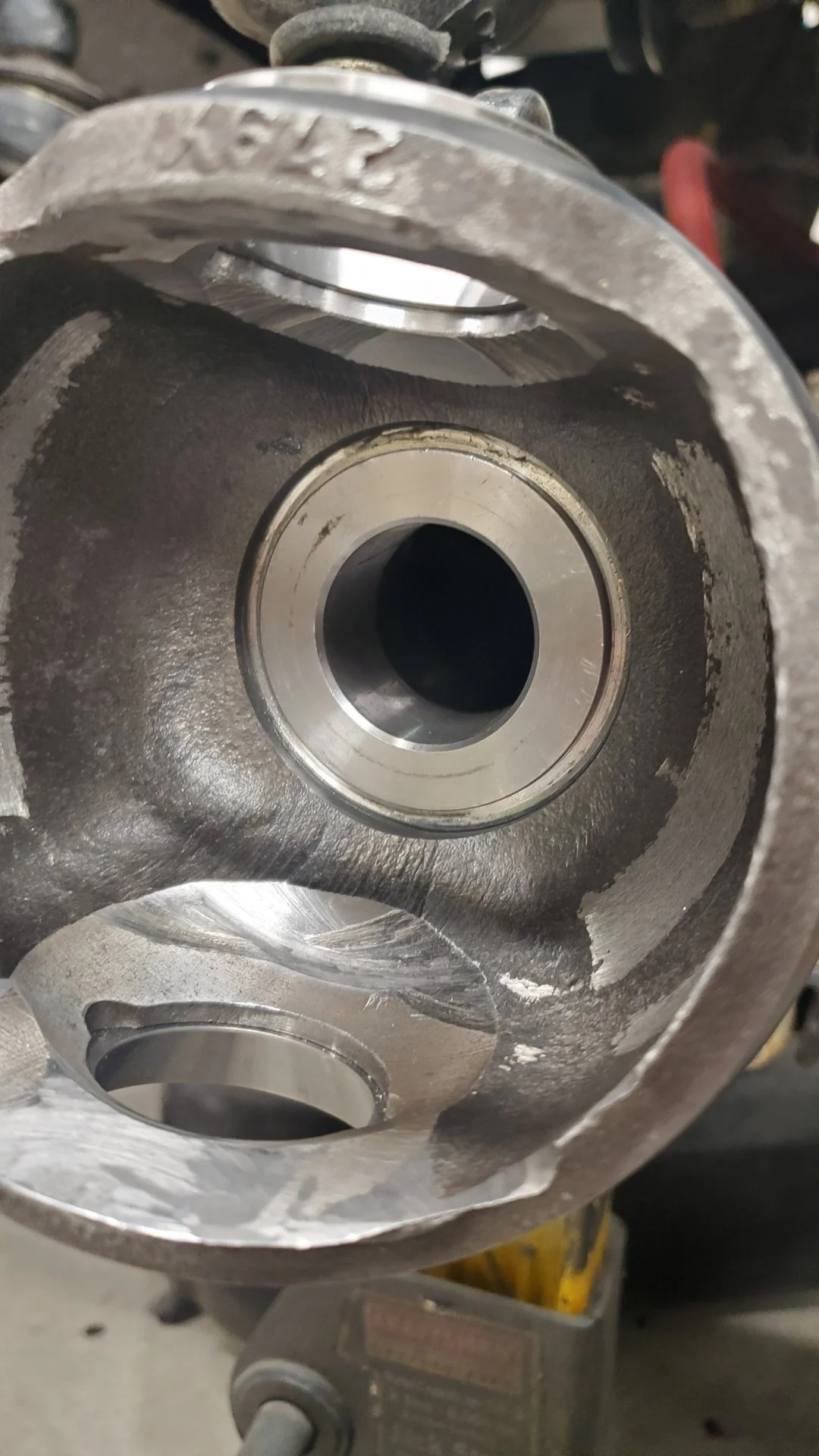

Started to prep the other knuckle for measurements and reassembly.

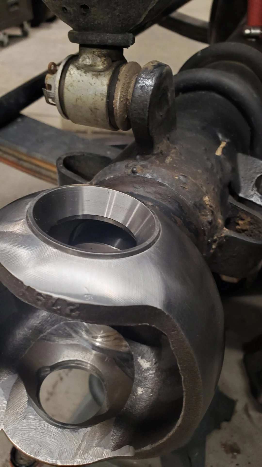

Polished up the ball.

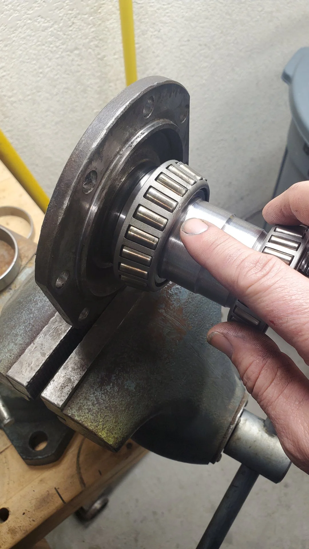

Set the outer races.
Installed the pointer for the centering tool.
