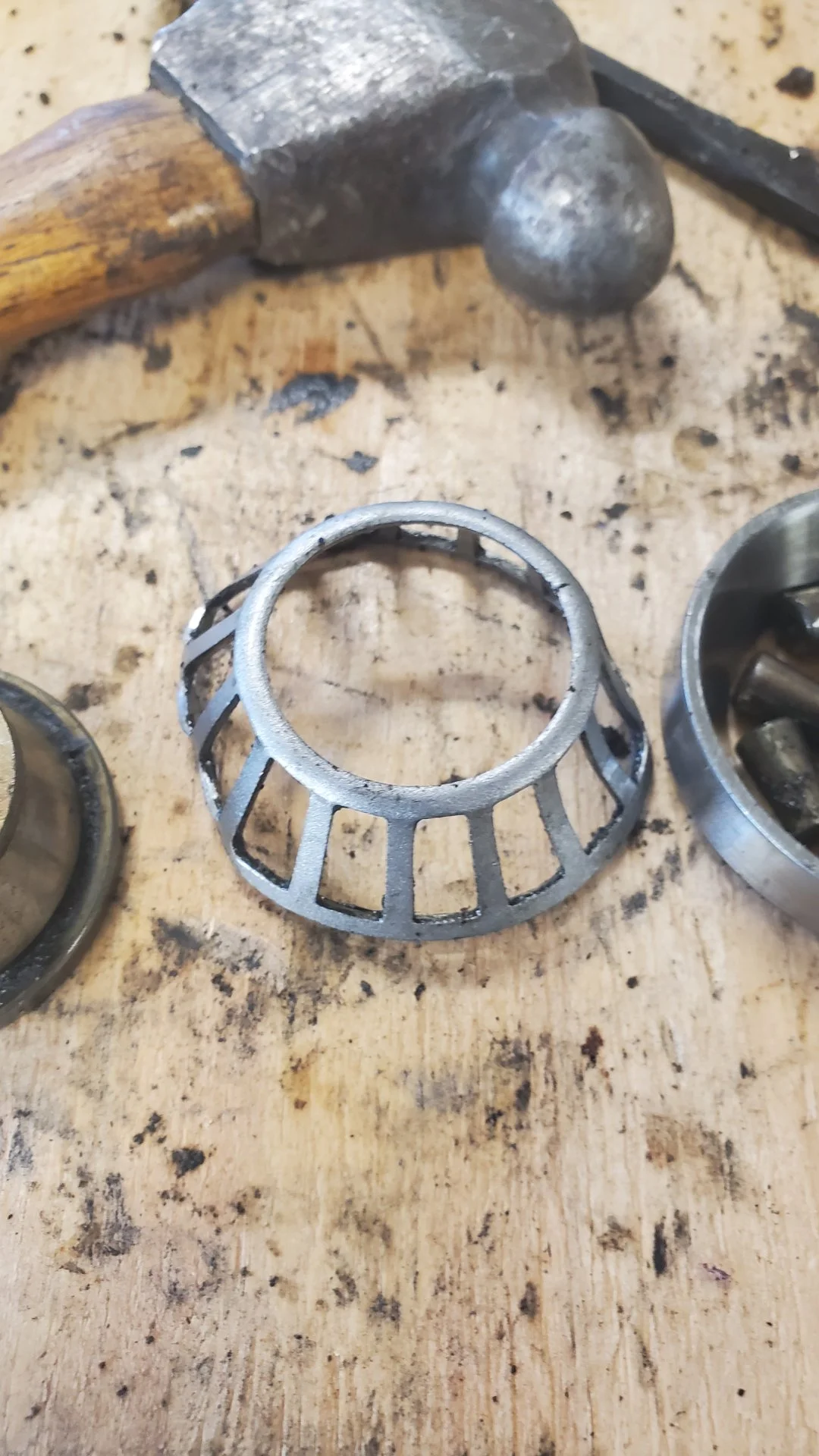

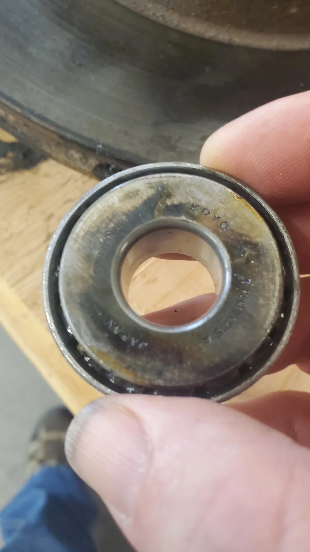

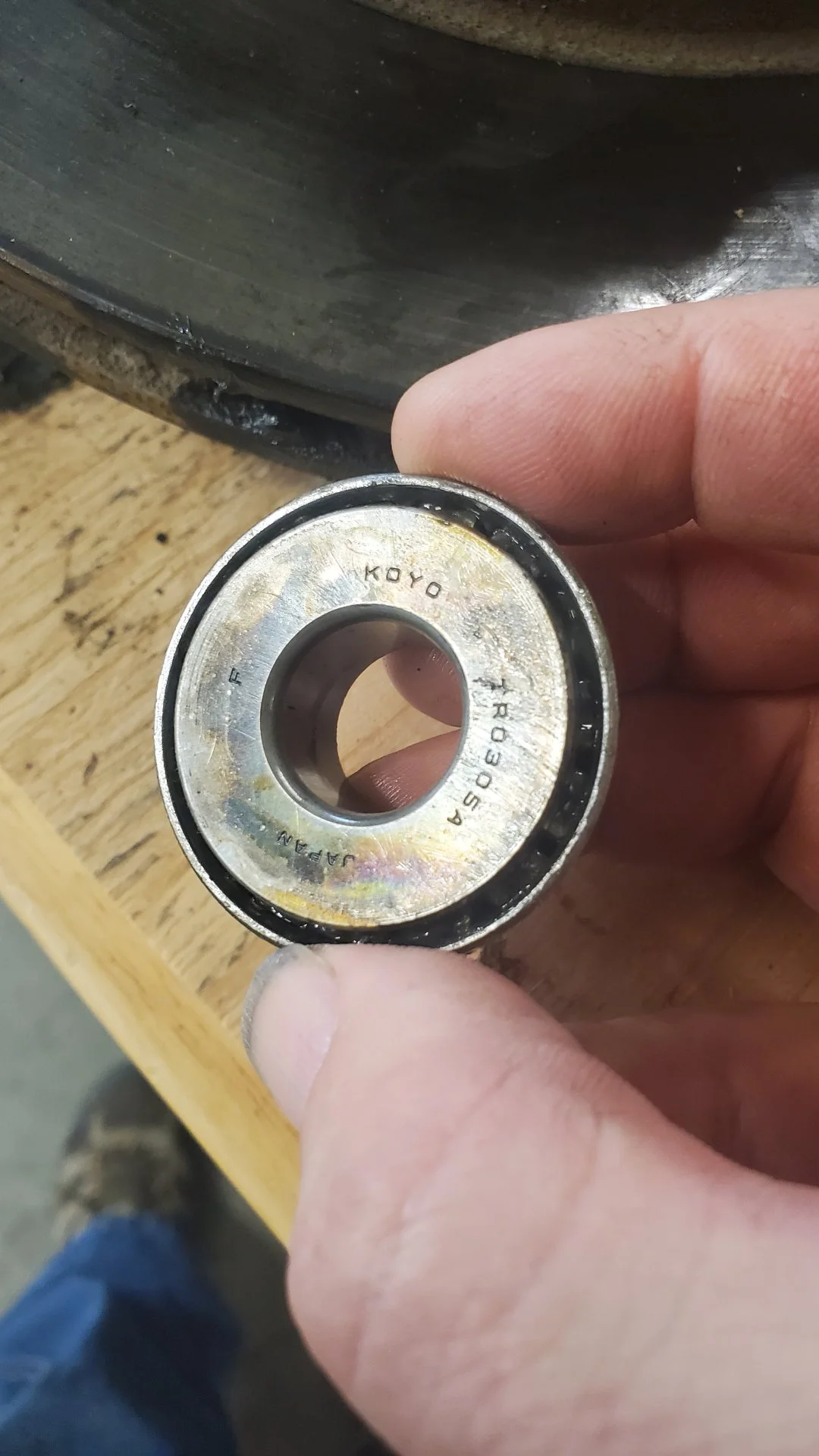

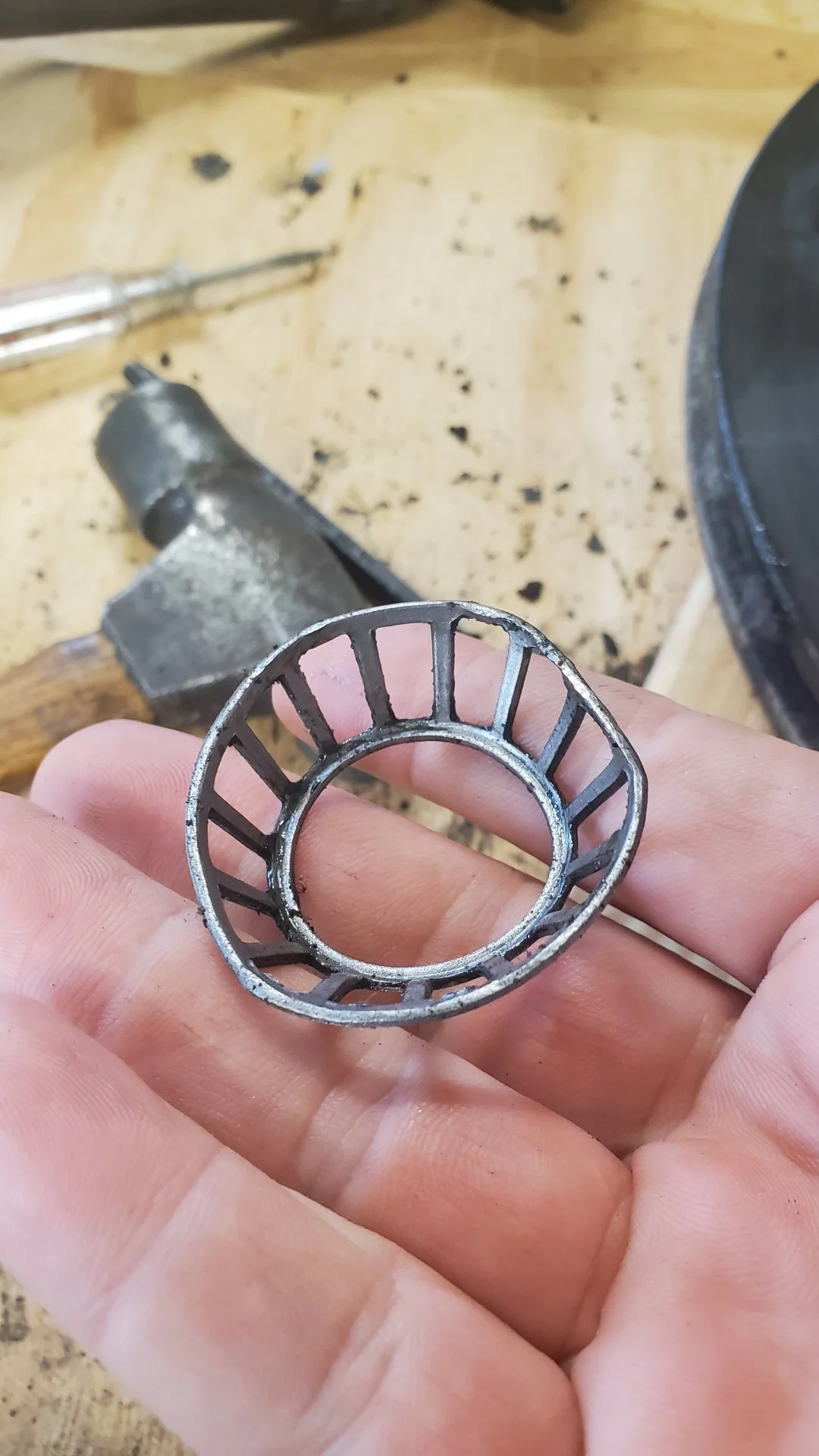

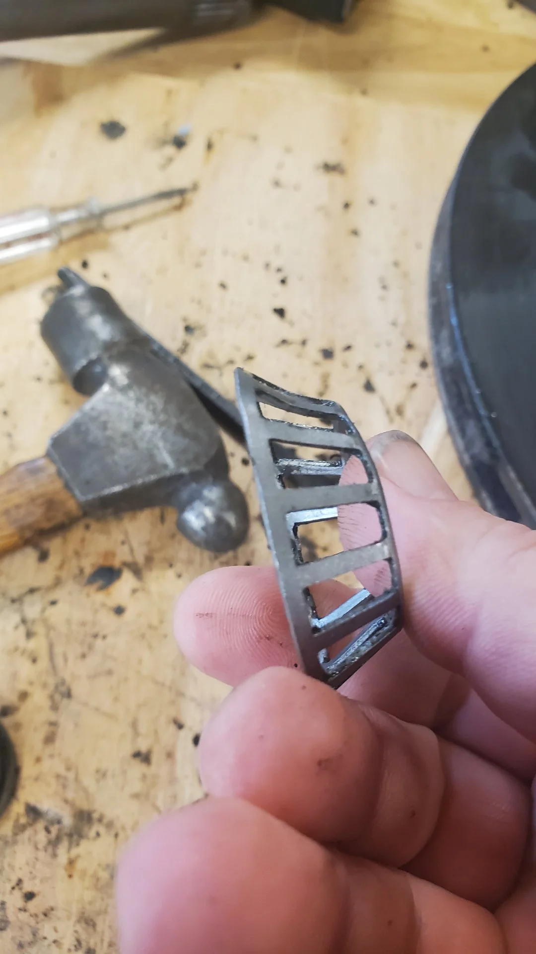

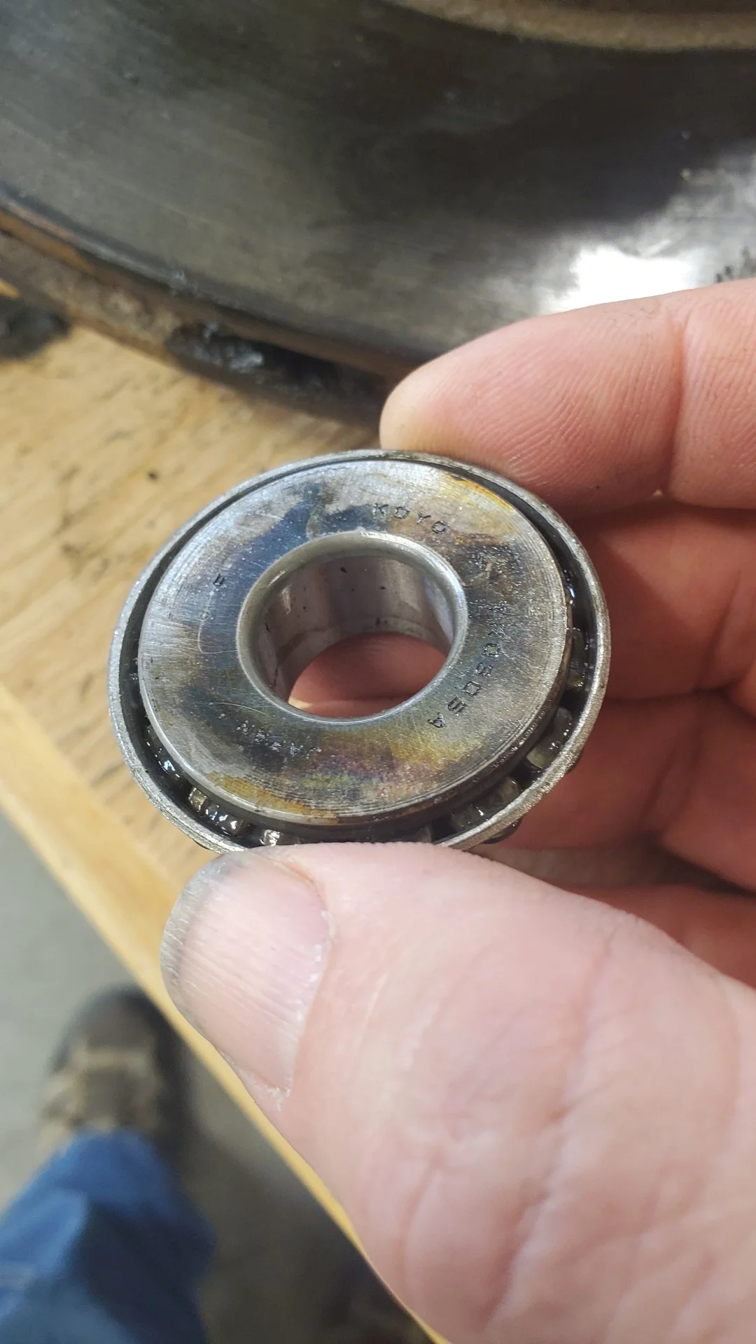

I did have some weeping on the knuckles but surprisingly there wasn't any gear oil in the birf. It did look like the drivers side knuckle had some problems. Like maybe it got a little hot at some point. Smelled funny also.
I'm not really sure about this, it is from the upper driver's side of the knuckle. I can't really say it happened during disassembly or was there prior, there wasn't any play in the front end, on jackstands or on the ground, everything felt tight.
Lower drivers side, looks like it got hot at some point. Strange.
