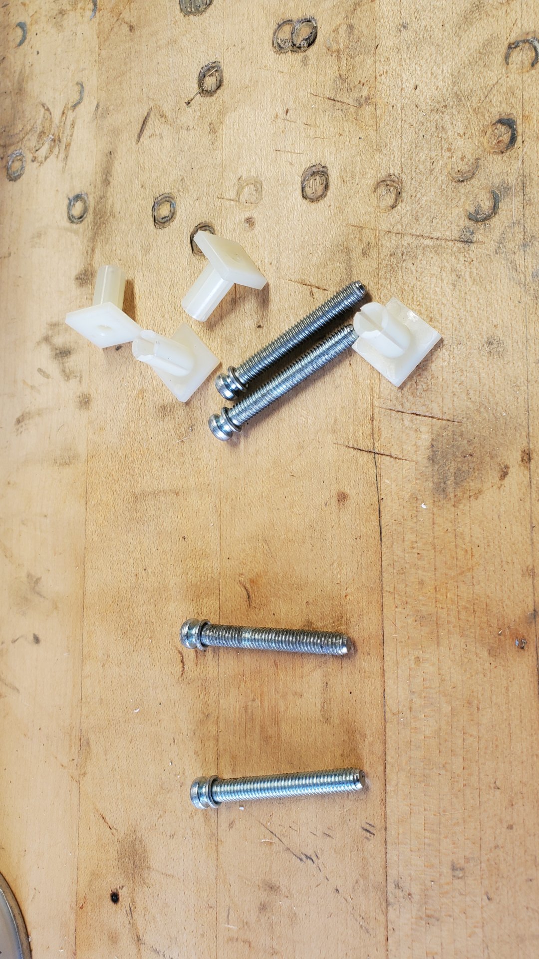

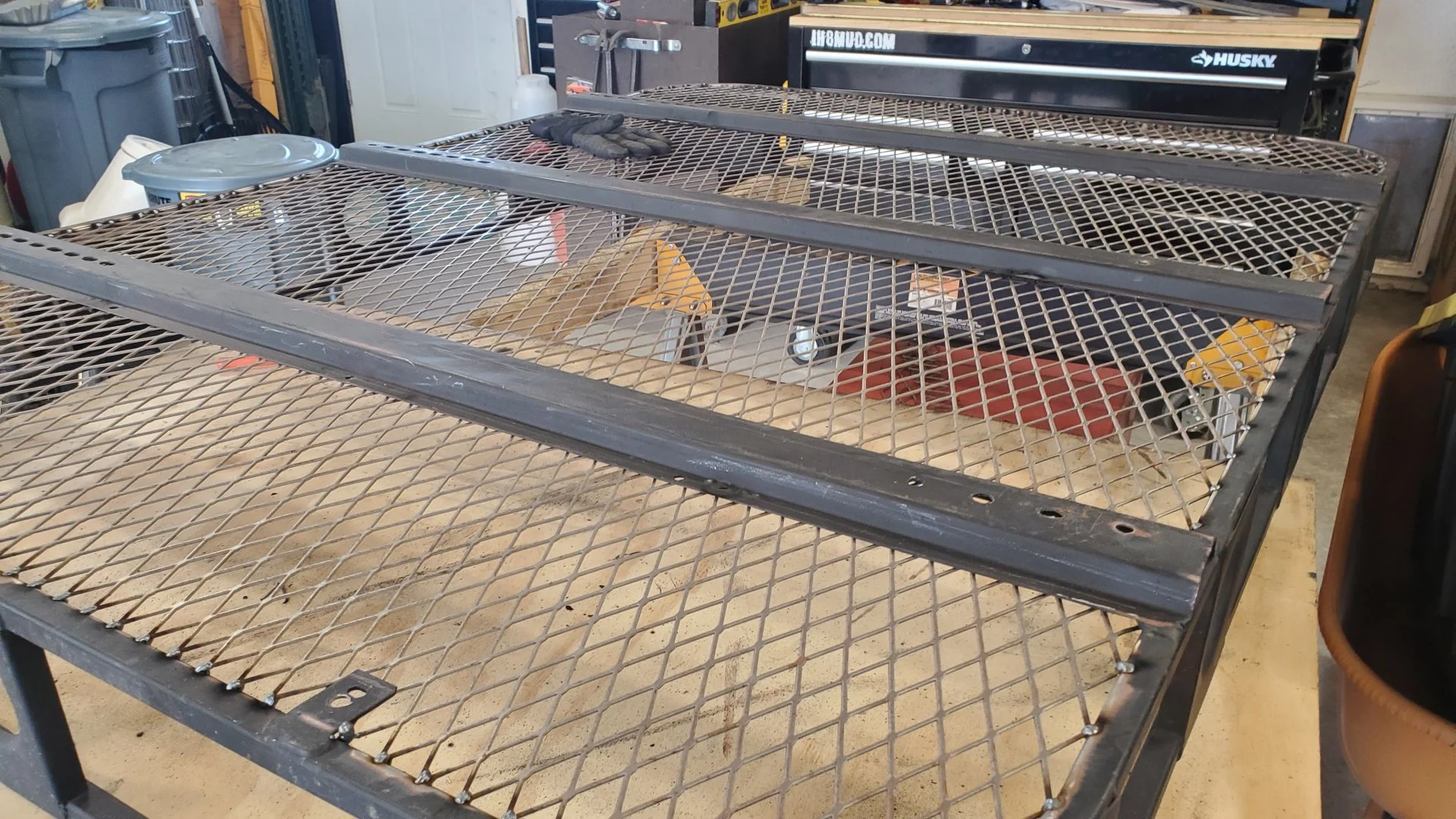

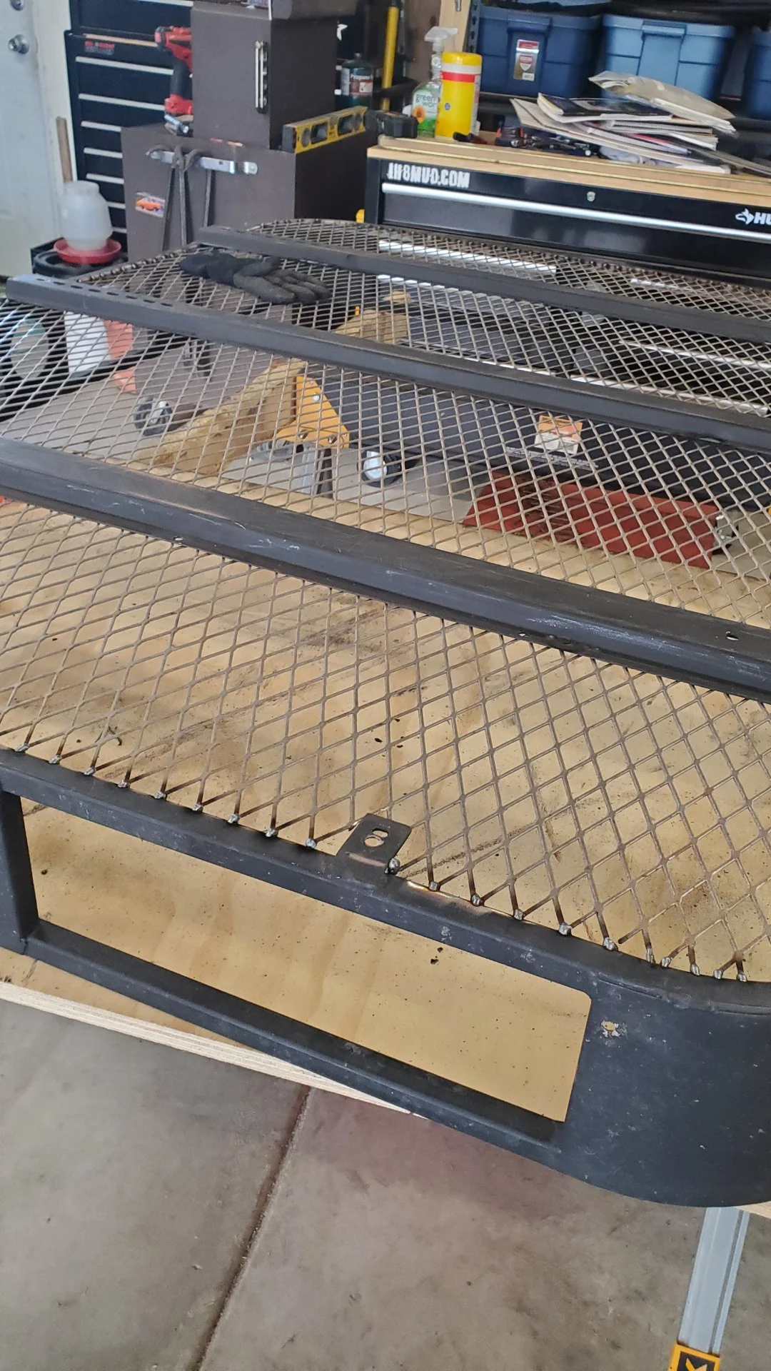

Decided to weld a floor in my roof rack in preparation for summer fun.

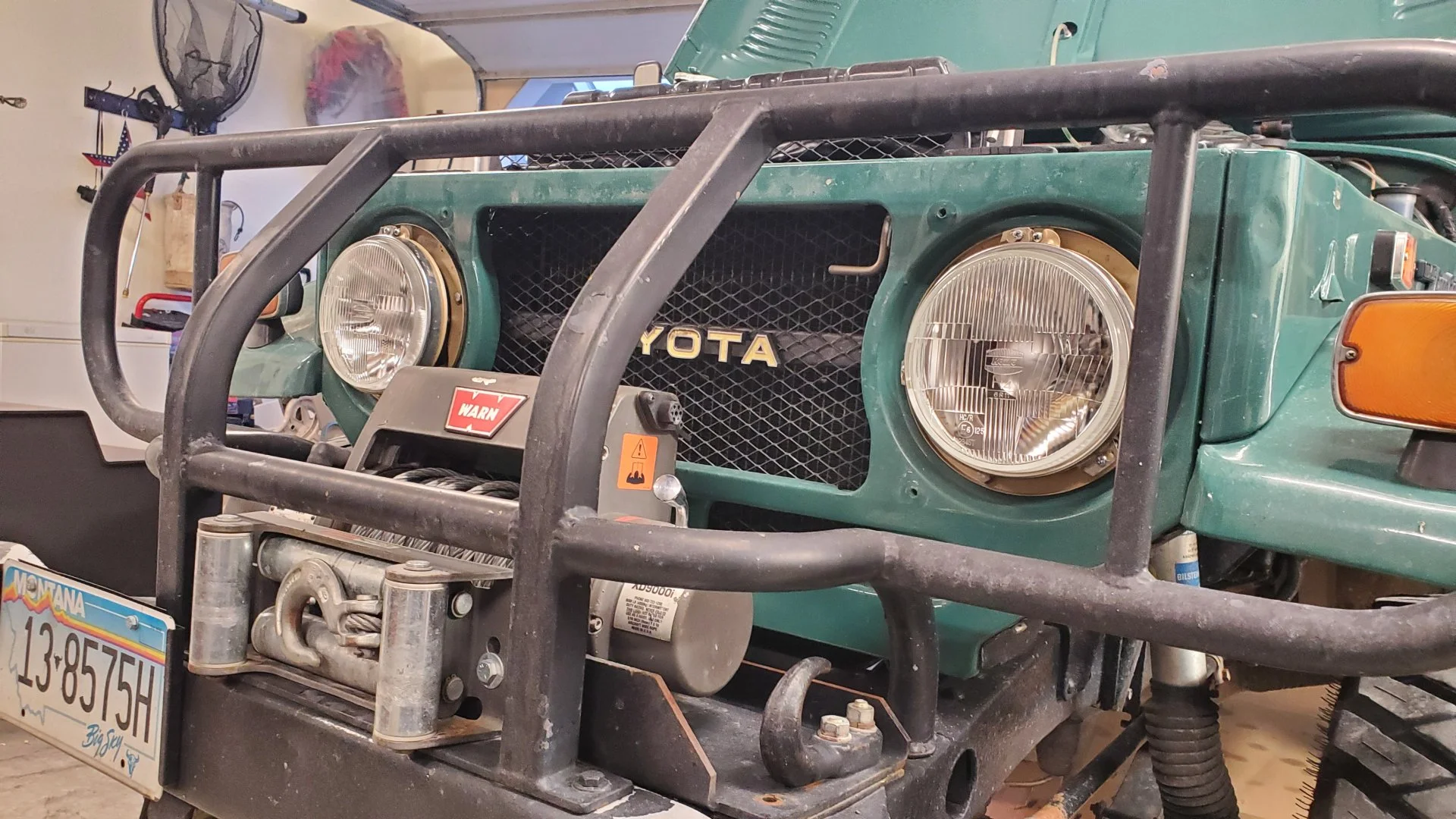

Found a bag o' goodies from @Jdc1 for the headlights I'm installing.

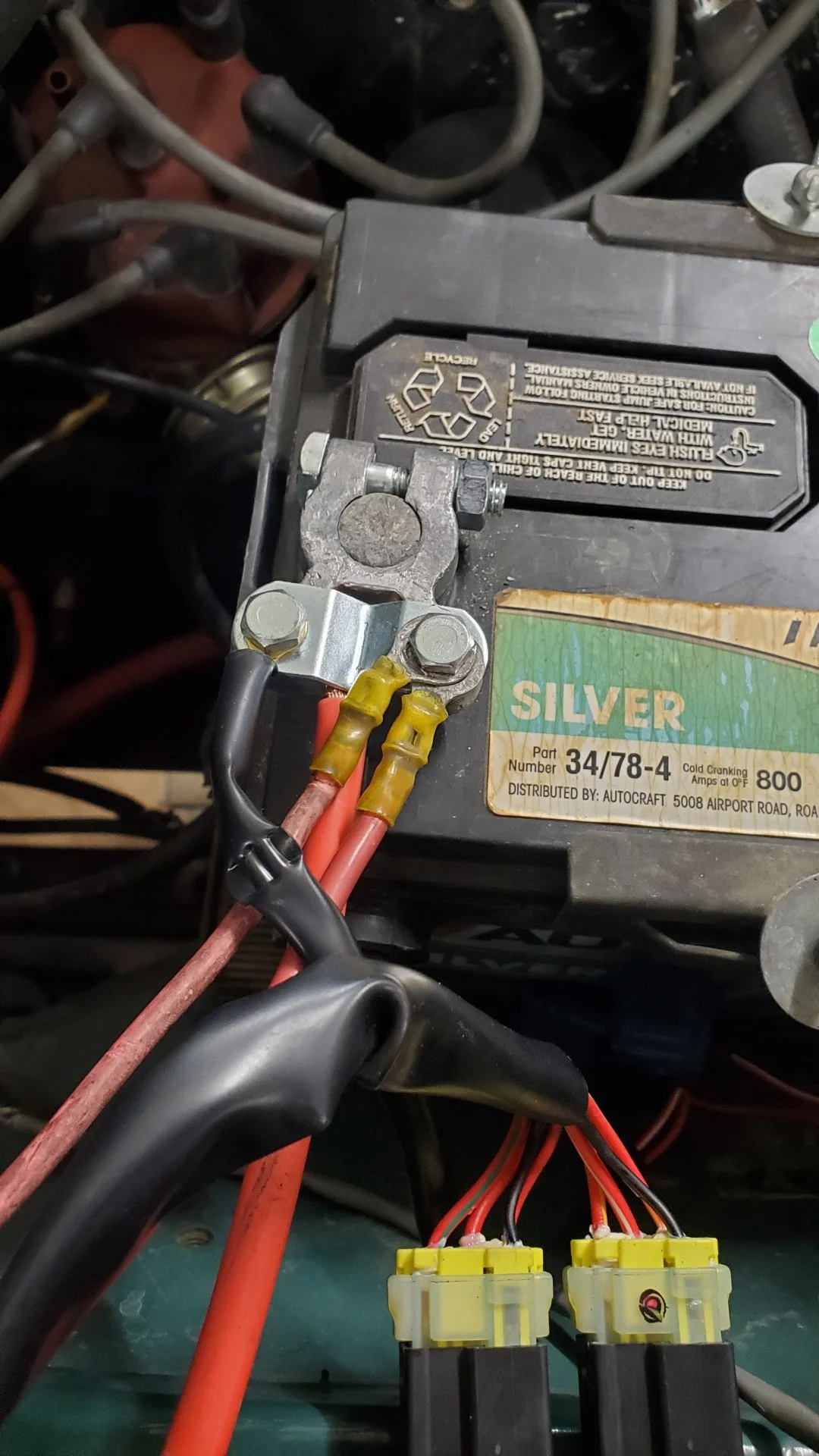

Broke the clamp on my battery cable, had to temporarily hack something together, mounted the relays, tied the harness in, I'm probably going to reconfigure some things under the hood.

I was trying to paint the rack after I cleaned it up bit ran out of sunlight and heat!

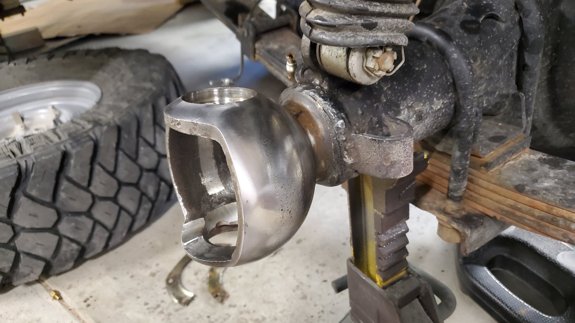

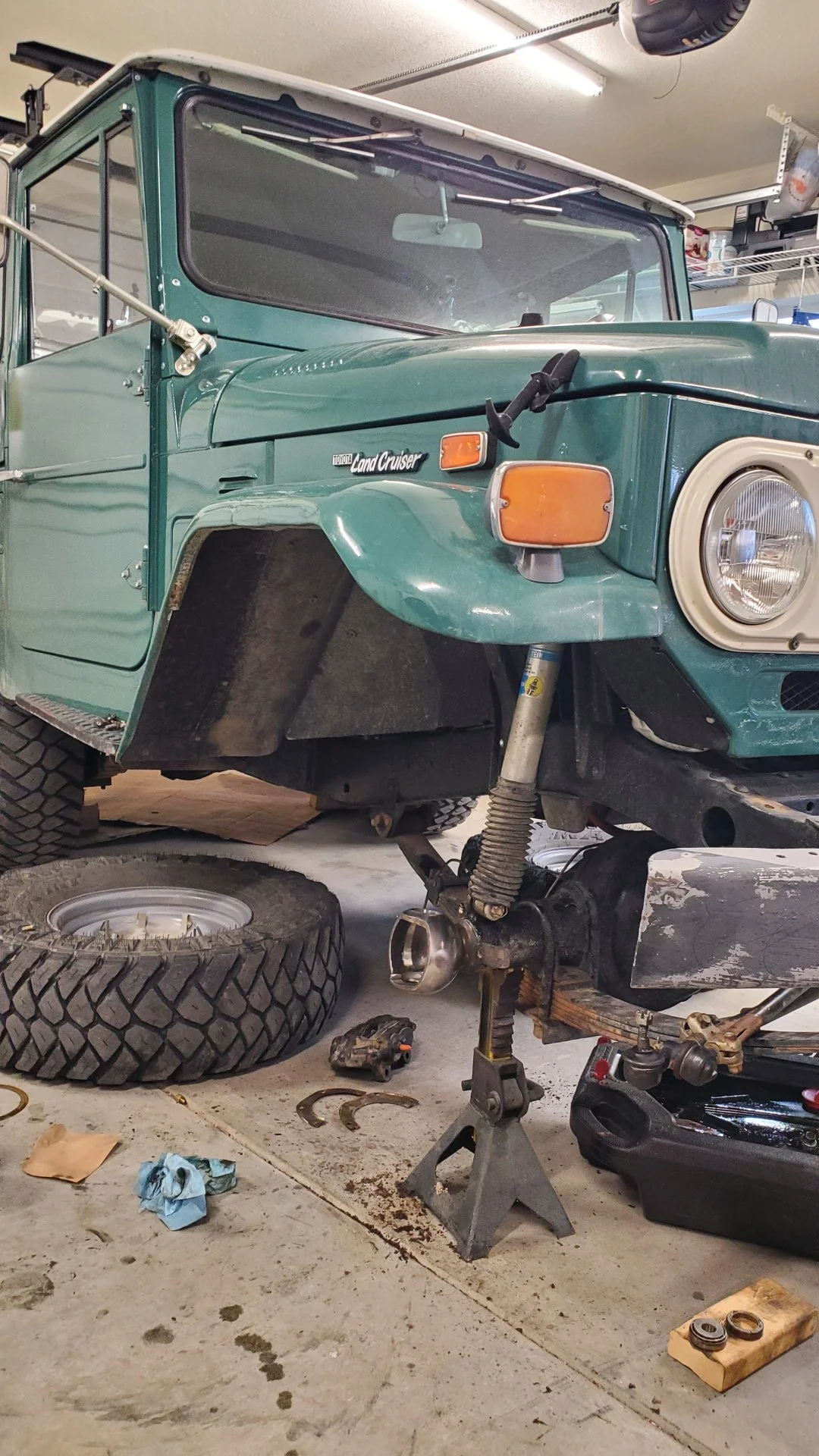

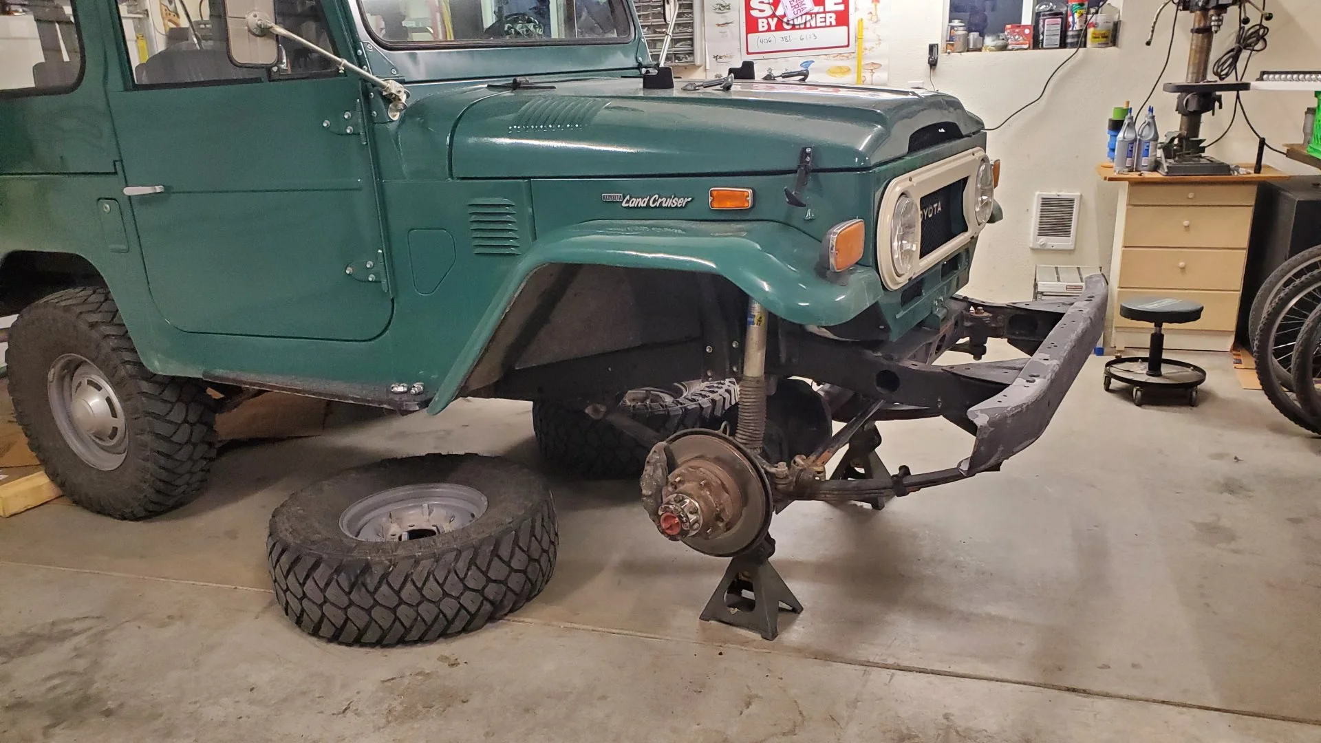

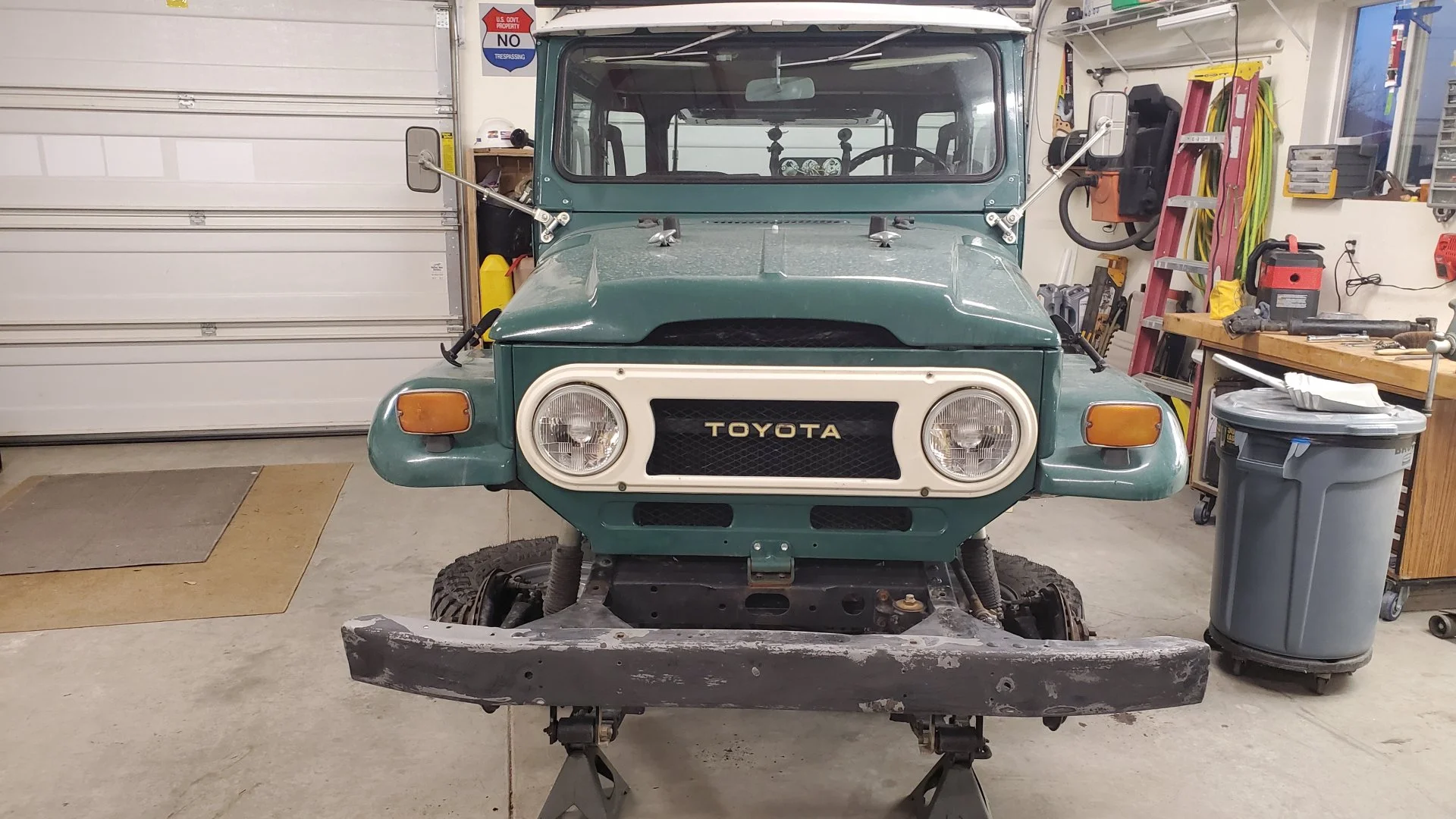

Decided to pull my deer kicker and winch off to clean them up along with the front bumper.

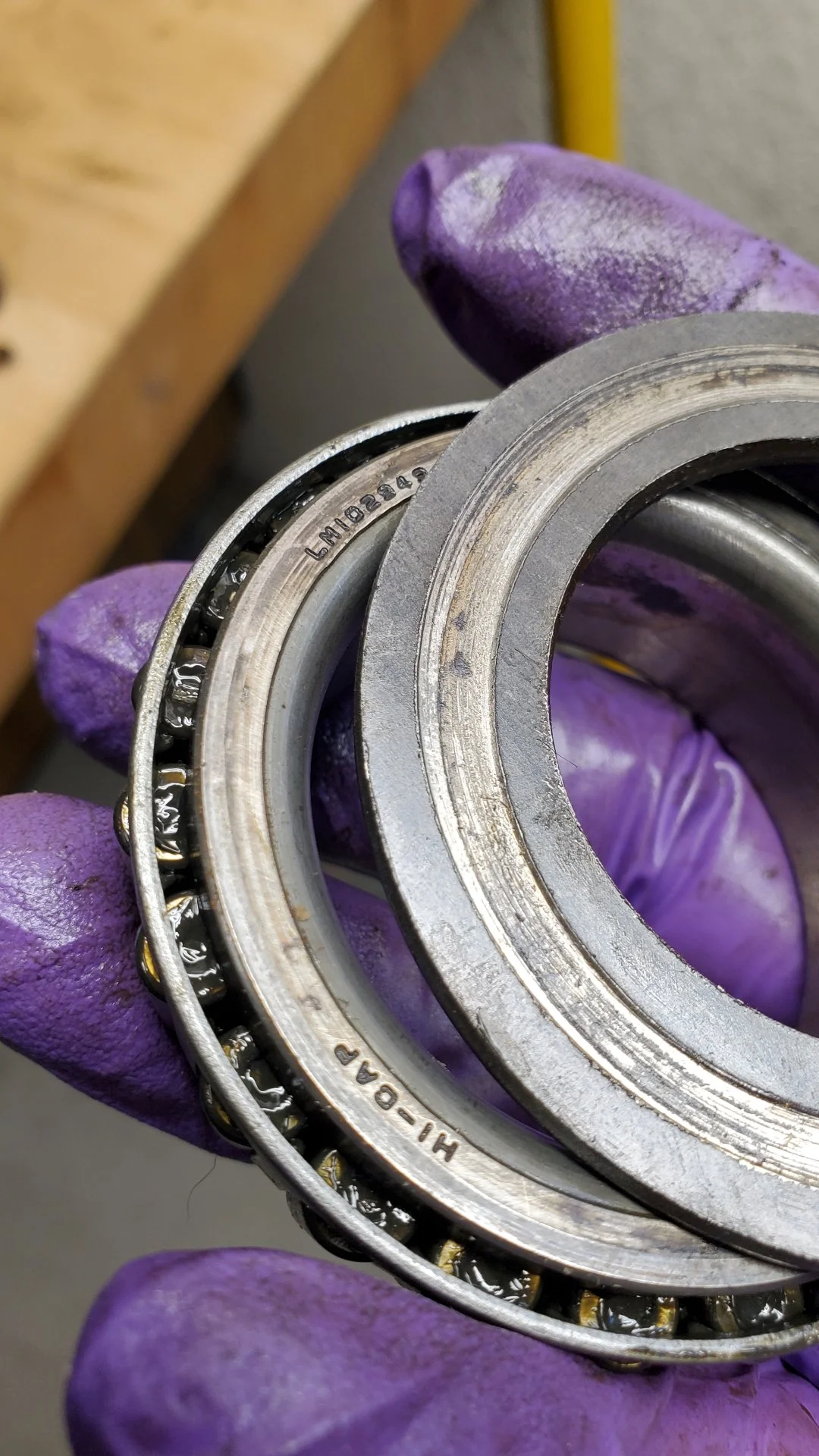

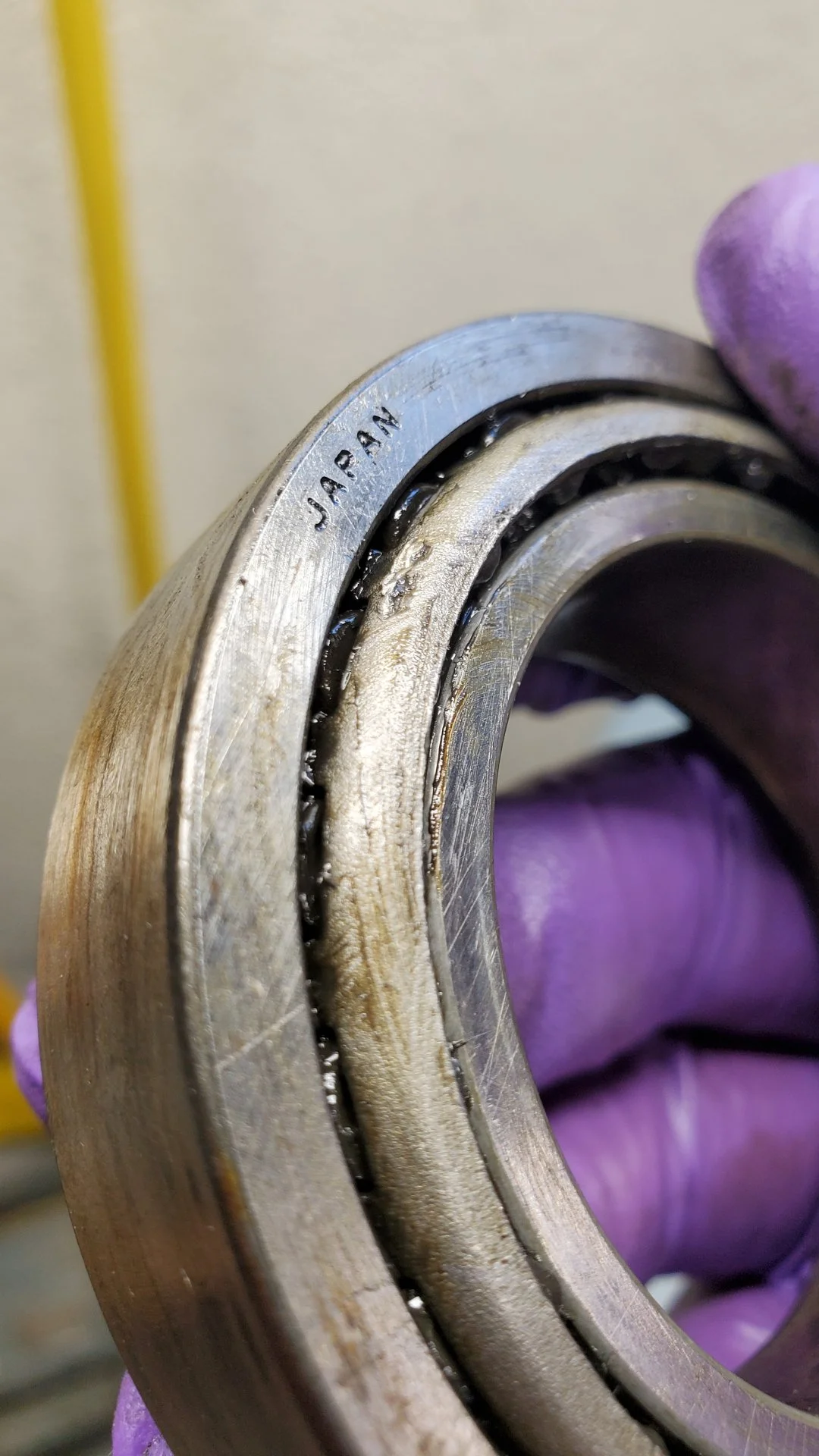

While that is going on I am also knocking out a knuckle rebuild.
The passenger side was pretty uneventful.

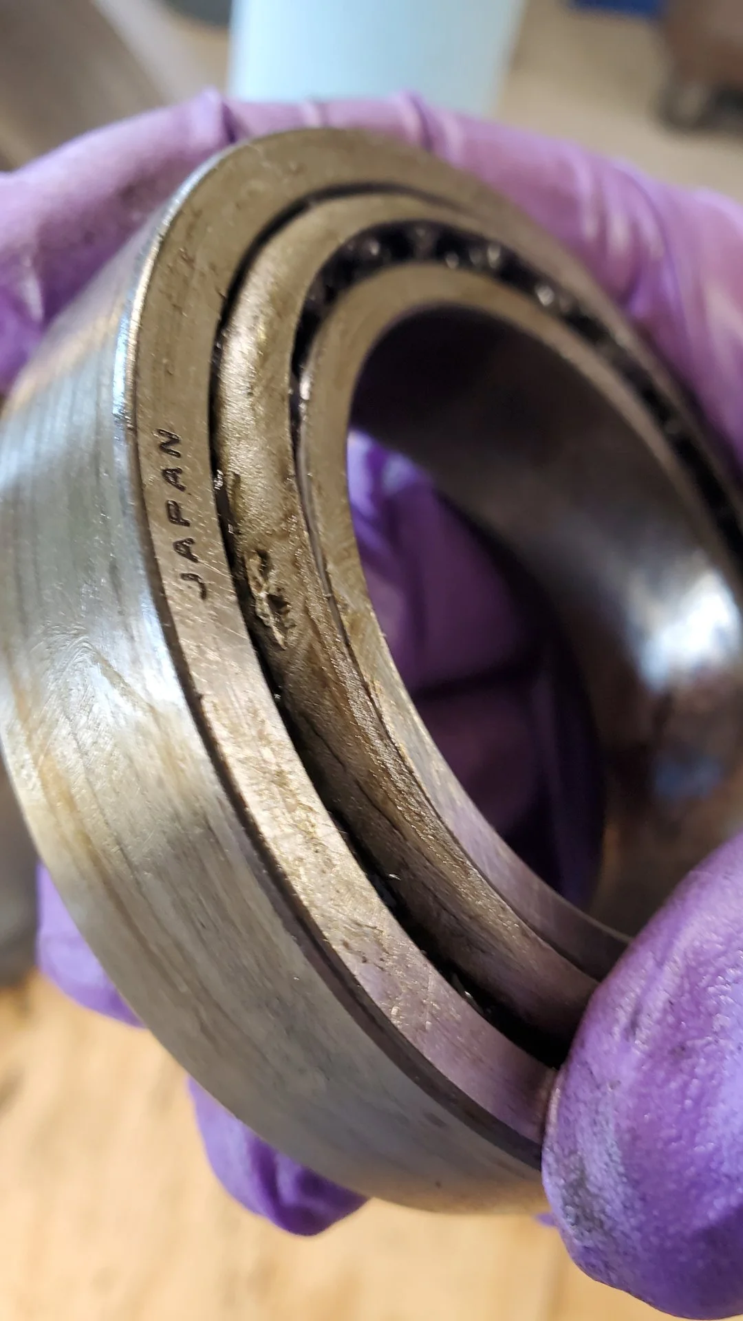

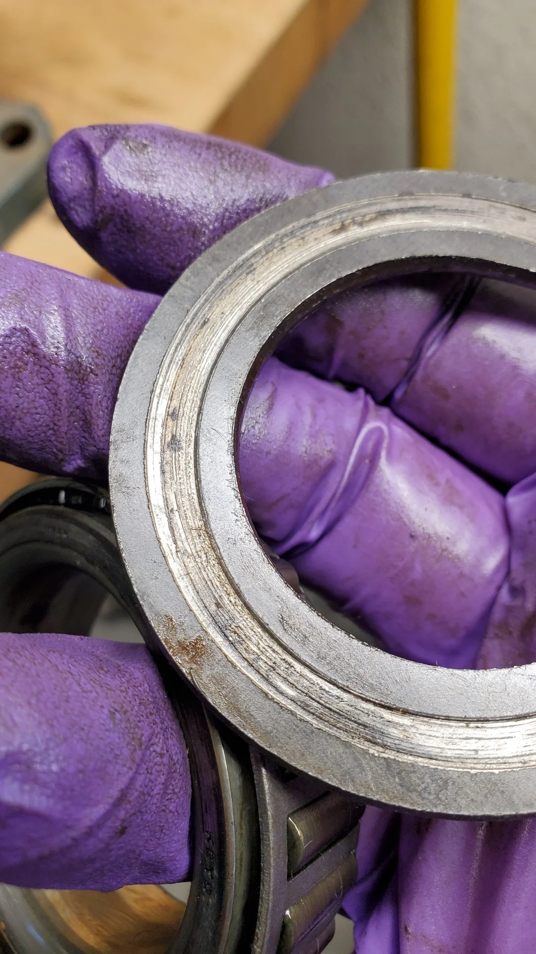

Aside from the wheel bearings on the passenger side looking like they've spun against the outer shim, and a ding on the race from an errant punch, they didn't look too bad.

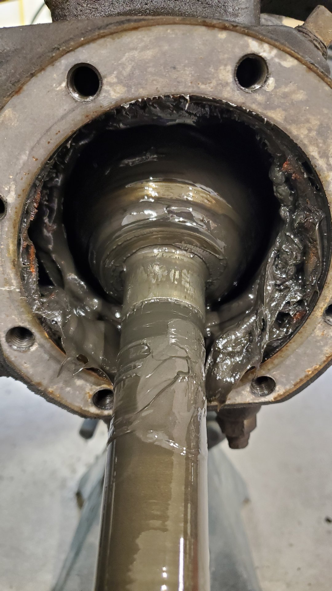

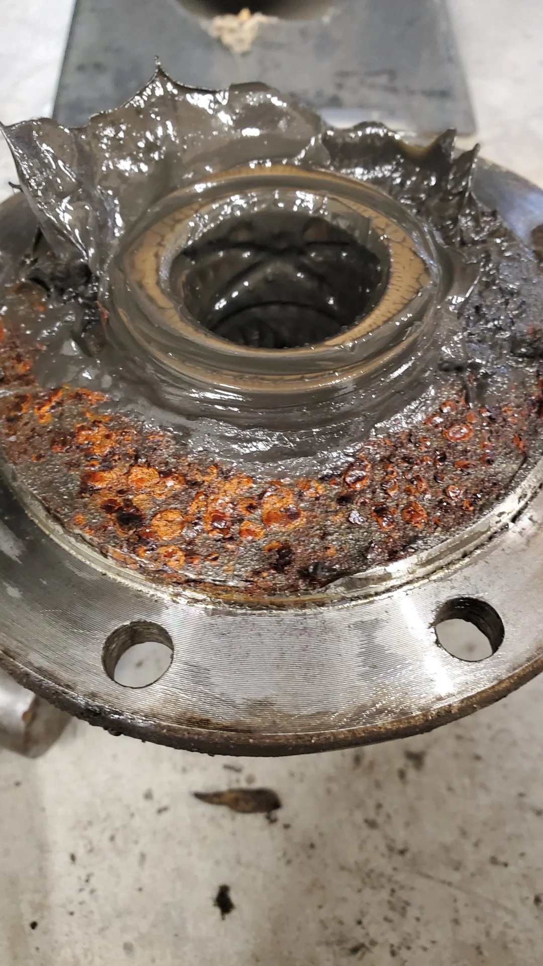

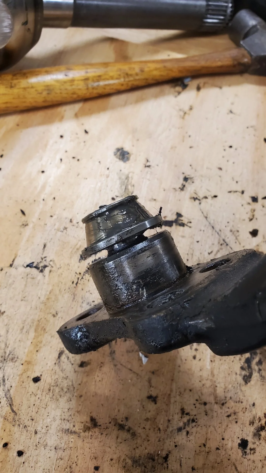

The driver side was a different story.

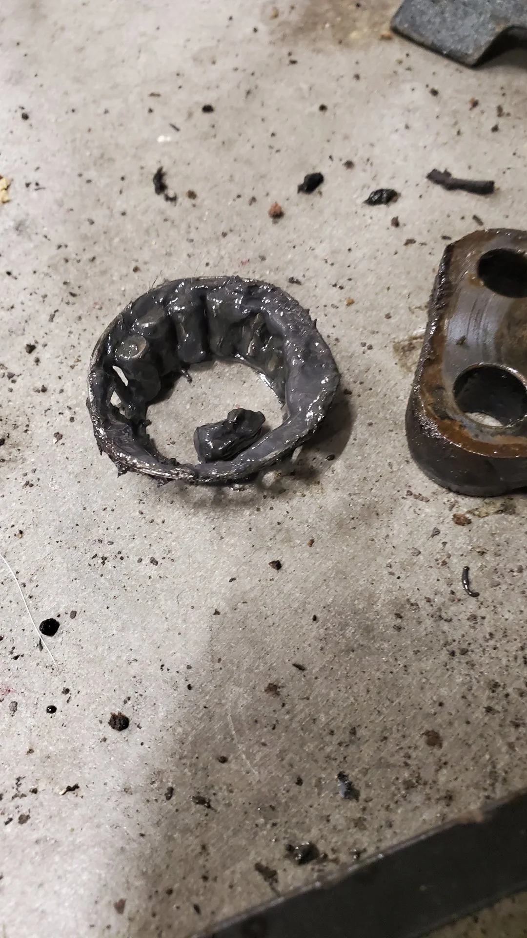

I had to pull the studs from the top of the housing, then spin the steering arm off of the top, that's when I found the trunnion bearing was sus.
It steered fine before I pulled everything apart, I'm thinking assembled it was held together fine, when I pulled it apart is when it gave up the ghost.
