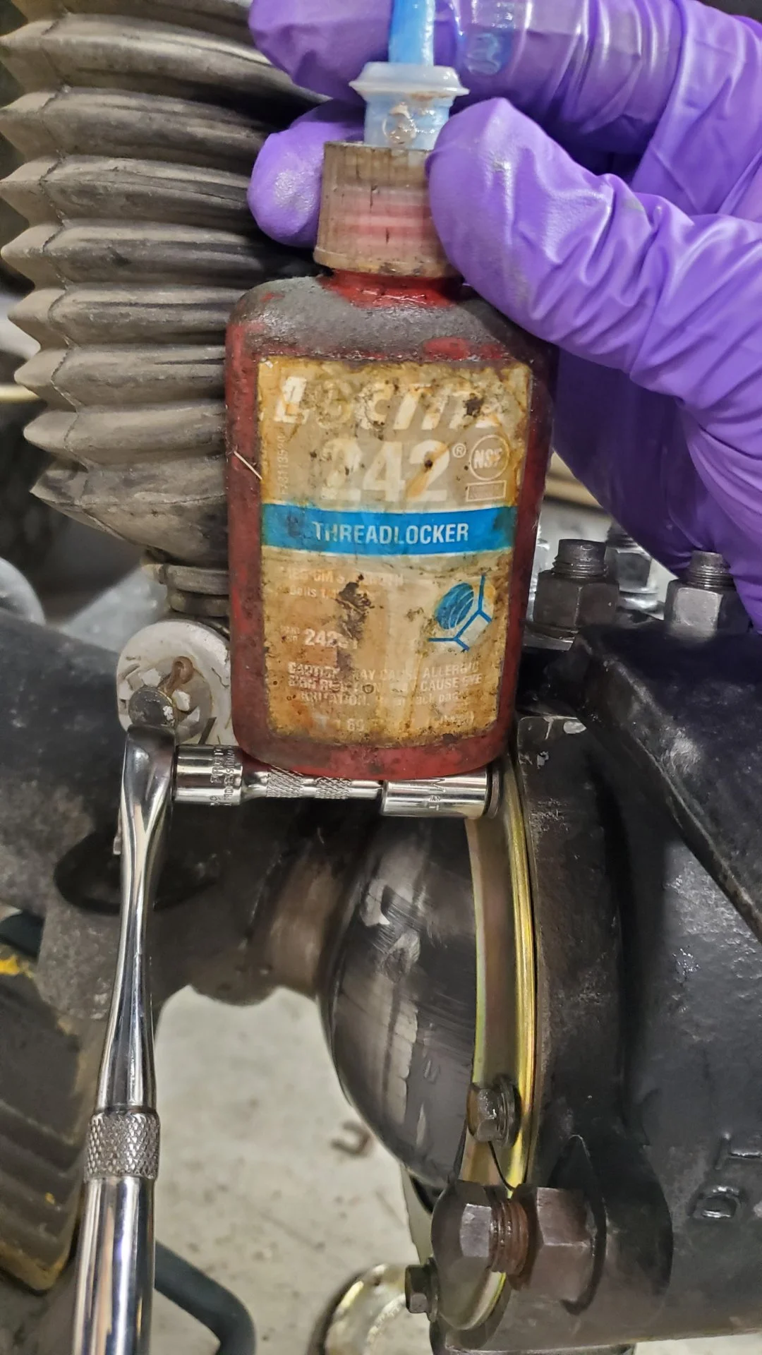

Blue mechanics glue on the bolts holding the wiper covers on, snug them down until the cover bottoms out on the back of the knuckle housing, then a fuzz more, just snug.

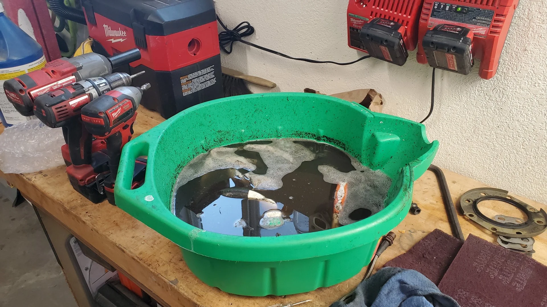

Just in case anyone thinks I work in a fancy shop, here's my parts washer setup.

Repeat as necessary, at least twice just to verify. Both inches and mm.

Very nicely done..... It's distracting sometimes to stop in the middle, grab your camera/phone. Shoot pics and repeat. Thanks for posting this up. .:beer::beer::beer:👈:cool: 2 thumbs up for the parts washer.
