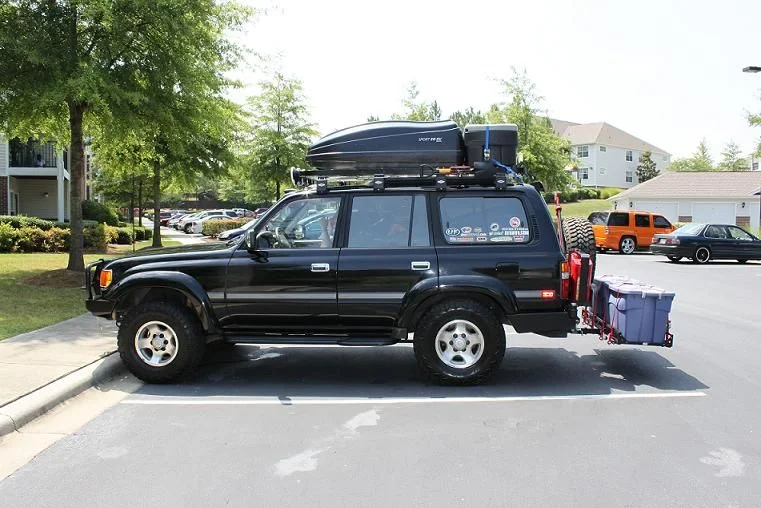

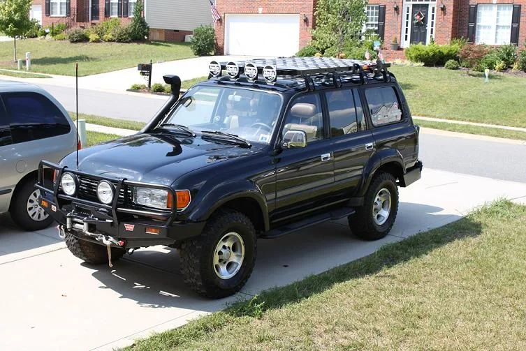

I finally finished my Wildyoats inspired aluminum roof rack. Took me a few weekends, but all in all it wasn't too difficult of a project. I started out with a bi-fold ATV ramp from Bass Pro Shops. Purchased some aluminum from a local metal shop along with rivets, Grade 8 hardware and rattle can paint from your friendly Lowe's store. Hella's were purchased on the cheap from eBay. And the gutter mounts were purchased from Mule roof racks. (Just look up the user Mule for more info.) These things are made out of 3/16" steel and are super beefy. The shovel and axle mounts are actually Swagman bike mounts. They work perfect for this sort of application and I added locking handles to keep anyone from heisting my tools.
The rack was finished just in time for our annual summer trip to the Outer Banks. It held everything plus the kitchen sink. Wind noise was only marginally louder with the rack. I'm very pleased with the final product. The 80 did great hauling me :steer:, the wife :princess:, and our 4 kids (age 5 and under) :bounce: :bounce: :bounce2: :bounce2:. We averaged about 10.1 mpg fully loaded down.

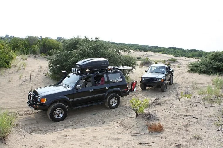

Here's another shot of the rack in action. This is on some of the sand dunes in Carova Beach, NC. These are the largest sand dunes on the east coast and the neat thing is there are wild horses running around that just live on the beach. We saw quite a few during our outing.

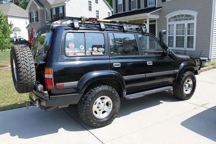

Looks great! .. now how about some close ups on the mounts. I would like to see how you attached the Mule mounts to the rack itself.
The gutter mounts are double slotted for adjustability up and down and also left to right. They can accomodate 3/8" hardware. The rack itself has 2" boxed side walls. I just drilled two 3/8" holes for each mount through the ramps boxed ends and mounted it to the gutter mounts with 3" long bolts.
Thanks for the info John .. just what I needed.

What size aluminum bar did you use and did you pop rivet to the ramps?
I simply used 1/8" X 2" wide aluminum strips that I pop riveted to the ATV ramp to create a floor for the rack.
