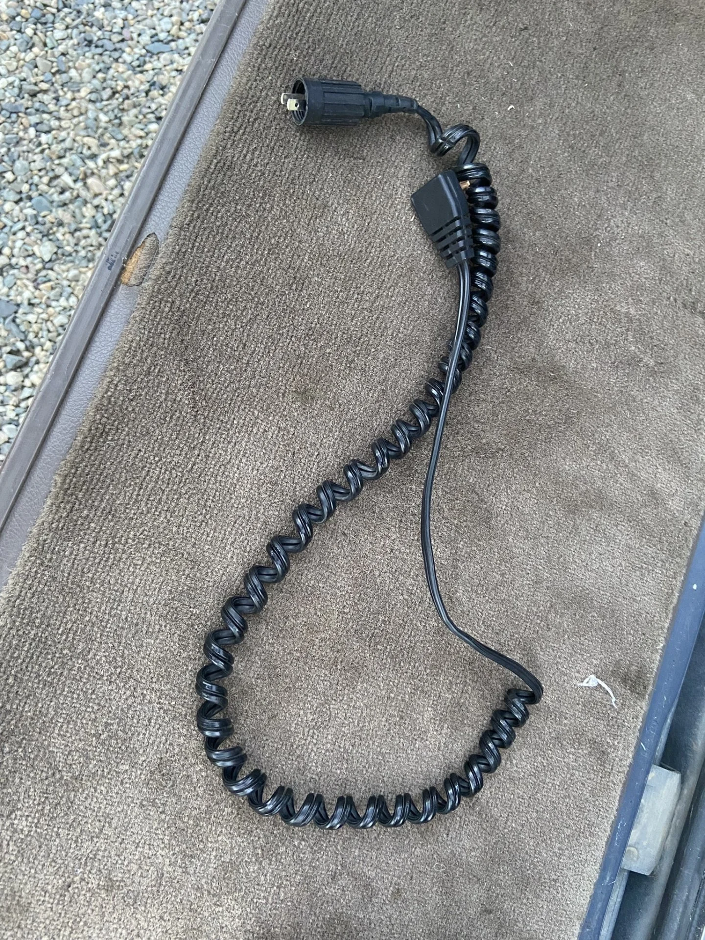

Figured out the cord situation today. Was concerned it would get caught up under the fridge when moving back and forth.

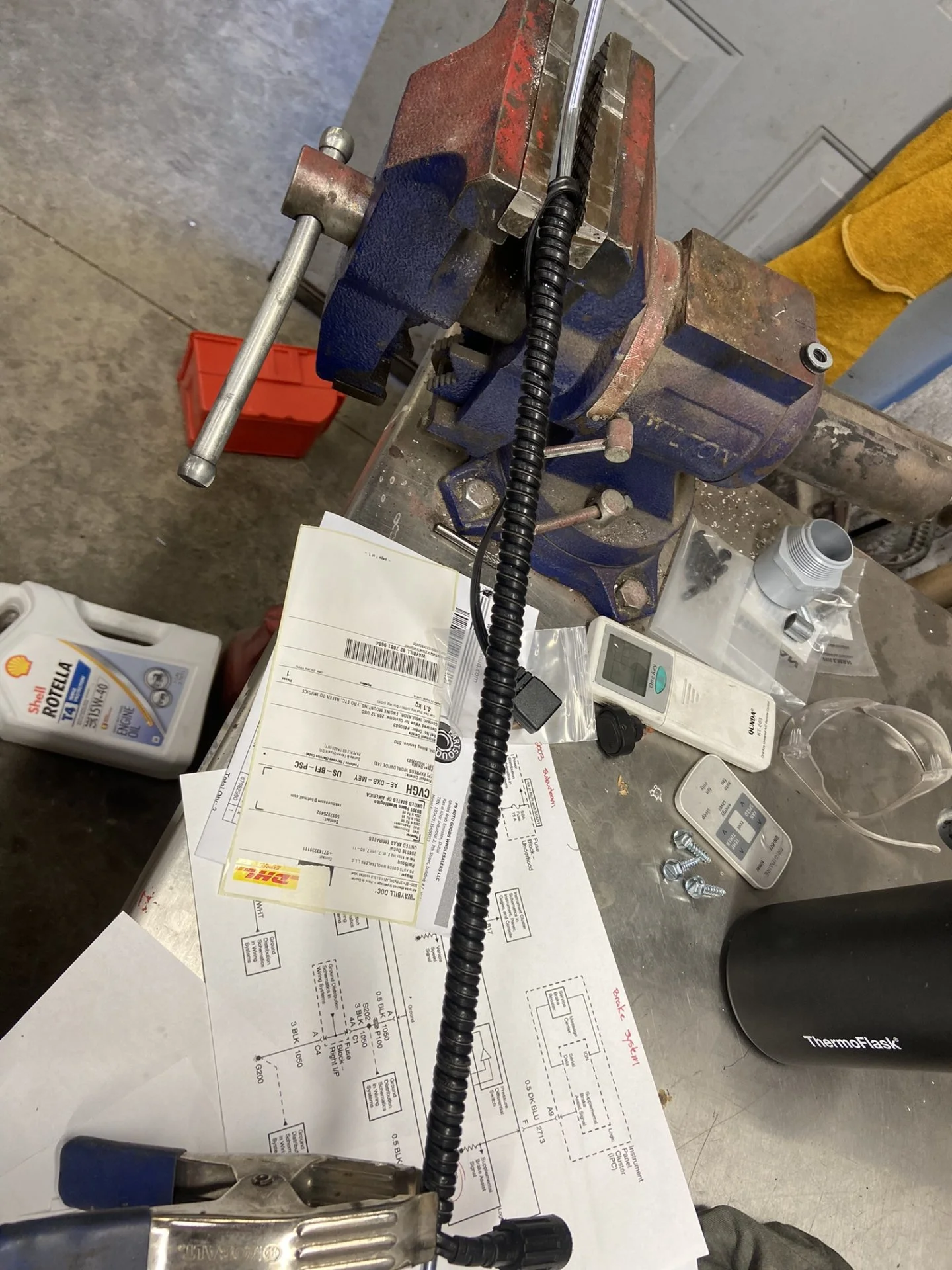

I took the standard ARB cord, wrapped it tight around a 1/4" metal rod, and heated it up with my heat gun until it was hot to the touch. Not so hot as to melt the cover but just the point it gets a slight shine on it. That causes it to lock in the "spring" coil so it somewhat retracts after being stretched.

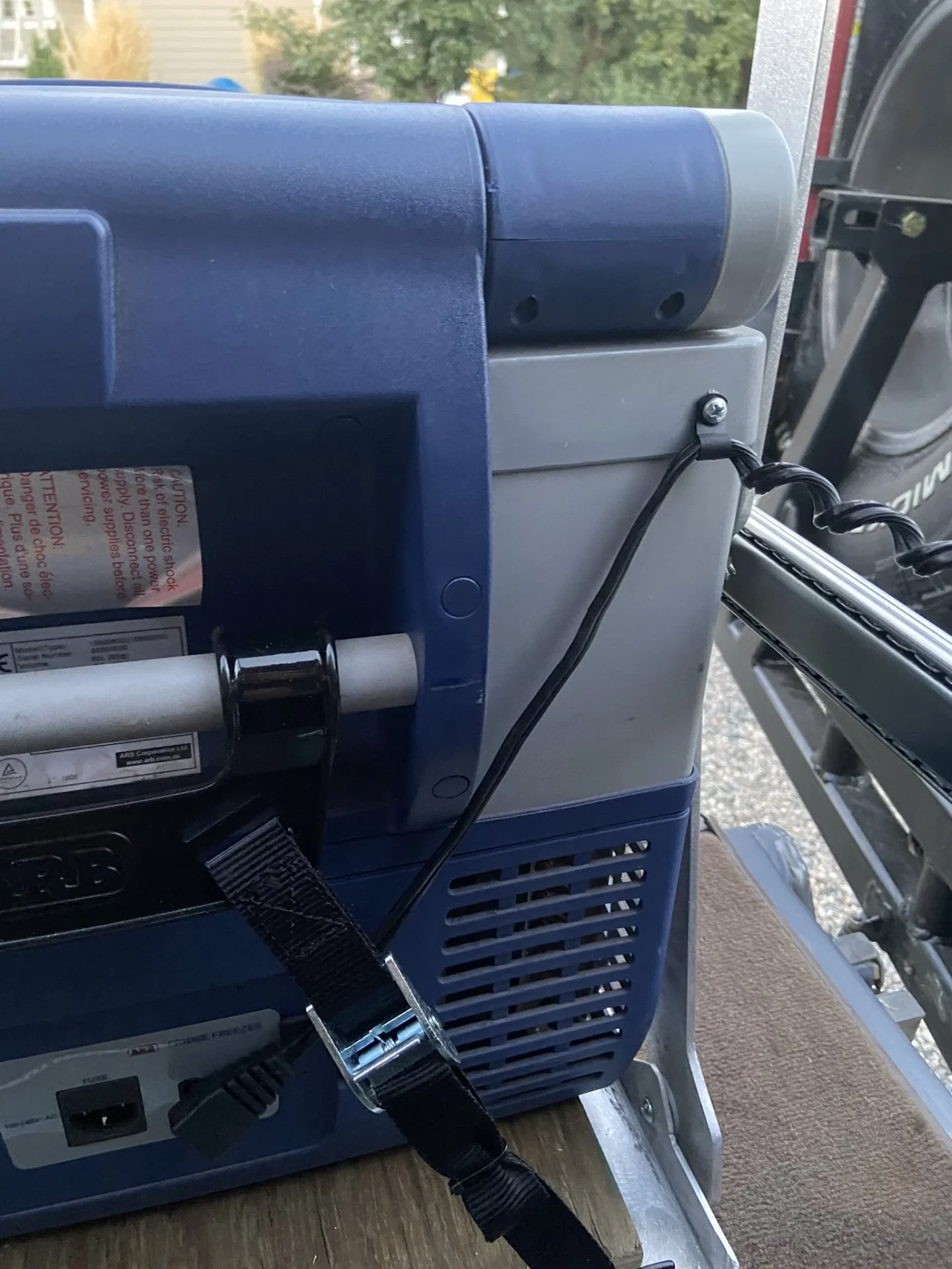

Fastened one end to the top corner of the fridge and plugged the other into the power outlet. Stretches out nice and folds back up near the power outlet when retracted. Only downside is I won't be able to store anything on that side of the fridge now. I couldn't put much there anyway because it blocked off the vents on the fridge.
Another method would be to leave a gap (probably about an inch) between the frame and the cradle and use one of those wire chains to protect the cord. I didn't want the extra height though so this method works for me.

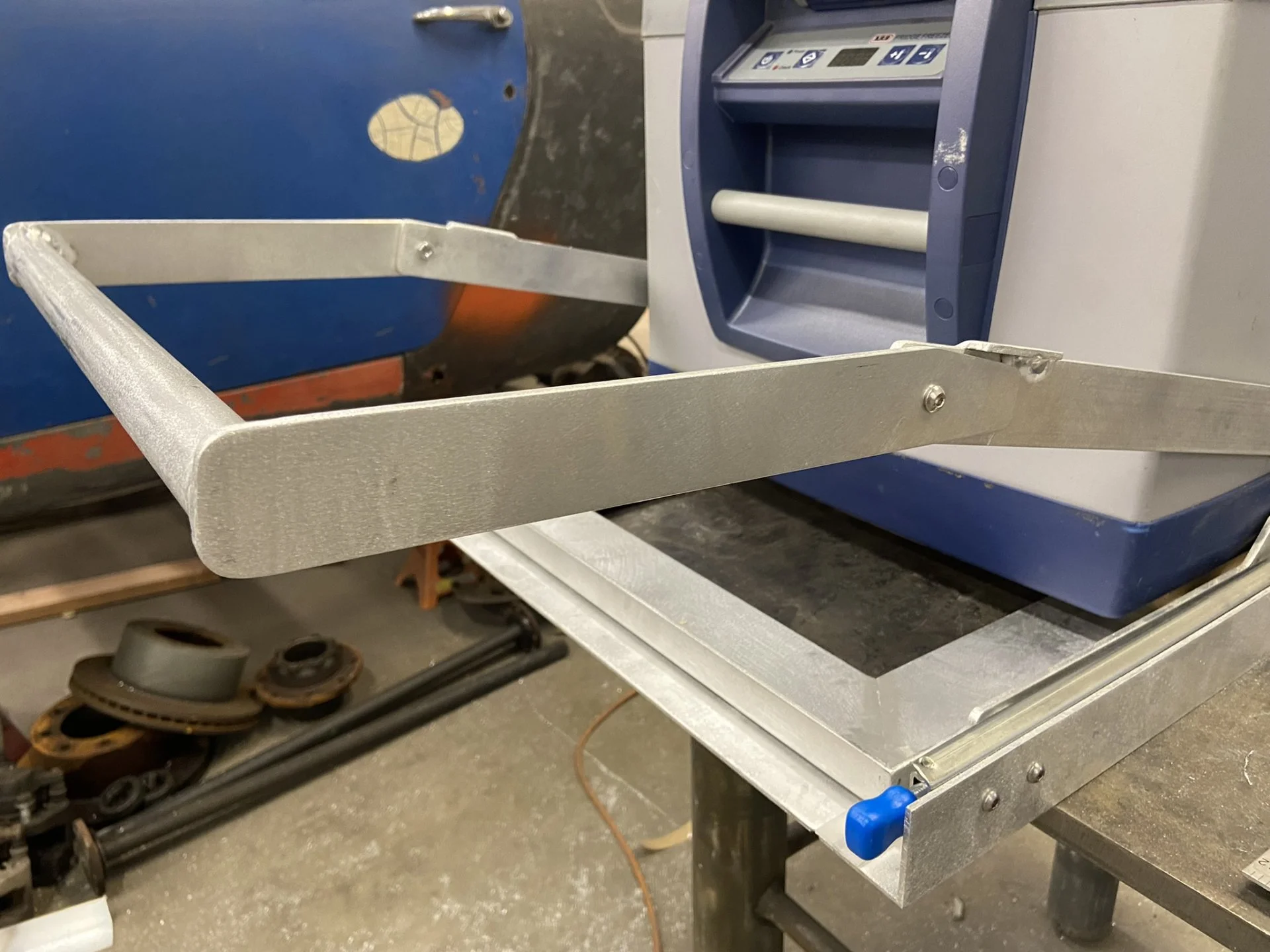

So after a week living out of my truck I noted a change that needs to be made. The long arms twist a little when your vehicle is not level. Will need to add some structure to them. Otherwise the slide worked great. I even found that it also acts like a tilting slide if I just pull the try out till the front drops so I could quickly grab a drink without dropping the whole thing.
Will reinforce the arms a bit when I can. Next slide will probably use thicker material for the arms to prevent the twisting.

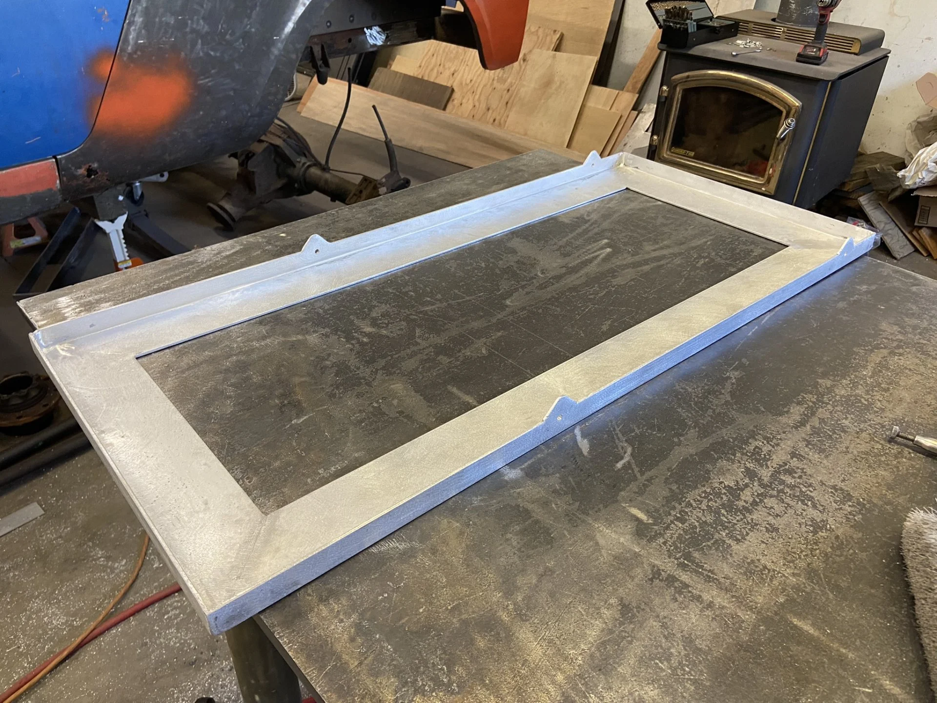

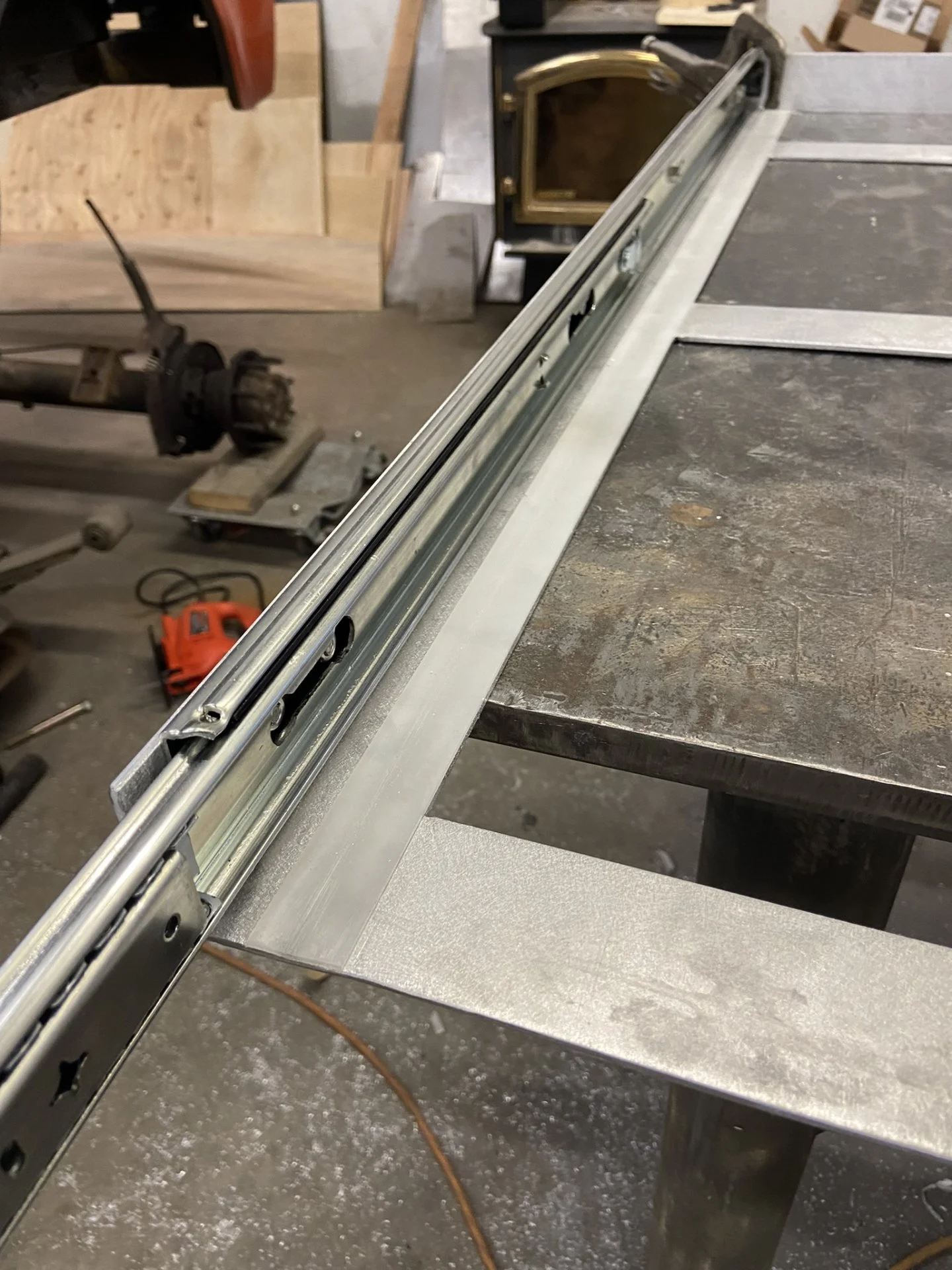

Made good progress today. Got the main portion of the slide done so down to just a few details and mounting in the cruiser. Added some UHMW strips for the cradle to slide on, seems to work very well. It's pretty light, the drawer slides themselves are most of the weight. I'll weight it once I have everything done.
I unfortunately found that I made the slide a little too narrow. I took my measurements at the top and bottom of the fridge but failed to notice that the middle bulges out about half an inch. The arms rub the side of the fridge just slightly. It still functions but I will probably end up making another one that's about an inch wider. Someday I plan to get one of the covers for the fridge so will need room for that.

I used 1/8". It works but can be a little wobbly when the fridge is full. If I was to build it again I'd use 1/4" for the lift arms and 1/8" for everything else.
