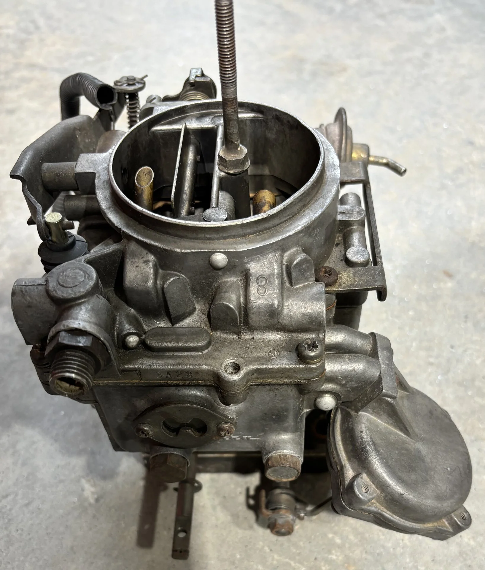

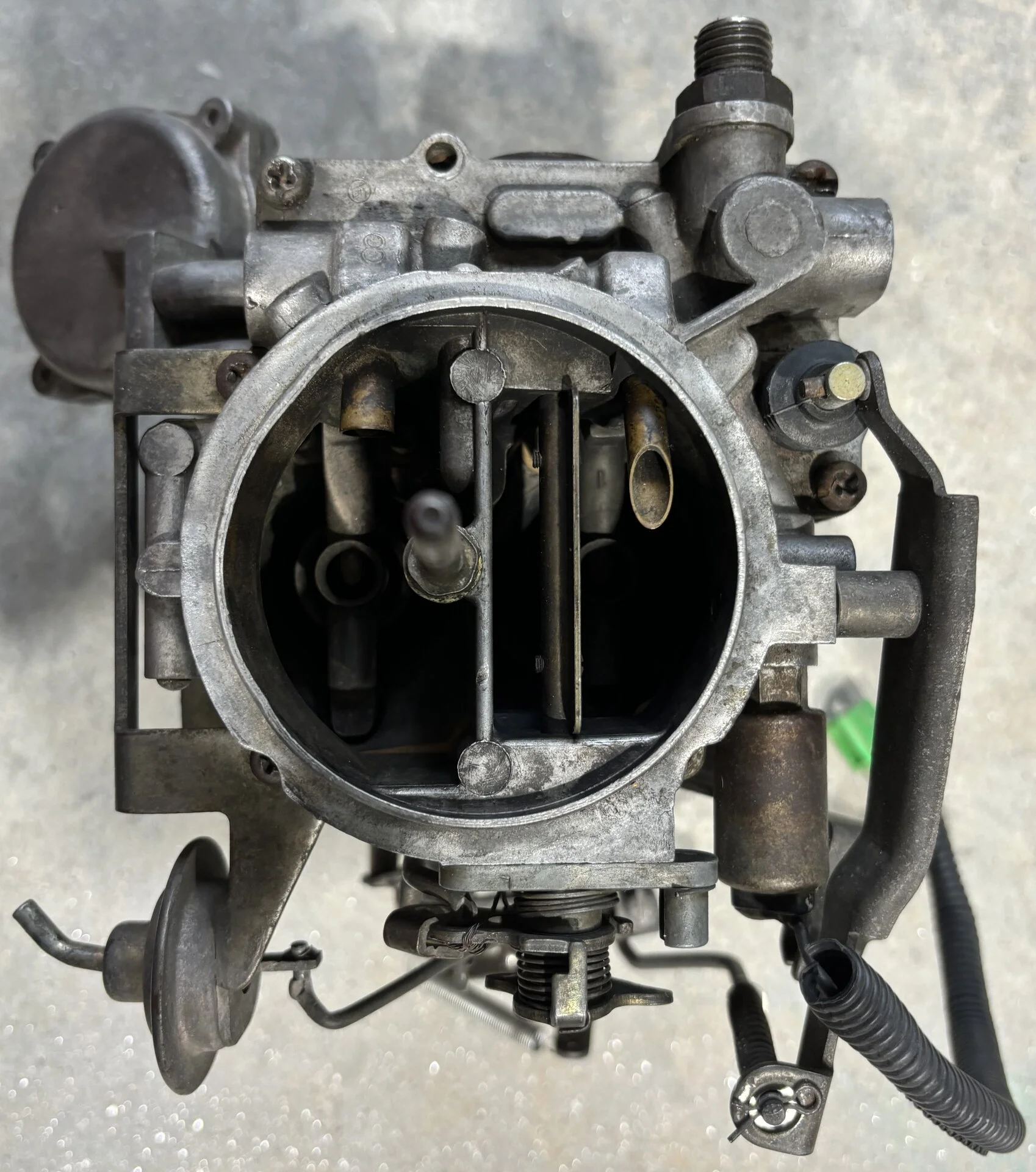

I have a 1978 FJ40 which was imported from Columbia and has carb issues. The existing carb is an Aisan, it looks like it may be the original, has the 'rod' linkage and has a vacuum operated choke breaker. I have read quite a few discussions on this site about the pro's and con's of Aisan rebuilds, Webber substitutions and new Aisan replacements and I am leaning towards just spending the money and buying a new Aisan. Could someone provide some insight as to whether this is the best conclusion and if so, a good source. Also what are the pro's and con's of an OEM Aisan versus an 'aftermarket' Aisan because there appears to be quite a price difference?

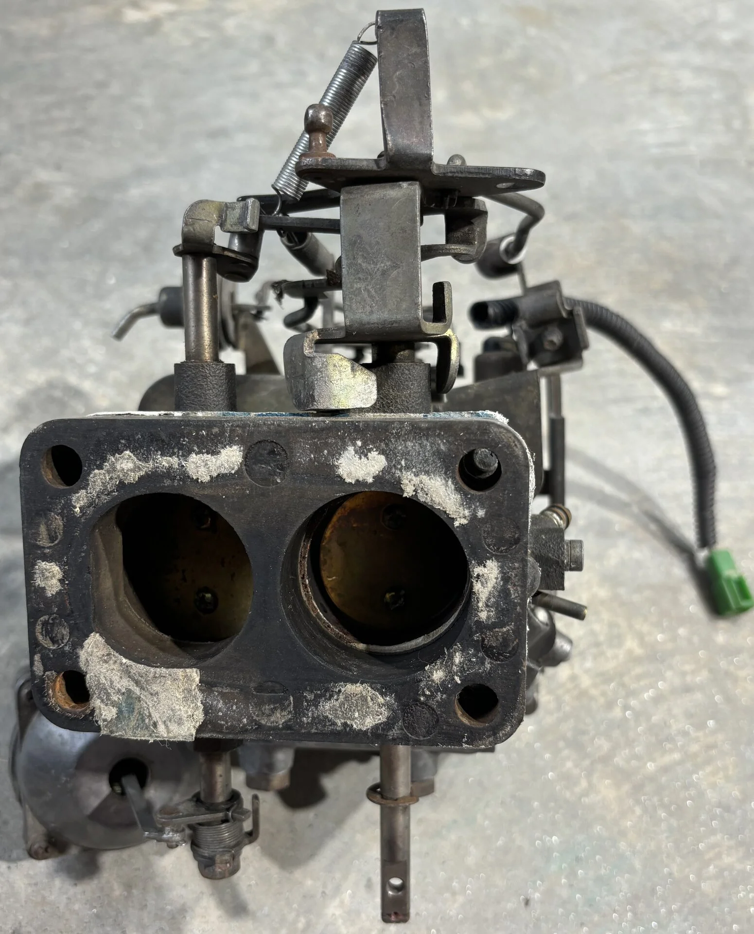

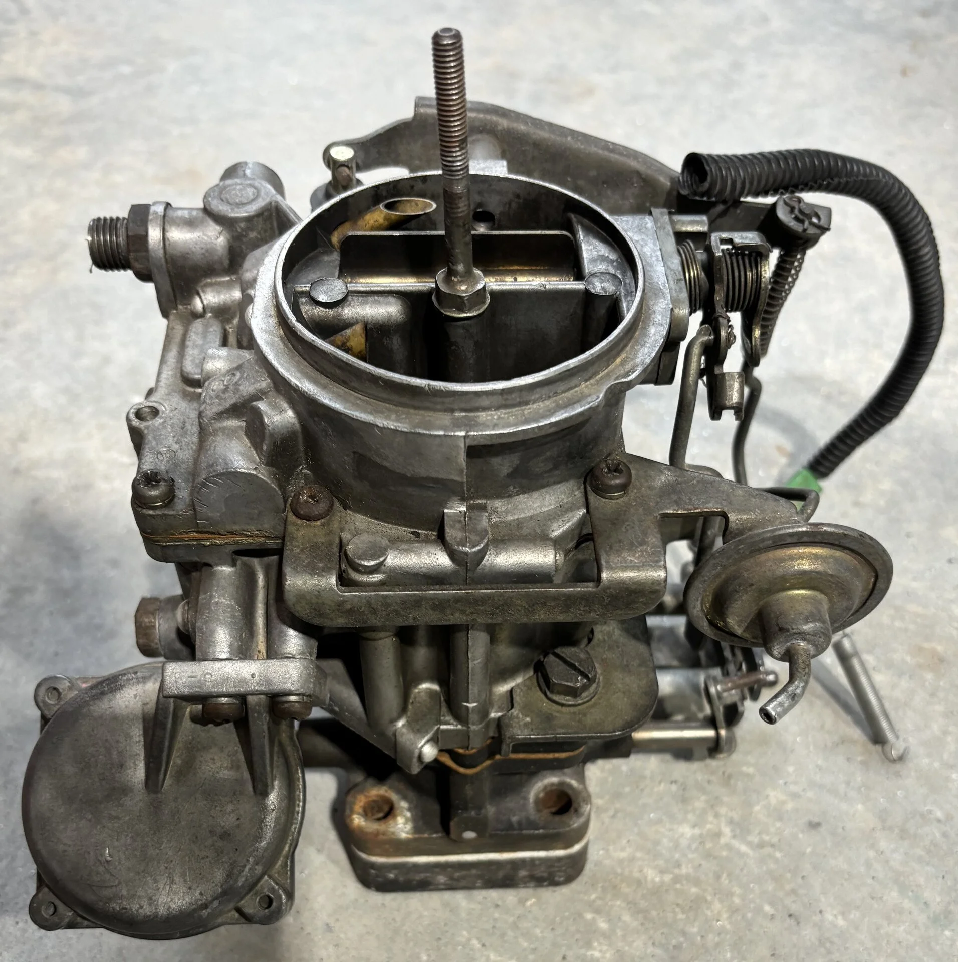

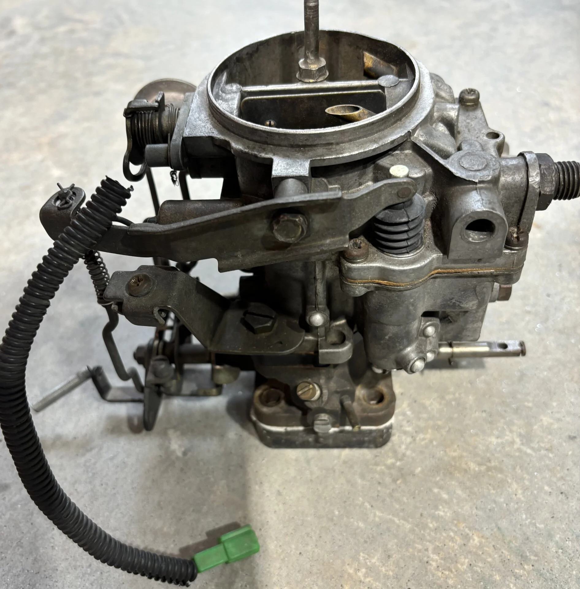

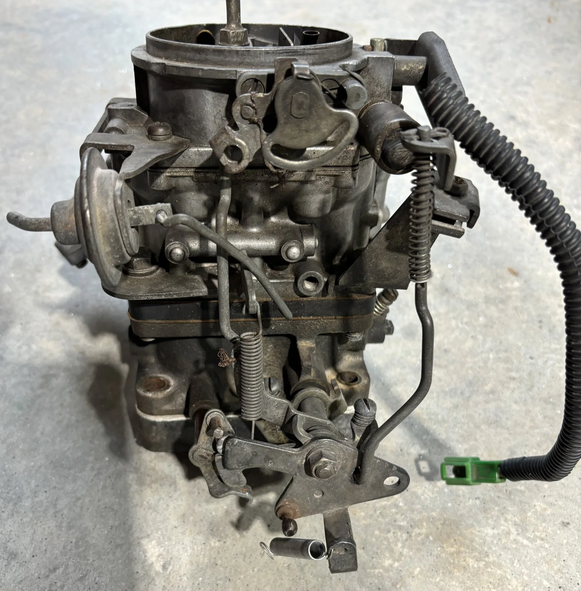

5 pictures of carb attached. Additional carb pictures, manifold and air cleaner to follow since I could only attach 5 pictures.
It looks like the build date is 3A28.
I do have the skills to rebuild the carb if I can get all of the necessary parts. I have the Haynes workshop manual and with the help of your videos and a 'parts cleaner' I am sure I could get the job done. That is the way I was planning on going and then I got nervous after reading some of the blogs from people who either had them rebuilt or did it themselves. I guess the key is to get a good rebuild kit that has all of the parts. Your further input would be greatly appreciated.
From the look of buggered screws and bolts and a few missing bits, I'd guess that carb has been apart an unhealthy amount of times; and as it's a Columbian rig, Gawd only knows what's inside.
You might be better served by having one of the Land Cruiser Carb Gurus do your rebuild as they'll have the resources to correct a Frankencarb.

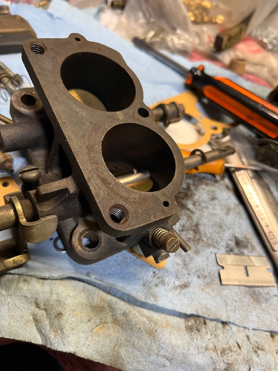

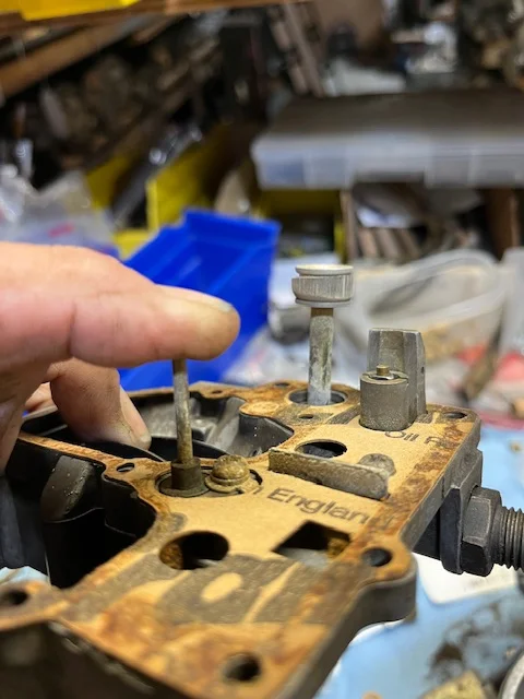

I will call you with the full post-mortem later. Suffice it to say, this was one sad carb that still has a lot of great potential. A few highlights:
Yes, I did see something that I have NEVER seen before! When I pulled out the two bolts that hold the fuel bowl to the throttle body, the carb separated. There was NO hollow screw inside the throttle body😱 The gaskets on the EGR spacer were homemade as well, and there was a significant amount of rust on top of the throttle body, indicating a long and persistent vacuum leak.
The factory main jets were both mia, replaced with Mikuni that were too small. Both the slow jets had been drilled out, the checkball and spring were mia from the accel pump discharge chamber, and the power piston was frozen in the ‘on’ position.
And the spring in the secondary diaphragm was installed on the wrong side of the diaphragm 🤦🏻
At least that gasket was made in England 😂!

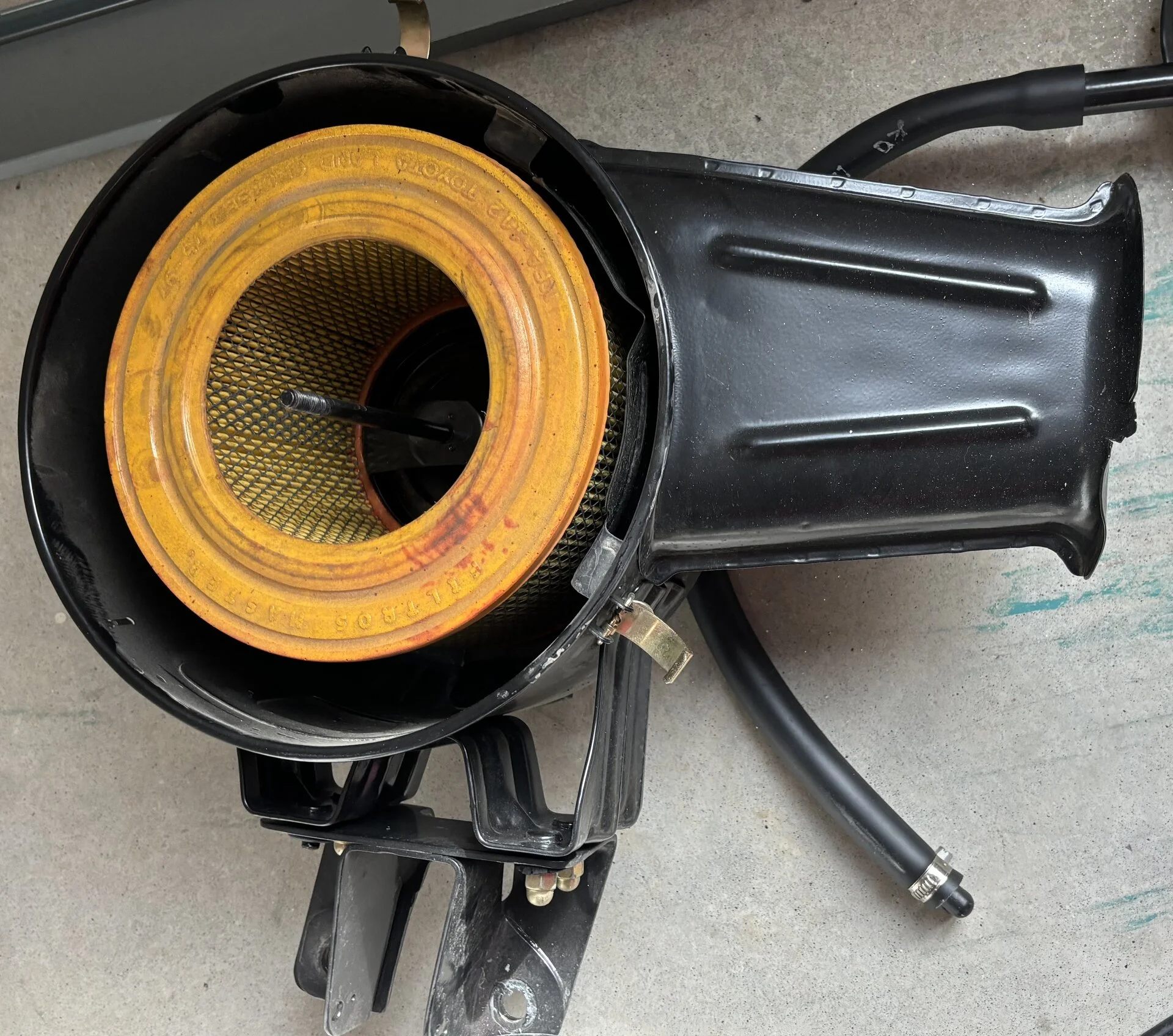

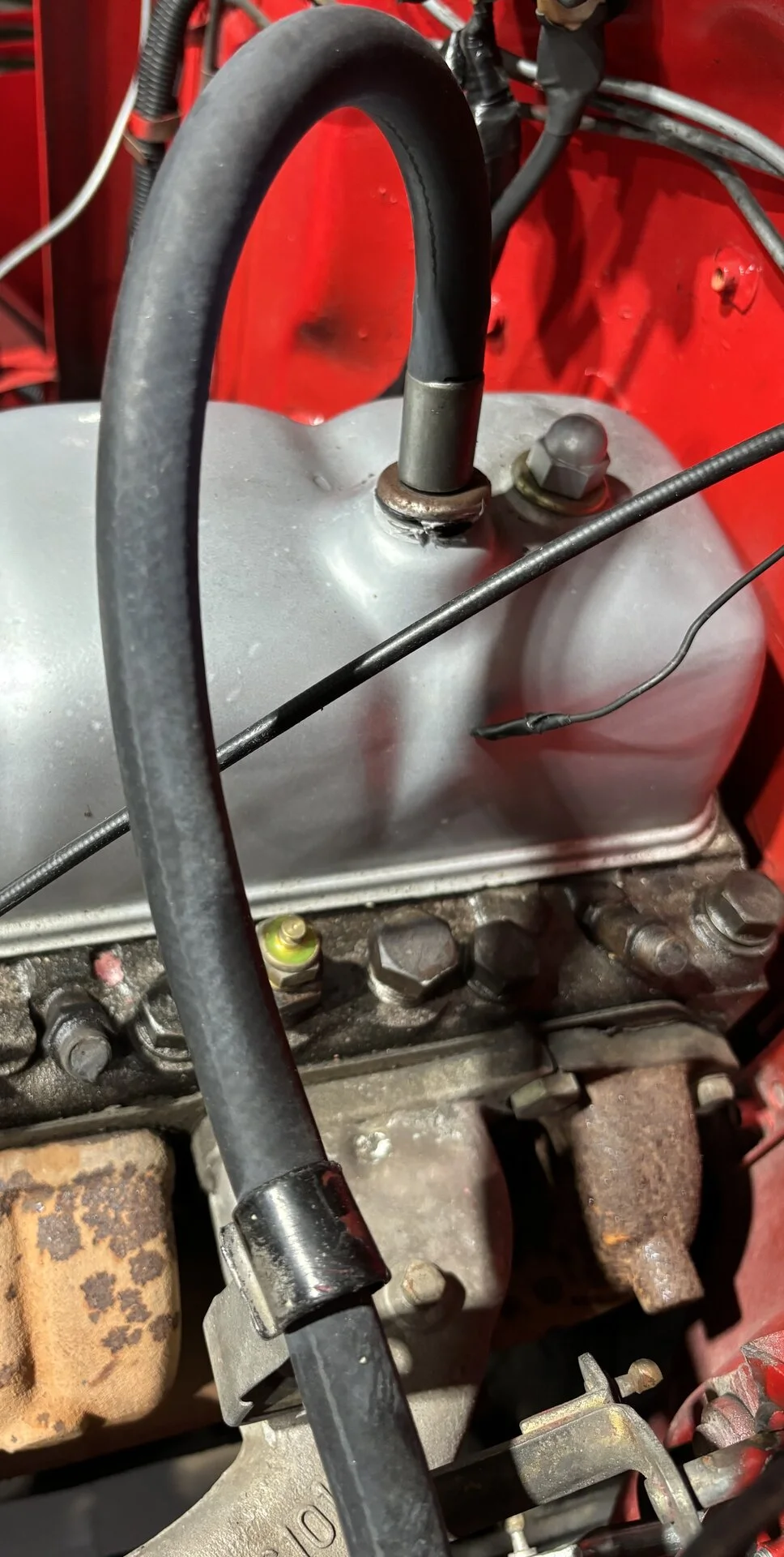

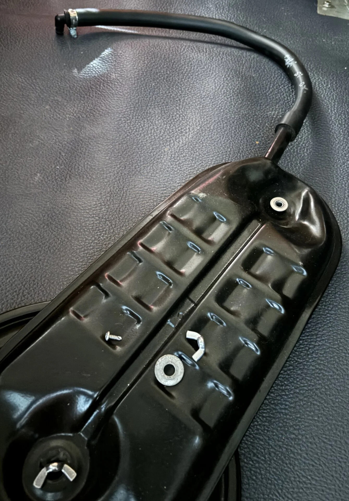

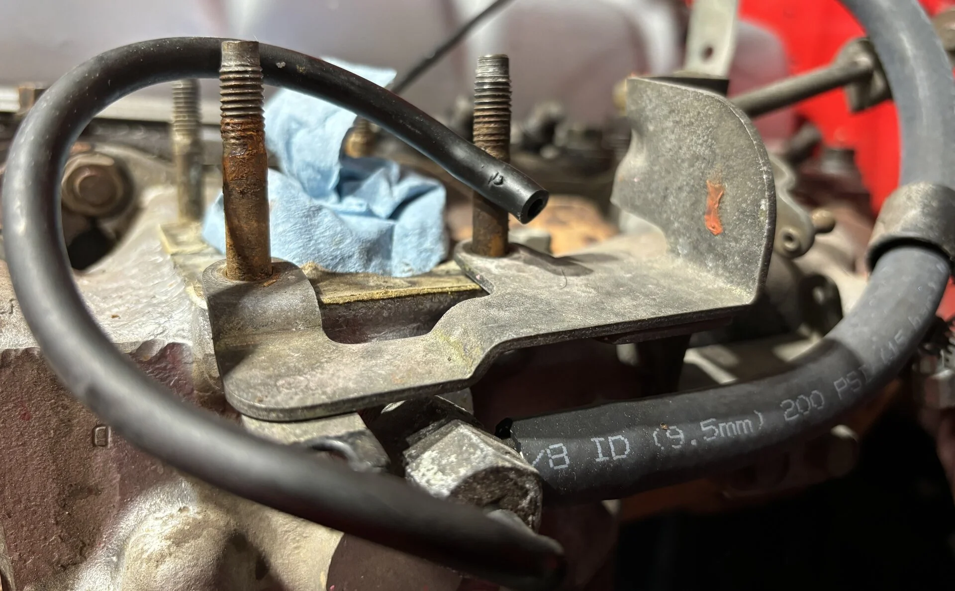

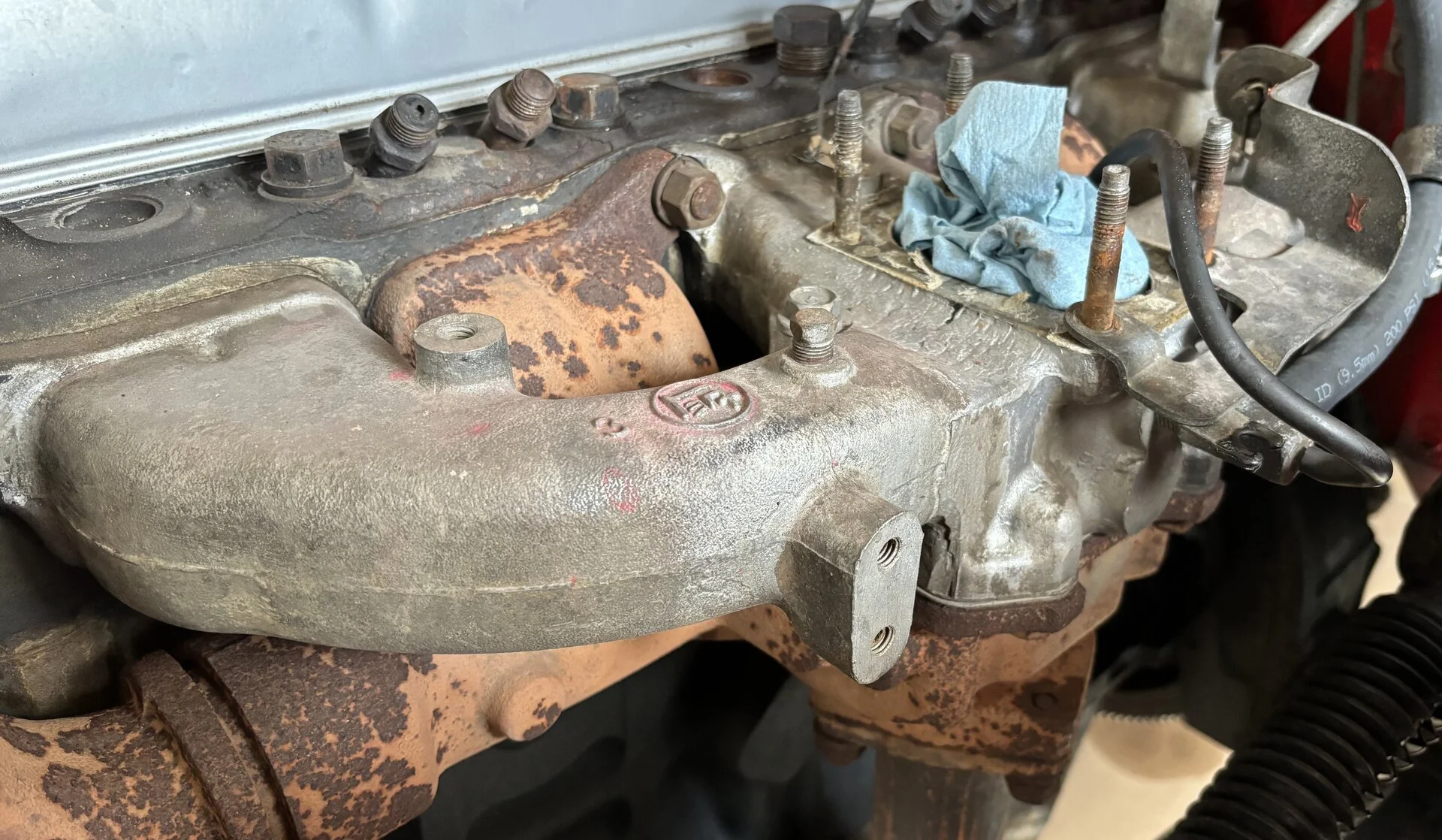

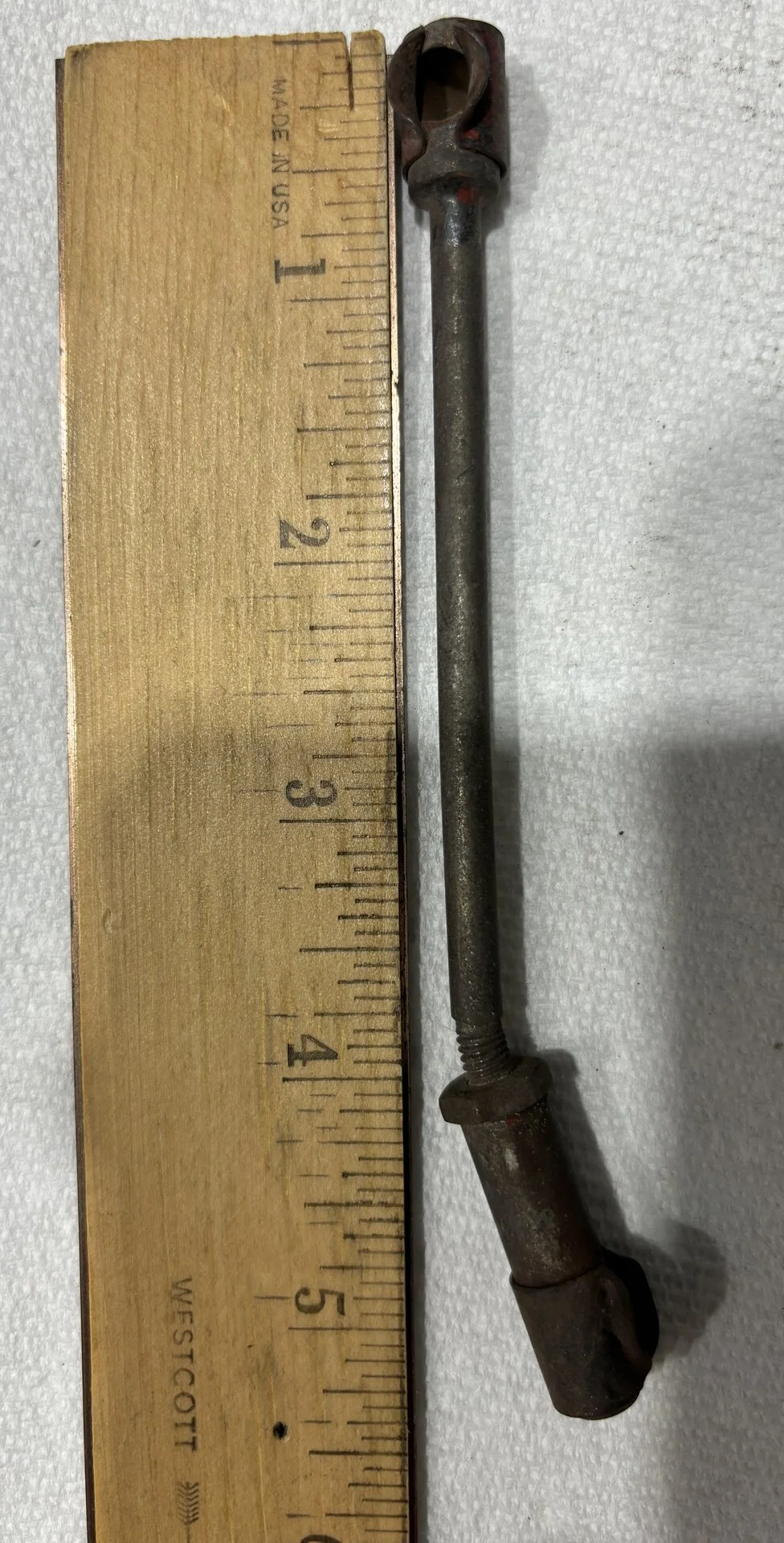

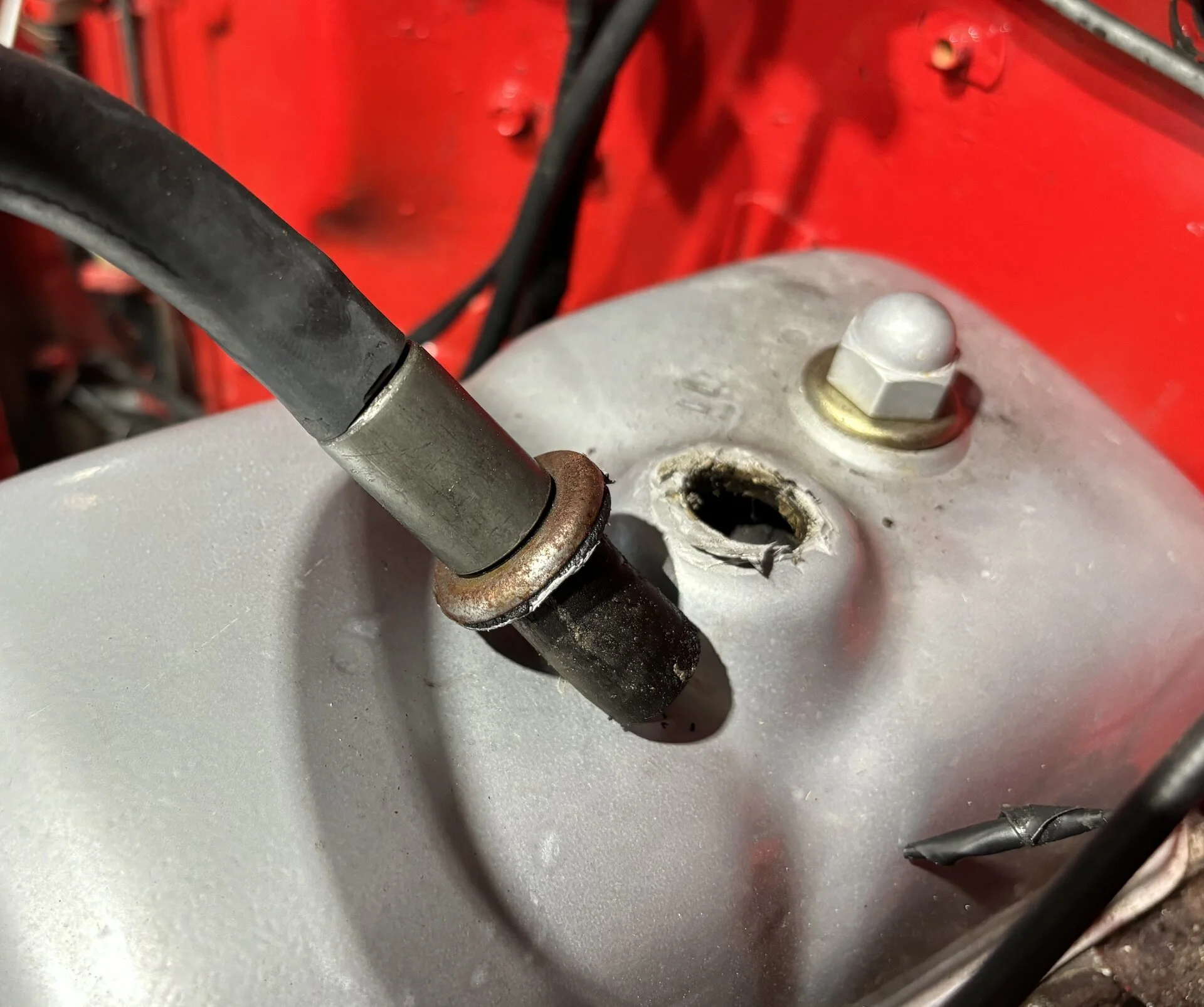

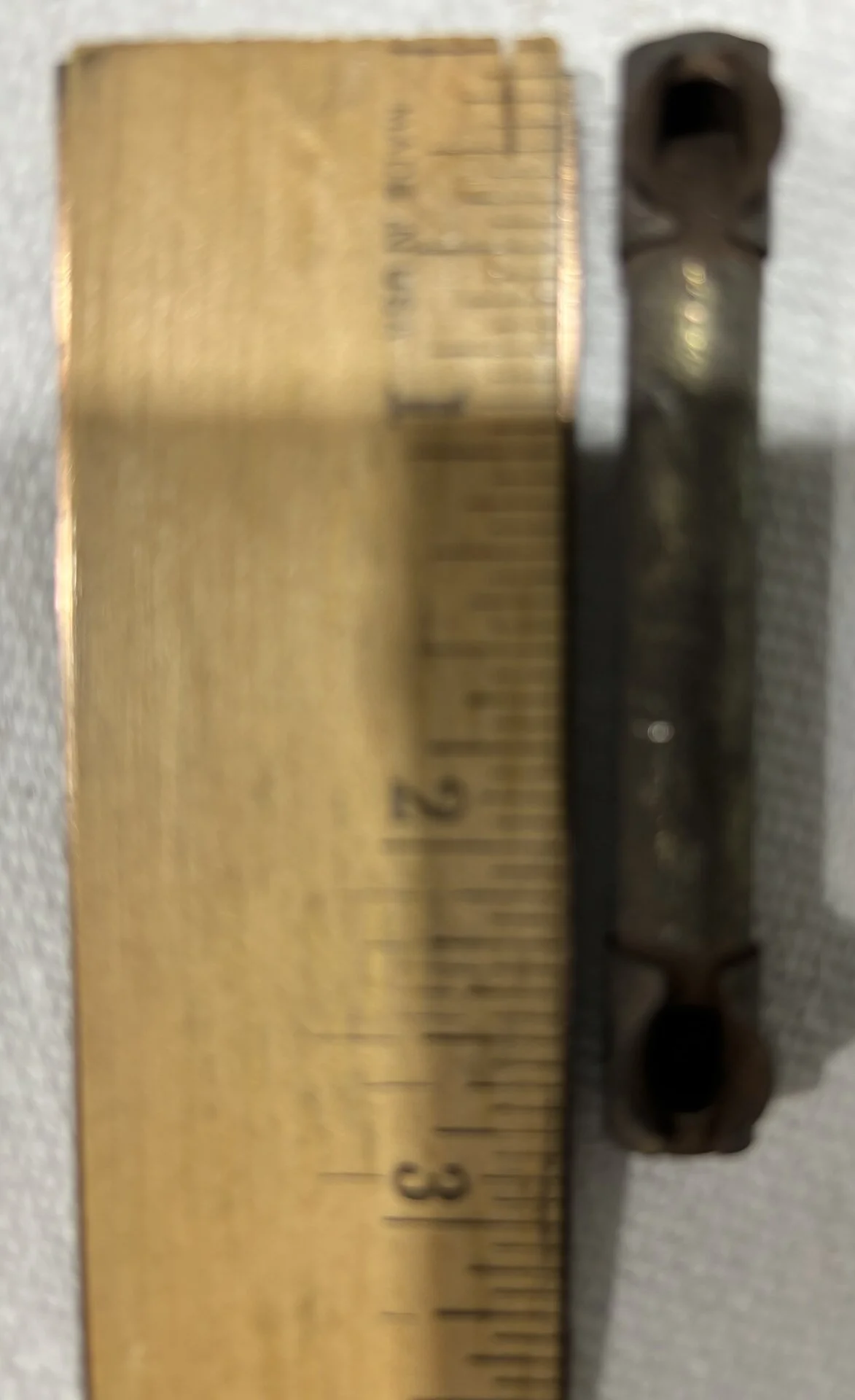

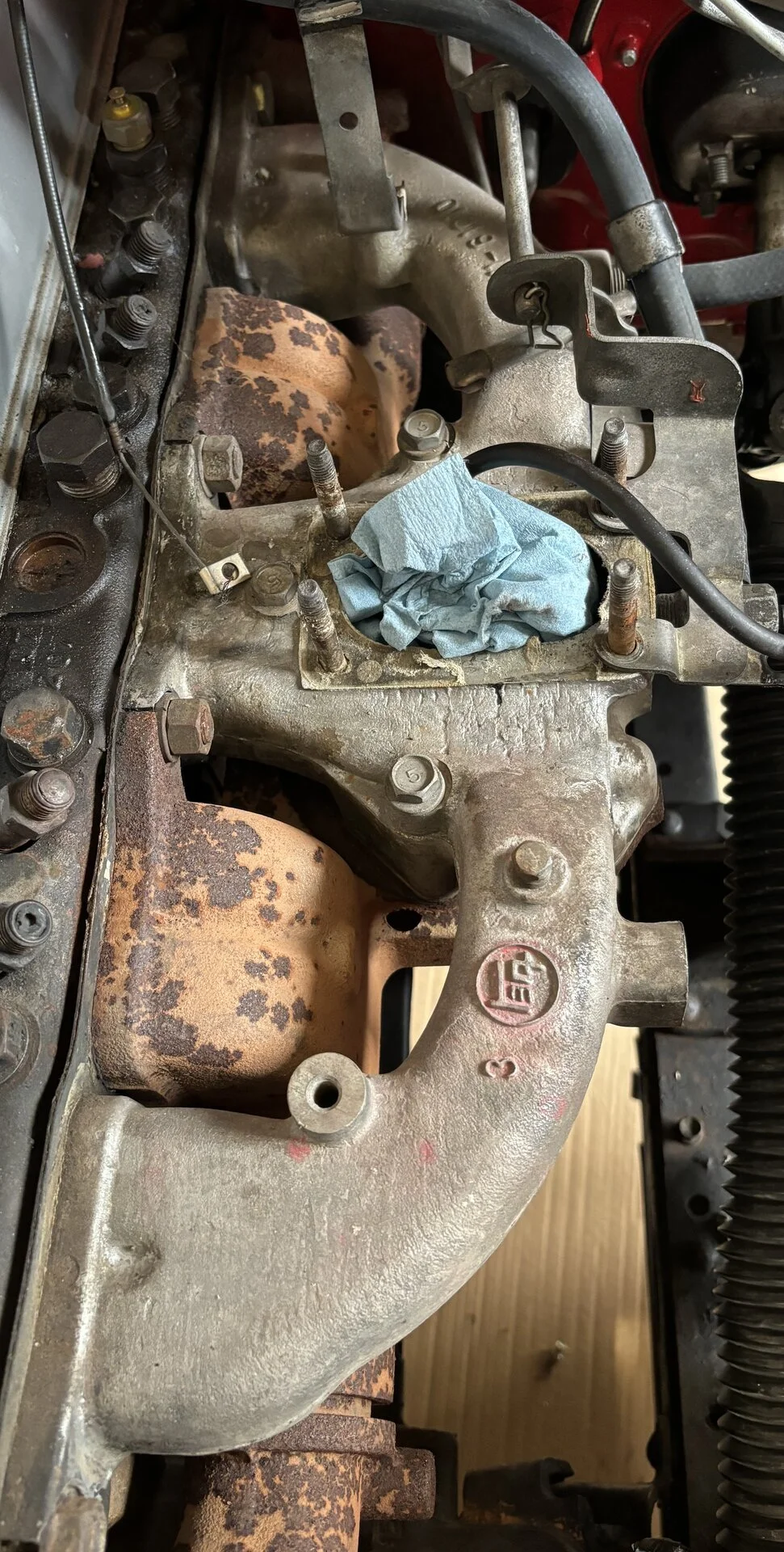

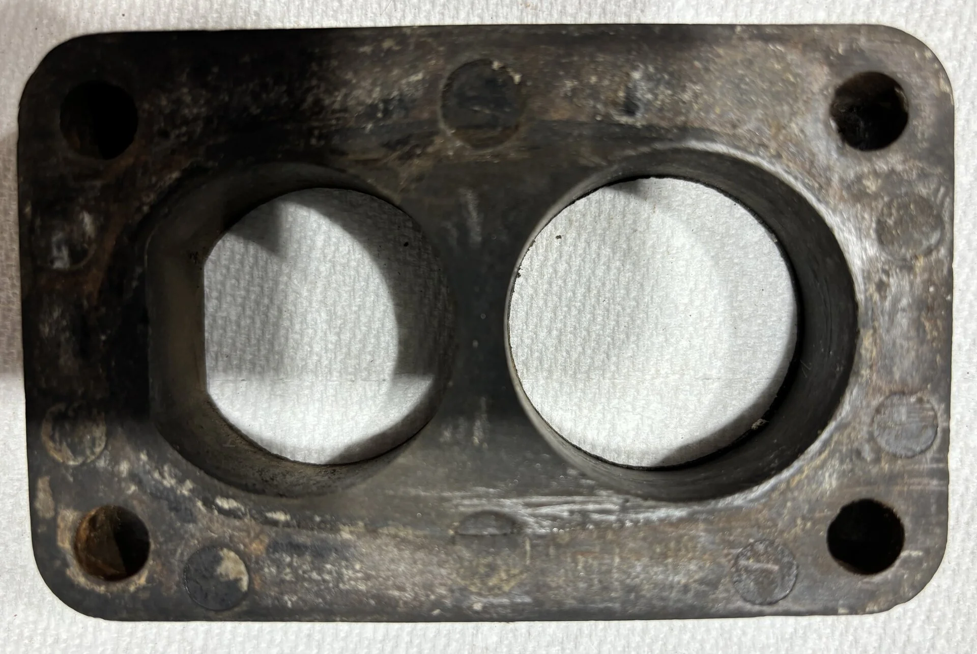

Hi Mark. Further to our conversation today, please find attached pictures with answers to your questions and the additional information requested.
1) the black carb spacer is straight and flat. Therefore the 2 gaskets should fit the bill.
2) the carb linkage rods are shown, the fixed one is 2.75" with the ends aligned and the adjustable one is a 'bent' 5.5" with the ends 90 deg to each other.
3) the valve cover does not have any markings on it, either "Toyota" or "F2".
4) the valve cover has two 'vent' lines, the one on the left connects to the air filter cover as shown and the one on the right connects into the inlet manifold with a 'T' fitting, with the other line from the 'T' attaching to the carb. I don't see any PCV valve.
I'll be available all day tomorrow if you want to call to discuss.
Many thanks.
