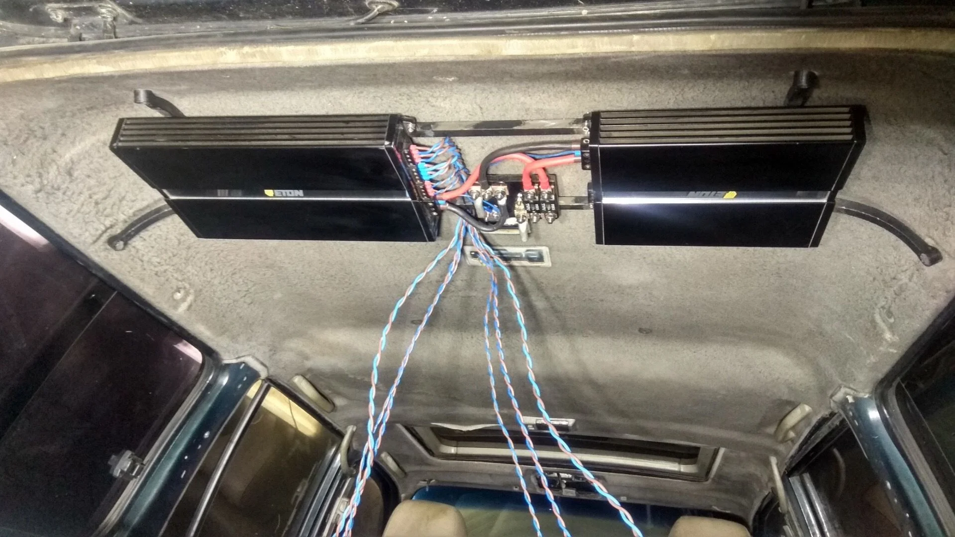

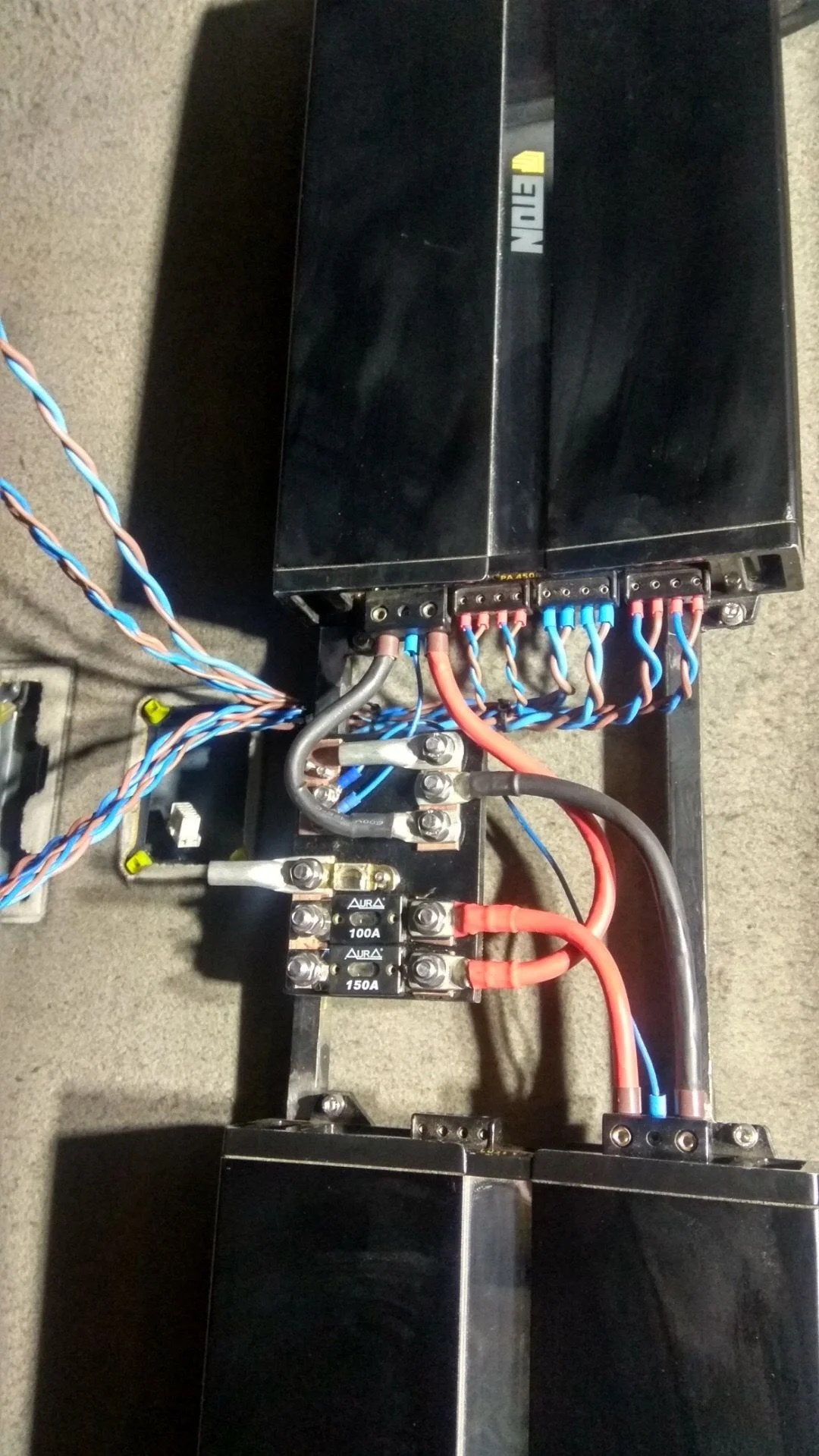

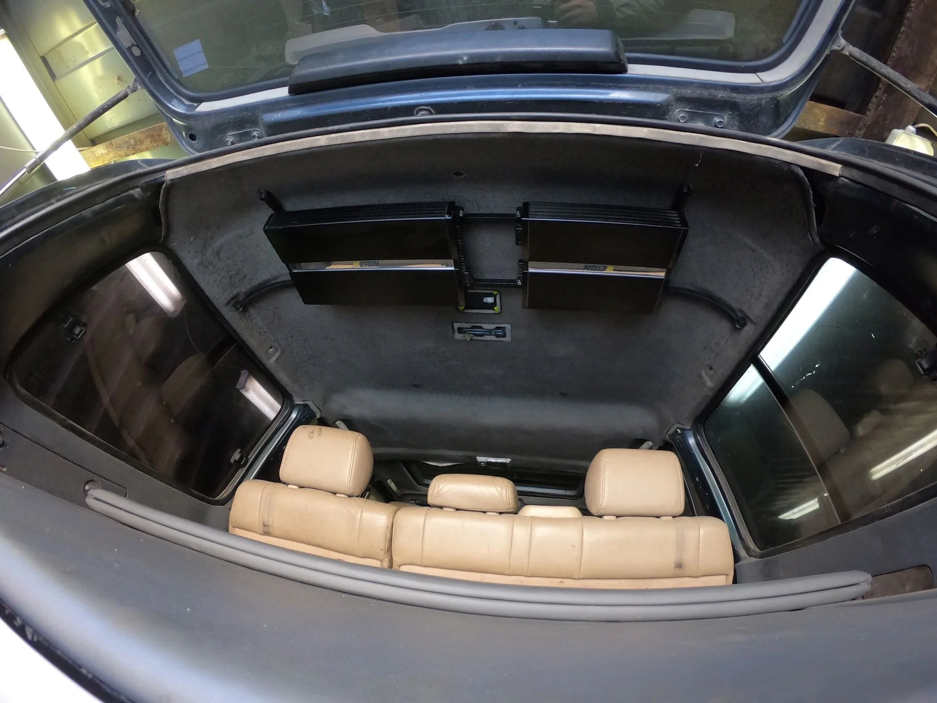

Amplifiers.

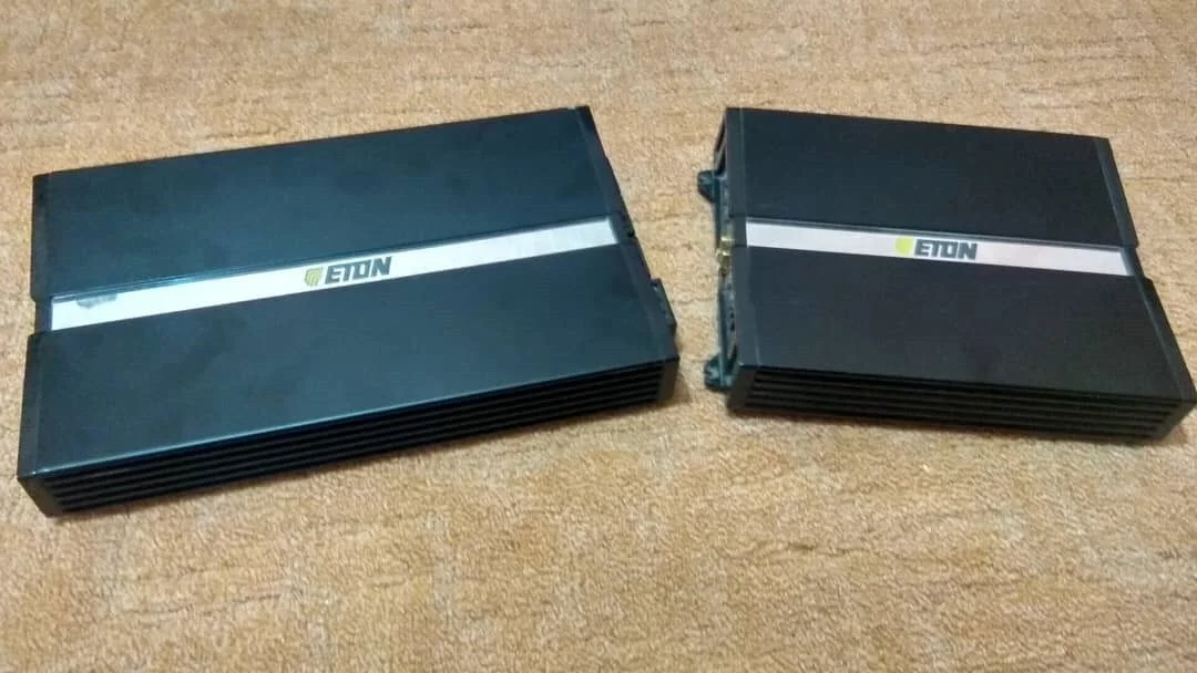

Purchased two old school Eton PA series 4506 and 1502.
Six channels PA4506 for 3way front, 1502 for subwoofer.

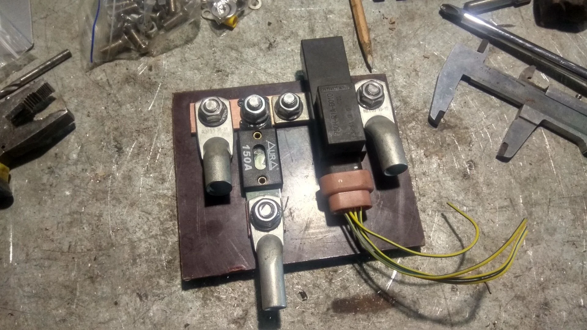

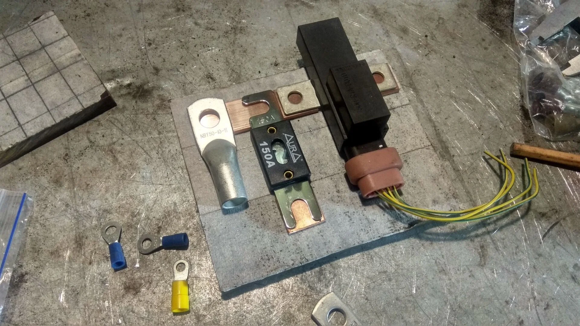

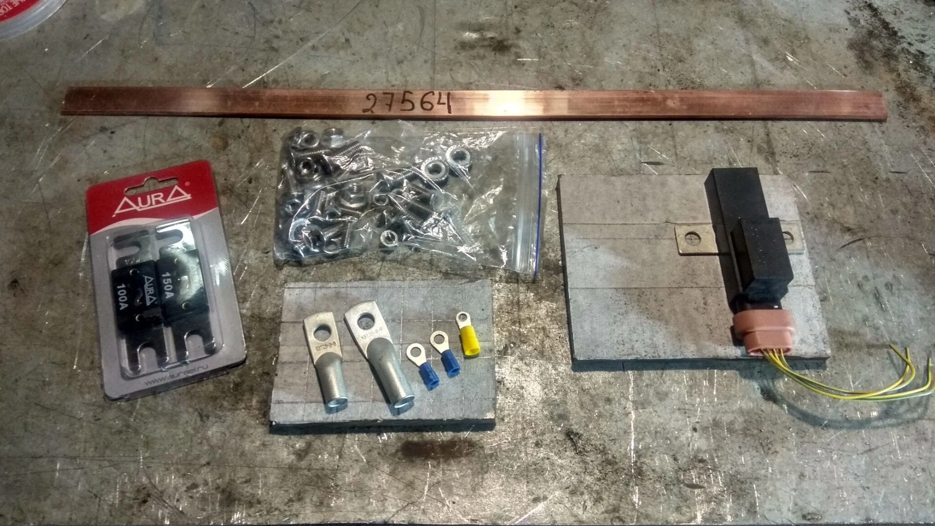

Custom build power distributors.
Copper bar, stainless steel bolts. Gruner relay for rear winch power off.
From left: power in 70 mm2 cable, fused power out to amplifiers, gruner relay rear winch power.

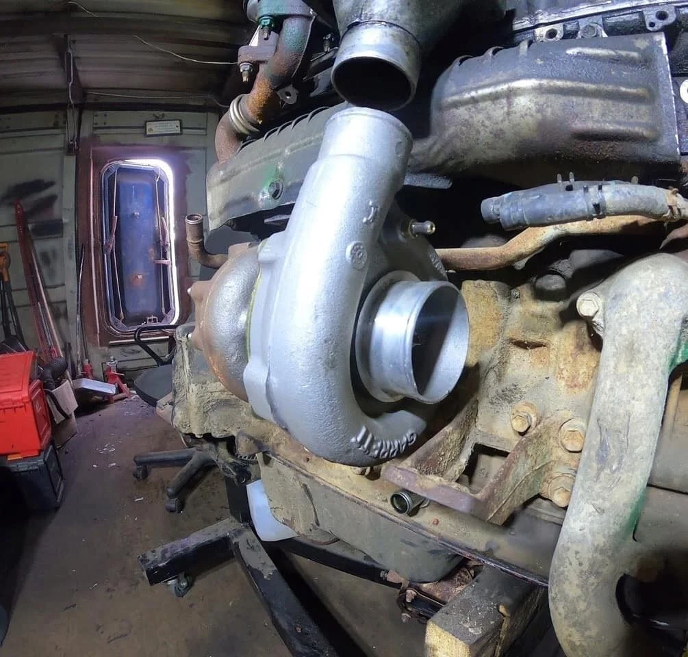

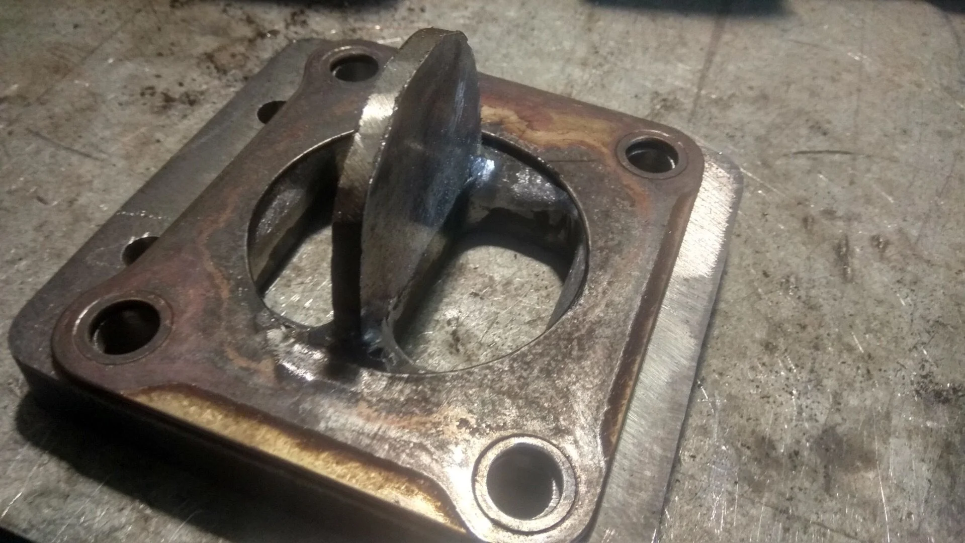

Stock turbo CT-26 changed to a Garrett m33 twinscroll.
16mm thickness adaptor from t4 to t3 twinscroll.
Next step is a top mount water intercooler

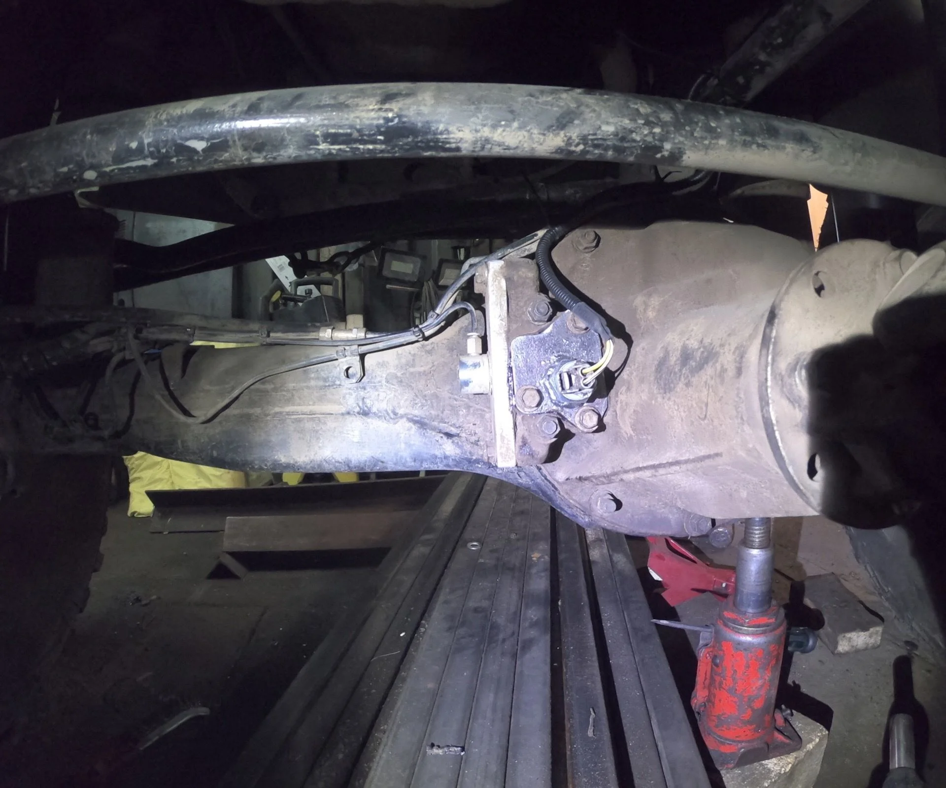

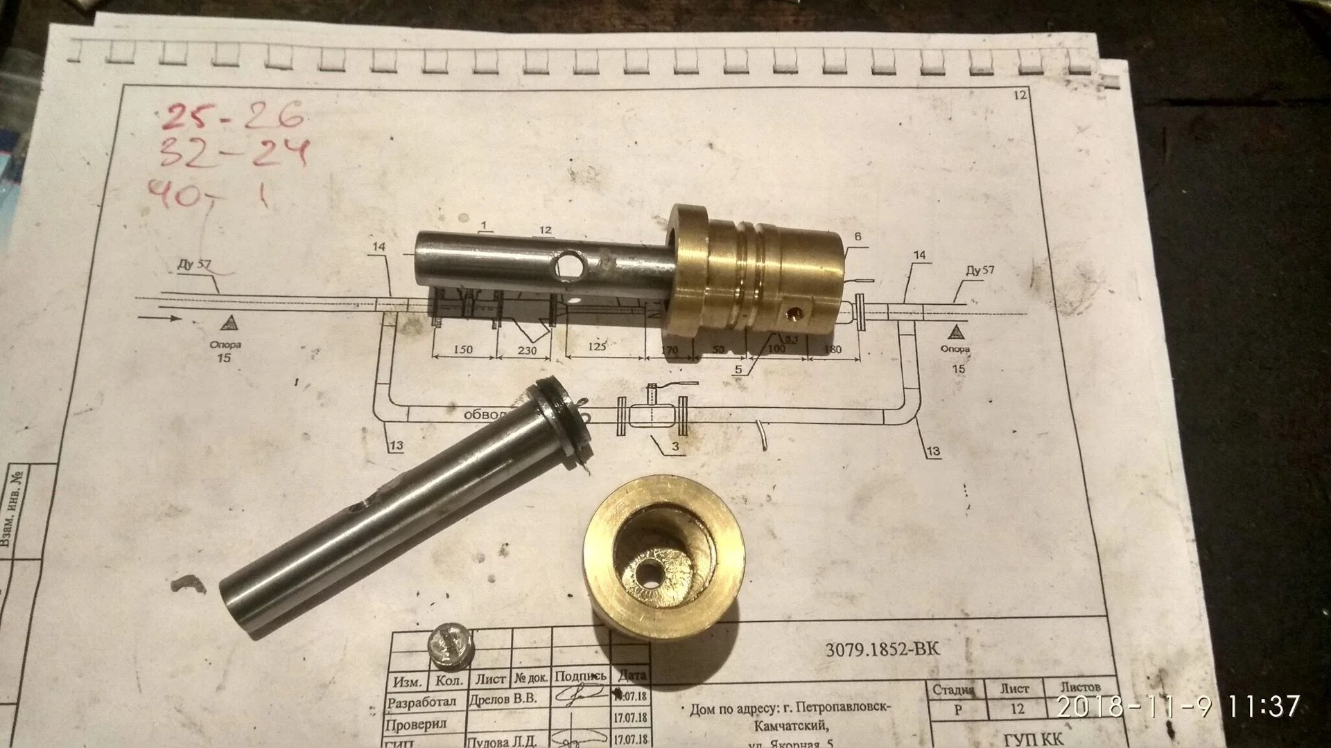

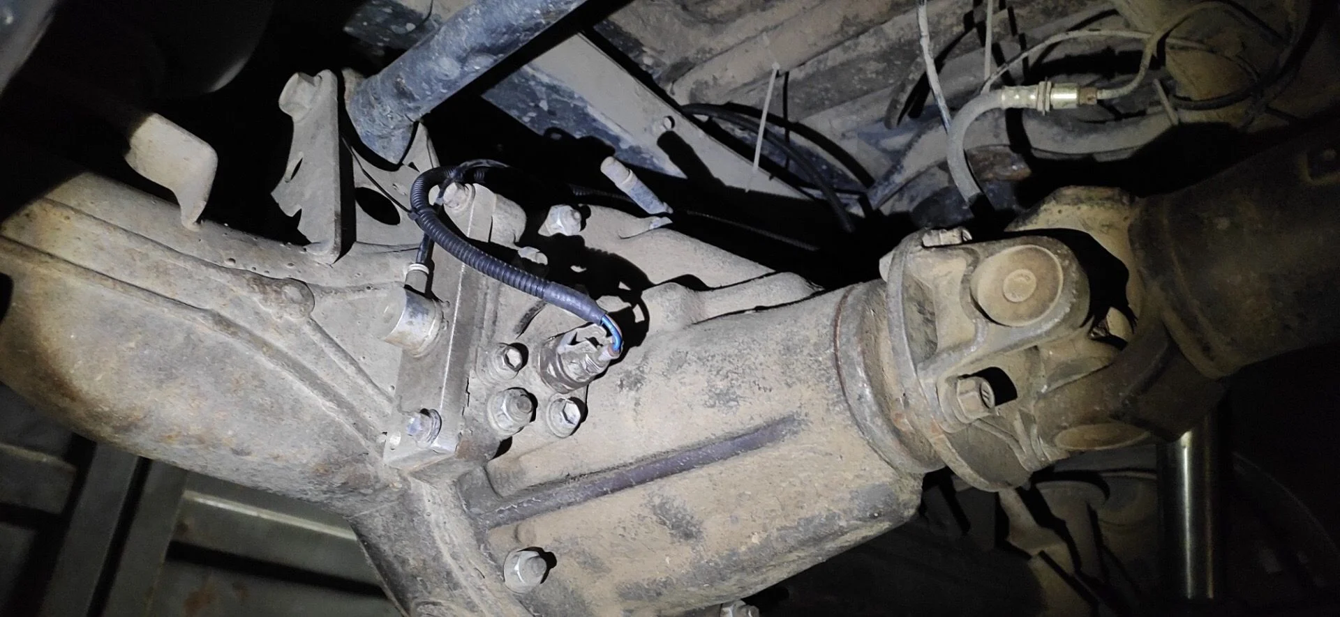

My rig haven’t stock e-lockers from factory. When I build front axle I purchased two rear locked differentials without electric actuator.
New pneumatic actuators are custom made. It’s pretty simple and good in work.
Little spring in rod returns the locking fork back

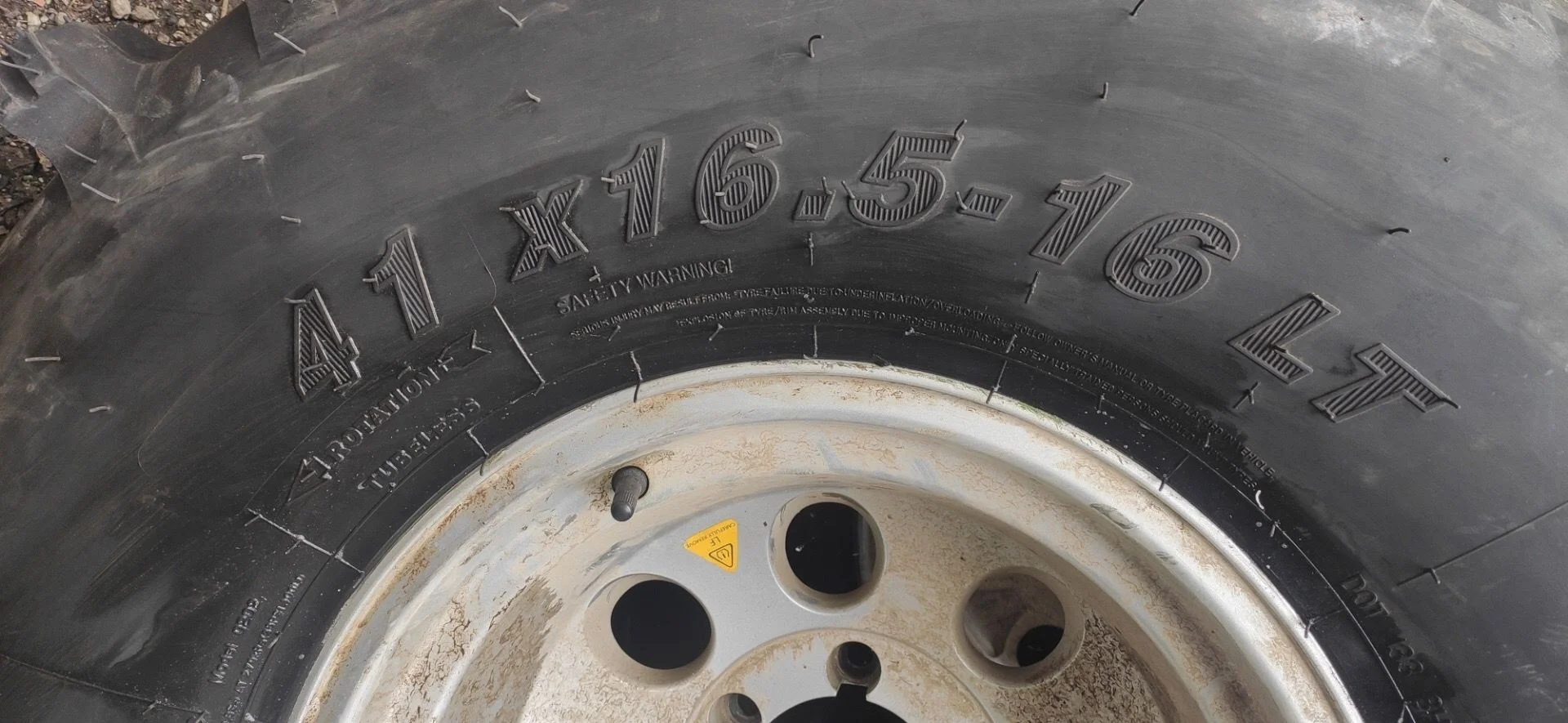

Stark Blackburn has only two sizes. Old - 39,5*16,5, new 41*16,5, only on 16 inch rim

I'm guessing these are something off brand then. They're marketed as "Russian Military Tires".
No, they marketed as a best off-road tires ever made 😊

I'll DM a link the next time I see them come up. Biggest issue I've read is that the bead is really thick, and doesn't seat in most wheels (dual beadlocks solve that issue).
