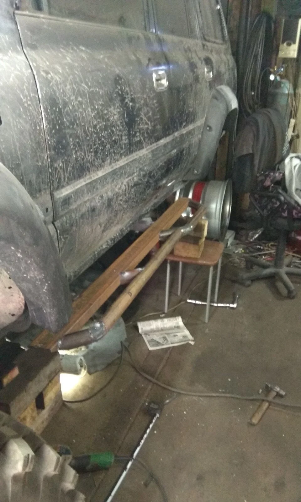

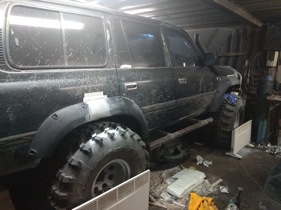

Rear axle moved back by 5 centimeters. Rear arch added 9 centimeters
@Obrokoff Nice work here!! Thanks for sharing. Like the air bag setup. What's your overall height to the roof line when it's lowered?

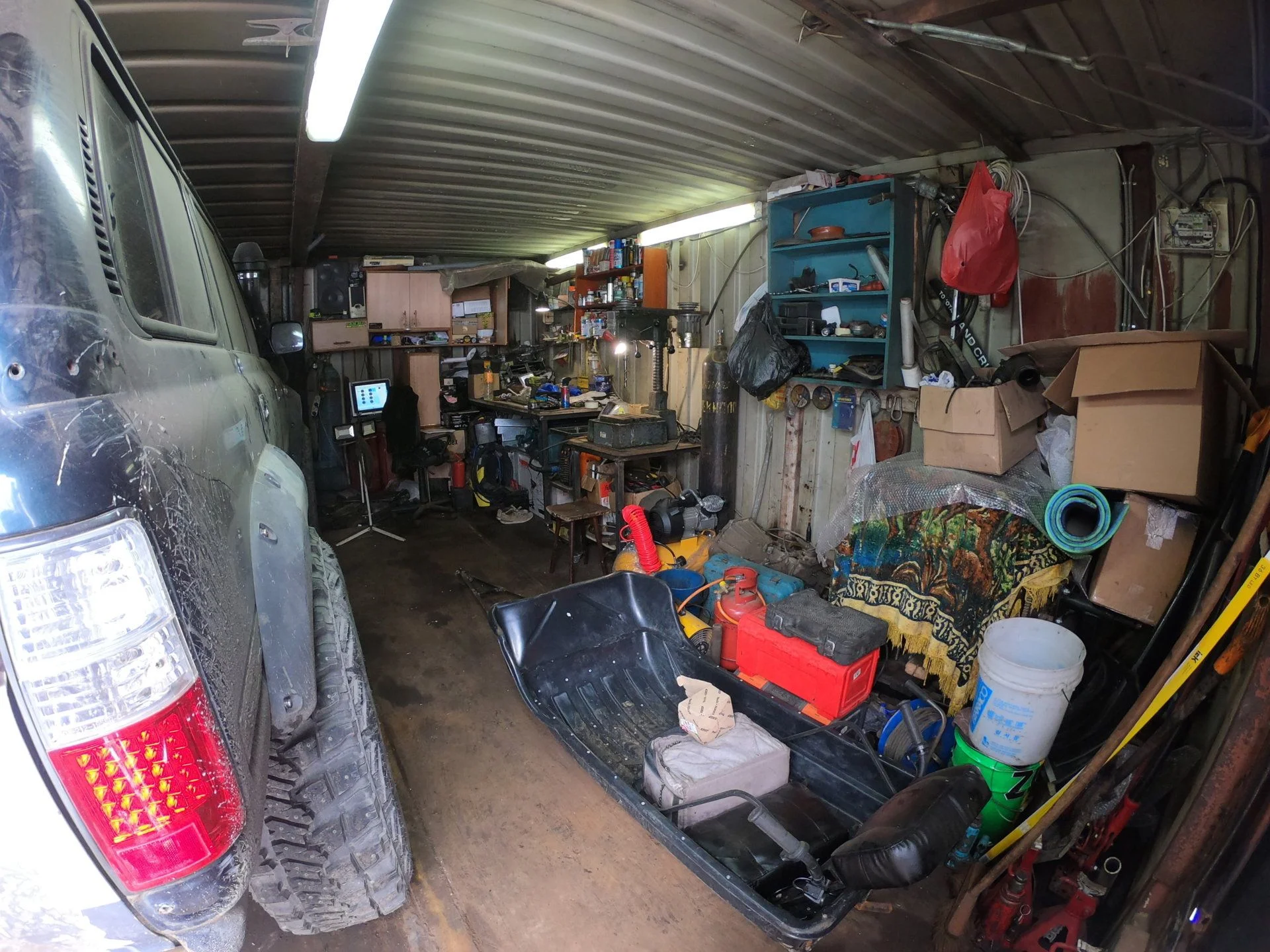

cool stuff. Nice front axle. Can you post a pic of your shipping container shop? :)
cool ride! Lots of work - when you do it yourself you know every part of the the truck.
I am amazed by your talents! You do it all! Body, paint, mechanical, welding, machining, electrical, pneumatic!
And all done in a container garage!
Sweet on rear axle converted to a front. I dig that! 😎

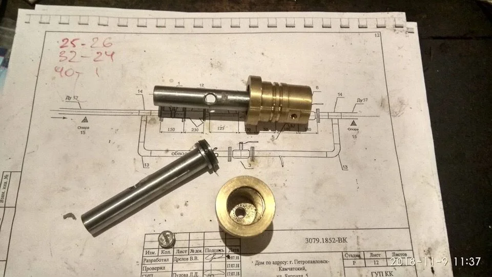

The diff actuators are interesting, they seem fairly simple, I wonder if hes got a spring somewhere for the diffs to unlock back when unpressurized.
Spring inside actuator
Cheers
It’s been pretty simple, some cuts, some welds. Axle complete 😎
This is my workshop. Two 20feet containers welded side-by-side

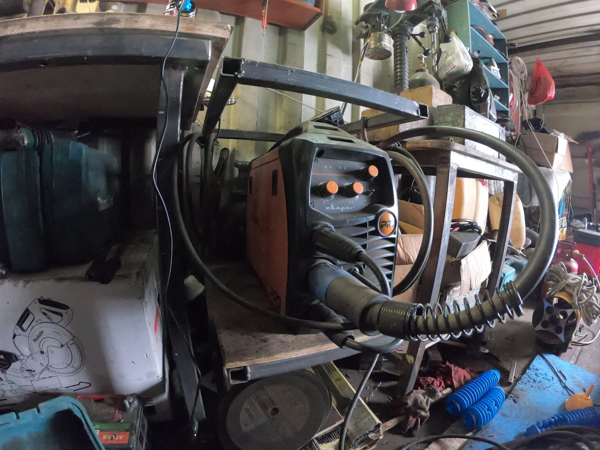

Me too! What brand/type of welder are you using?
Chinese MIG Jasic pro mig 200
Chinese Fubag In200. Most welds I do this welding inverter.
