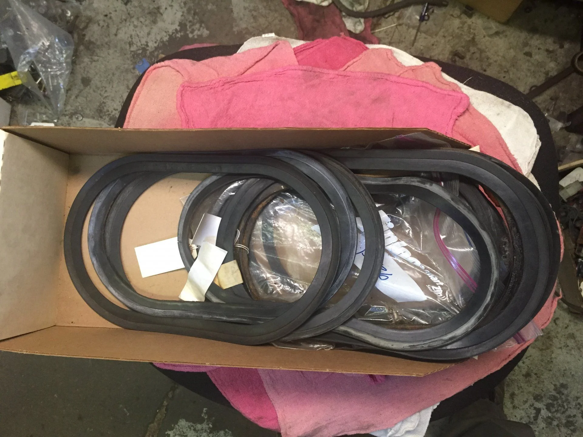

I have a stack of good used 2F air cleaner gaskets. Not looking to sell them by themselves, but happy to include with larger orders.

Is this what we are talking about? Upper and lower are the same right? I'm pretty sure 17845-61010 is discontinued also.

do you have a stock of those? i dont see them on the website
