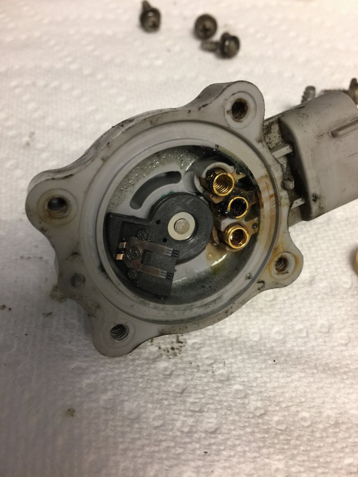

You may be able to pull the sensor apart and clean the contacts. I think they sell cheaper sensors somewhere online too.

So I took the sensor apart and the spring were pretty corroded and shot. There was a fair bit of water in the sensor as well. Picture below. One spring broke into 4 pieces as I tried to remove it. I salvaged a spring from a ballpoint pen and put that in and now my truck is back to normal, if only temporarily.

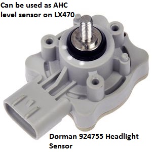

I did some searching and it seems that the height control sensors are the same as those used in Toyota's headlight leveling system. I ordered a Dorman 924755 sensor to replace mine. I will be sealing all 3 of mine up as well to prevent further corrosion.
This is the prius headlight sensor:
2004-2009 Toyota Prius Headlight Level Sensor - Body Electrical - Standard Motor Products, Rear Left 04-09 Prius Headlight Level Sensor - 18054-05523039 - PartsGeek
This is what I bought...
Amazon.com: Dorman 924755 Headlight Sensor: Automotive

Read the reviews on Amazon on those. Seems to be a bad design that wears out the carbon trace after a few weeks. We need guinea pigs.
Camino quoted a post of mine above but I cracked the Dorman one open and it seems identical to the stock sensor. Been running it on my rear height sensor for a while now with no issues.
I like to practice what I preach - put my money where my mouth is - whatever and have been running the Dormans for quite a while (18 months?) with zero performance issues. I did a write up with pics and comparison to OE a while back and the only identifiable difference is the Dormans have apparent copper springs and the OE appear to have either gold or brass plated springs and the OE have a manufacturing date code printed on them. Otherwise they swap straight in.
I just ordered one via e-bight, for 17.75. We'll se how it measures up.
I just ordered one as well. Attempting to return the $$$ one I already ordered :doh:

If you search "Dorman" by me you'll find a post where I've measured resistances, angular displacement etc and point out that the front OE potentiometers are left and right hand oriented and the Dorman potentiometers are right handed; however they do swap directly over and fit/function in left, right and rear installs. Best to swap over off vehicle to ensure you seat their lever arms properly and don't accidentally rotate the potentiometers wiper beyond its stops.
