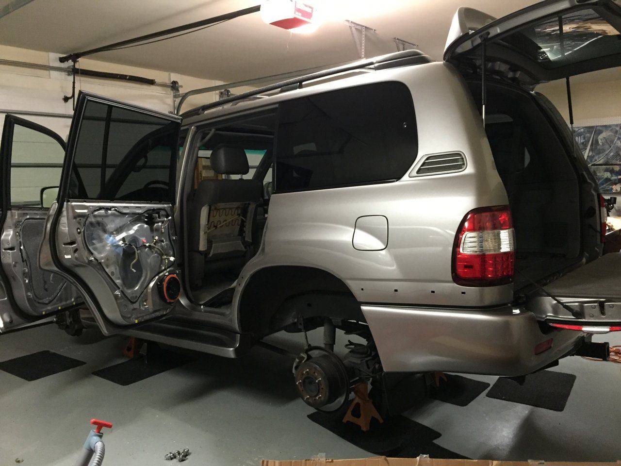

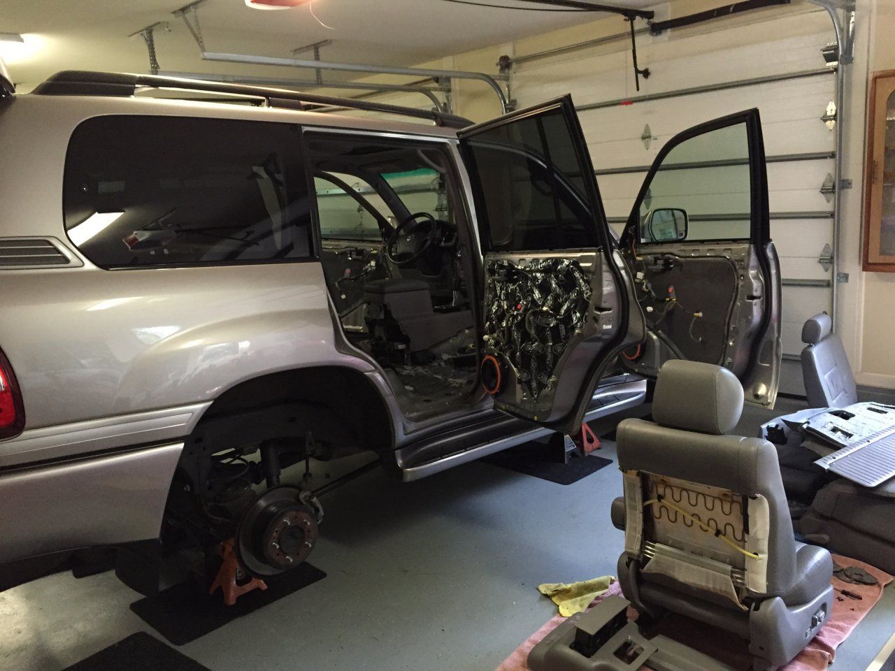

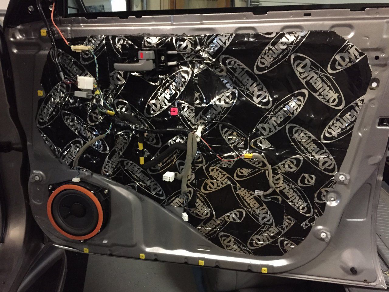

Bought a 2006 and am now having some fun:
-refinishing wheels
-new tires
-new side moulding
-new weather stripping
-a few new trim pieces
-professionally painted bumpers
-three stage compound and wax
-pulled carpet, cleaned floor, new carpet
-cleaned all interior trim pieces
-dynamat doors and rear cargo
-change all belts (incl timing), plugs, etc
-new speaker grills
-new front grill
-weathertech mats
View attachment 1188758 View attachment 1188757

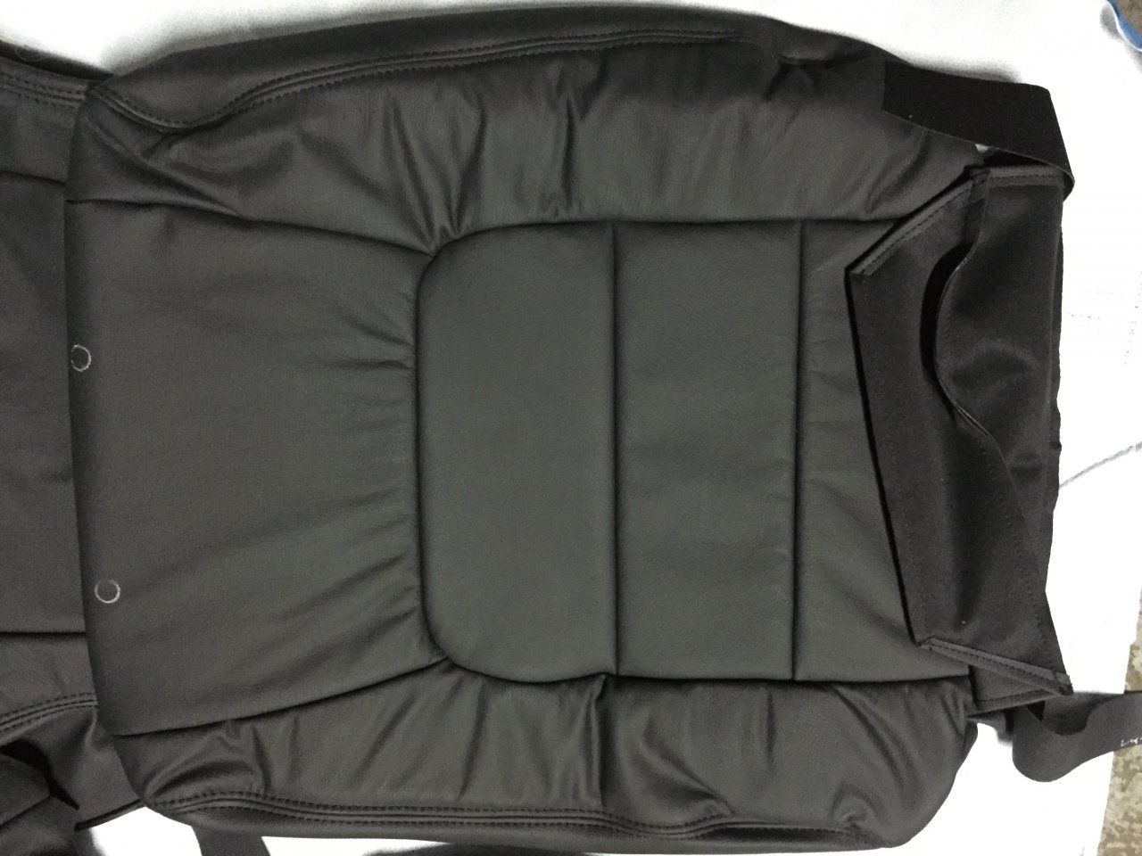

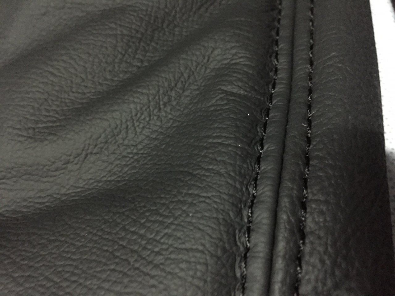

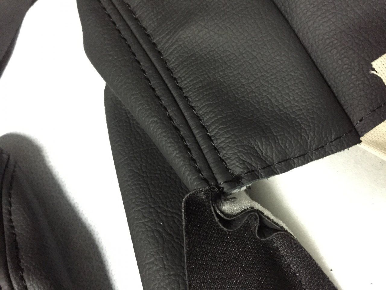

Received my front leather/ pleather skins from Land Cruiser Heaven. These are for the 100 seats in my 55, so I ordered them in black to match its interior.
I'll post up a pic/ thread once the upholstery place gets them on

That is going to be awesome! I have never heard of Land Cruiser Heaven? Land Cruiser Heaven Unfortunately it is a blocked URL here at work...

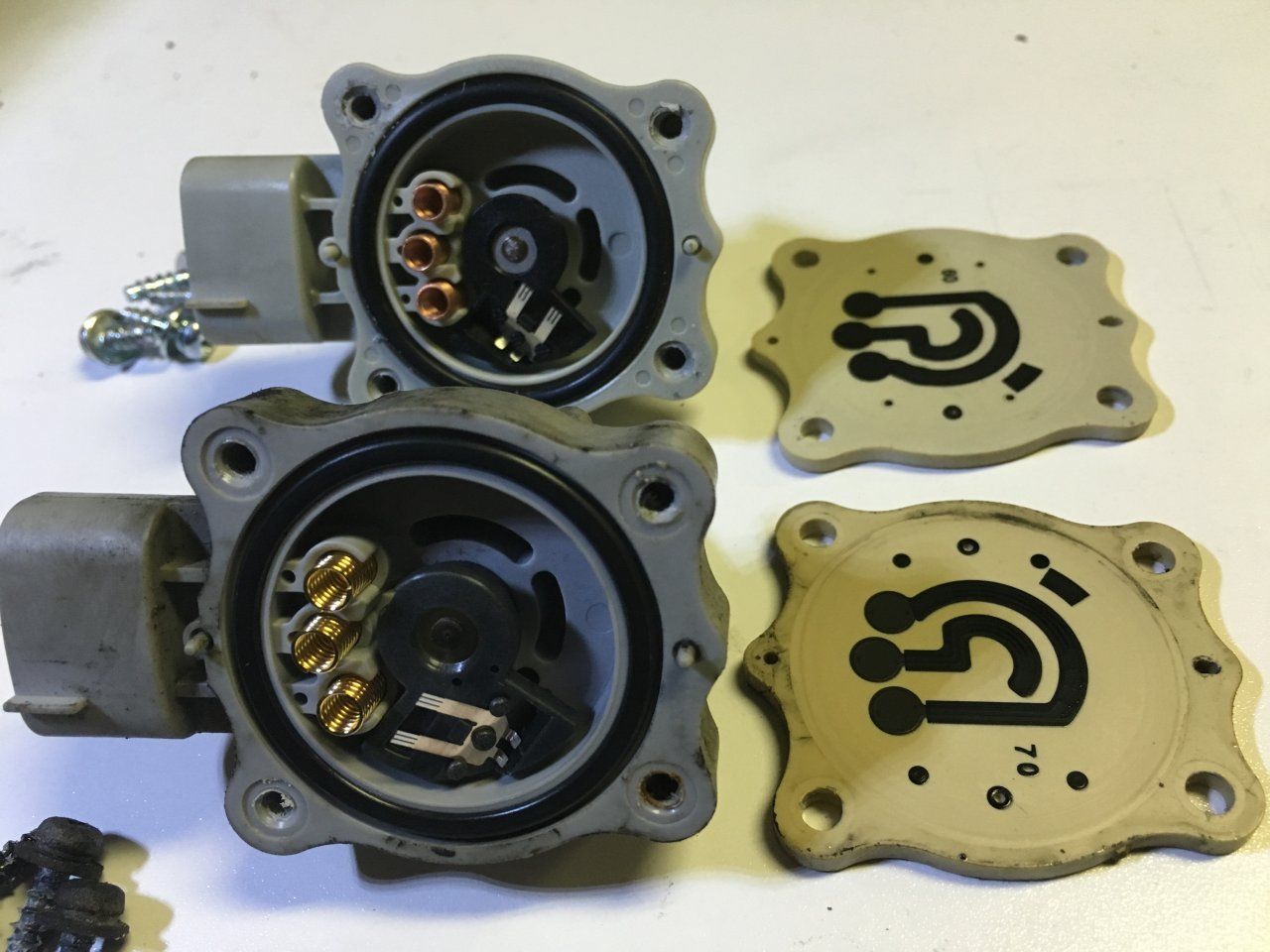

Fitted a Dorman 924-755 headlight leveling sensor into a front AHC height sensor position. Works as expected and appears to be a $55 aftermarket option to repair failed OE height sensor assemblies that cost $250-$300.

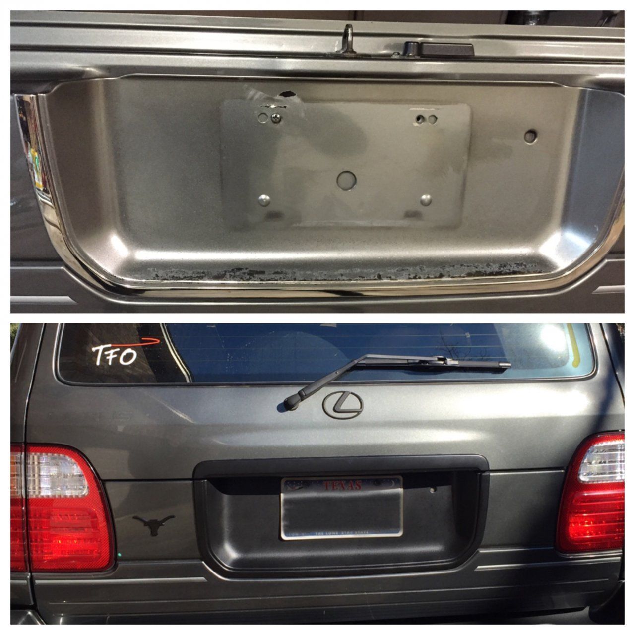

aaaand I plasti-dipped the back panel thing with all that chipped paint ugliness. also deleted the emblems!
Interesting, never heard of Land Cruiser Heaven either. I don't see anything listed for the 100 series on their site though... care sharing how much you paid for those @cruiserjunktion?
I'm not sure what the retail on these is, you'll need to contact Frank
I ponied up the templates for the seats. We also did some horse trading with this deal, too.
Wanted: - Old OEM cloth/Leather Seat covers for 60/100 series - no matter condition
I opted for leather seating surfaces and synthetic materials on the other parts of the seat to save $. All leather is available.
