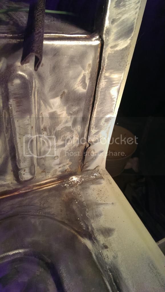

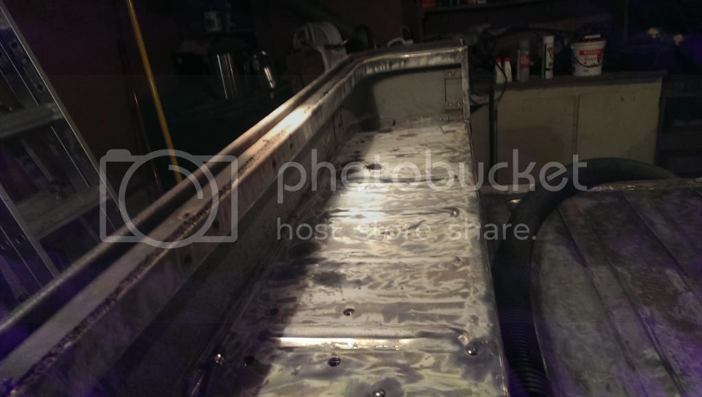

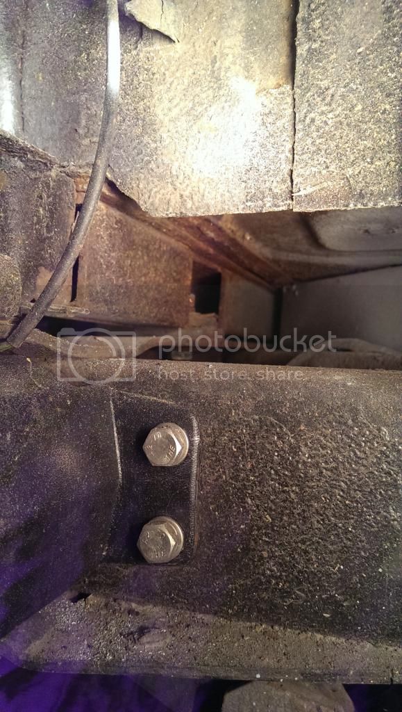

Box tube rear sill:

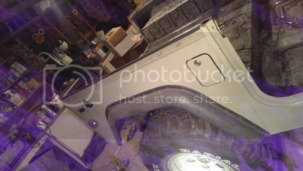

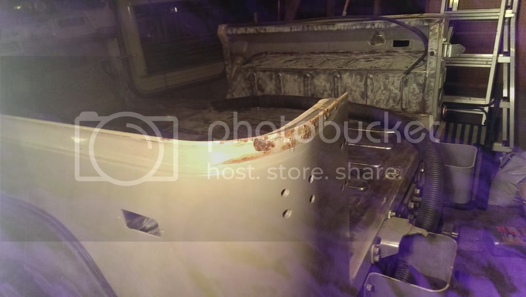

Holes in the passenger side rear fender where the supports are:

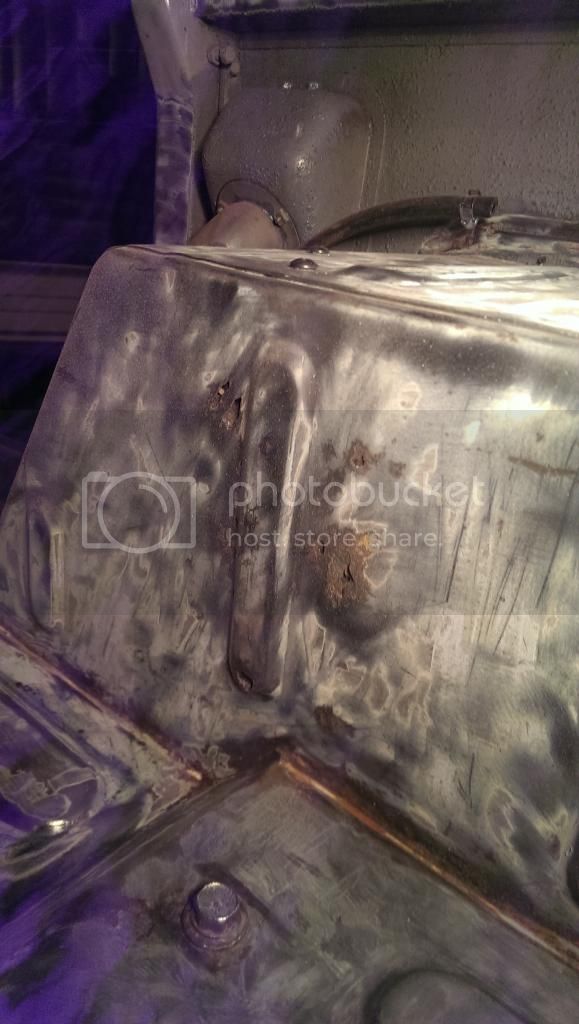

rust in the passenger rear channel at the ambulance door opening:
Cut fenders:
Tough to see here, but the tops of both rear fenders are pretty dented up:

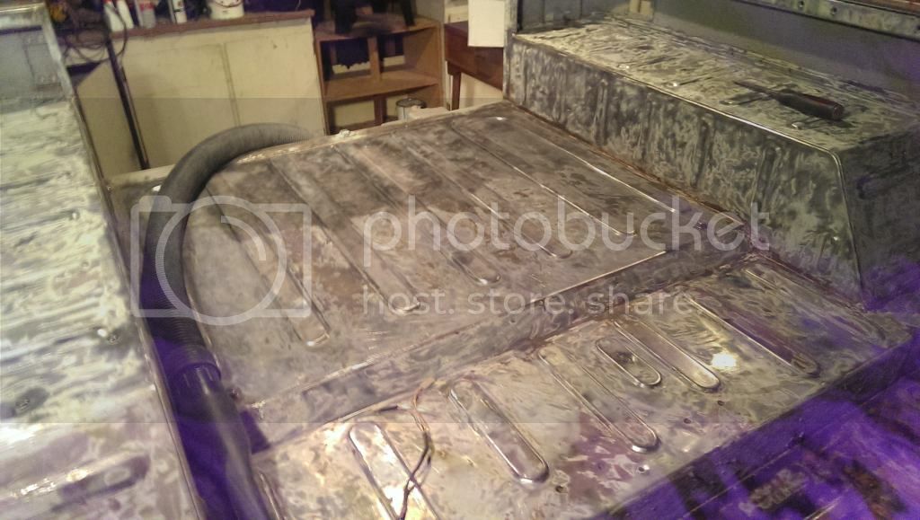

But, the tub is in decent shape in the rear:

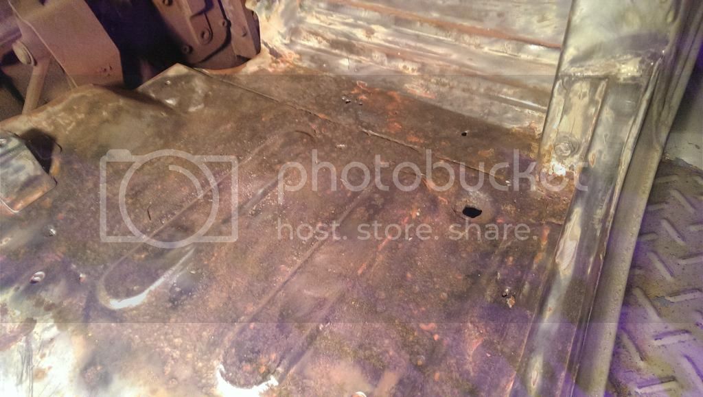

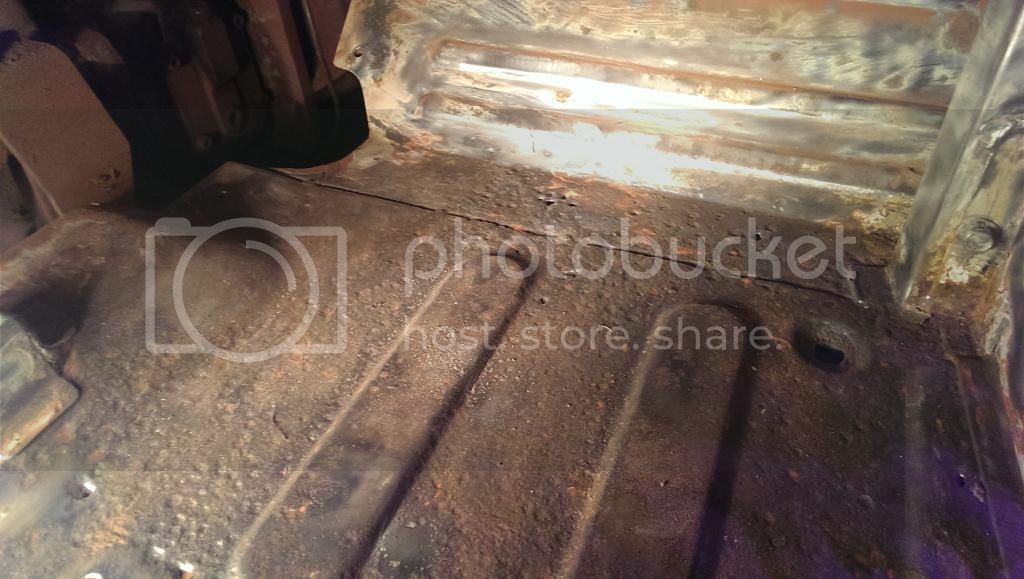

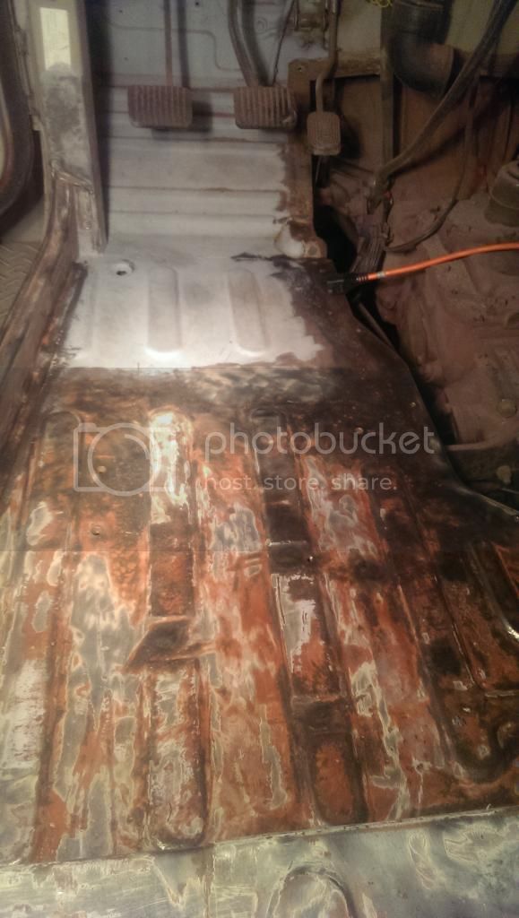

Super pitted passenger side floor, with some holes. Any remaining red stuff is filler that I haven't wire wheeled out yet.
Another passenger floor pic:
Driver side floor. Looks like there were some prior rust repairs where the ribs are- you can see a few sections where the ribs stop and there's a flat section, then the ribs resume.

Your rig will have a greater resale value with the original tub and the repairs. You rig is in better shape than mine was and I repaired mine. But I would recommend using POR 15 on the frame and all the body parts. Yes its a pain to get it prepared right and a long day from the time you apply the POR 15 until you get the etchant primer and buildable primer all on in one day. Do the Frame and under side one day then the inside and outside of the tub another day. You will be happy with the results. I have done two FJ40's that way.
Is your truck 100% stock? If not I say aqualu. If its a survivor go with steel. Majority of people wont care anyway if you sell it what the tub is made of if its a somewhat modified rig. At that point what matters is if it looks good and the mods aren't ghetto. At least from what I see on ebay. If you restore yours you have to buy almost as many panels as a fairly rotted tub because who wants to make a bunch of tiny patch panels? Then you have to get it acid dipped or else their will be rust you'll never get too otherwise, then you will have to have it galvanized cuz youll never get protection in the nooks n crannies, and then you can think about paint, and then you'll wonder why the heck your doing all this work to save 500 bucks.
