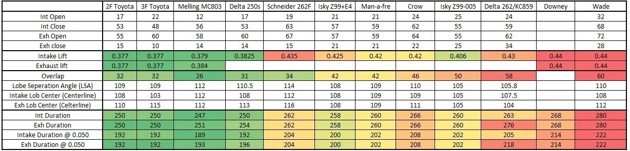

And then @ERNRAM went to the effort to compile all this info into a table.
I have not checked for accuracy:

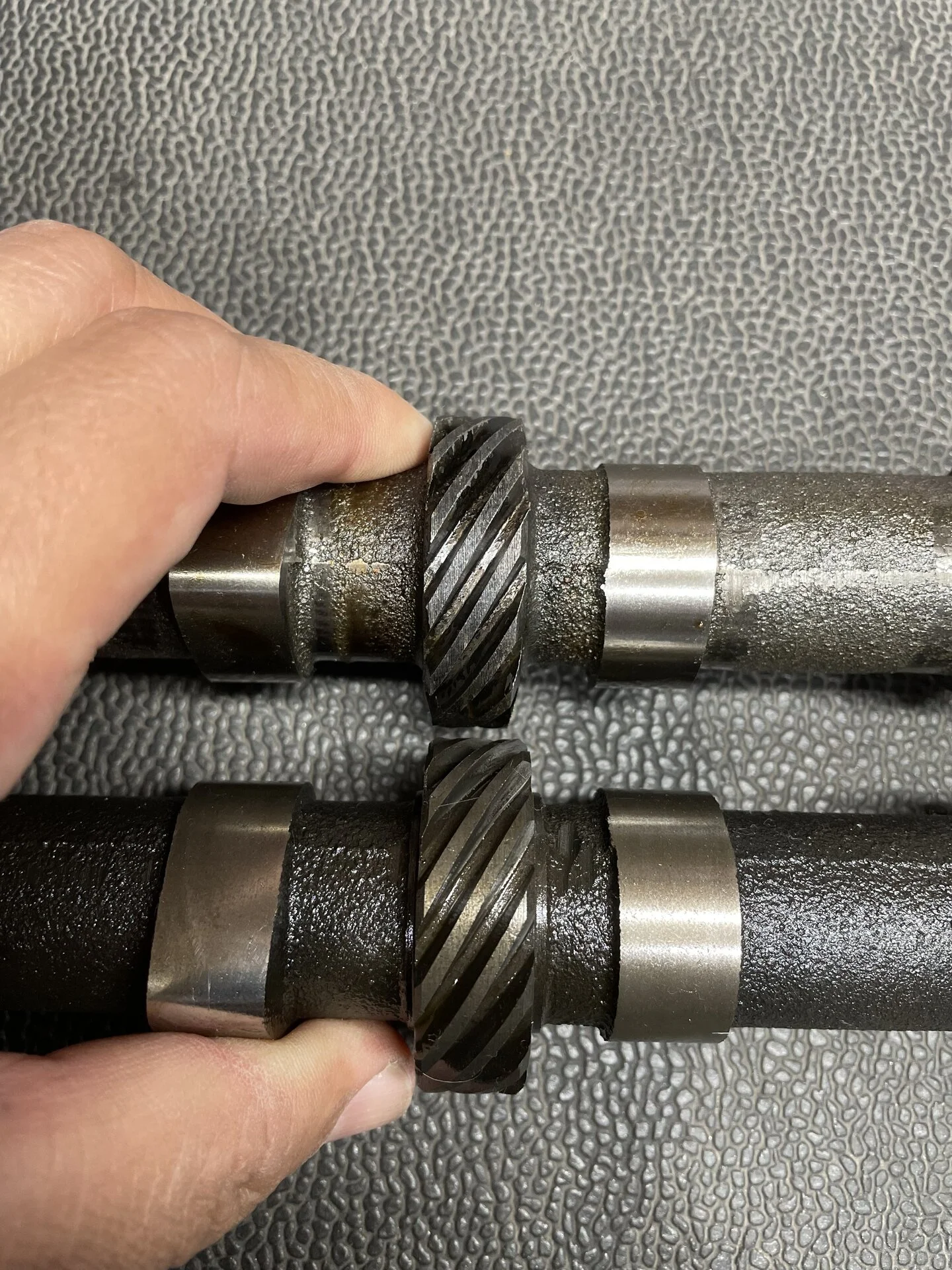

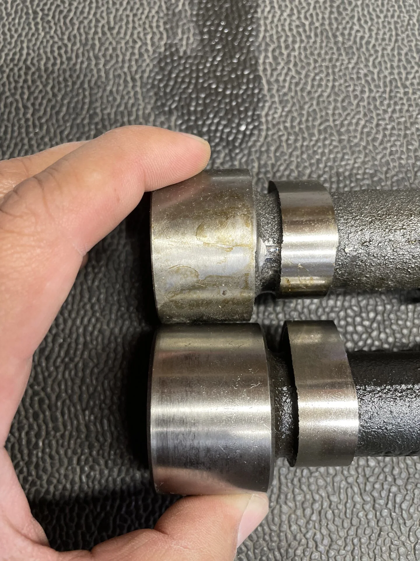

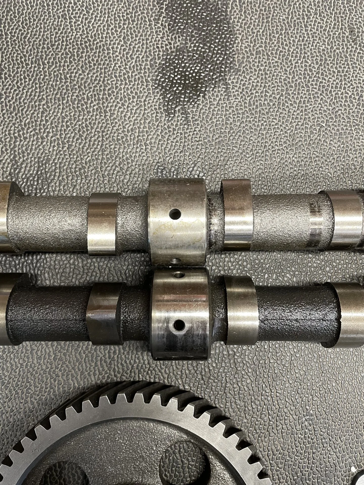

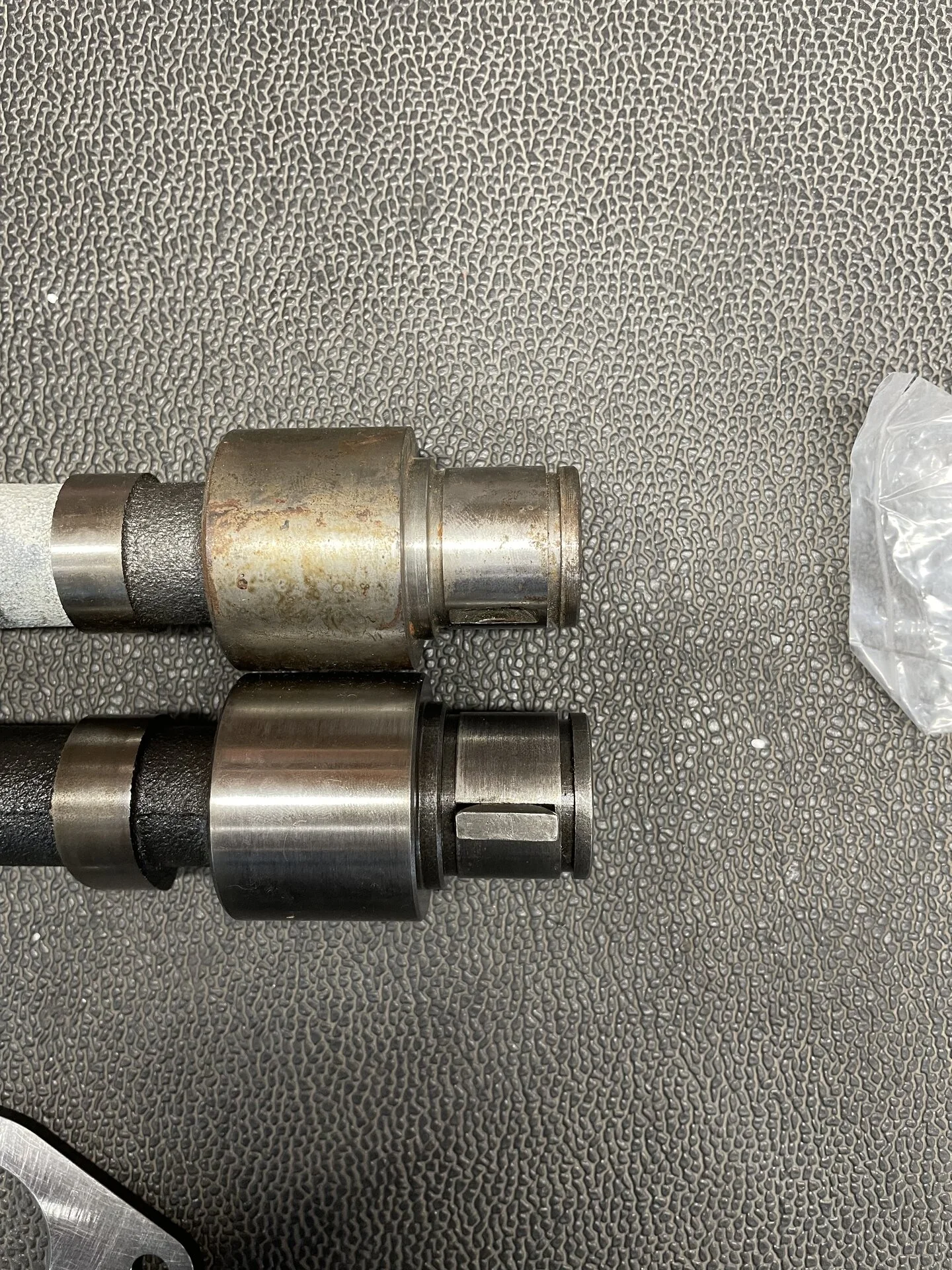

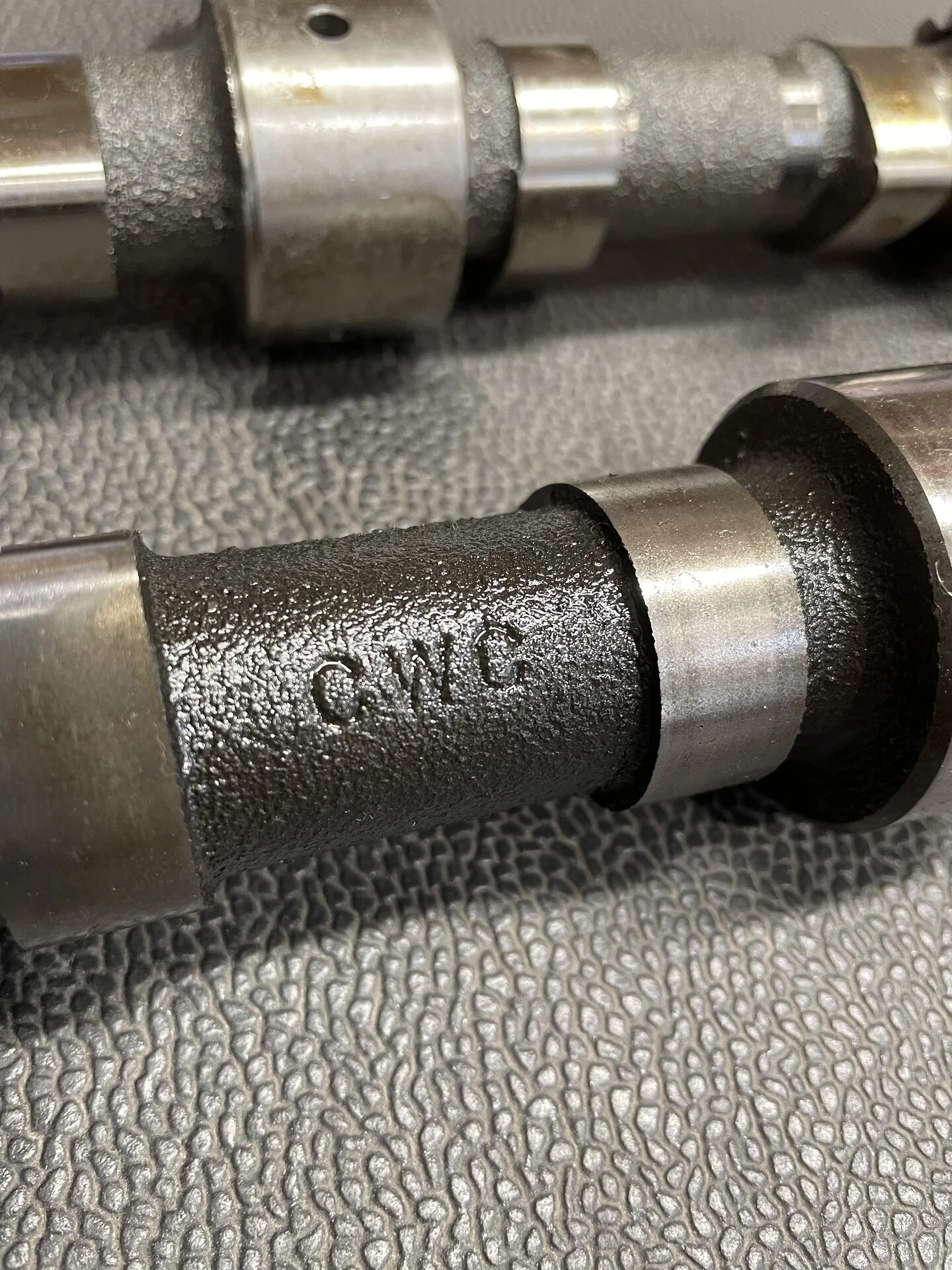

A picture of the NOS one on the top and the CWC blank that was most likely ground to spec by a PO on the bottom. Notice the size differences.

What is CWC?
How did your other cam ruin the timing gear and thrust plate?
Couldn't you just measure the used cam and inspect surfaces to know if good or not?
Thanks!
CWC makes most of the aftermarket cam blanks. They grind some, others go to companies like isky or Comp for their proprietary grind.
Not sure what year a PO put in the CWC aftermarket cam. I can’t figure out how the excessive wear happened either. Makes no sense but the wear marks seem to indicate the cam and attached cam gear having too much back and forth motion rather than just circular rotation. Must have happened over many many miles. The used CWC cam had visible ridges on several of the lobes. I took it to a shop to see if it could be ground and they said nope,,,too far gone.
