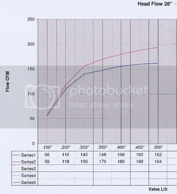

Cam was ordered at these specs
Duration 220 @ 0.050" Lift 0.43" Center line 112 Degrees.
The 3FE head is fitted with larger flat faced Ferrea Valves and Crows heavy duty valve springs.
Ferrea exhaust valve 1.6
Ferrea intake valve 1.9
Valve springs by Crow Part No 4832
Ported and polished 3FE head, the flow rates look like this after testing.
These gains would be pretty much the same for 2F & 3F heads, the only real difference between them and the 3FE is the intake ports which are shaped to accommodate the injectors.
Intake
Exhaust
