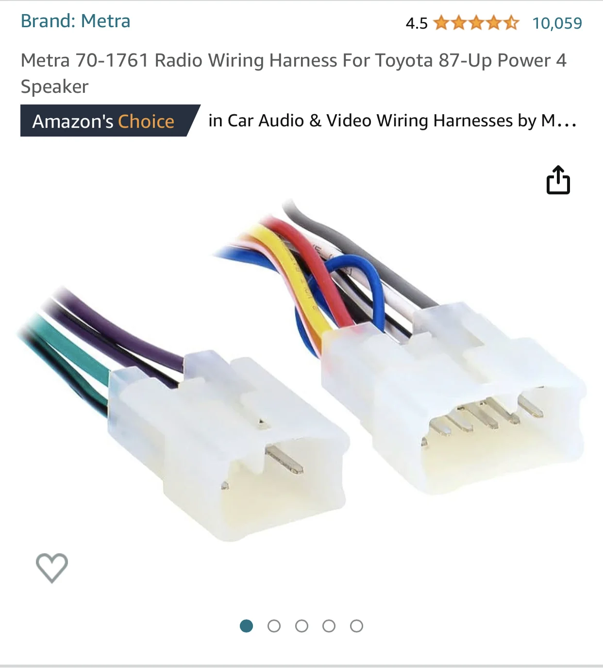

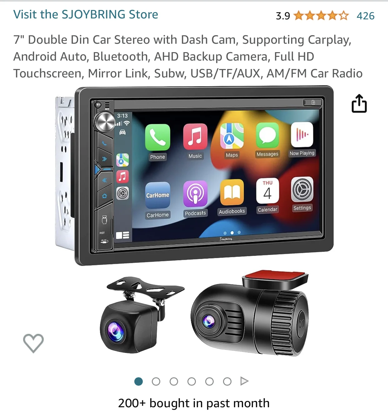

Has anyone purchased this particular radio unit on Amazon? I purchased it along with the Metra wiring harness for Toyotas 87-up. I wired everything per the directions and used the 2 (unused) factory connectors behind the dash. Everything powers up but the sound is sub par. The new head unit heats up very fast and the speakers can’t seem to handle the bass. I double, triple checked the wiring and still can’t figure it out. When I put the stock radio back and use the original single harness everything sounds good. I have a 1996 Land Cruiser… any ideas?

Metra 70-1761 Radio Wiring Harness For Toyota 87-Up Power 4 Speaker https://www.amazon.com/dp/B0002BEQJ8?tag=ihco-20
7" Double Din Car Stereo with Dash Cam, Supporting Carplay, Android Auto, Bluetooth, AHD Backup Camera, Full HD Touchscreen, Mirror Link, Subw, USB/TF/AUX, AM/FM Car Radio https://www.amazon.com/dp/B09W2J8J3K?tag=ihco-20

It's the silver box on the left. You can see the two unplugged connectors. The Metra harness you used is the same one I used. It bypasses the factory amp and goes straight from head unit amp to speakers. If you unplug those two factory amp plugs I bet it'll sound better.

I don’t see any internal amp specs on the radio. I think you need to supply the amps for that thing to work.

Looking through the manual, it shows the speaker wire connections out, not just RCA's, so it must have an internal amp...that said, not a single spec on the amp power, so that's a little disheartening.

It's strange that you get sound, but very degraded with the new unit...that and the extra heat would make me return this one if I were you...no need for it to run hot under any circumstances.
