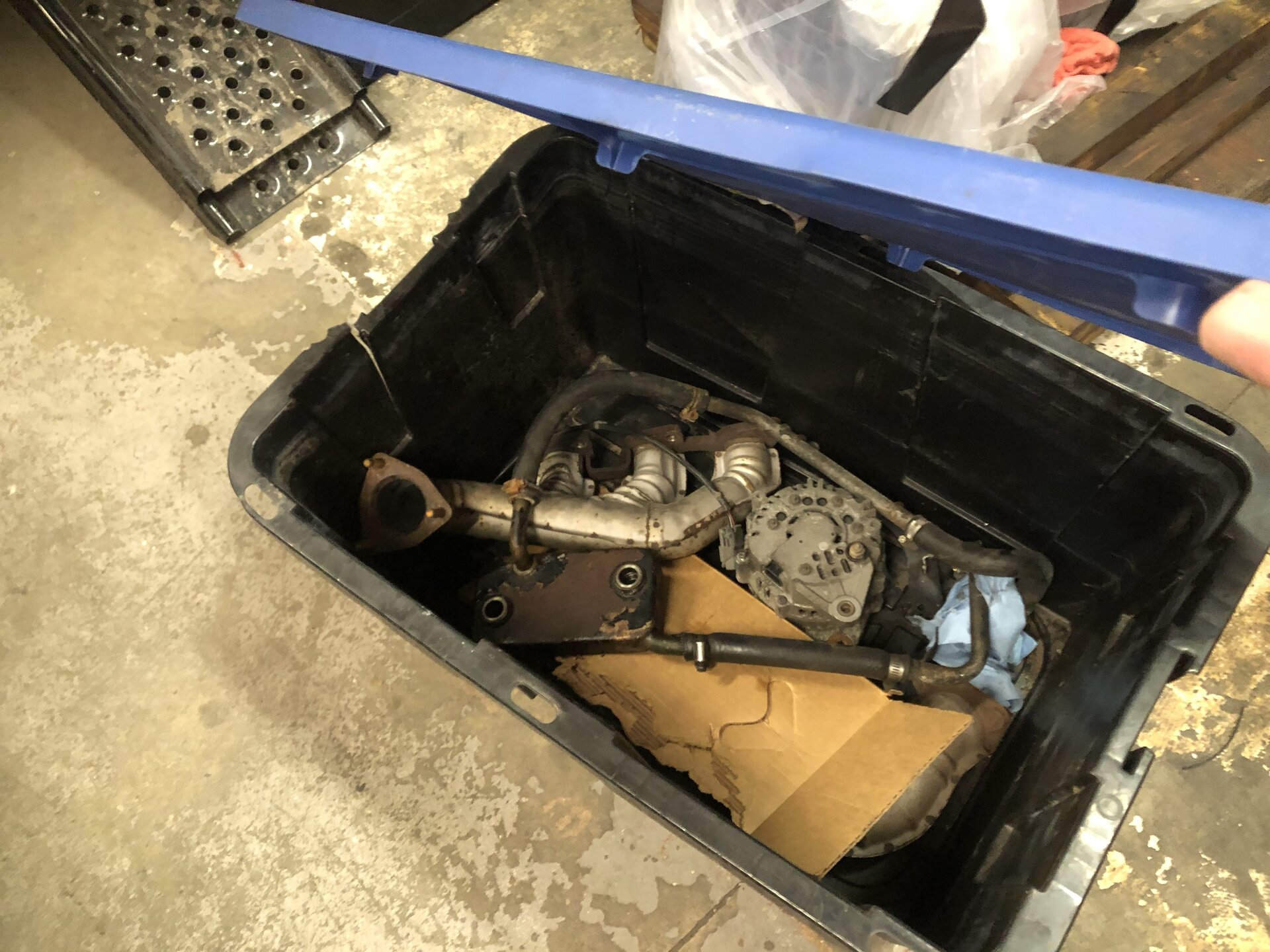

Finished day 1, unloaded stuff and got the cruiser in the shop. Unearthed some less than ideal things.

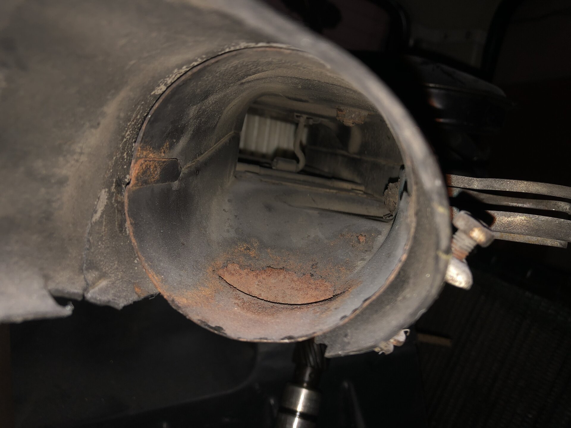

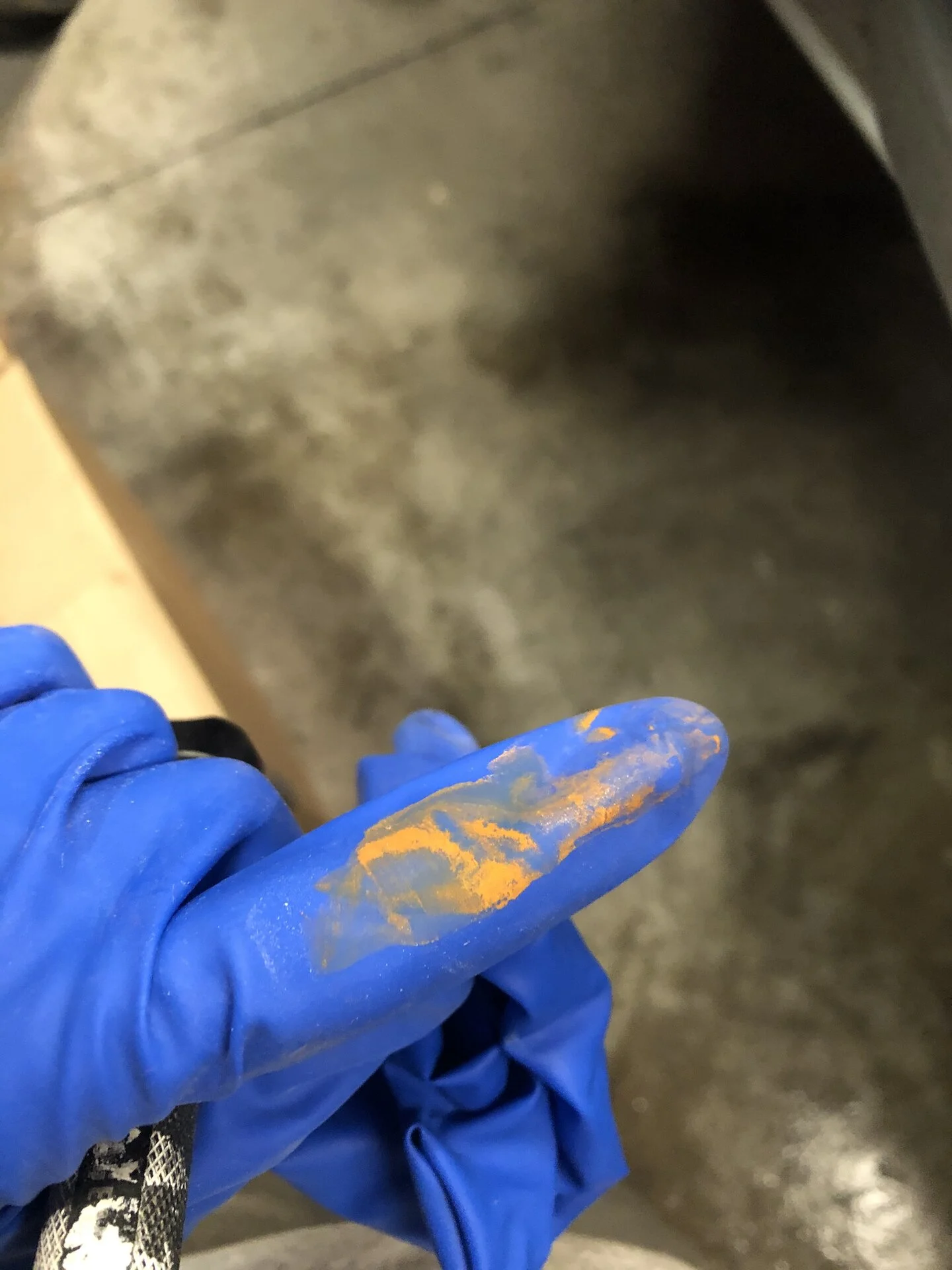

There’s rust on the rebuilt engine and head. They’ve been sitting in a parked car outside for 2 weeks and something with the moisture happened, so will have to scrape it off I imagine? Any pointers on this?
I’m trying to convince my boss to let me unload the engine in the shop so it’s not outside in the elements and can get cleaned, but don’t want to push it. Maybe if I wipe it down with oil I can store it outside.

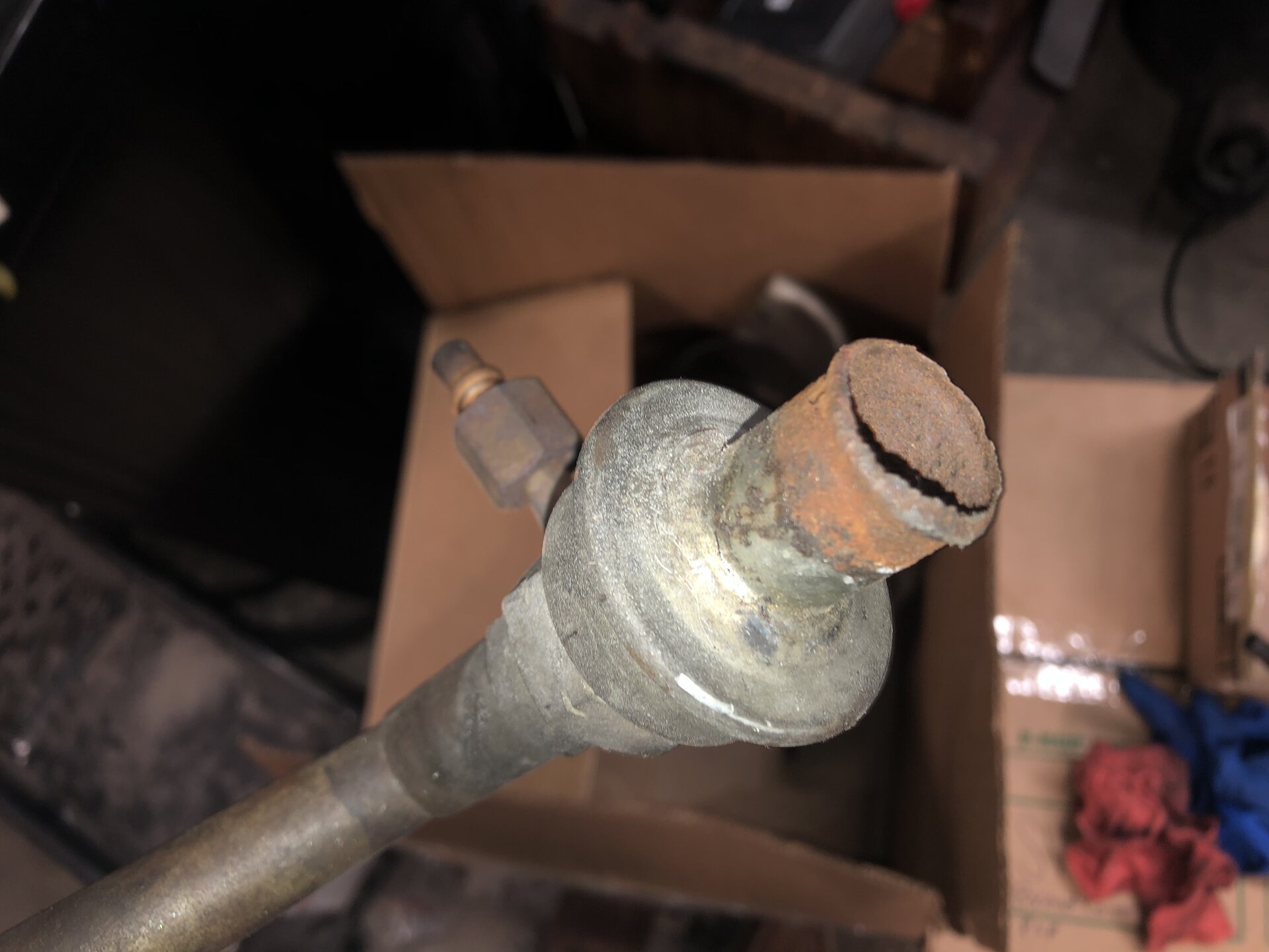

There’s also some rust on almost all parts, which sucks. I’ll have to find a way to clean these too. I have a wire wheel at the shop but that’s about it.
Most of that will probably brush off with scotch pads and brass brushes. Just make sure you don’t get any rust or dirt in the oil passages or cylinders. WD40 was invented to displace water. Stands for water displacement - formula #40… so that will keep it from rusting till you get it back together. Spray it down and put it in a garbage bag to keep debris and whatnot from getting in it. Clean it up with acetone before you put it back together or try to paint it.
Definitely some wd40 coated rust seeped in. I could get it all off without wire brush. I’m going to disassemble and clean everything anyway. As for the oil passages, there’s rust in there and will have to use piper cleaners or something to get it out

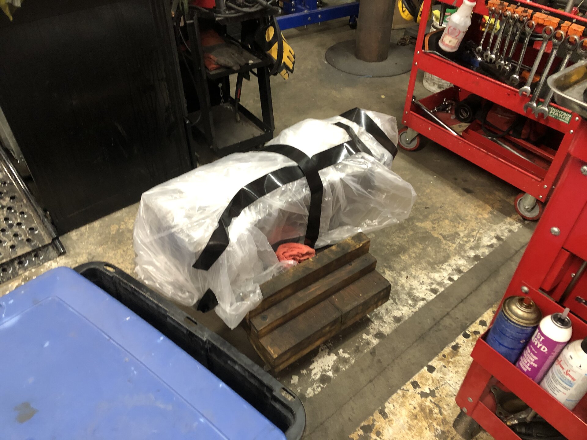

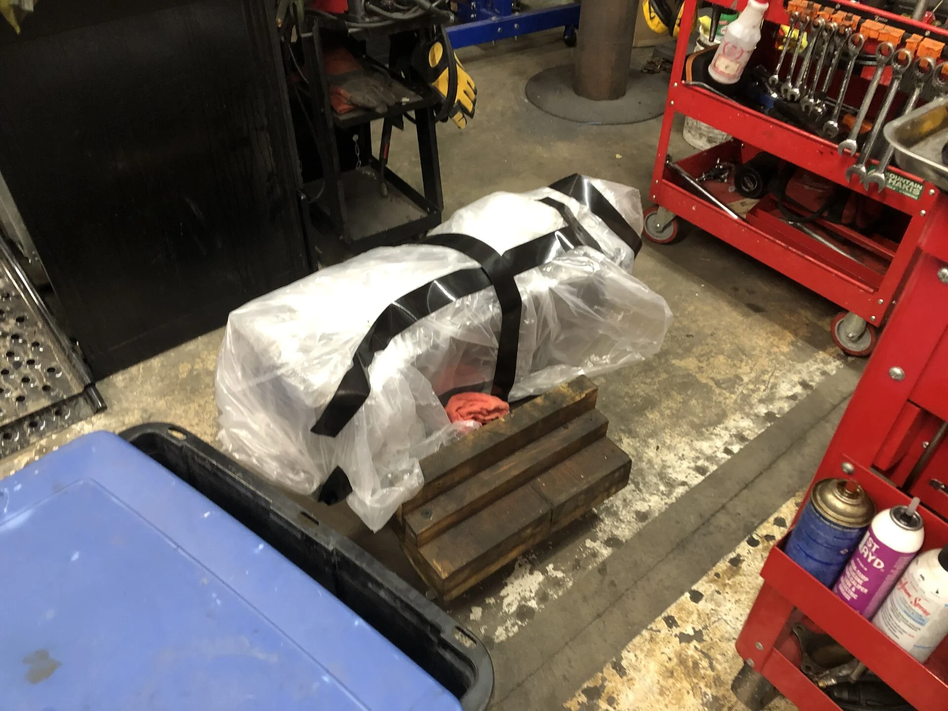

Day 2 complete, engine out of the truck sprayed with 40 and covered. Enjoying my first Ih8mud tradition beer 🍻
