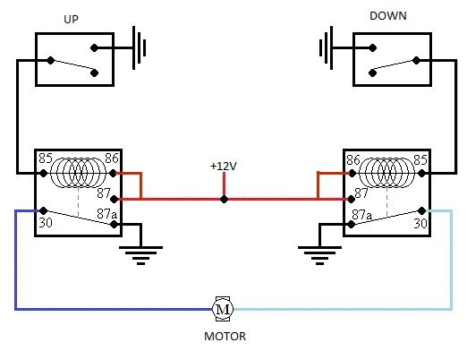

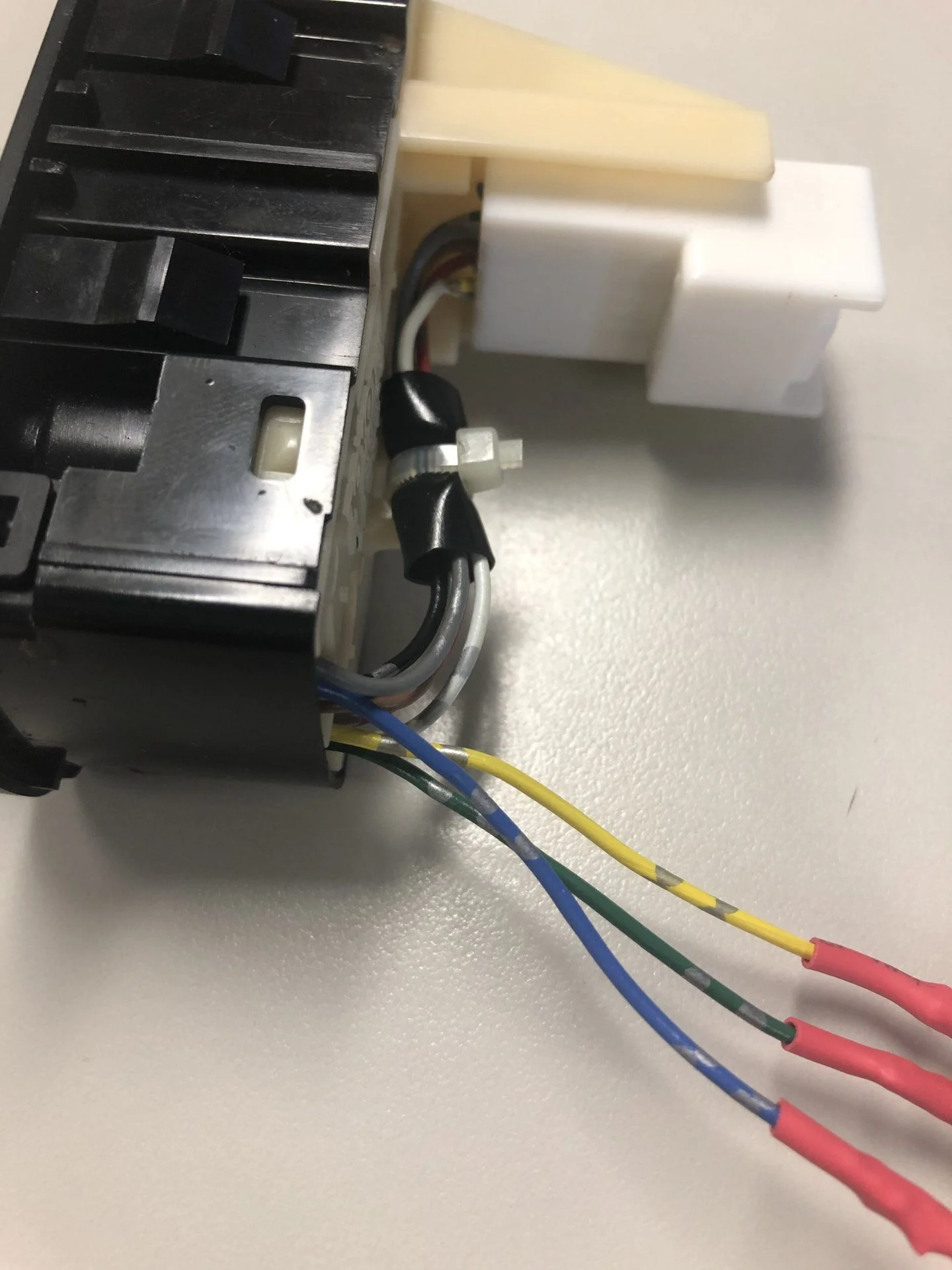

I always hated that the rear vent windows were manual in my GX (I guess I got spoiled in my old LX). Just on a hunch, I looked at pictures of the manual latch from a 100 series and it looked just like the ones I’m my GX so I picked up a LX window motor on eBay. I was right! Bolted right in. Big problem was figuring out how to wire it in. There are only 2 wires from the motor so you have to reverse polarity to make it close. Also, I wanted to make it look factory so I used the height control switch to open and close the window. I made a video of it because it would be too much to write to try to explain how I did it.

Very cool. Does the motor have a built in limit switch?

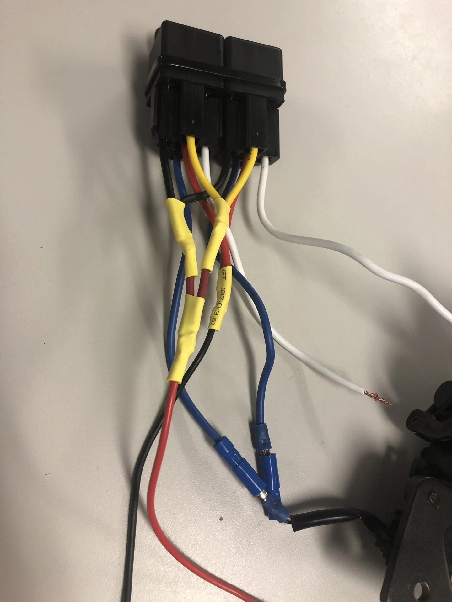

The 2 relays and relay harnesses I picked up at Pep Boys:
Dorman 88069 30 AMP 12 Volt 5 Pin Universal Relay
Novita RS40 relay socket
Like I said, you can use any switch. It just has to be grounded, not powered.

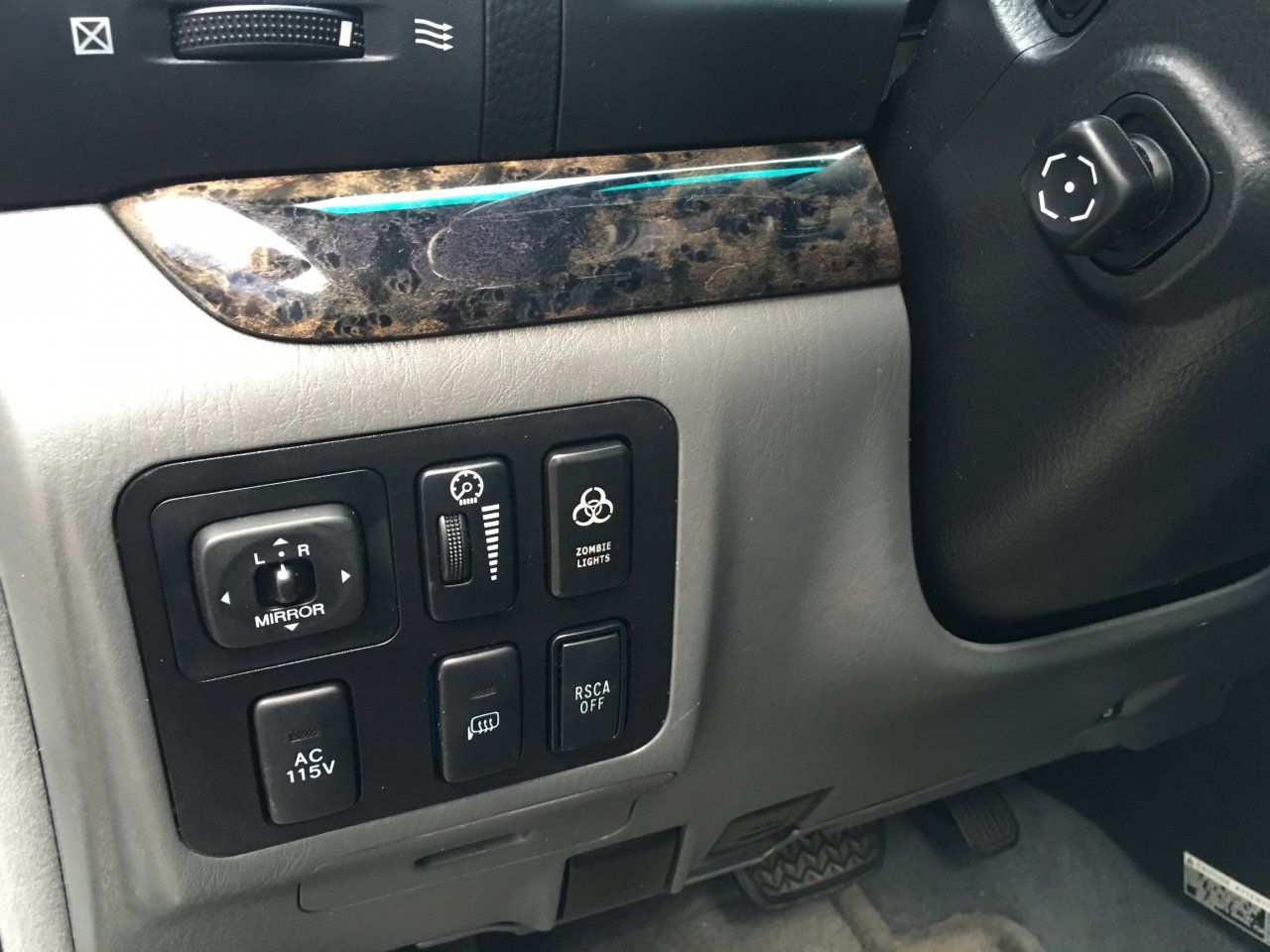

If you have a pre-aux plug model and need a place for a switch, you could do the late model switch panel swap to free up a slot. I already did it in mine but I used the spot for a light switch.
